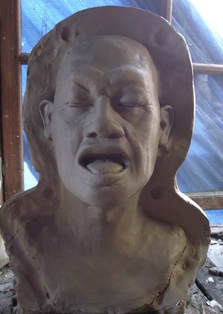

This is an old commission of mine a candy man bust, here's the sculpt pics
Once the sculpt was done I then added a clay wall to the middle of the bust to separate the front and back halfs of the mould

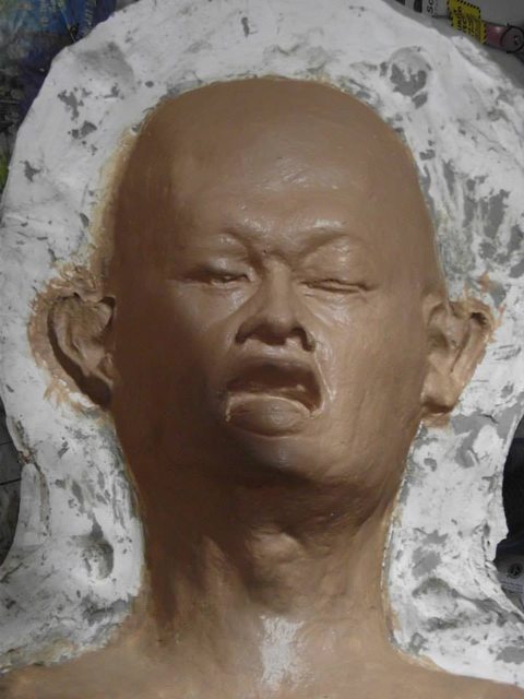

first beauty coat of plaster
once the first half of the mould was done, I then removed the clay wall and started on the back side

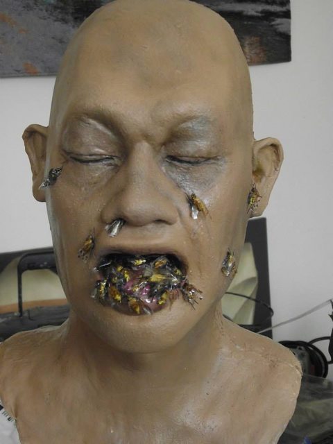

I then based the head in a skin tone after clearing up the mould seam, and added various colours to build a realistic tone up, once this was done I made individual bees and started adding them

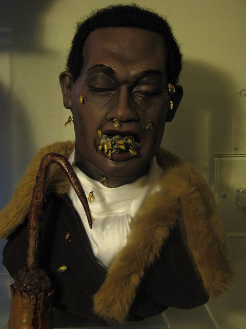

Then I was forced to stop due to illness, and the bust was completed by David Lady and his wife, they did a great job, repainting what was there as the buyer wanted a darker tone

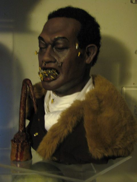

the finished bust was then finished by the buyer with clothes and coat and added hook, I think it turned out great
