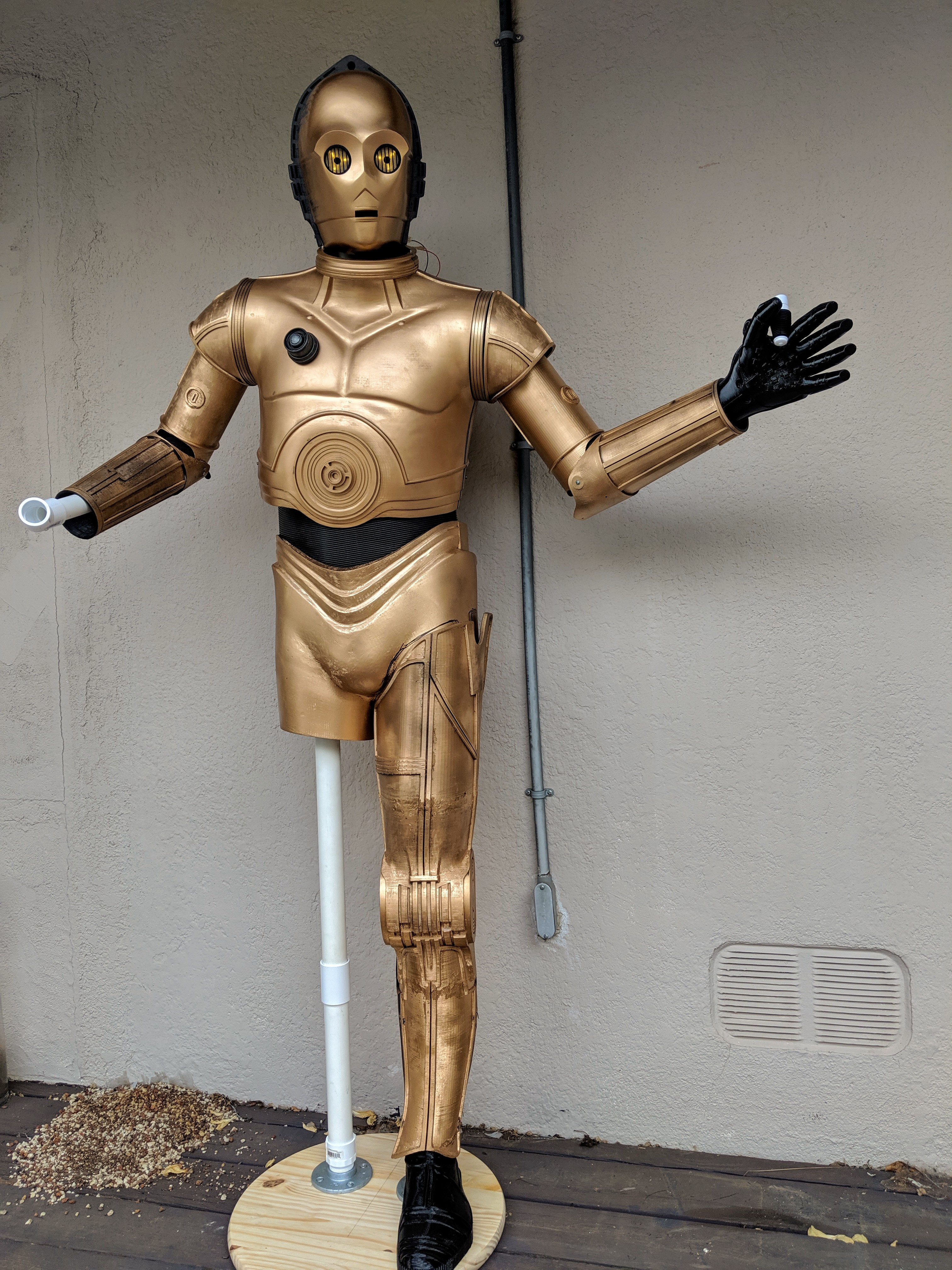

Its pretty difficult to put on. I can't do it myself, I need at least one other person to help me. I've heard that it takes around 40 min to get into the full costume.
I built a stand based on Gordon Tarplay's design:
The above image does not represent the final finish (Gold Krylon paint + primer just happened to be half the price of the other colors).
I'm currently focused on improving the fit of the leg, so I'm printing a thigh that is 2" shorter (despite being 2" taller than Anthony Daniels) to try and bring the knee joint up to where my own knee is.

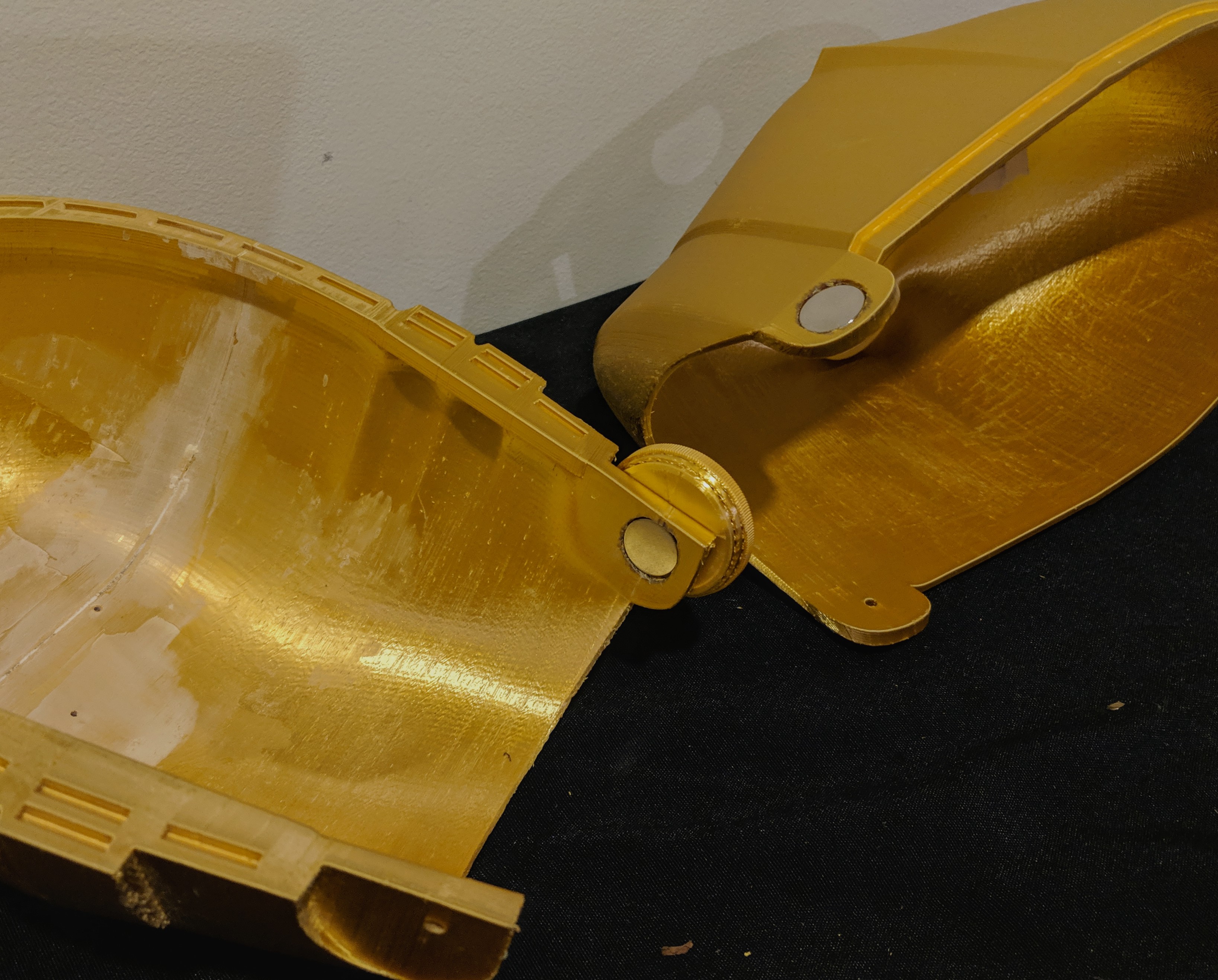

thegnome I replaced the neck bolts with neodymium magnets, seems to work really well-
I would really like to find a way to avoid using bolts in the torso, but I haven't had any ideas yet.

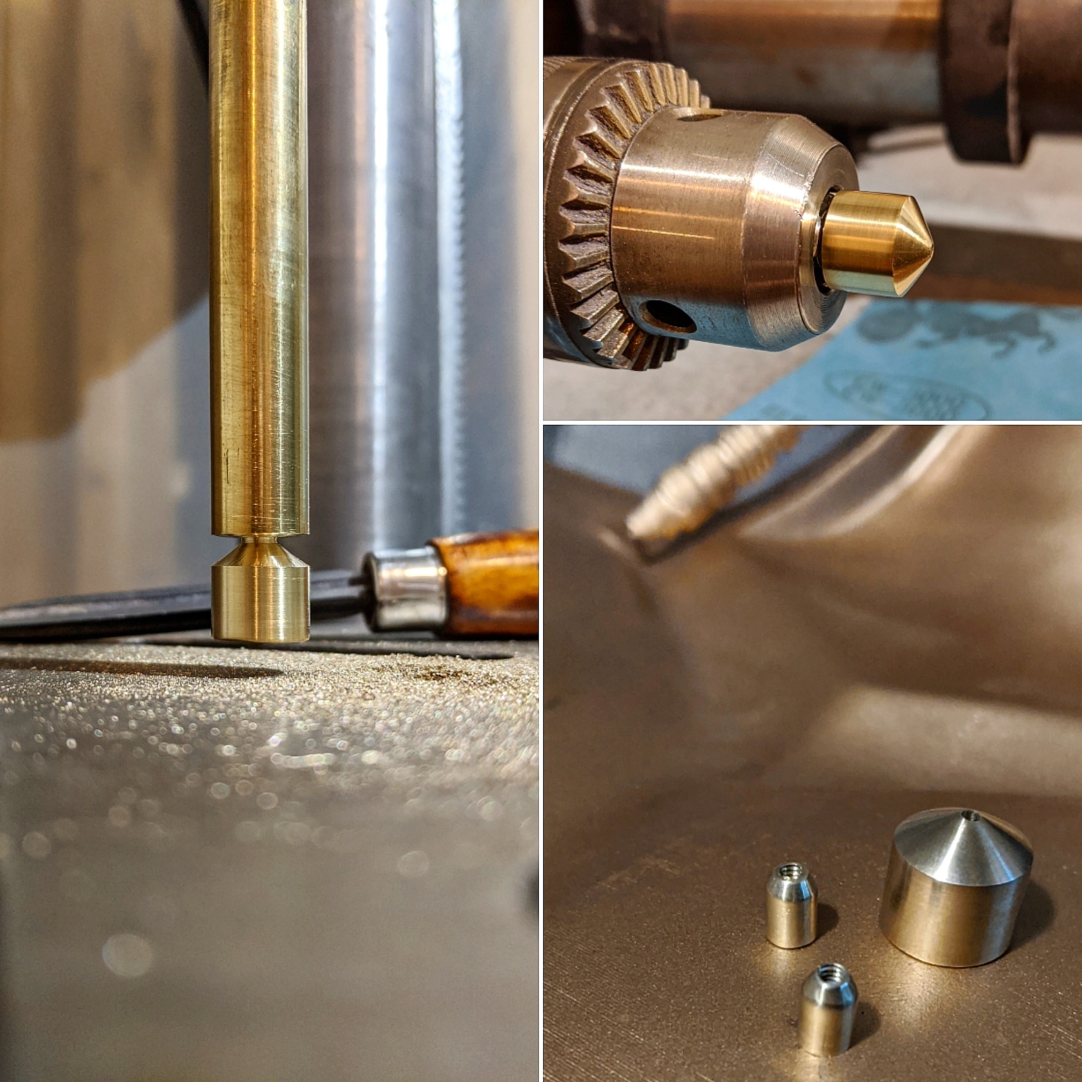

Not much to report on 3PO (so much sanding), but I did take some time to make a few brass greebles-
