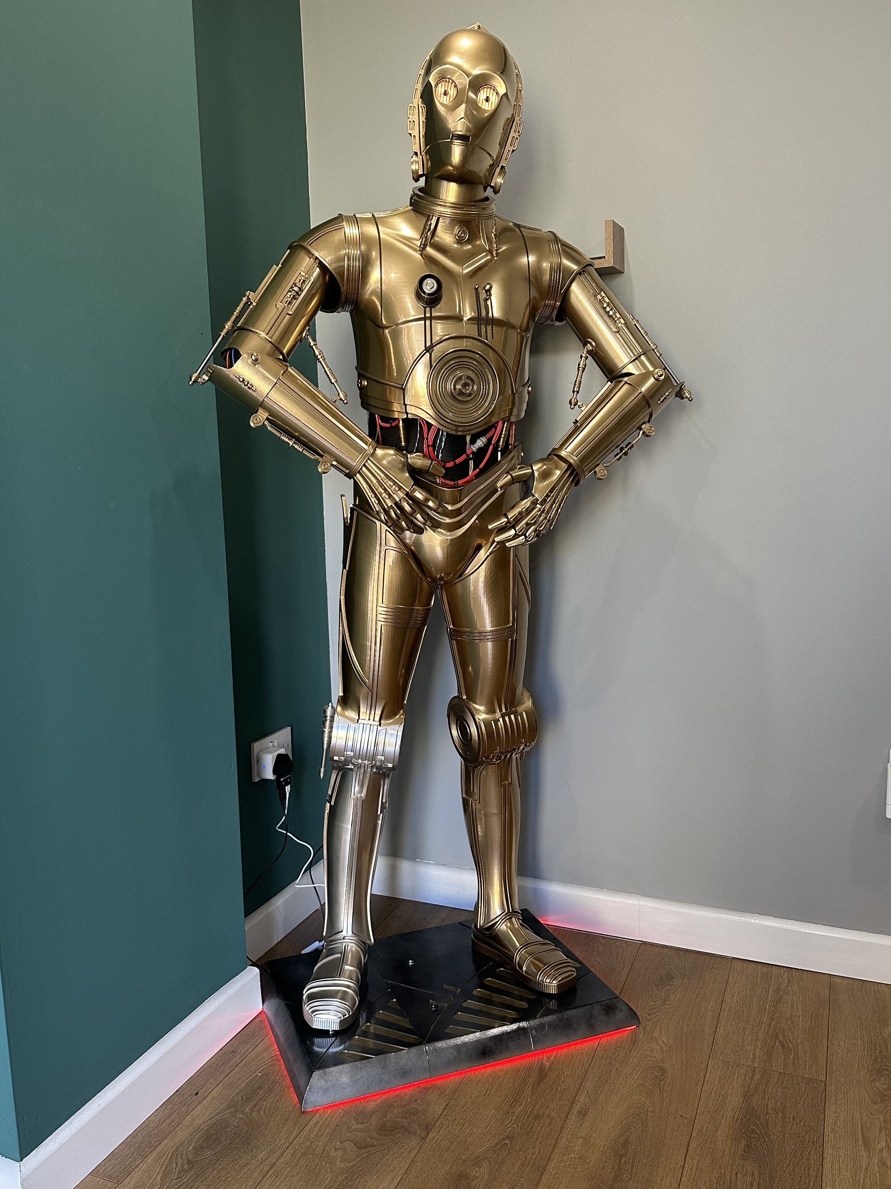

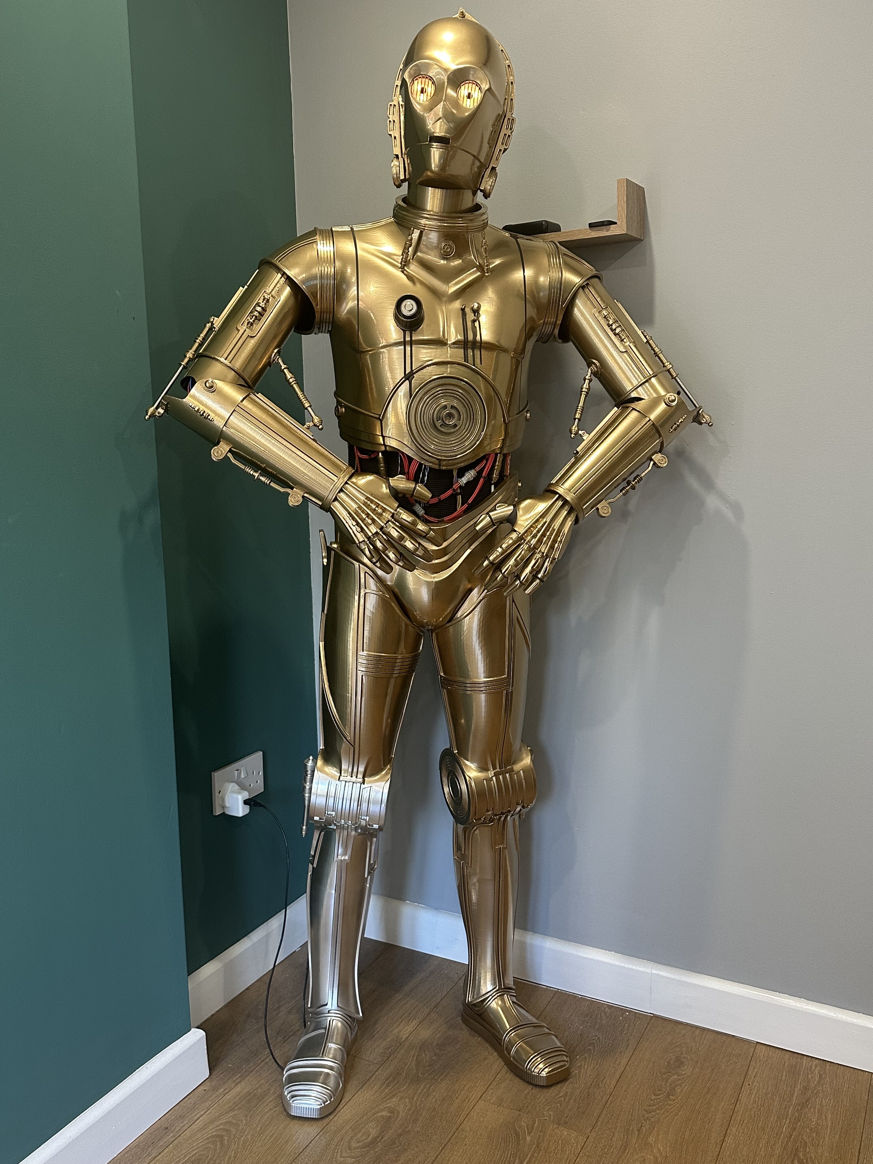

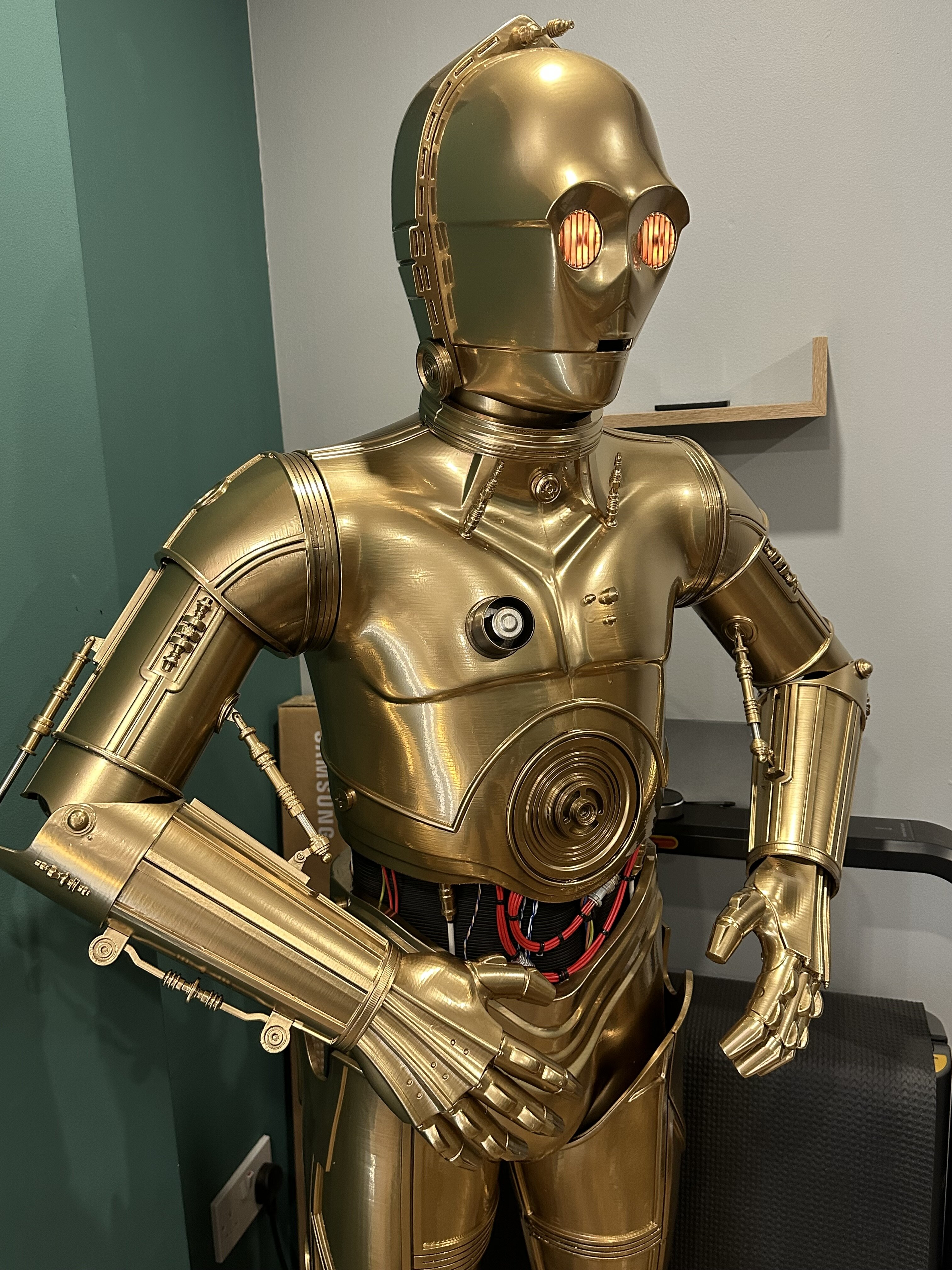

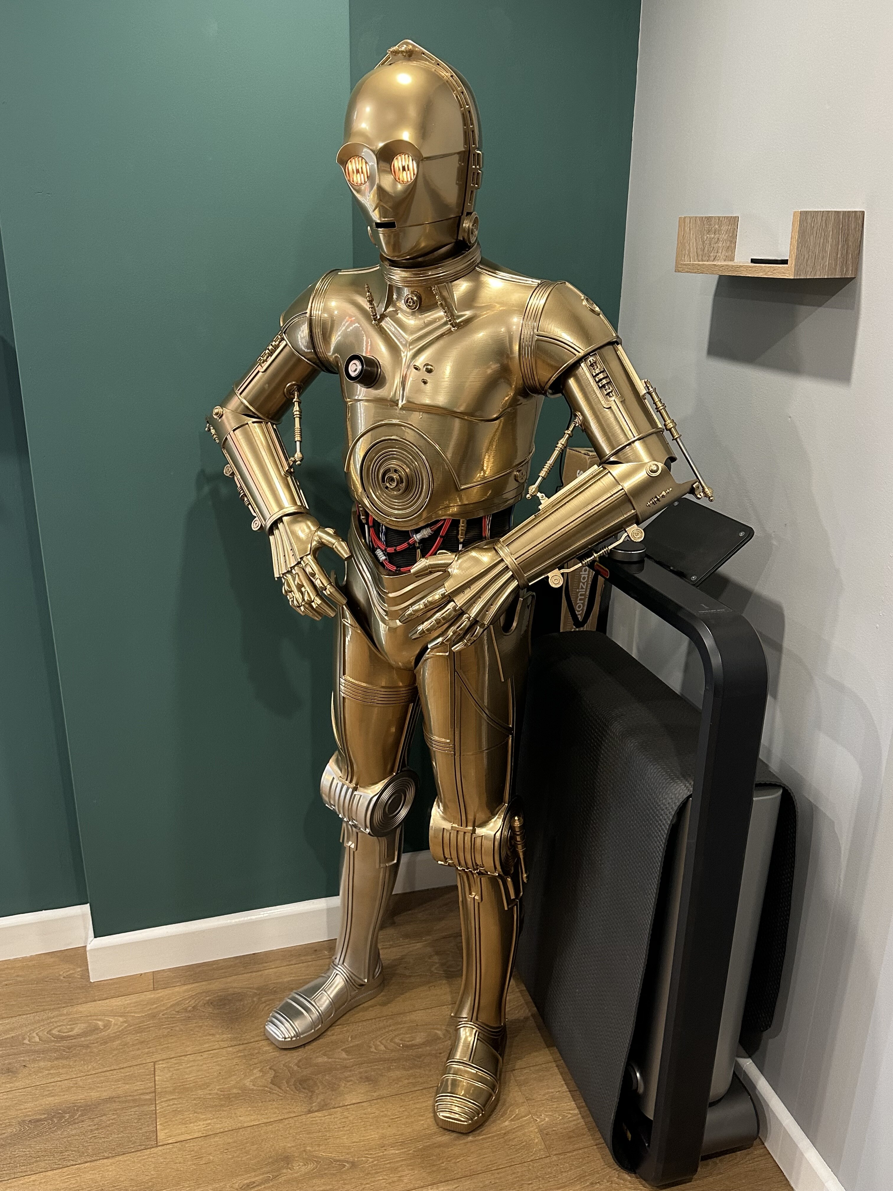

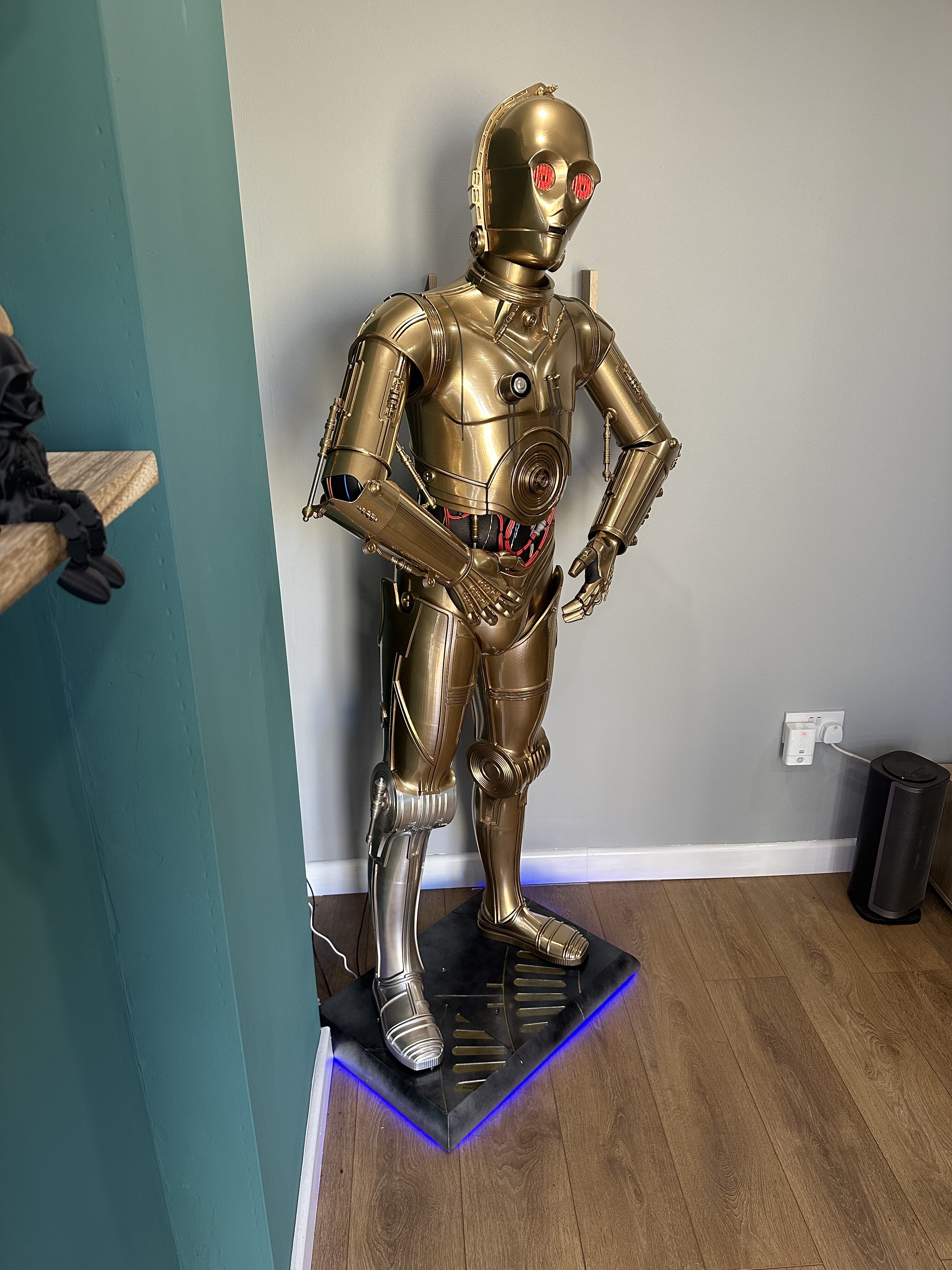

I’m new to this forum and would appreciate any advice on valuing a C-3PO replica that I’ve just built - Hoping that I’m not breaking any rules by also asking what people think it would be worth if I sell it ?

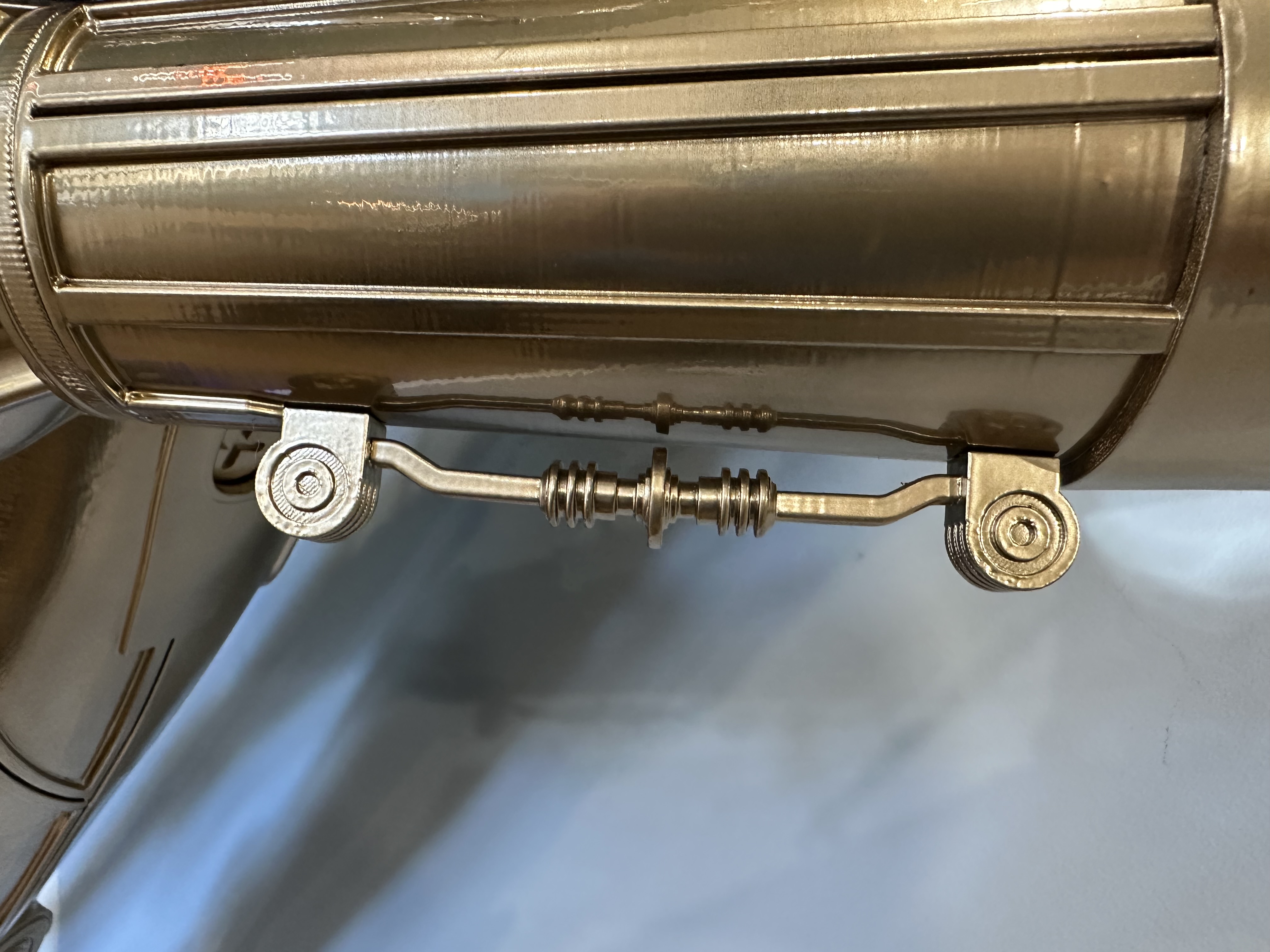

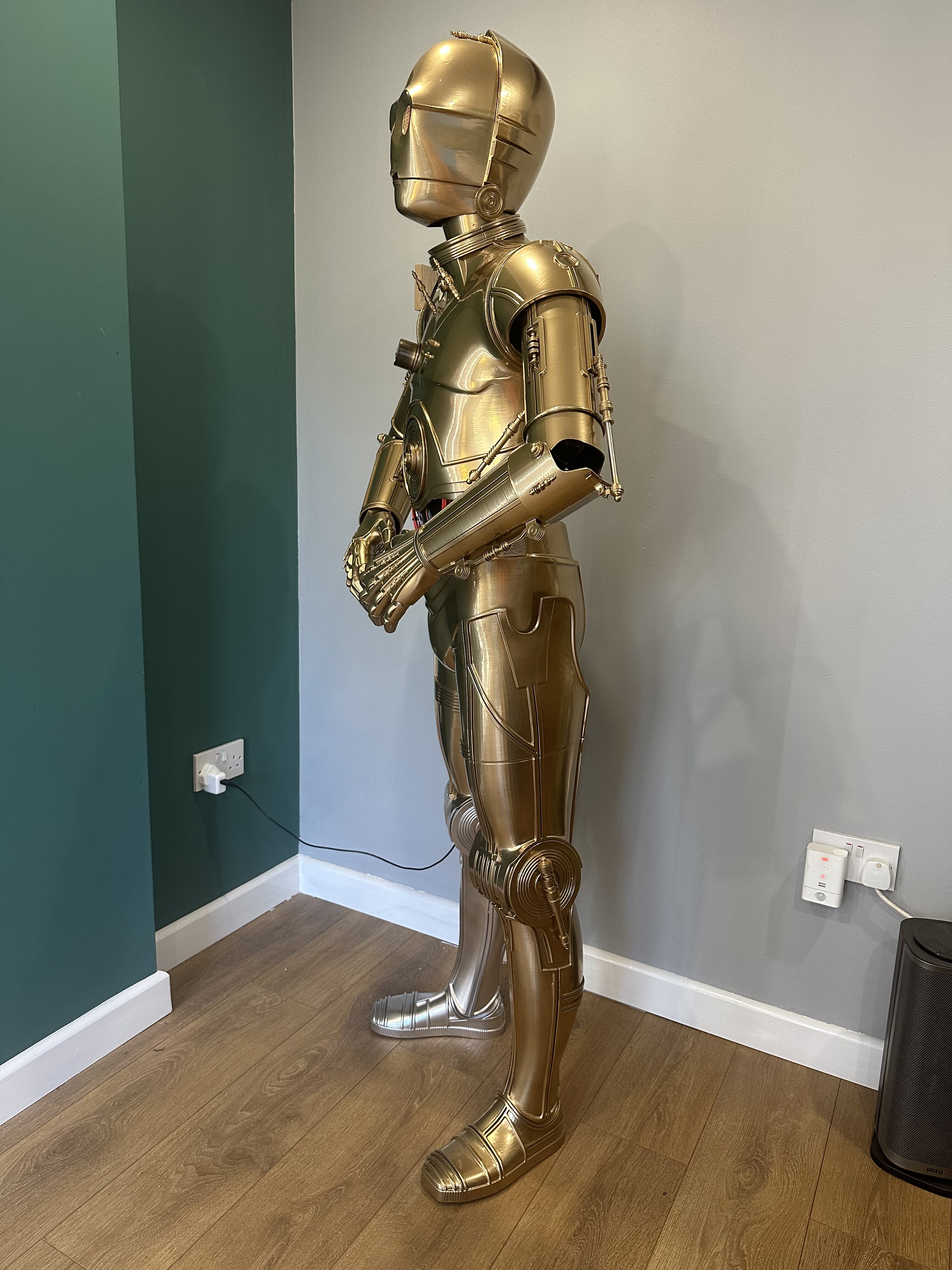

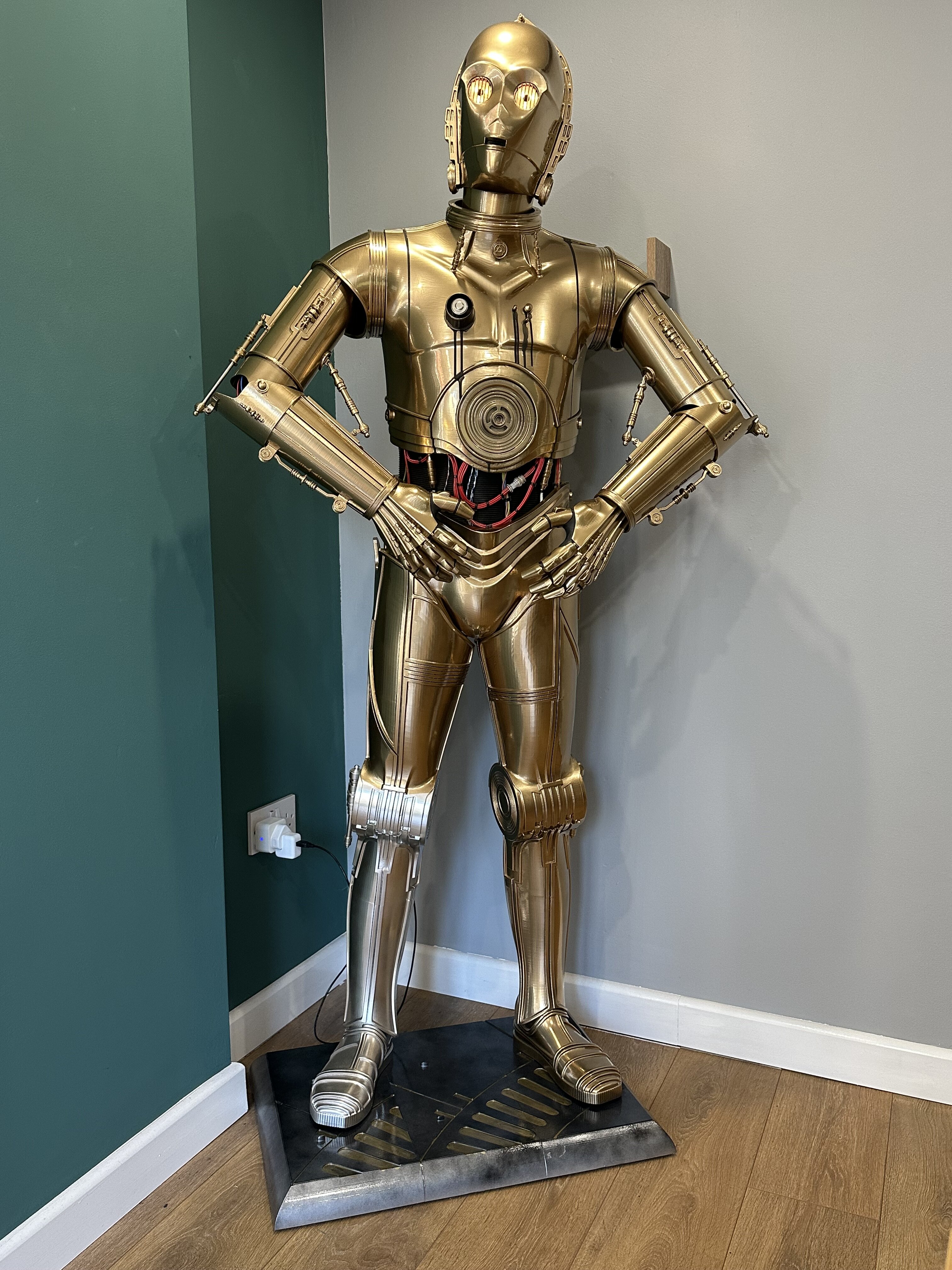

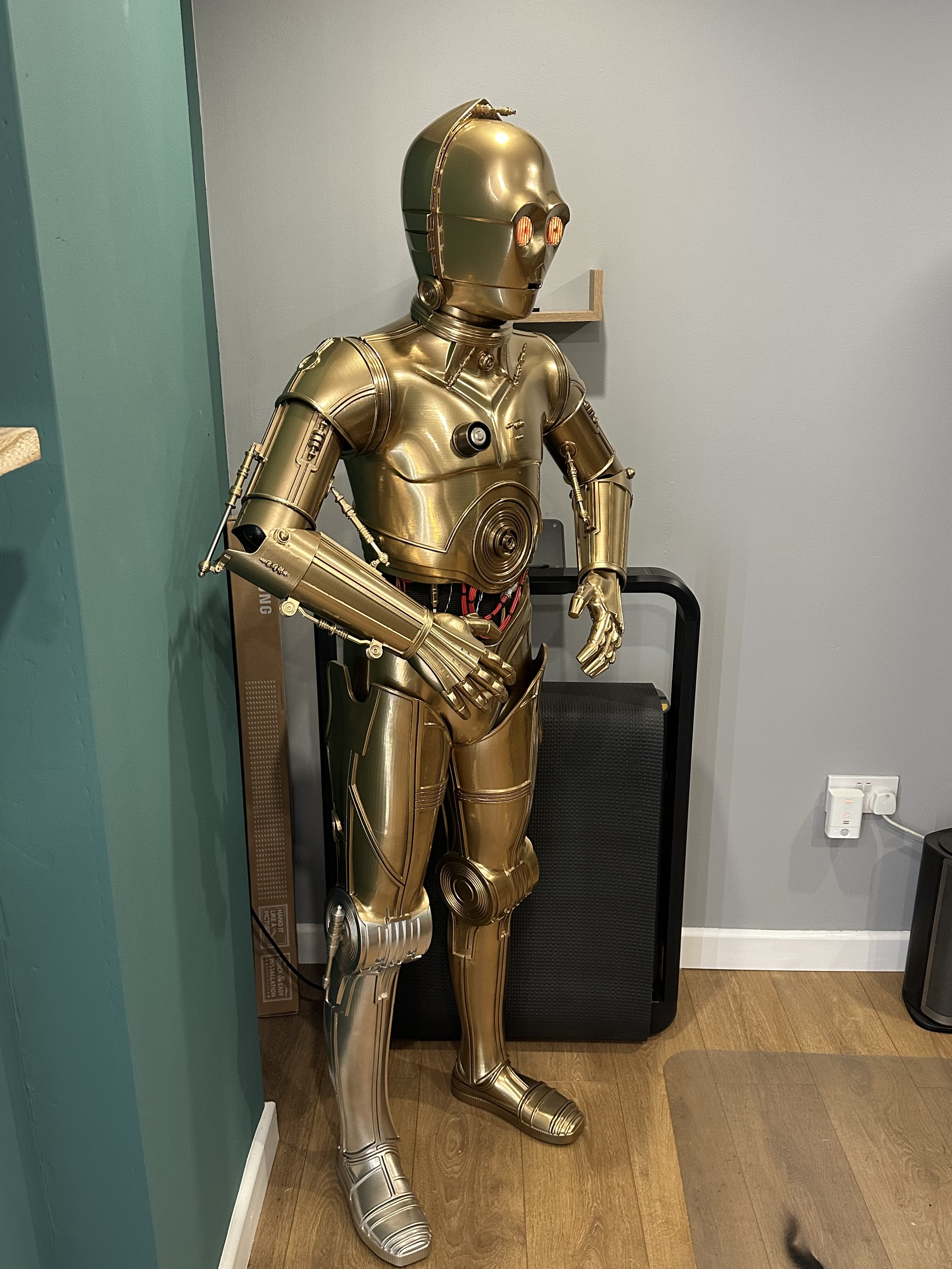

Having recently acquired a 3D printer, this is my first attempt and building a Star Wars droid, so it’s not perfect by any means, but I’m pleased with the result for a first attempt - I probably should have picked something simpler, but it’s been a great learning experience.
I believe that the 3D model files I used were scaled down to 95% to make printing easier - I believe the model is based on the Jesse M C-3PO costume files.
I built a pipe frame skeleton and I’m looking at ways of adding some strength to the model to make taking and re-assembling easier, as it’s been built to be a static display model - has anyone used self-expanding foam for this purpose ?
Currently, he’s not physically attached to the stand, but can support himself and is surprisingly well balanced - I do plan to attach the feet to the base using flange attachments, but haven’t gotten around to this yet.

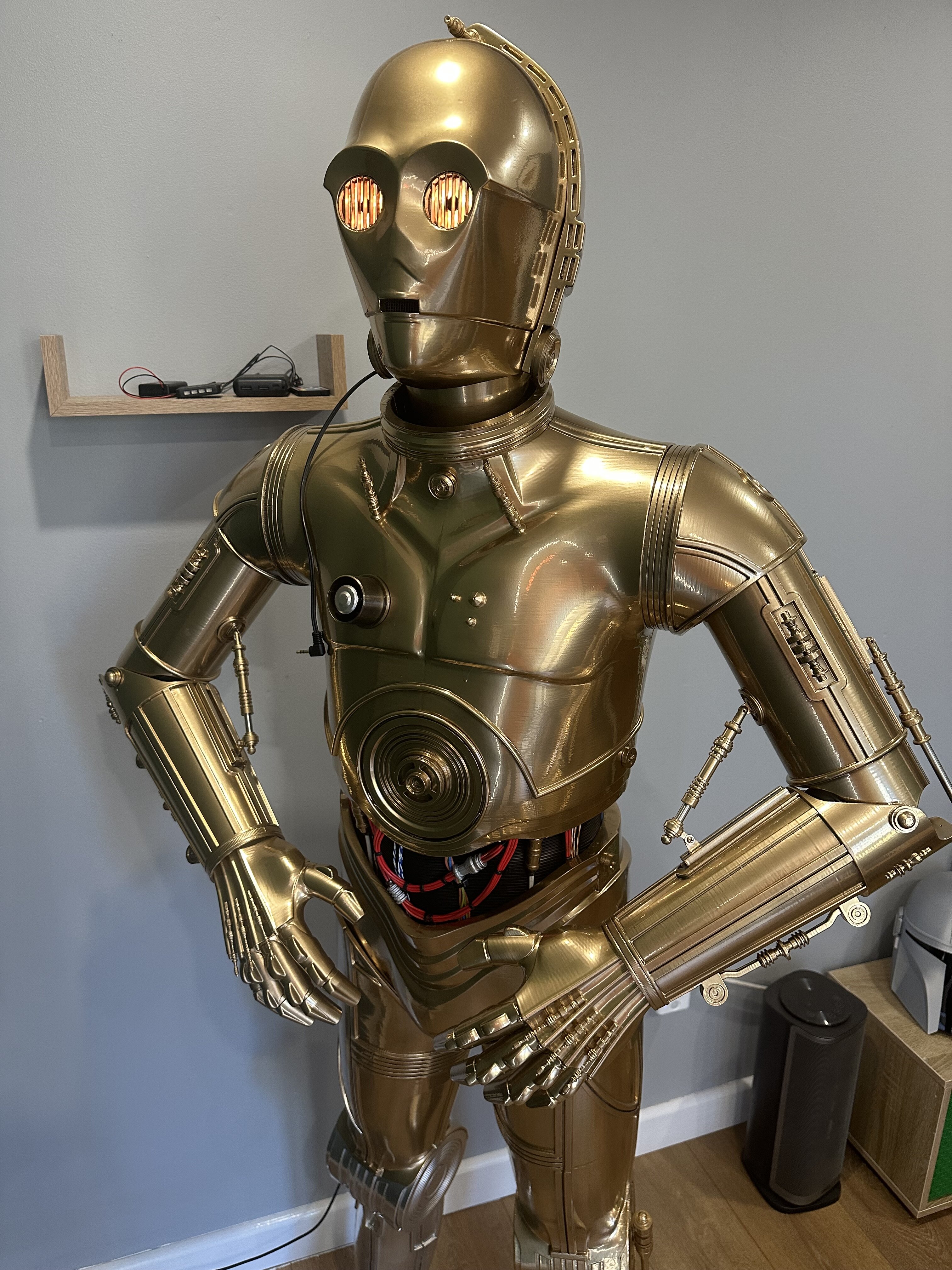

The eyes light up and the colour can be changed using a remote control, as can the LED light under the display stand.

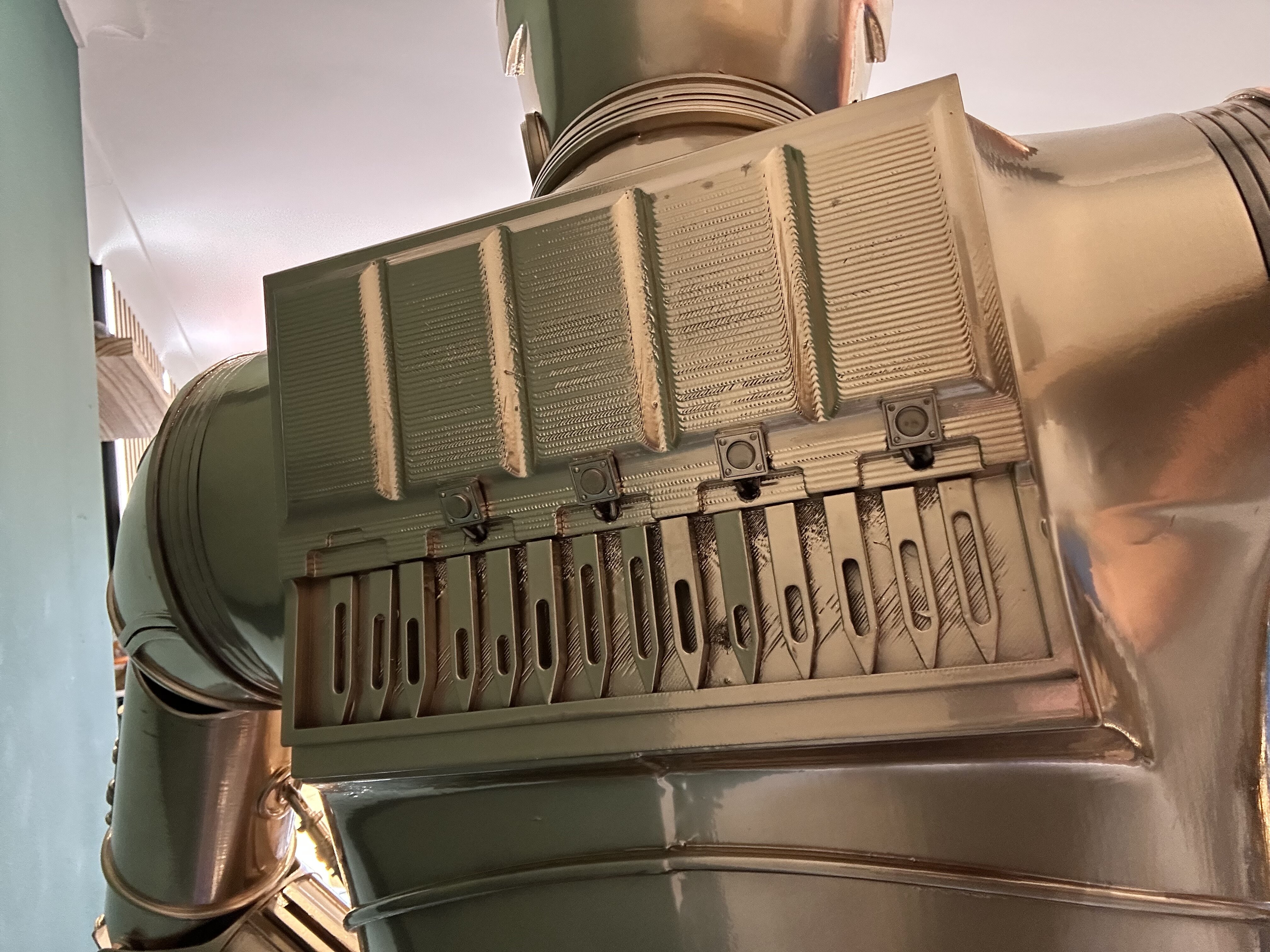

I’ve also added a speaker in his head which connects to a sound effects board and 4 buttons on his back pack (visible in the photos) that play C-3PO quotes, “Hello sir, my name is C-3PO†etc.

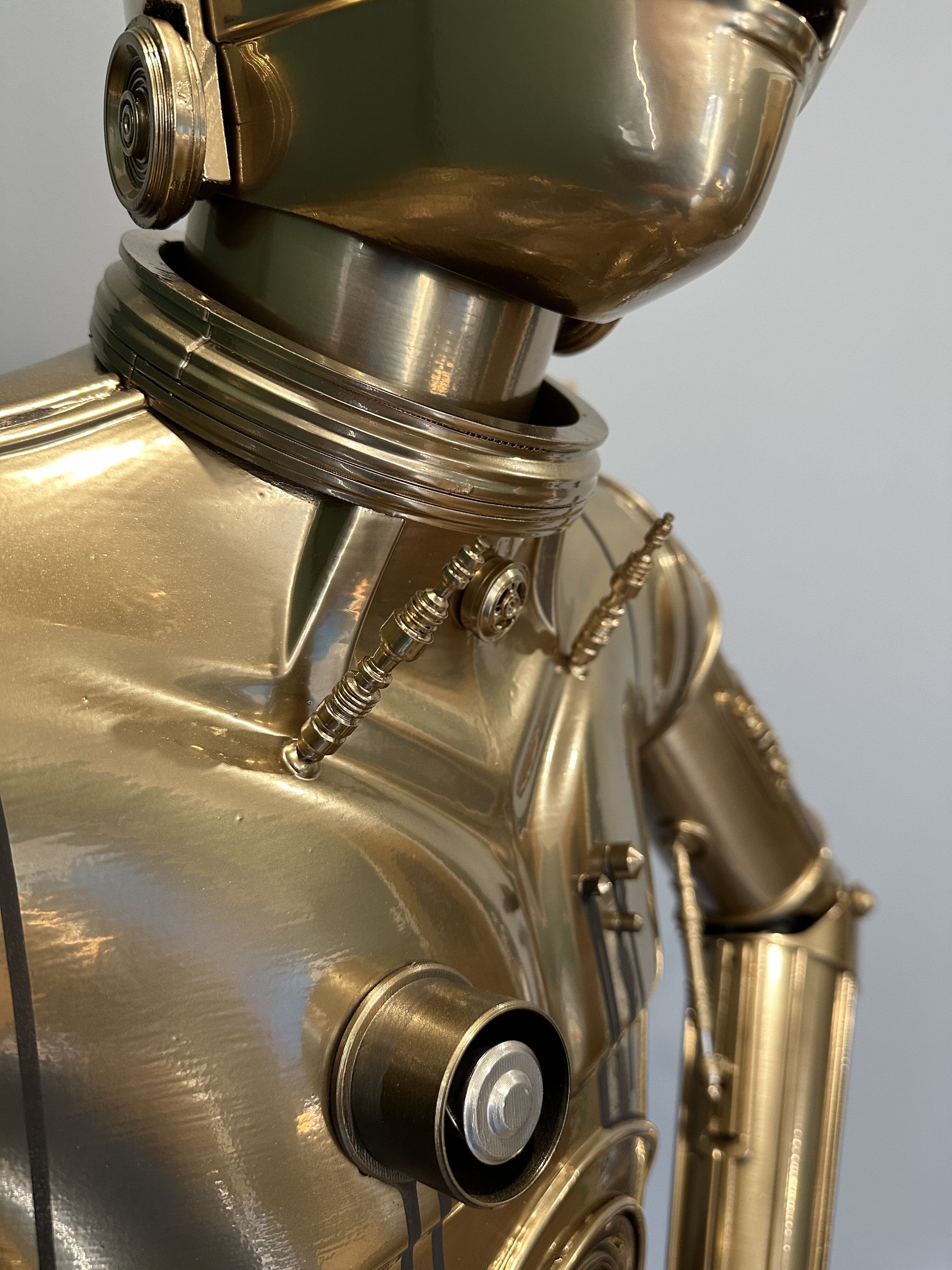

The gold paint is Plasti-Kote, and was applied over a base primer, followed by a gloss black enamel, 2K clear coat, and finally the gold paint.
I’ve had some issues with the paint not 100% curing and even several weeks late it’s still a little prone to finger prints - I suspect I applied it too thick, but that’s down to my inexperience.
Thinking of selling this now to invest in the new Bambu H2D 3D Printer & Laser cutter, so I’d be interested to get peoples thoughts on what I’d likely get if I sold him ?
It’s a difficult thing to value, and whilst materials cost only a few hundred £, it took many hours of work to get it to where it is.
