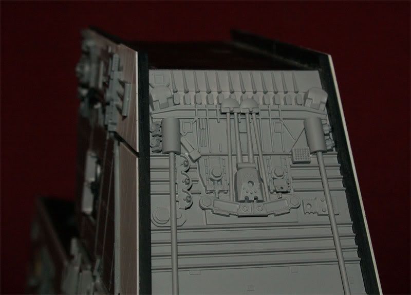

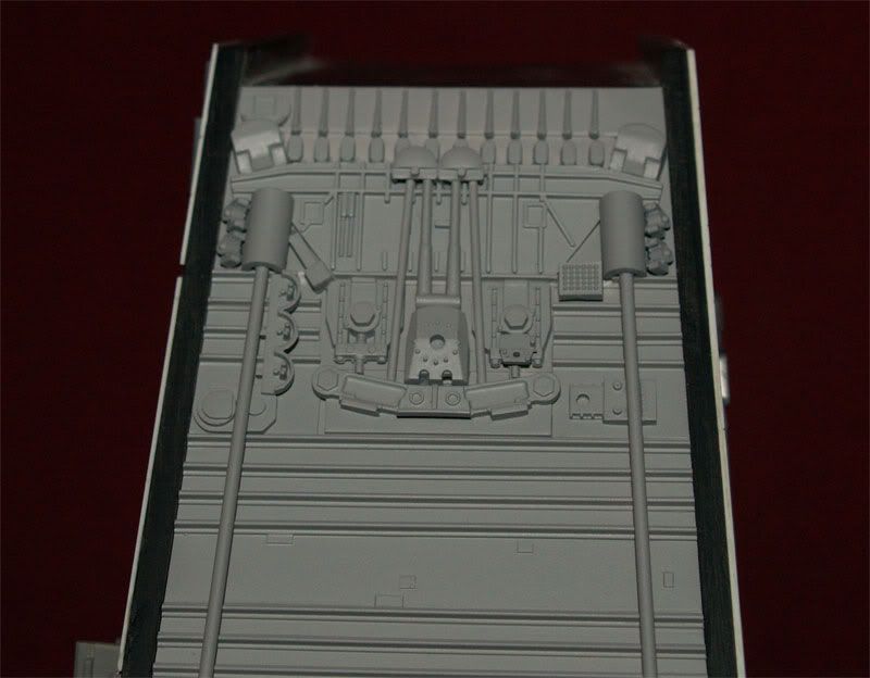

Hey guys,
Ive started to work on the rear bay :

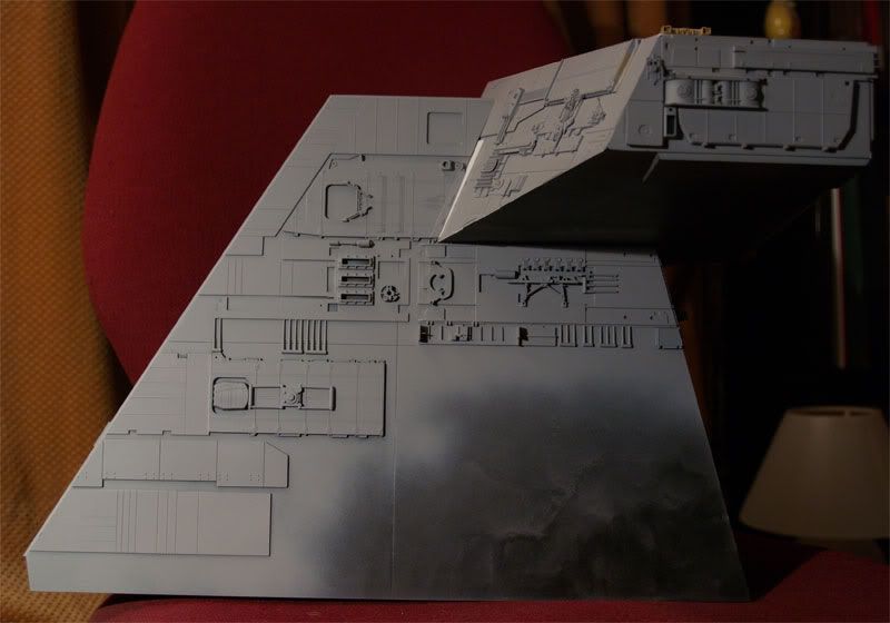

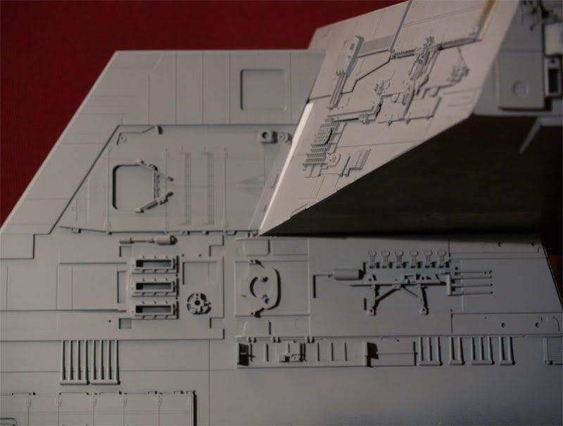

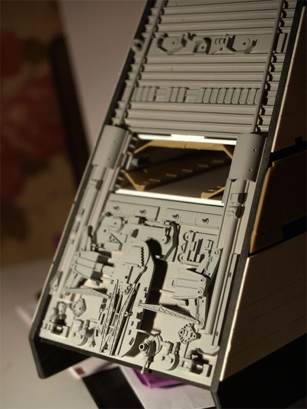

I glued some more details that I ID'd today on the back of the neck
Ive also scratched the top parts, not 100% accurate but it does the trick. I also added some more kitparts I found today :
Thanks for looking !

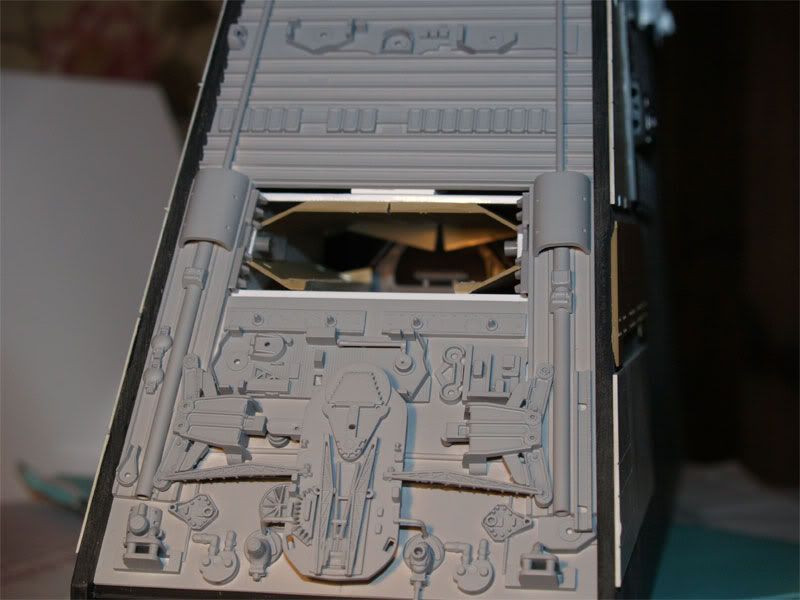

Jay, the neck side plates are 28.8 cm tall. The back of the neck is 2" wide at the top and 3" 1/2 at the base (not the base of the kind of step at the very base of the neck)

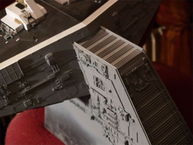

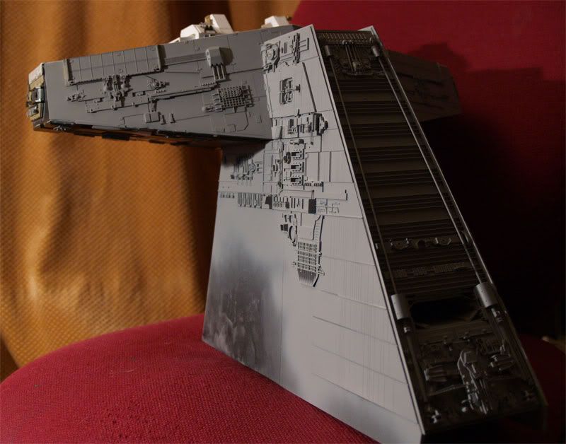

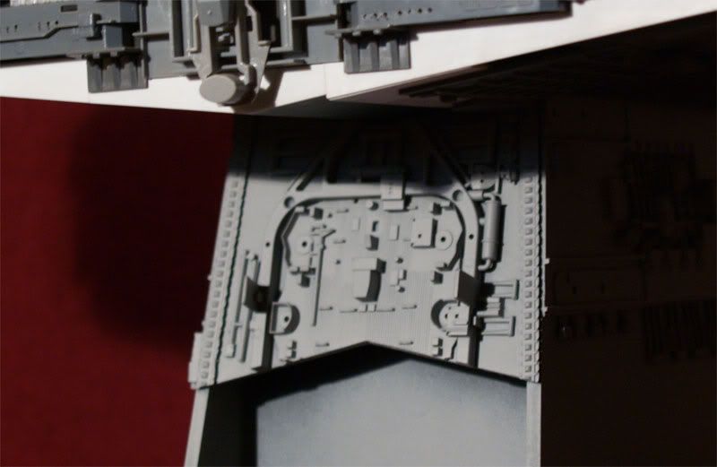

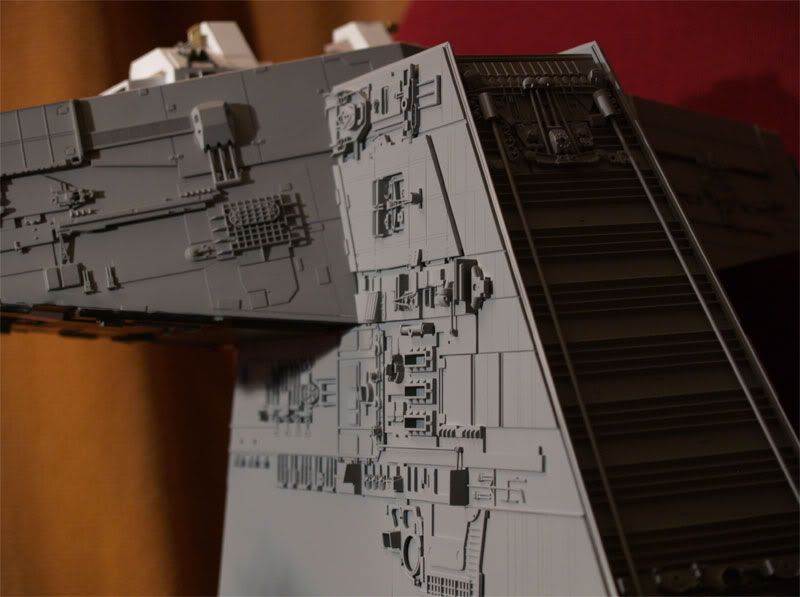

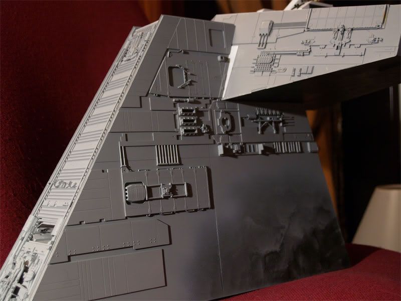

Today I tried to find new parts on the neck sides, I found about 40, not so bad, but there are tiny :( Im still missing 3 or 4 parts but that's not too bad. I built the top of the neck, glued the tee-strips on the edges then I sprayed a coat of primer, here the pics :

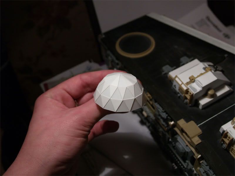

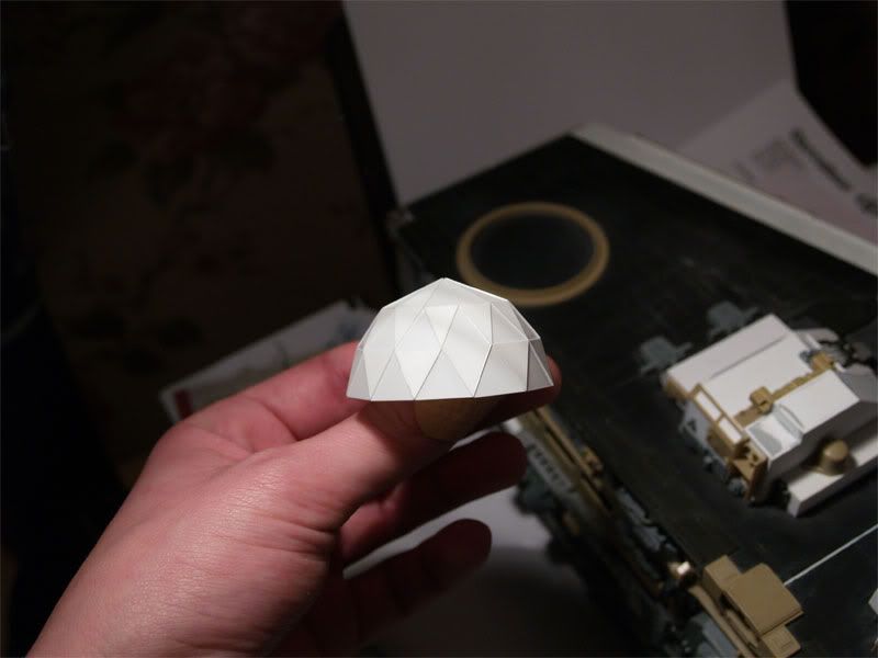

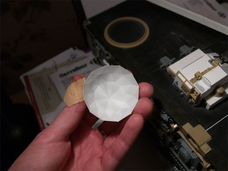

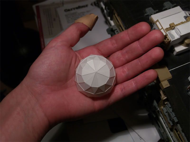

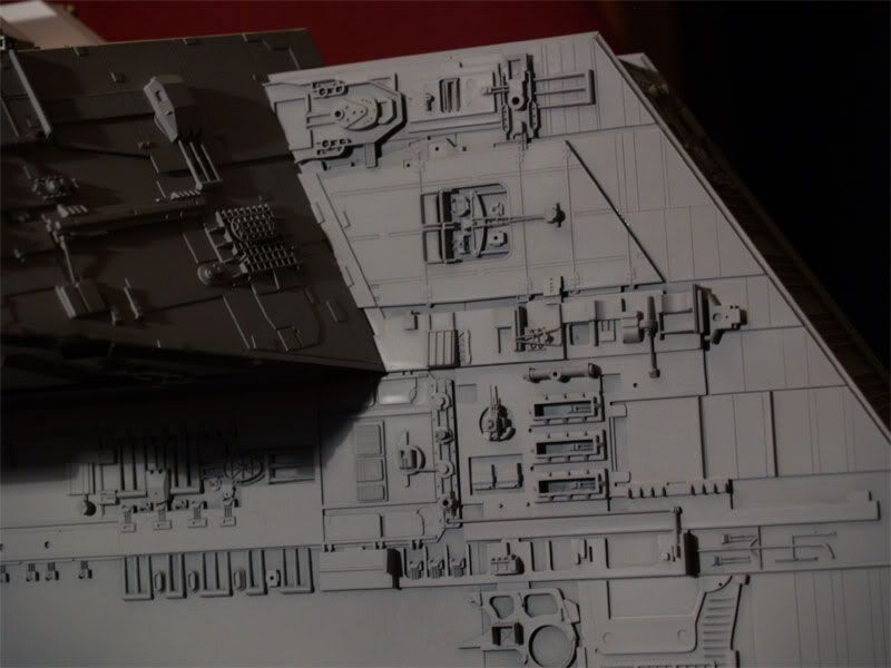

Today, I've started the domes. Well I did just one half, 3 more to build lol
Thanks to Scratchy (Jay) to helped me on that with his files (I did some modifications to them, gonna send them to you Jay). He had a great idea to build one half with only one piece of styrene. Easy and precise (well easy at studio scale, not easy at the scale he's doing his ISD :lol).
Here's the first result, took me 3 hours (needs to be sanded) :
I used very thin styrene (0.3mm), I will do some internal ribs to give it rigidity and the correct shape then I will pour resin once the 2 halves are glued together, it will be very strong. I also build a rotocasting machine today, this way I will be able to get hollow domes for weight purpose...
