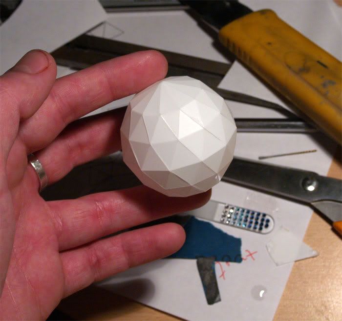

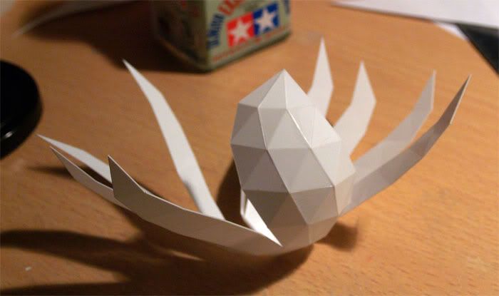

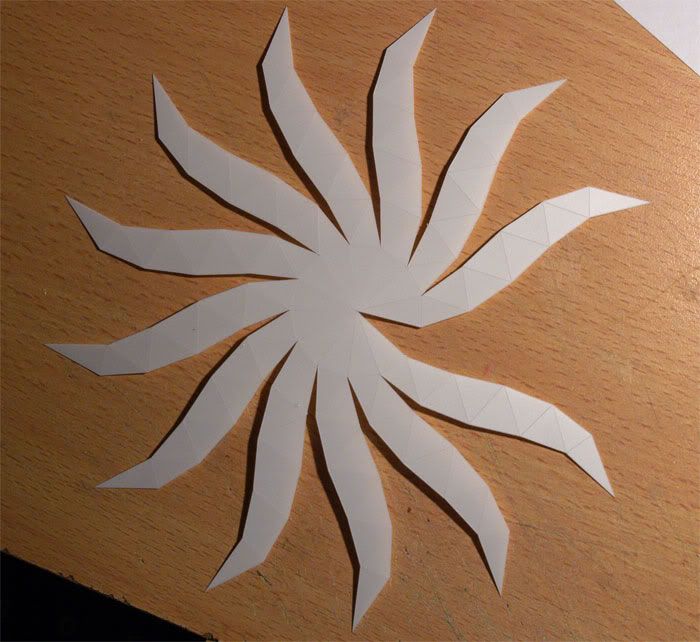

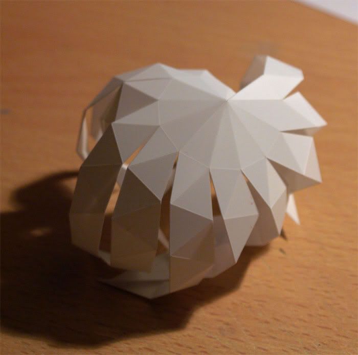

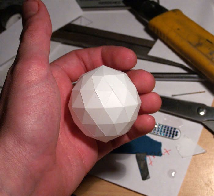

I will show you the process of how I built a dome with one piece of styrene. Unfortunatly, it was not perfect so I will have to go with another way (3D printing ? Probably).

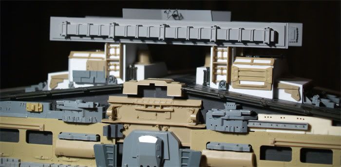

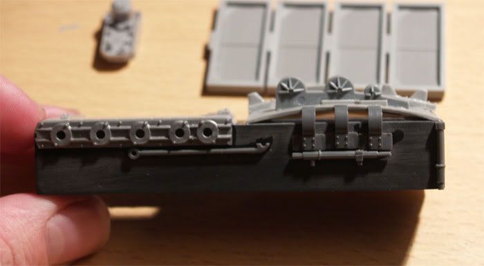

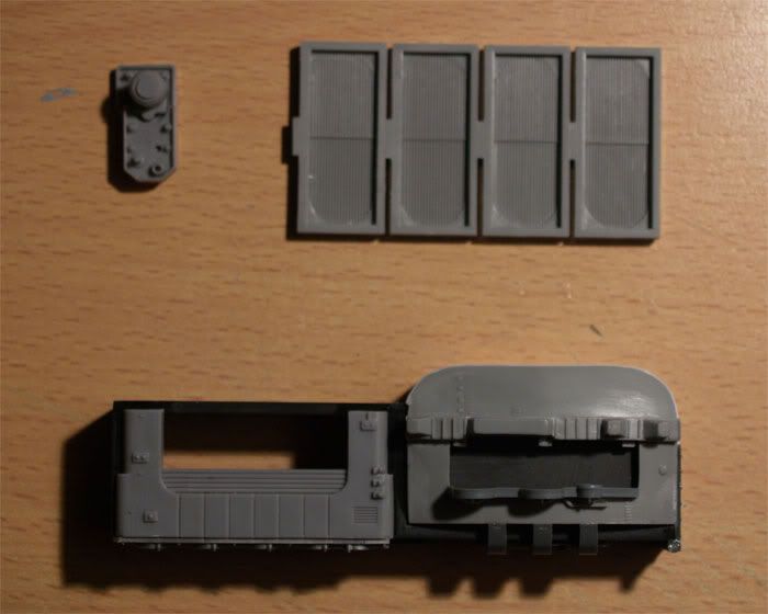

Here some stuff which will detail the main hangar bay :
I've read somewhere that the kind of rails of the main hangar bay were from a loco kit. Actually those are every black pvc half round and H rods with half styrene disks. It can be seen on a pic of Fulmer building the hangar and it's easy to notice that those pieces are not evenly cut and glued (there are a ton to build, they could have cast the parts ! I will :$).

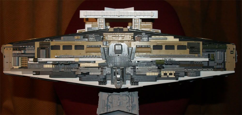

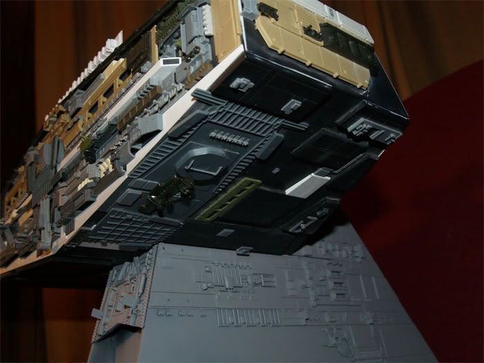

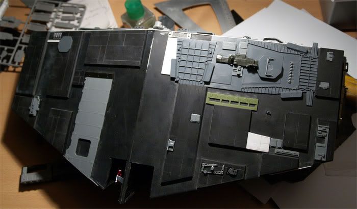

Ive also worked on the underside of the bridge which is almost done. I did some cool find !

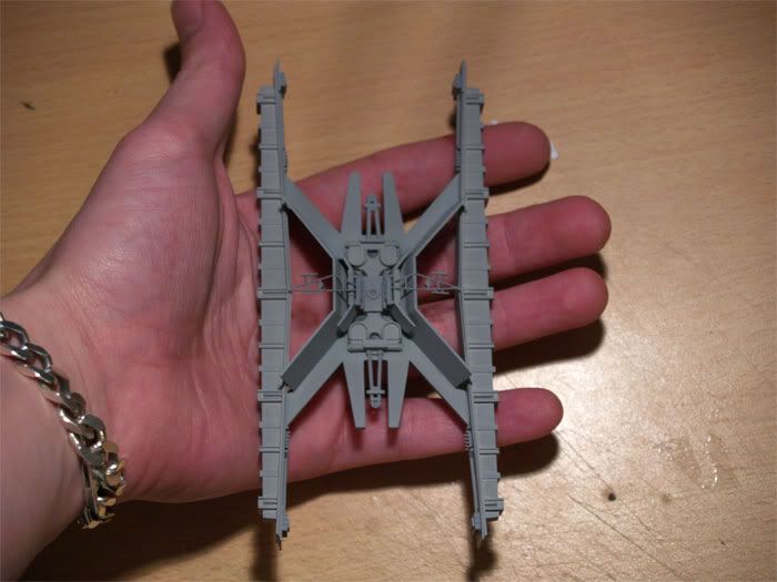

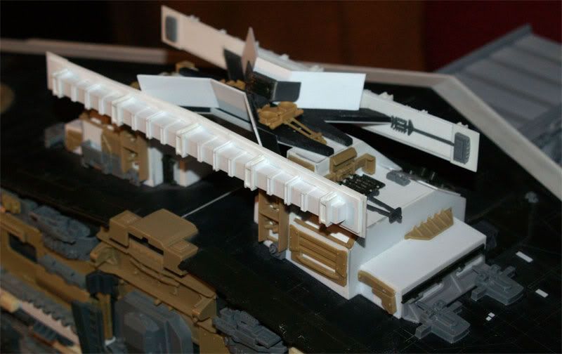

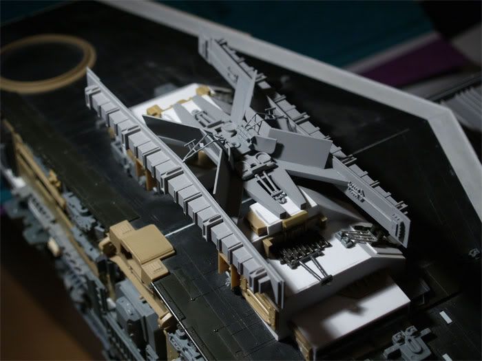

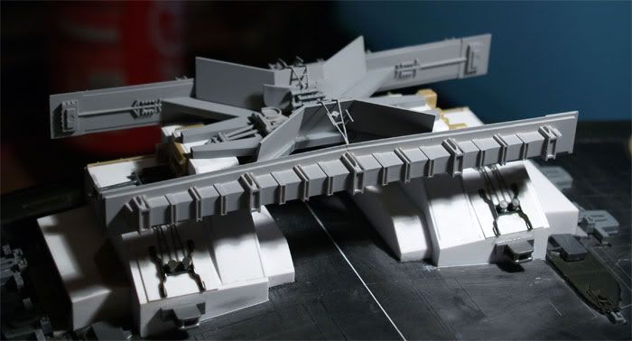

I worked on the X array, it's also almost done, some minor details to add :
Thanks for looking !

I like what you did with the dome, adding the top and bottom to one pattern, good idea!. You said you ran into some problems, can I ask what were they?

Thanks Taz, I bought some months ago crystals but the faces are not perfectly done :( The ones on your site looks better, unfortunatly they is not the size I need (2" diameter)
Jay, there are some misalignement (about 1/10 of millimeter but that's enough) between the triangle faces when I glue them. I cant do better :(
Gonna try to get them 3D printed as this is the only way to get something perfect (because even with stock crystals, you're not sure you've got a 100 accurate dome because of the proportion of the triangles which can be slightly different from a manufacturer to another).
