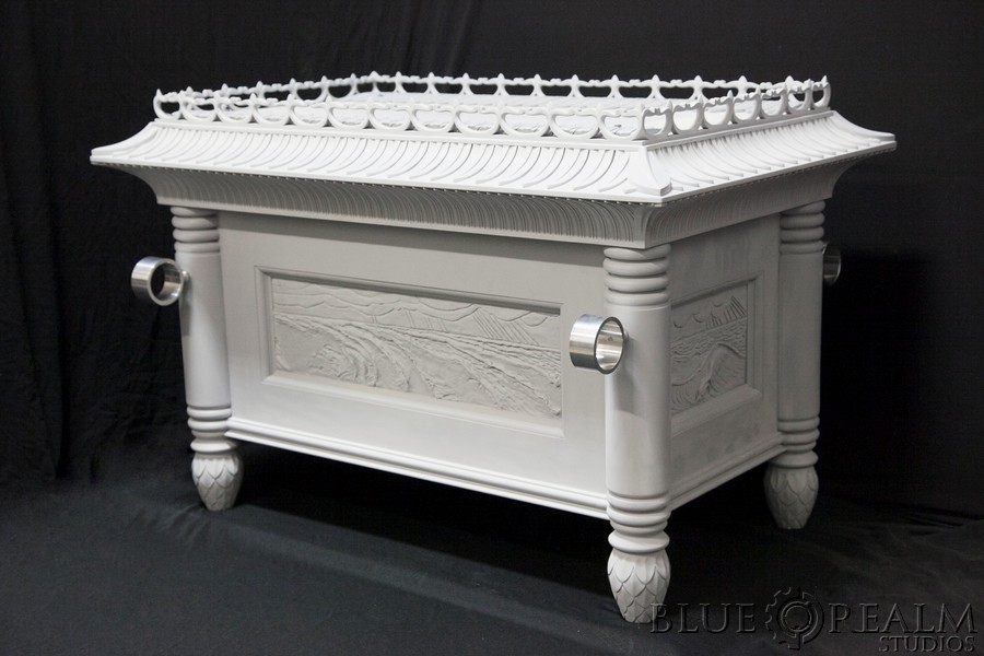

A finished kit

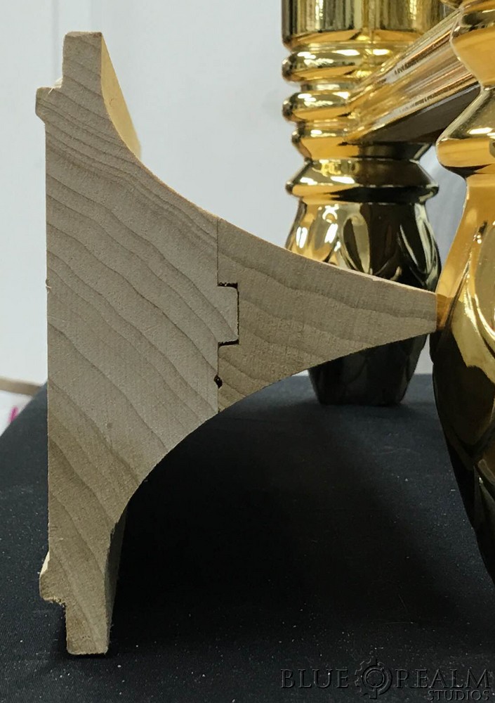

Here's the cast parts in the kit.

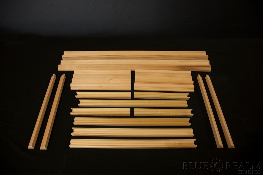

Here's the custom milled wood trim parts

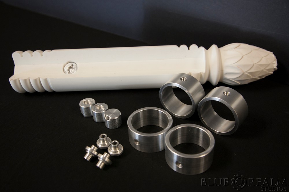

Here's the aluminum lifting ring parts.

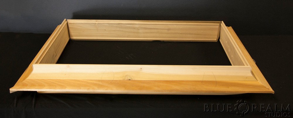

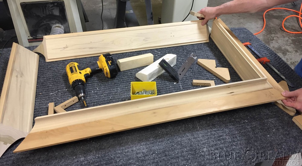

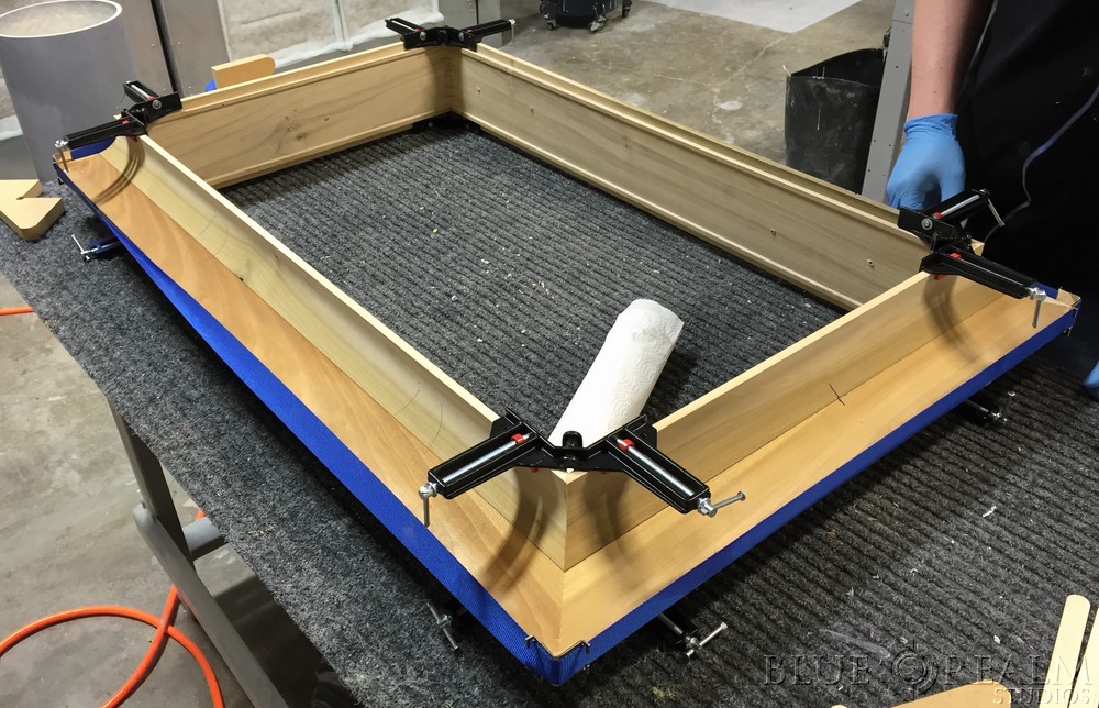

Assembly starts with the very large wood double-cove profiles that make the frame for the top. You will receive 4 pieces that are already mitered for assembly.
You can see that we use a long band clamp and corner clamps to join it together. You can user your 1/2" MDF that becomes the bottom of the lid and assemble the four lid pieces with it in place to hold your parts square. Just don't glue it in yet. Be sure and check that your pieces are square with diagonal measuring during assembly. We use a special inside corner nail gun for this but you can use glued wood blocks or screwed metal corner brackets attached inside the corners. You will need something to stiffen the joint since you can't rely on just glue for the miters. Since they miters are HUGE, the joints may not be perfect. Do the best job you can getting them close in a dry fit so you can see what you're up against. This is a large and stressful glue-up even for an experienced woodworker. Be sure and get an assistant to help you. You'll want to use epoxy in the miters instead of wood glue. Don't try to use a 5 minute version. Get something that's longer and do two on one end first, then the other two. Use blue painters tape to prevent the gaps from leaking and don't worry about squeeze out as you'll be sanding them anyway and the joints don't show on the finished ark.
Here's the orientation of the lid profile pieces showing which side is up.

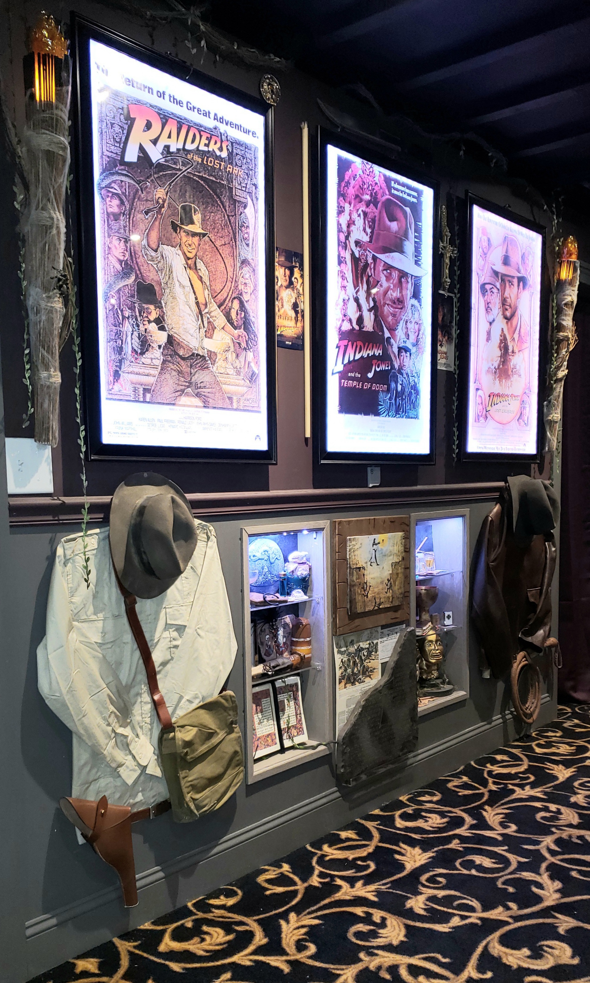

What if I only needed certain pieces? Is that something that could be ordered? I was thinking of making a shelf for my Indiana Jones section out of just the lid. Standard lid length but only about 4" to 6" deep. Is that a possibility? Basically i want to put the shelf under my posters to hold more props.. I'd order the whole ark if I could afford it. Sadly my wife would probably divorce me. Lol. Anyways, let me know.
