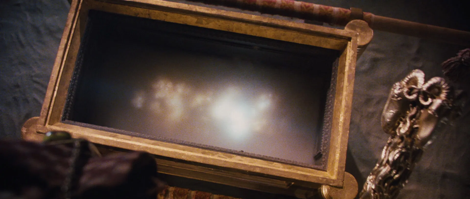

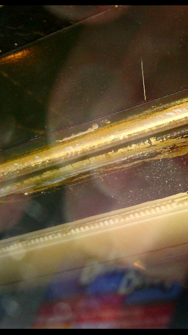

I asked some time back if the interior trim was included to which Philip replied, "Yes", but I think my question was not fully understood. I'm guessing nobody has attempted to finish the inside as it is seen in the film, which includes added wood support angled at the top and trim bordering the reliefs on the inside and trip which goes along the interior rim. I was able to get a pic of this trim from the hollow bottom when the Ark was here in Chicago some time back.

Agent5, good questions to increase the accuracy of this kit. The original box and corner legs (not the sculpted feet) were definitely wood. Not sure about the undercarriage of the lid, but all sculpted parts appear to be cast fiberglass/resin. I always assumed the gold metalized finish was shiny at first and just treated with dulling spray and aged with airbrushed thinned paint washes. And I too always wondered about the interior moldings inside the box top edge and around the backs of the side reliefs. This is the only shot from the film that shows it. Is it just smaller leaves similar to those on the lid?
Agent5, good questions to increase the accuracy of this kit. The original box and corner legs (not the sculpted feet) were definitely wood. Not sure about the undercarriage of the lid, but all sculpted parts appear to be cast fiberglass/resin. I always assumed the gold metalized finish was shiny at first and just treated with dulling spray and aged with airbrushed thinned paint washes. And I too always wondered about that interior moldings inside the box top edge and around the backs of the side reliefs. This is the only shot from the film that shows it. Is it just smaller leaves similar to those on the lid?
Its just a small (guessing 1/2" wide repeating pattern of half-moons going along the bottom interior. Not sure about the pic we see above. When I get home from work I'll post a pic. The pics are old and poor quality but still useful.
K. Here’s the pic of the mounding around the reliefs.

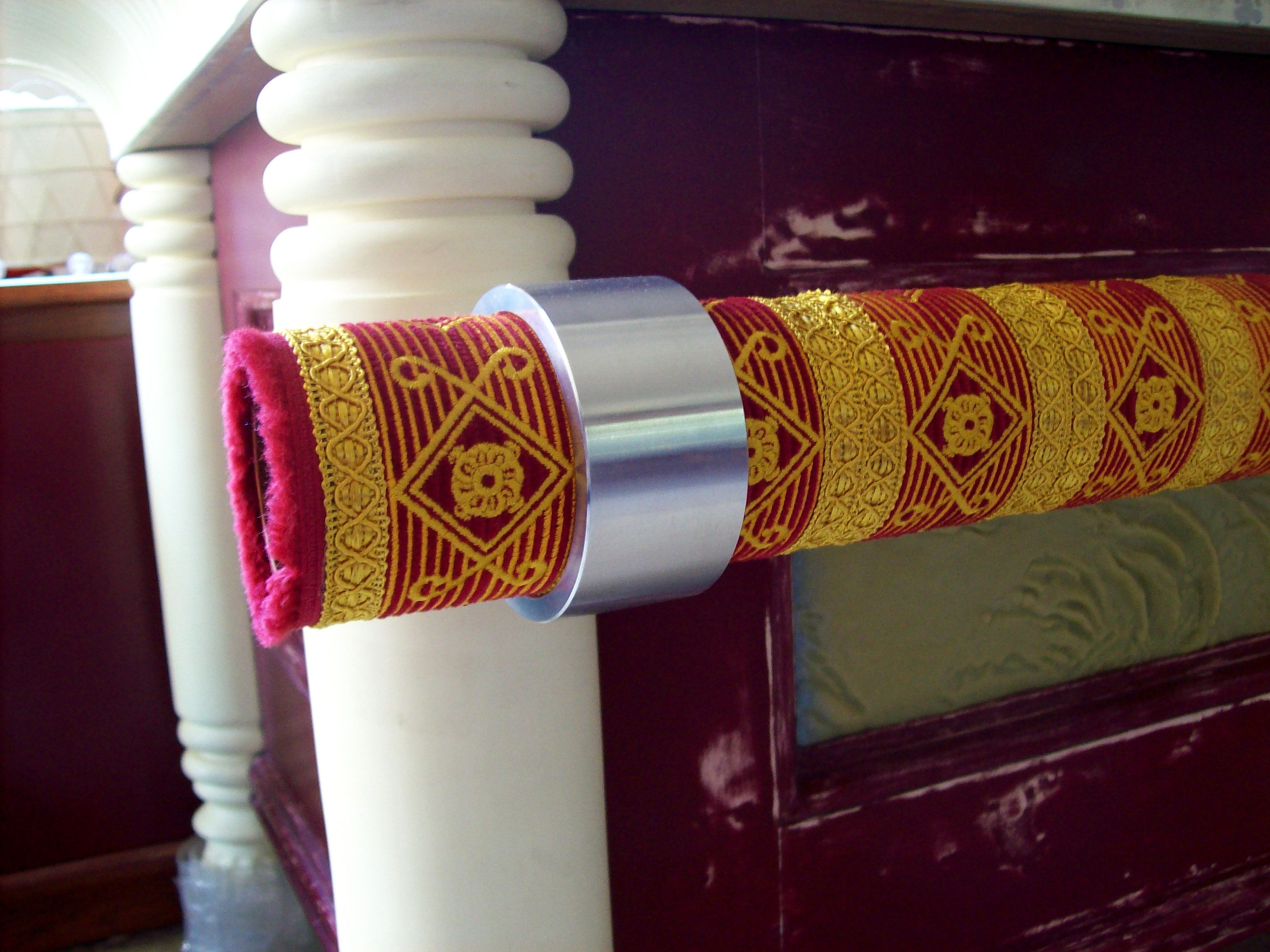

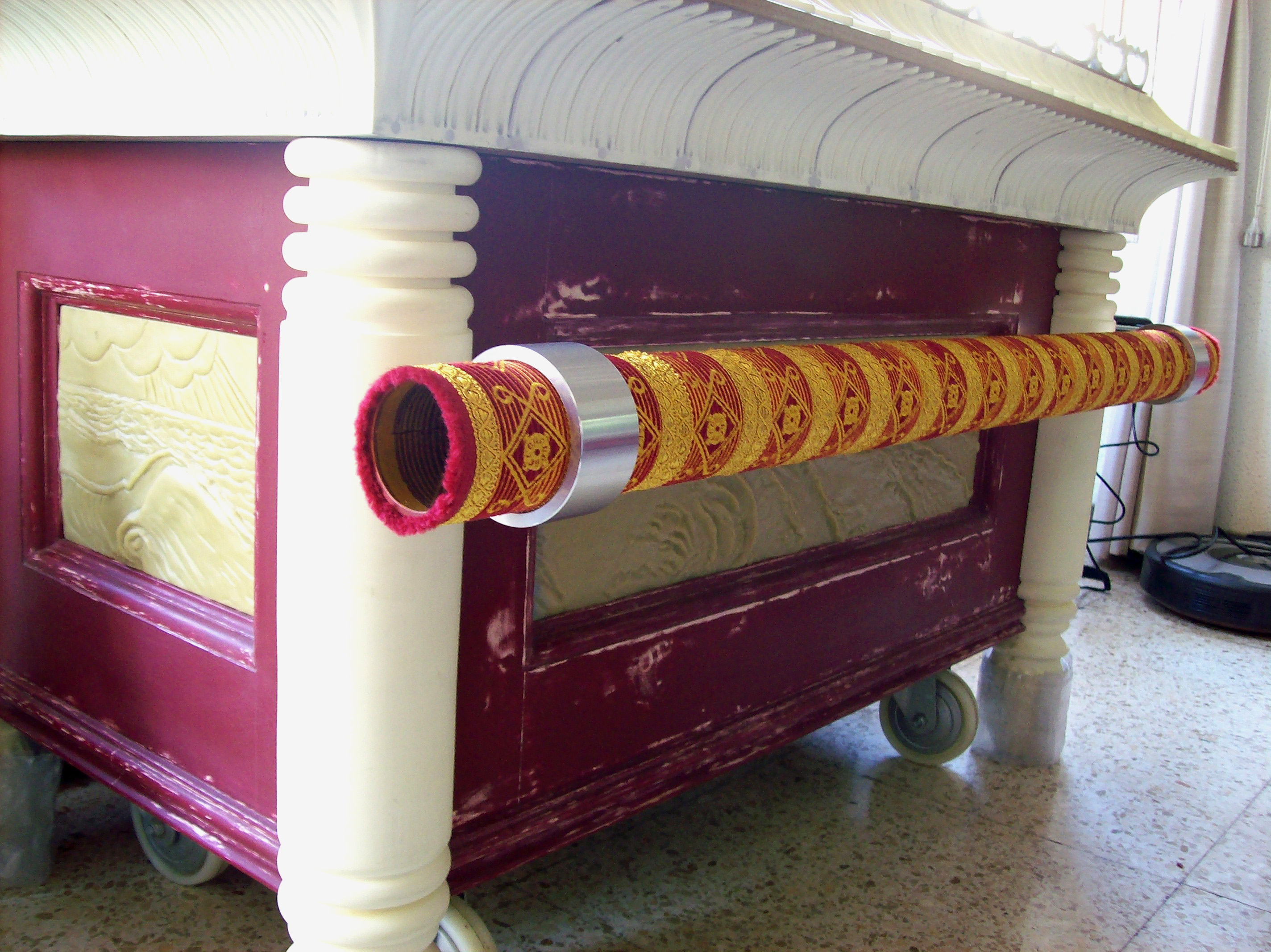

Hi everyone.
I have made my own embroidered covers for the Ark poles, but they are quite difficult to fit into the rings due to the thickness of the fabric.
My plan is to print my own rings ( with a slightly larger inner diameter to solve the problem ). They will only be for aesthetic purposes ( since the Ark will never be lifted using the poles, I don't want to risk the resin legs breaking due to the weight of the Ark ).
I need to purchase four threaded rods exactly the same as those that came with the original rings.
I have tried to screw an M8 nut but it does not fit ...
Does anyone know the thread pitch of these rods ( to make sure they will thread into the metal inserts on the Ark legs )?
Thank you very much.

Hi everyone.
Are you asking what the thread size is in my kits? If so, they are 5/16" x 18 TPI.
Yes thanks.
Are they easy to find? ( Since I live in Spain, and here we use the metric system ) ...
Yes thanks. Are they easy to get? ( Since I live in Spain, and here we use the metric system ) ...
They are easy to find here. email me and we can see about sending you some.
You’re such a helpful fella Phillip. Thank you for being an asset to this community. Rebelscum is also a great place to find info, and converse with other collectors, so thanks for that place as well.
