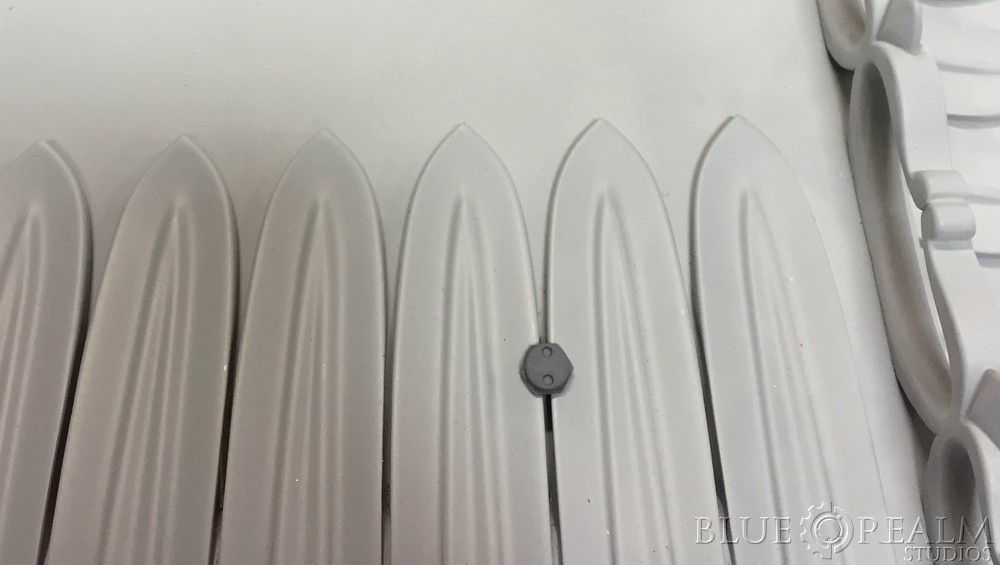

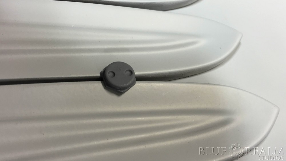

The flat top leaves
The flat top leaves are left separate because if you are using the spray chrome process and they are attached to the top, it's easy for impurities to run out from under them if they are not completely sealed on the edges. It isn't really possible to completely seal them to the top. This isn't a problem for you if you are painting it yourself.

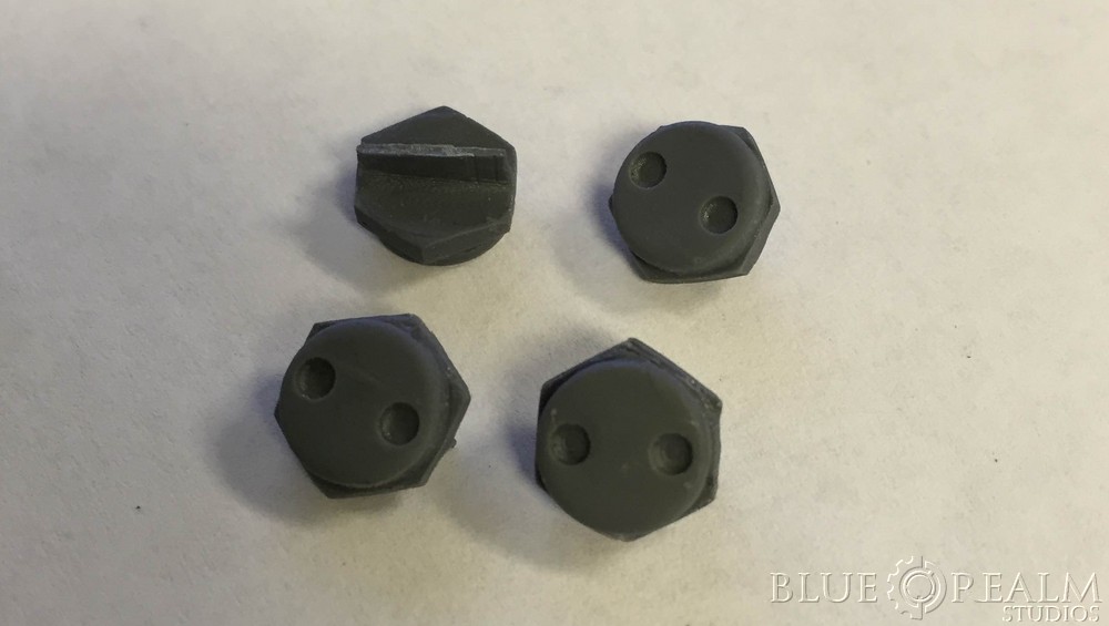

On the prop there are two attachement devices that appear to be holding the leaves down to the top. It's unkown what they are so we modeled them and are providing cast pieces. These are also not shiny gold, and appear to be rattle can gold. You can use these to cover screws that you use to hold down the leaves, or they can just be decorative if you glue your leaves down after they are chromed. Your choice.

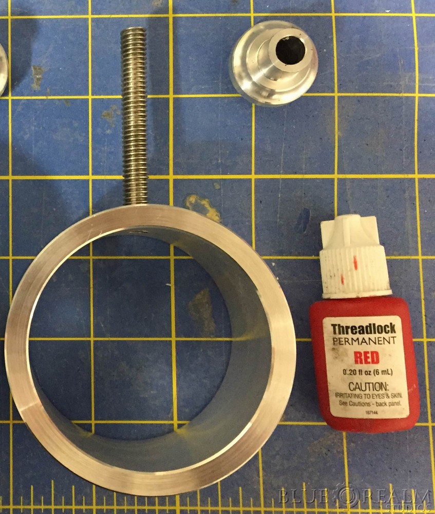

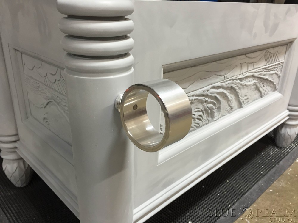

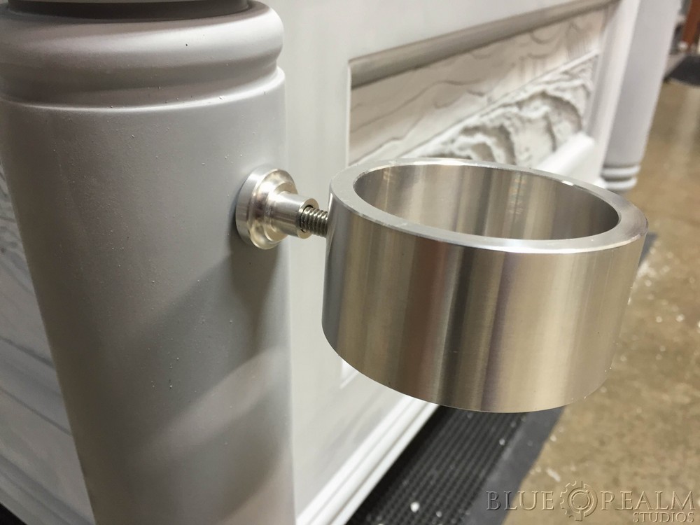

The lifting rings
The rings will come with the threaded rod ready to put in screw in place. Each leg comes with an internal machined aluminum "nut" that you'll screw your lifting ring into after you put the escutcheon on the threaded rod.
We use red Loctite to fix the threaded rod to the ring. Once you have test fit your ring to each leg, you can either leave them there, or secure them with Loctite as well. I would suggest if you intend to lift it with poles through rings, you secure it in this manner. Since I have never lifted my Ark with poles, I haven't secured mine, so I don't know for a fact they will stay fixed when lifting it. If they do not, then I'd suggest securing them with epoxy in the hole in addition to the red Loctite.
Note, that on the Ark prop, these pieces are not plated with the same shiny gold the Ark is. The finish appears to be just a sprayed rattle can gold paint.
Just read this thread all the way through and thought I would answer your question as to what the 4 machined pieces are on the top of the lid between the leaves. The version touring is the stunt Ark and holes were drilled through the lid to fit wire through for the FX shot when the Ark lid comes crashing down from the heavens. Also the reason the bottom is hollow. The 4 pieces were most likely screws (or similar) of some kid to fill in the holes and not supposed to be part of the original piece. It made me laugh though as the attention to detail on this piece in other worldly and it seemed very fitting they were included.
