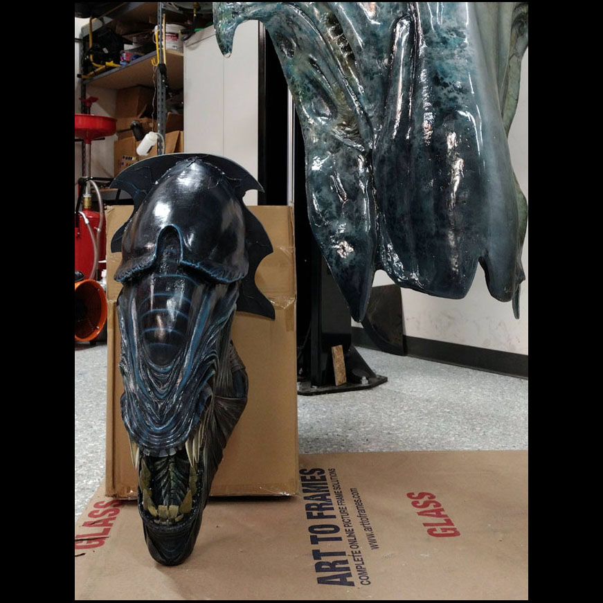

And now the test fit is a lot more accurate. Although the depth of the jaw will necessitate pushing the lower part of the crown about 12" off the wall. I have some ideas on how to do that, but it would be important to double-check the security of the hanging wire.

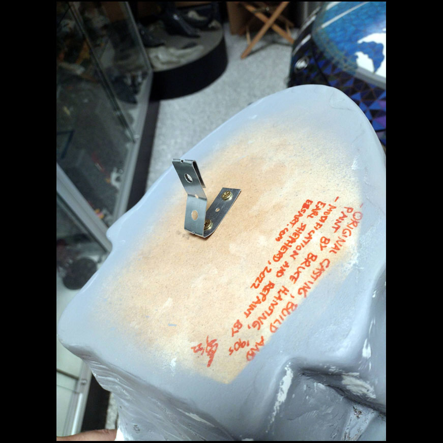

Then I signed it, WAY prematurely. Traditionally I would never sign before completion. But it forces my hand to finish the job, and also I wanted to document that it was Bruce's work, revised by me, so there would be no confusion in the future. And I wanted to leave the original MDF visually exposed where it won't be seen because I like seeing the original materials when possible. I then sealed it with some Liquitex Gloss Medium (NOT High Gloss Varnish) because the medium will make it impenetrable to moisture but will allow gases to pass. This will ensure that there is no future buckling of that board from dissimilar moisture levels and also no bubbling if the interior fiberglass continues to offgas.

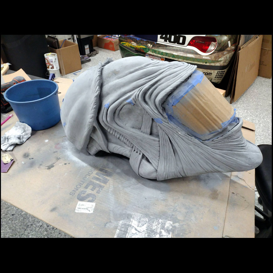

After priming I noticed a lot more, smaller, defects. This led to a lot of time spent with various files and nippers cutting and shaving away unwanted distractions. As example, this recess between lip bulges, before:
And after:
That was just the first little area I attacked, quite a few hours of nitpicking followed. Here is a pic of the side of the jaw.

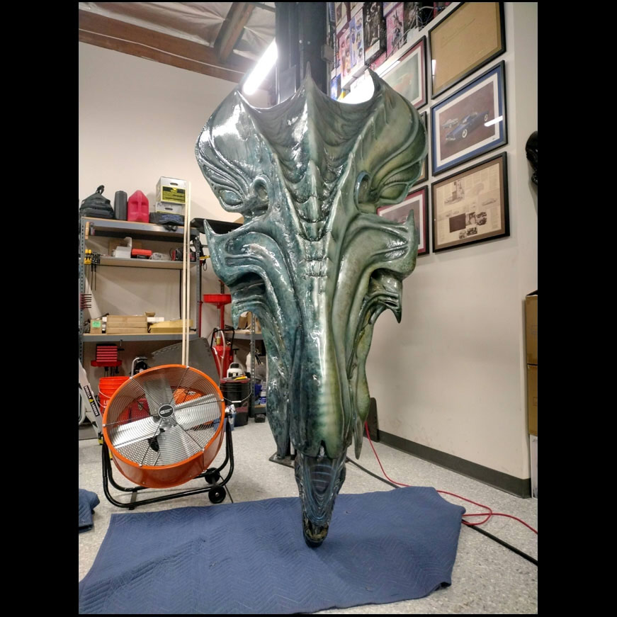

Oh, and a wide shot of the crown in place, for those that didn't wade through the other thread. (and my poor half-naked gun wall, I need to get stuff back up!)

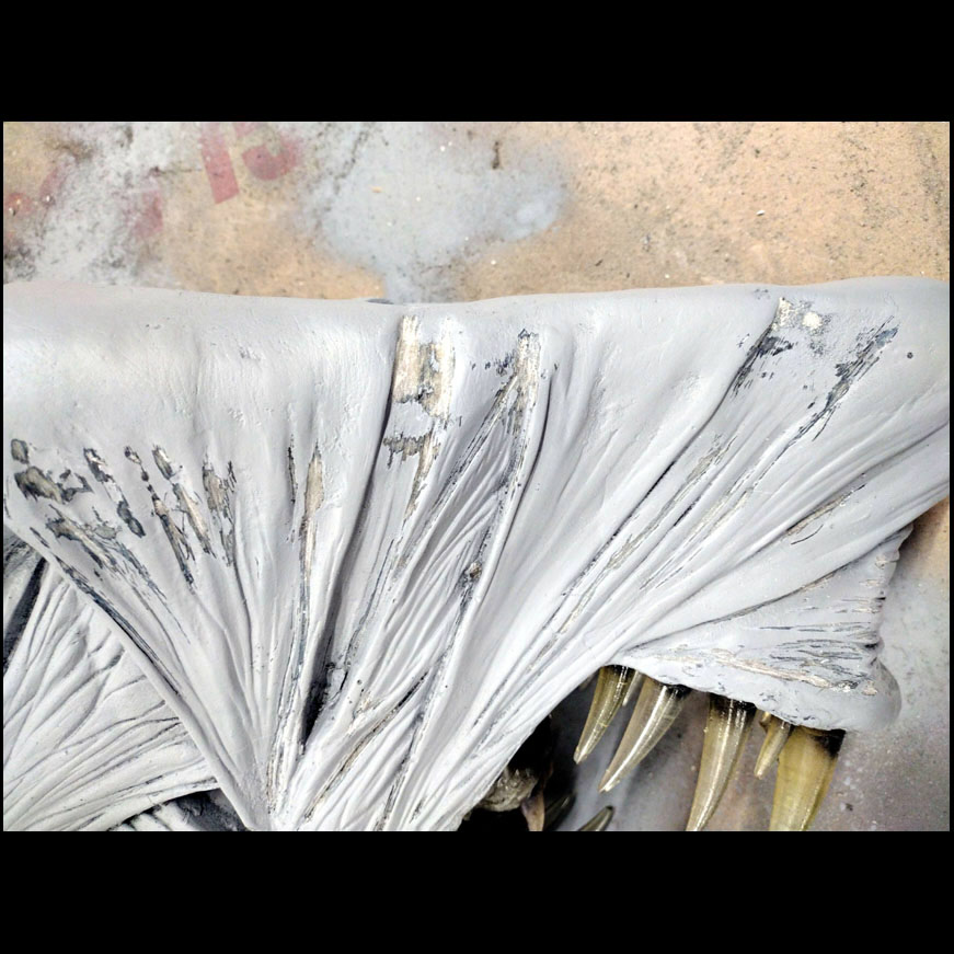

From the front all that was needed was a little in the chin creases and a lot under the crown lip. That internal area was pretty much unfinished, and a few spots were knobby enough that even painted black the highlights would be distracting. So I'm smoothing over the area and will make any residual distractions disappear with paint.

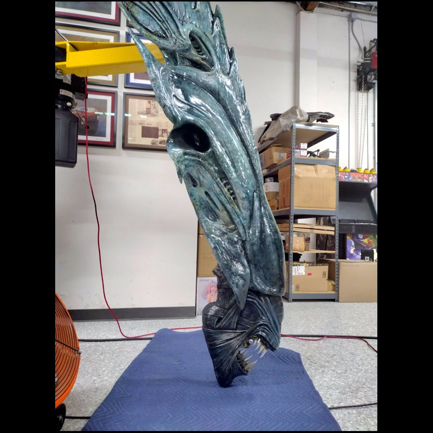

To help answer this question I got myself a helper to hold the head roughly in place (the leading edge of the head's crown nestles under the leading edge of the ADI crown). I have mixed feelings.
From the side it looks like it belongs there. The angle is not quite right, but I don't want to set the crown off the wall any farther, so let's assume for now this is their relationship.
From 3/4 angles it looks great.
