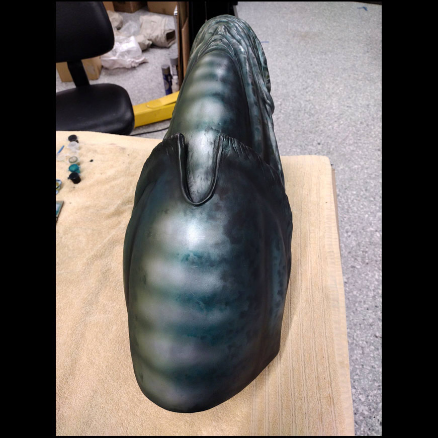

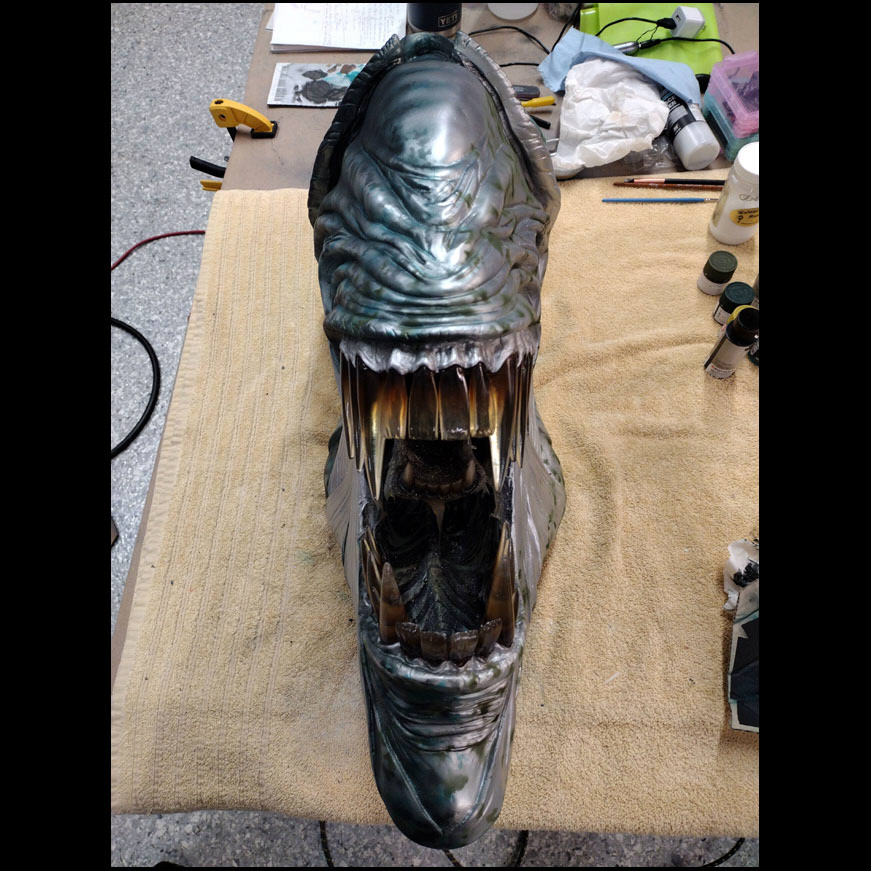

Monday, FINALLY getting back to work on the Hansing head. Beginning to paint the colors!
Thinking that following the same basic process as the crown should yield similar results. Except that the head has more variety of details that these will need to be painted differently. So I'll figure that out as I go. First, as a baseline, I want to re-create the crown colorations from the crown of the crown to the crown of the head. That way I can use it as reference as I alter the colors on the face.
First, aqua, using the same splotch masks that I made for the crown.
Then dark aqua, splotches and shading.
Short day, so that's all. But a good start, I think. Here is a pic as close as I could comfortably get it to the crown and still take a picture. More depth will come with additional colors and clearcoating, but it's in the ballpark. So a good first day.

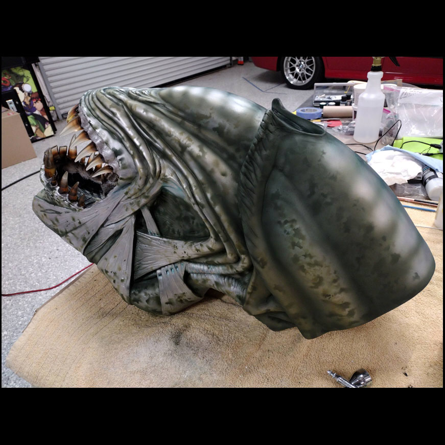

Blue side:
Green side:

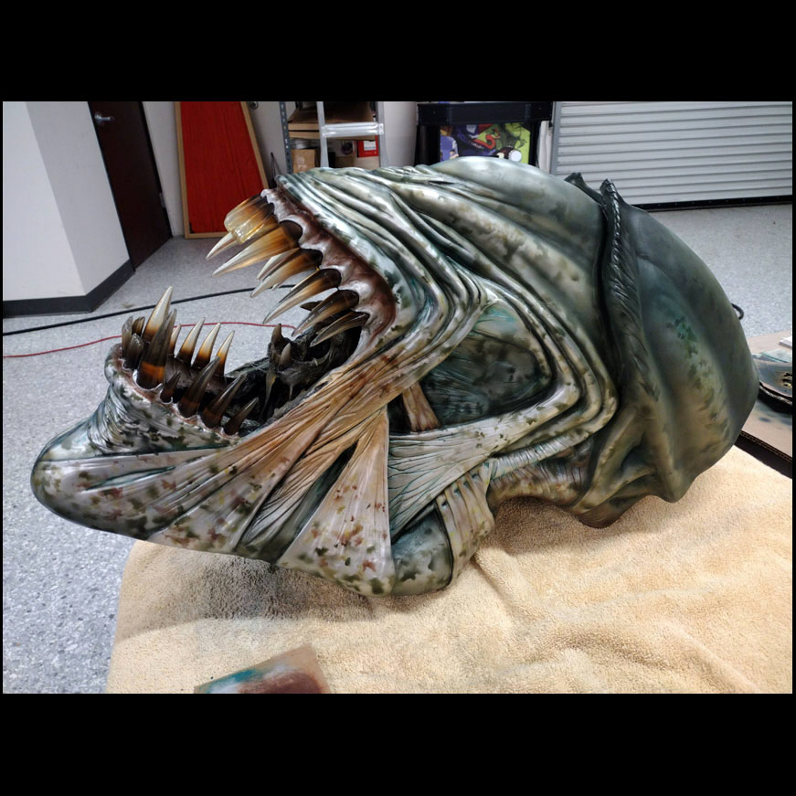

Sorry it's been a while since the last update. Been too busy to process pics, but in a way that's a good thing.

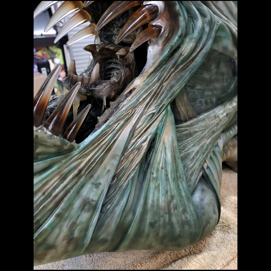

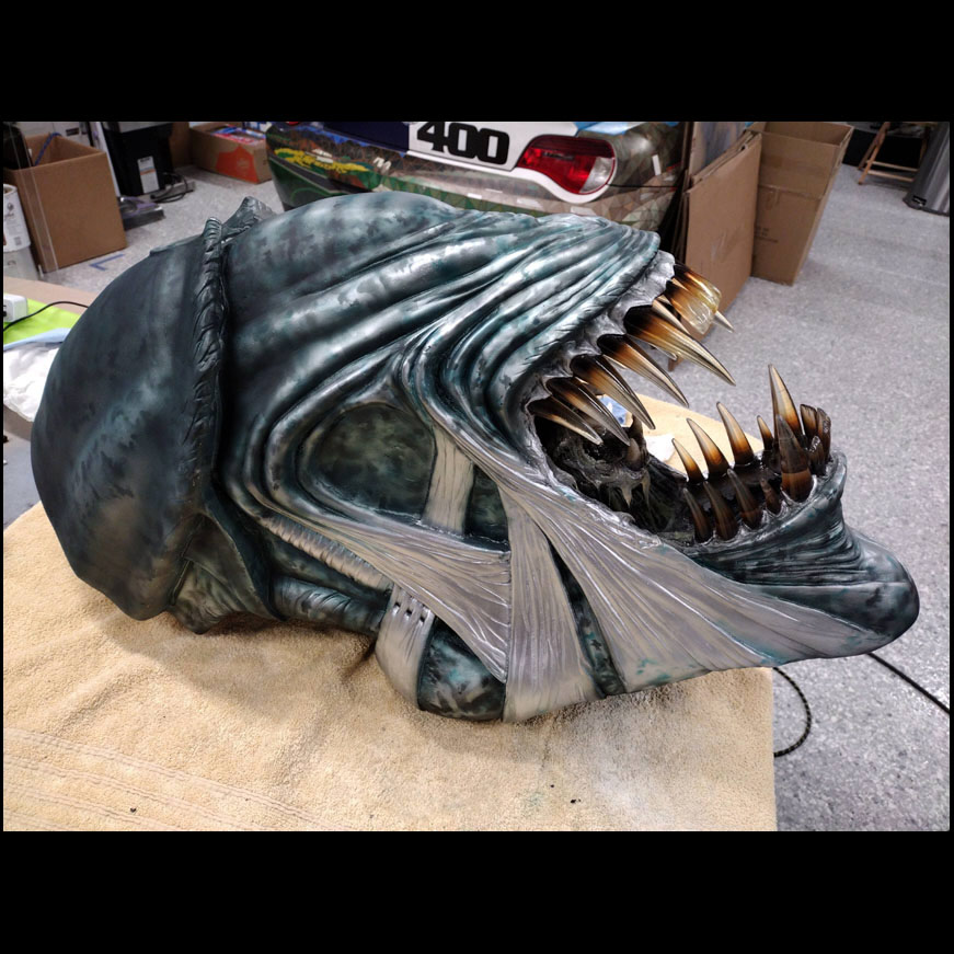

Wednesday until now I've been focusing on the tendons. These are really tricky on this figure because they aren't cast clear, and because they are sculpted with a lot more bulk and detail than typical. We all know that a queen's jaw tendons are clear(ish) and often mimic the coloration of the teeth. So I wanted to aim for that same aesthetic. But at the same time these need to appear more integrated with the rest of the head because of the way they are sculpted.
Which is why I based the tendons in the same silver and they have been unpainted to this point.
I started with toning them with clear brown (and a tiny bit of yellow), like I did with the teeth.
Then I tried airbrushing brown transitions in the recesses of the creases. In hindsight this was stupid. But I'm laying out the whole process, and that includes failures.
Then aqua transitions on the green side, because I wanted to use aqua as an accent on that side as it is a minimal accent on the green side of the crown. Thinking I'd use brown as the tendon accent on the blue side.
And some dark green transitions over the aqua. I also brush painted what I (probably incorrectly) refer to as core refractions (dark areas in the center of a translucent shape). Not terrible, kinda heading in the direction of what I want, but its missing the mark. Out of time, so that's the end of Wednesday.

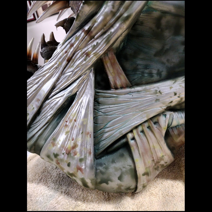

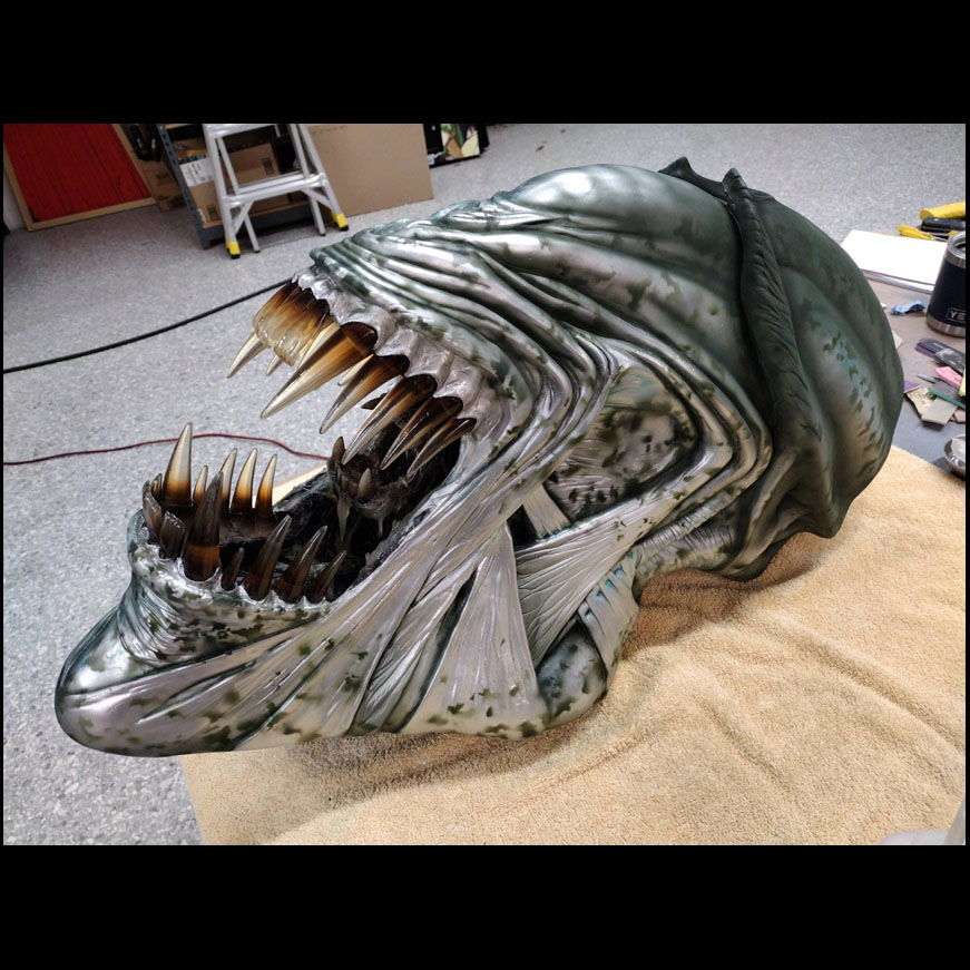

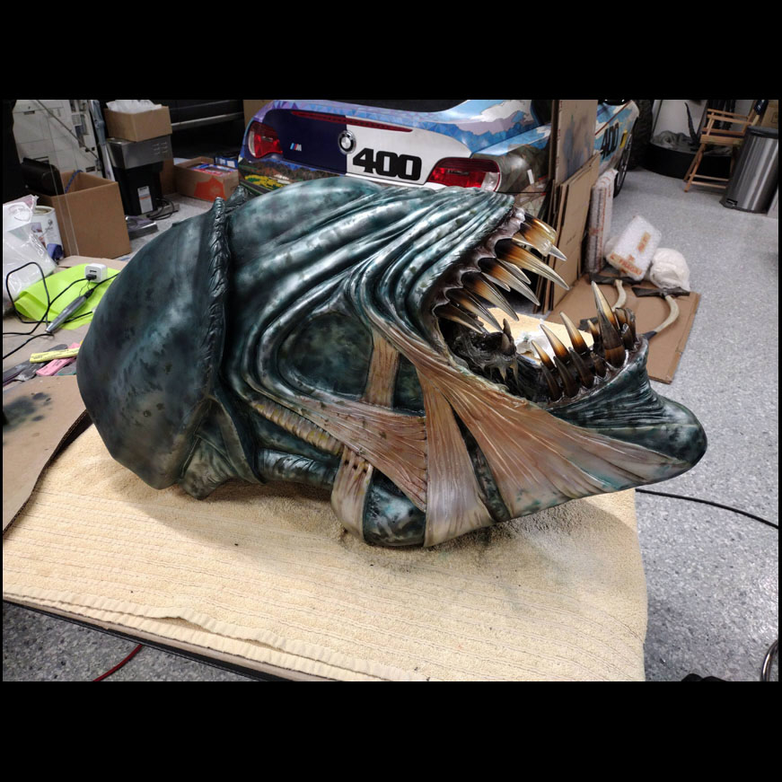

Thursday was a very long day. Started off with drybrushing silver on the green side, to extend the lighter colors (translucency) of the jaw tendons.
Then airbrushing clear brown, moving it further away from the center.
Then clear yellow, to tint the center slightly.
Then refining the refraction areas.
Then I reattached the hanging strap, because at this point I realized that I HAVE to hang it near the crown to really understand if I'm getting the values and saturation correct. I used a little gasket sealant between the strap and backer board, hoping it will act as a vibration damper and keep the screws tighter longer.

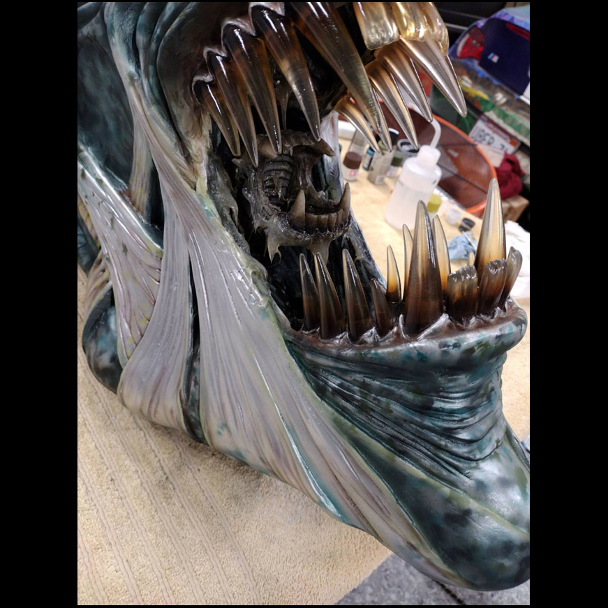

Last thing before lunch was tinting the gums with Freak Flex clear black. It definitely helped unify the head, and gave me some idea of how to treat the gums later.
And I brush painted the inside of the gums black, so they merge with Bruce's original paint.

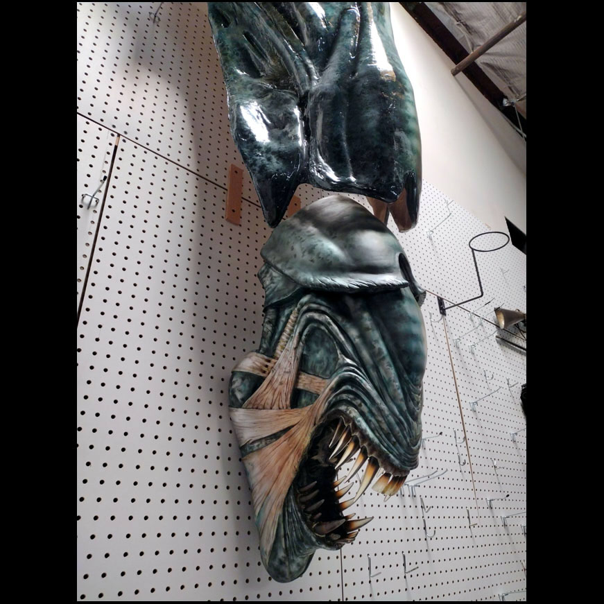

Then the hang test. And yes, I DID move the hanging peg down several inches from it's installation position. This reduced the risk of scratching the head's crown on the crown's crown.
It's one thing to match color and value, it's another altogether to match flat paint off a gloss reference. I could tell from this test where I needed to add more, and more importantly: Where I didn't.
You can see here just how much lighter the colors look when they are flat vs. gloss, especially at certain angles of reflection.

Second hang test. Matching a lot more closely, if one imagines the darkest areas getting darker when clearcoated. There were a few areas of color still to tune.
Look how much lighter the black on the head is! Same black, same density, just not clearcoated.

Back to the tendons...Airbrushing brown on the ridges of the creases on the blue side.
Then brush painting the refraction shadows, leading up from where the tendon turns opaque.
Drybrushing a little more silver.
Done for the day. Feel like I've made big improvements on the tendons since yesterday.

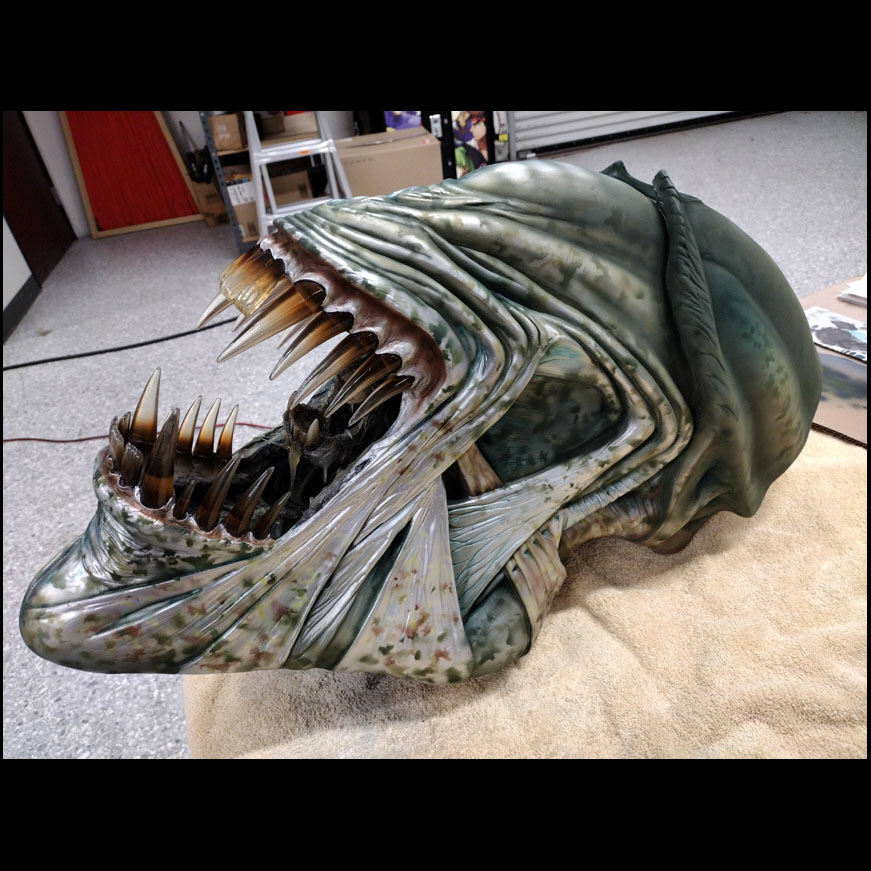

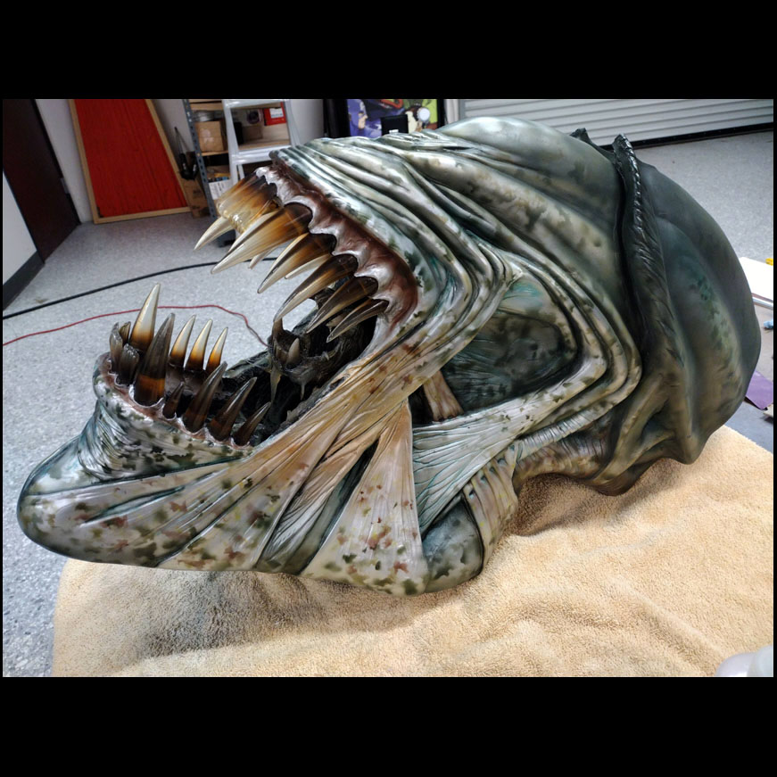

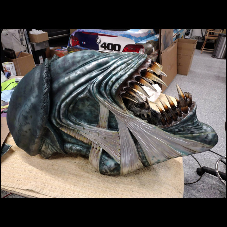

And hanging again. Pretty happy with it overall.

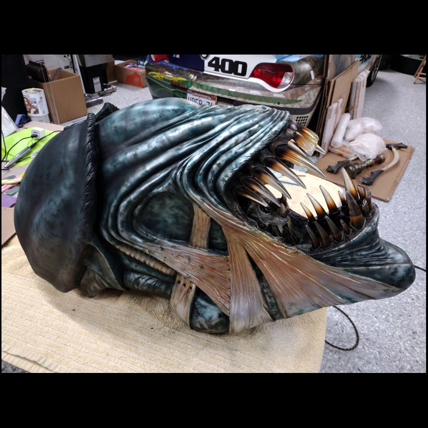

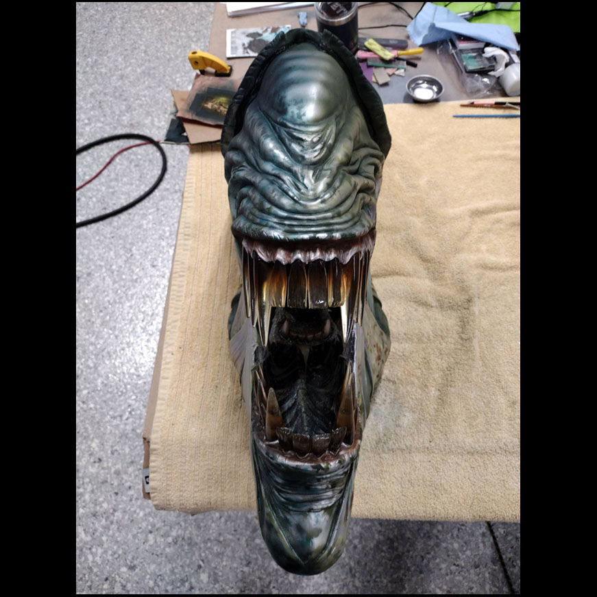

But not totally happy. Something was bugging me. Something about the tendons. Took Friday off to get some space away from it, and did some Photoshopping to test ideas.
Yes, the overall colors are matching the crown:cool::cool:(y)(y)I'm sure that the high gloss will tie everything up;)
As for the tendons; you have all of my sympathy...trying to make, somewhat, "translucent" is a difficult exercise at best.:oops:
She looks Amazing!
In regards to the tendons have you maybe thought about recasting those sections in a clear rubber or even silicone sealant..
Super flexible and open to pigmentation if desired ?
