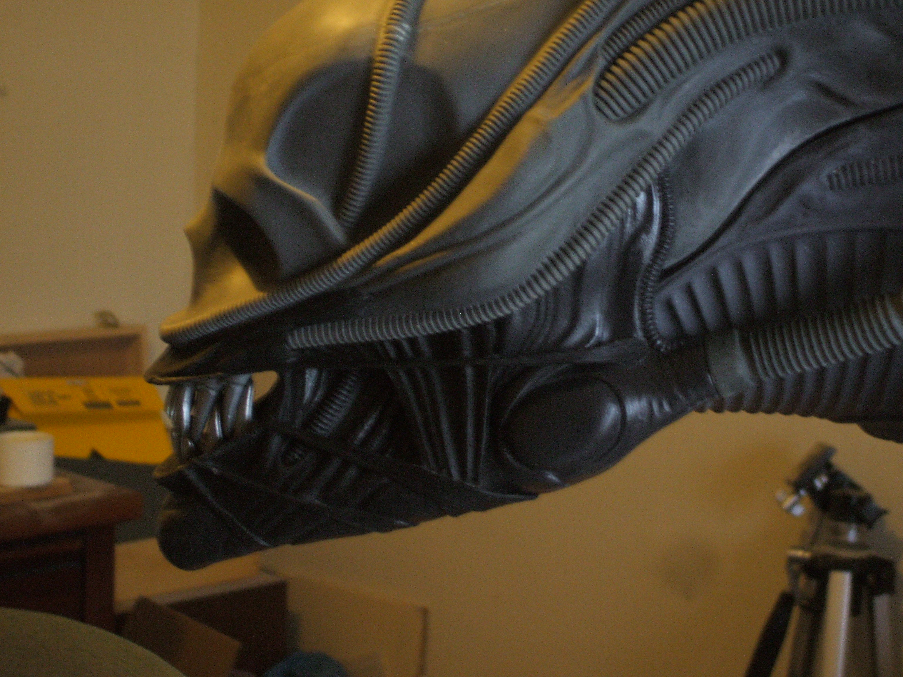

If you notice my casts are varying shades of grey, that's just because I've been experimenting with the pigment. The last cast I did (the fin) has come out almost completely black & that was at a mix of 9% So If black is what I'll be going for then in future I'll mix at 10%.

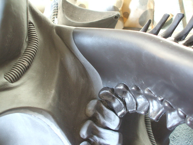

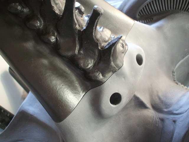

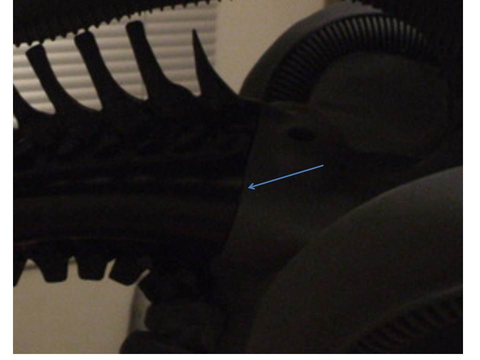

Hello Leigh,
let the removable rear fin, or the paste with plaster definitively, hiding the seam?
Re: Bob the Alien (Giger inspired Alien) Its back on!
The fin will be bonded forever, or is removable forever? If will be glued forever, you will hide the separation zone with a surface finish? I like it too, as seen in the photo, because it maintains a technical aspect. :):thumbsup
Oh ok :)
I'm not sure if I'll blend it or not? I have the choice :) It doesn't need to be glued to stay in place, surprisingly it fits really well :)

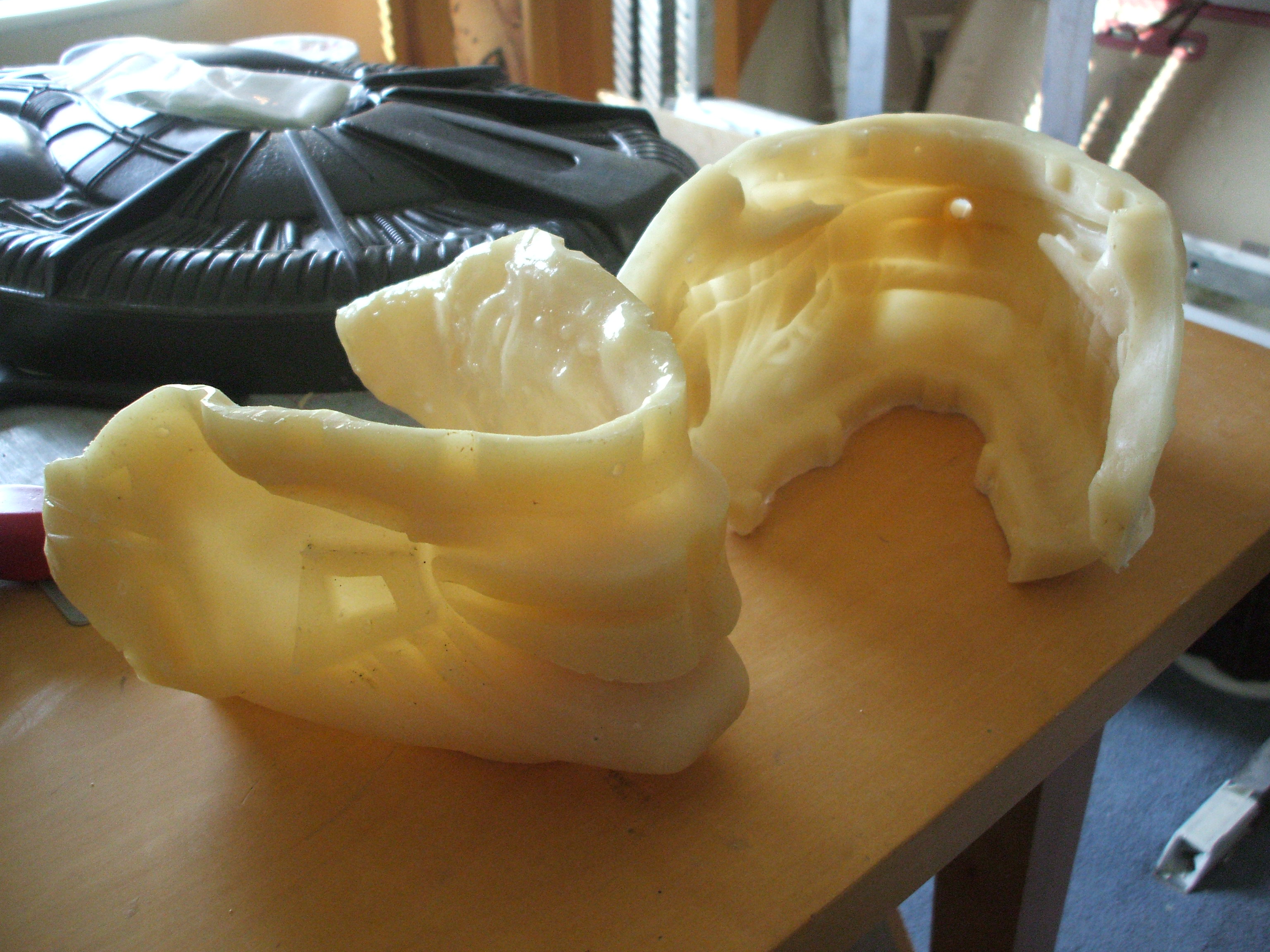

I've made a FG tube out of woven FG, soaked & tightly wrapped round a 22mm tube. The tube has been bonded into the stand part of the body & filled around it with extra urethane.
The body was then foam filled & is now pretty strong :)
I've also been experimenting with the lips :)
I made a hard urethane rubber mould around that very delicate cast of the lips. The urethane rubber is Shore 85, its similar to cold hot glue in stiffness.
I tried running a cast in clear Addition cure silicone & it failed, didn't cure :(
Next I tried soft urethane rubber I left over from the first attempt way back. That was past its shelf life & didn't cure! :lol
So I've spent quite a lot of time cleaning that mould :rolleyes
I learned a bit about the mould in the process though & made some adjustments along the way.
My last attempt was using the very same urethane the mould is made from but with black pigment added & it worked!! hoorah :D sort of :)
I got one bubble in the top lip but I know how to prevent that happening again now :)
So the plan will be to cast this in clear urethane rubber with a touch of pigment. It wont be as flexible as I'd have liked but it'll be glueable & paintable :)
