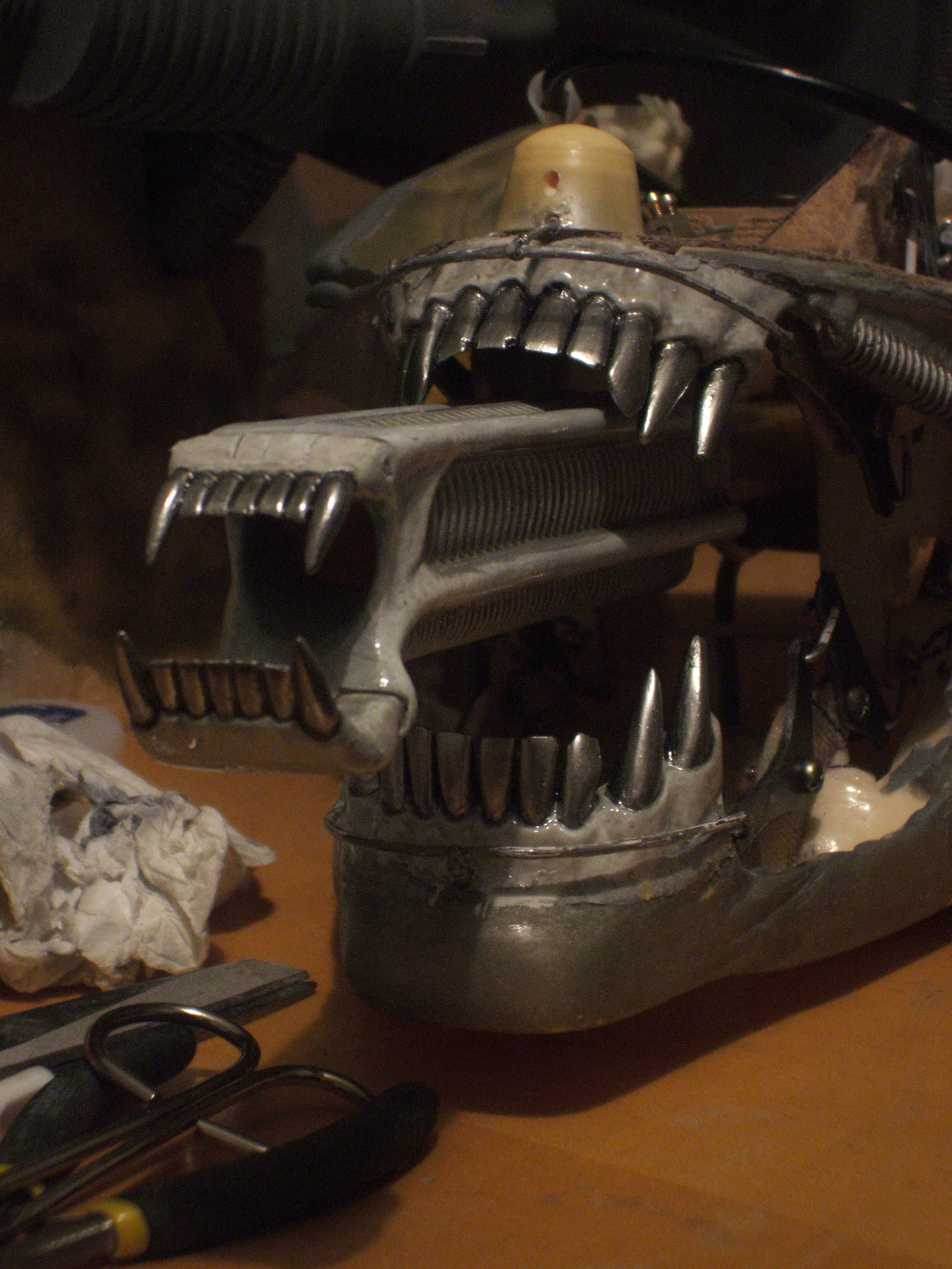

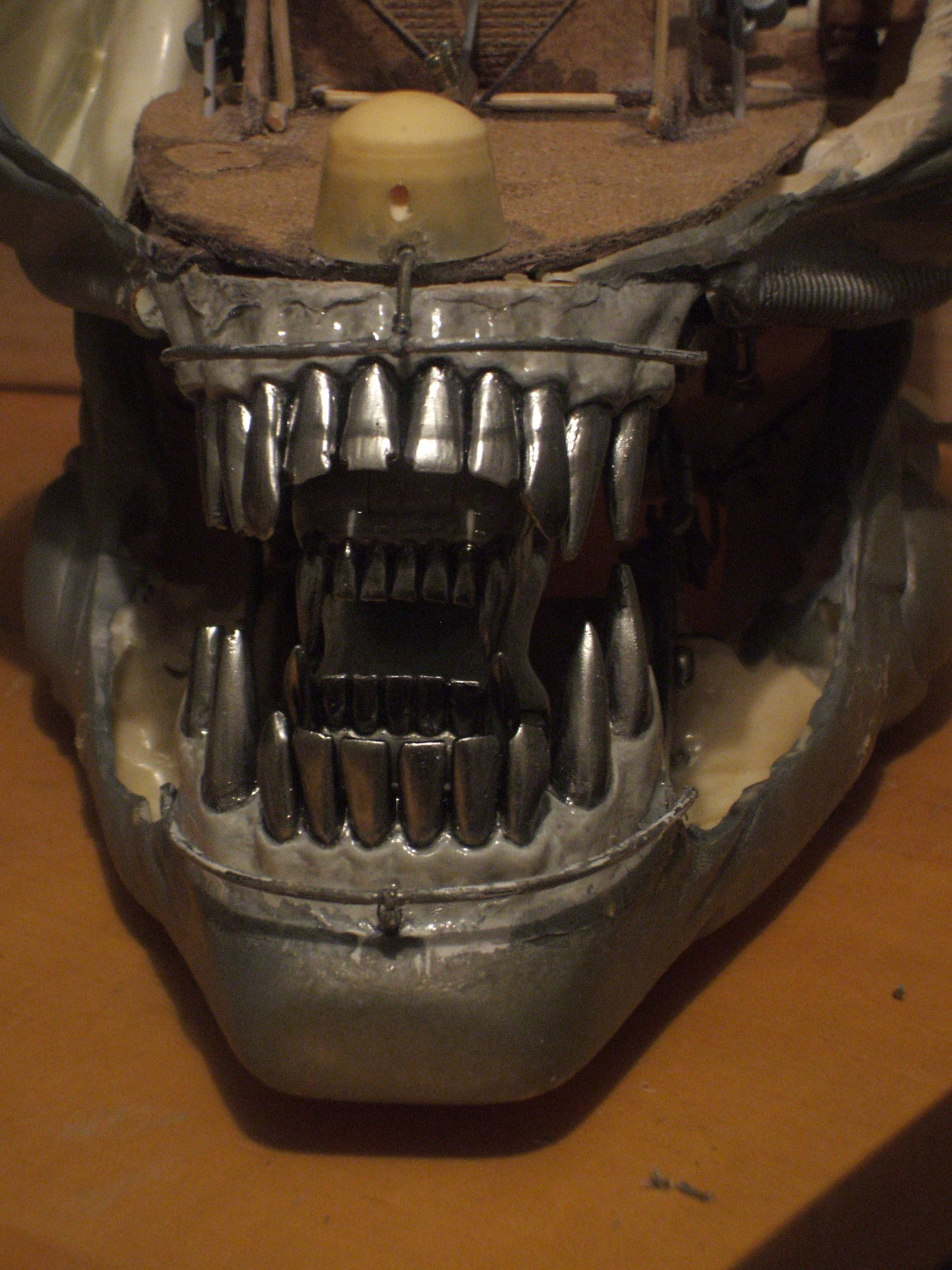

I've been reading threads here where people have used Alclad for metal finishes, so I thought I'd give it a go:
The pics don't do this Alclad justice! it looks great in the flesh, although I have clear coated it.

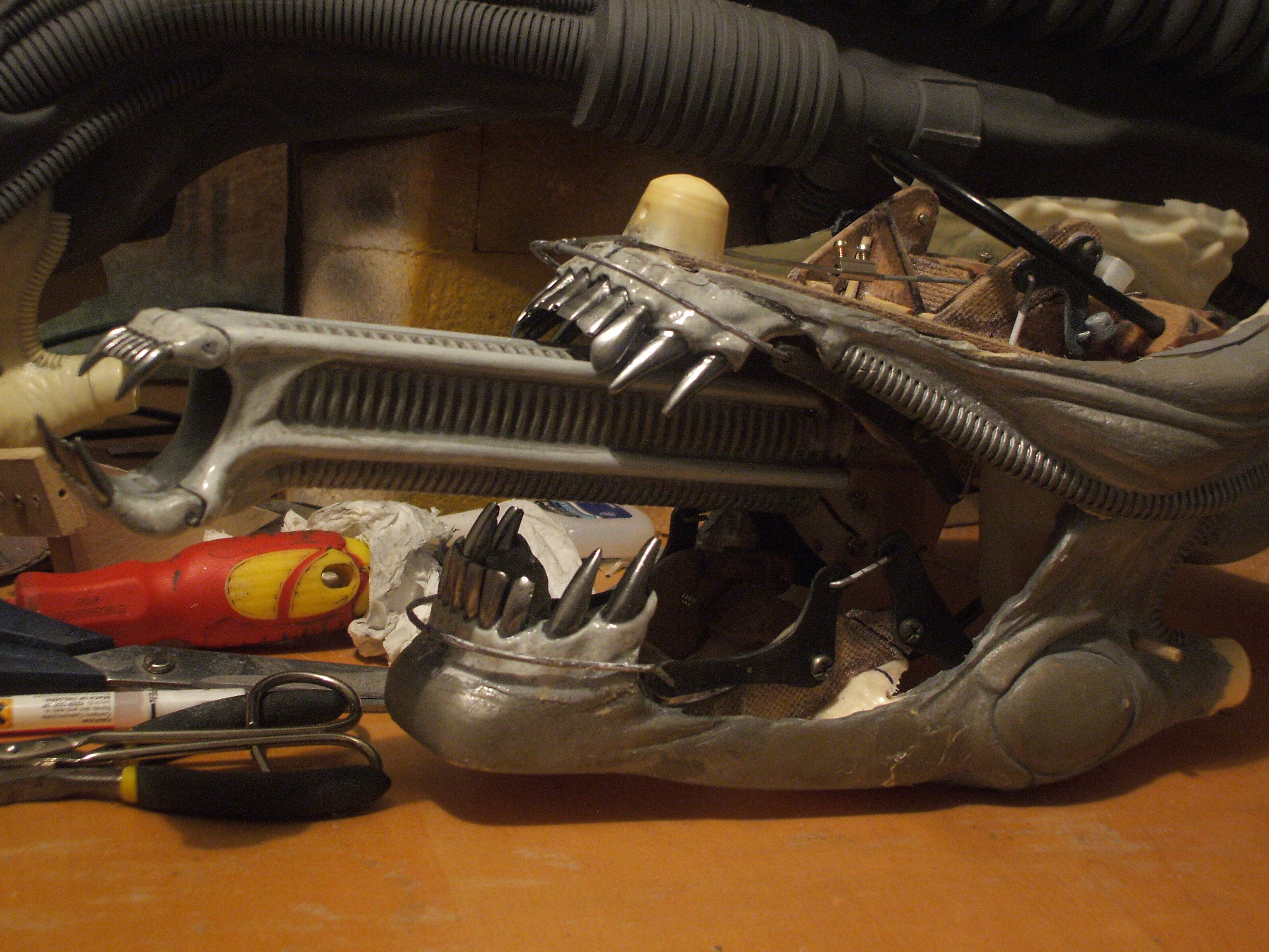

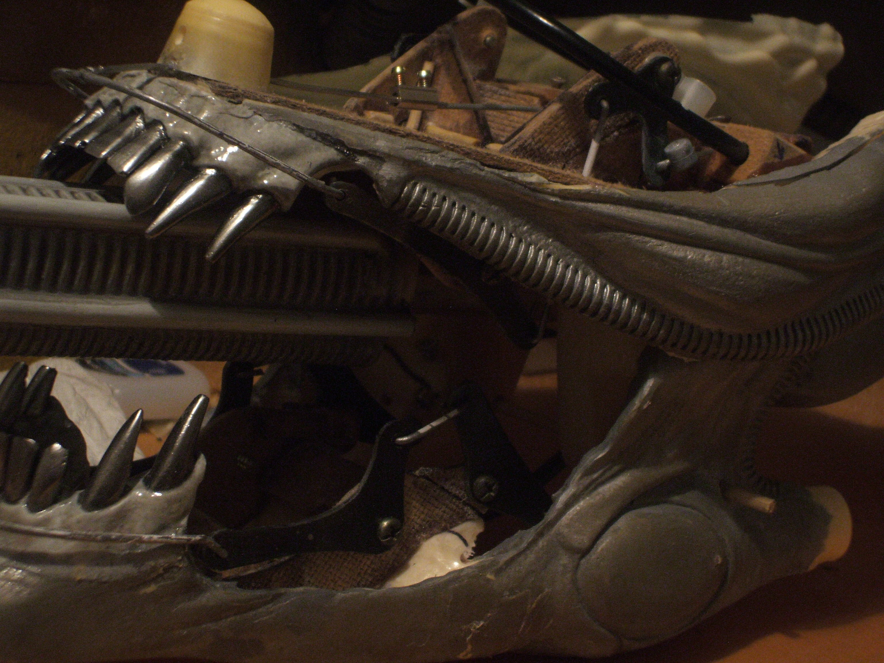

I've also been refining the mechanism's that'll make him move. The hardboard parts will ultimately be made in urethane now that I'm happy with it all :)
Just got to hook up the tongue, add a few springs here & there & build a lever block to control him :)

:p Waaaauuuw!!! Those teeth look great!!! Nice job, it really shows how great the sculpt is, and when the head is all put together and painted, they will really make the piece pop.
And I like that you've kept the gums a light grey, I know it's all probably just to show the details and such, but I hate it when I see a very nice Alien bust, statue or figure and they've painted the inside of the mouth and gums all black, when it should be the same whitish colour as the tongue, just as our tongue and inner mouth are the same pinkish colour :)
But yeah, can't wait to see more.. keep those updates coming! :)
Re: Bob the Alien Sculpting finished page 45
Thanks :)
Yes, the inside of the mouth is an off-white or dirty white. I've found that if I use the Alclad chrome over the white or light grey it gives it an interesting depth, it almost gives the impression of translucency. I haven't finished this one with it but I'm thinking of using the Alclad chrome all over him when he's finally finished, it only shows up as chrome on a dark or black base.
