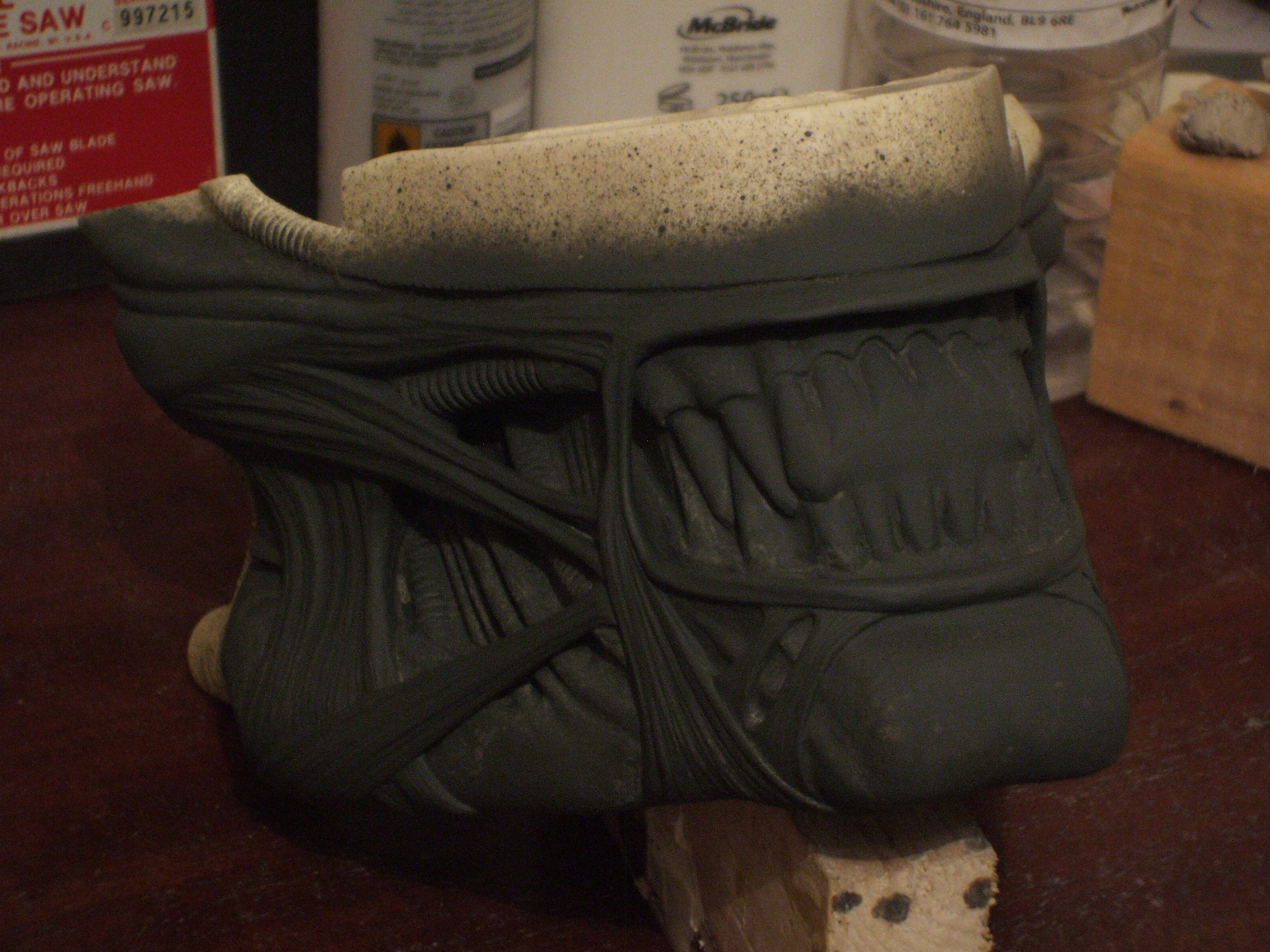

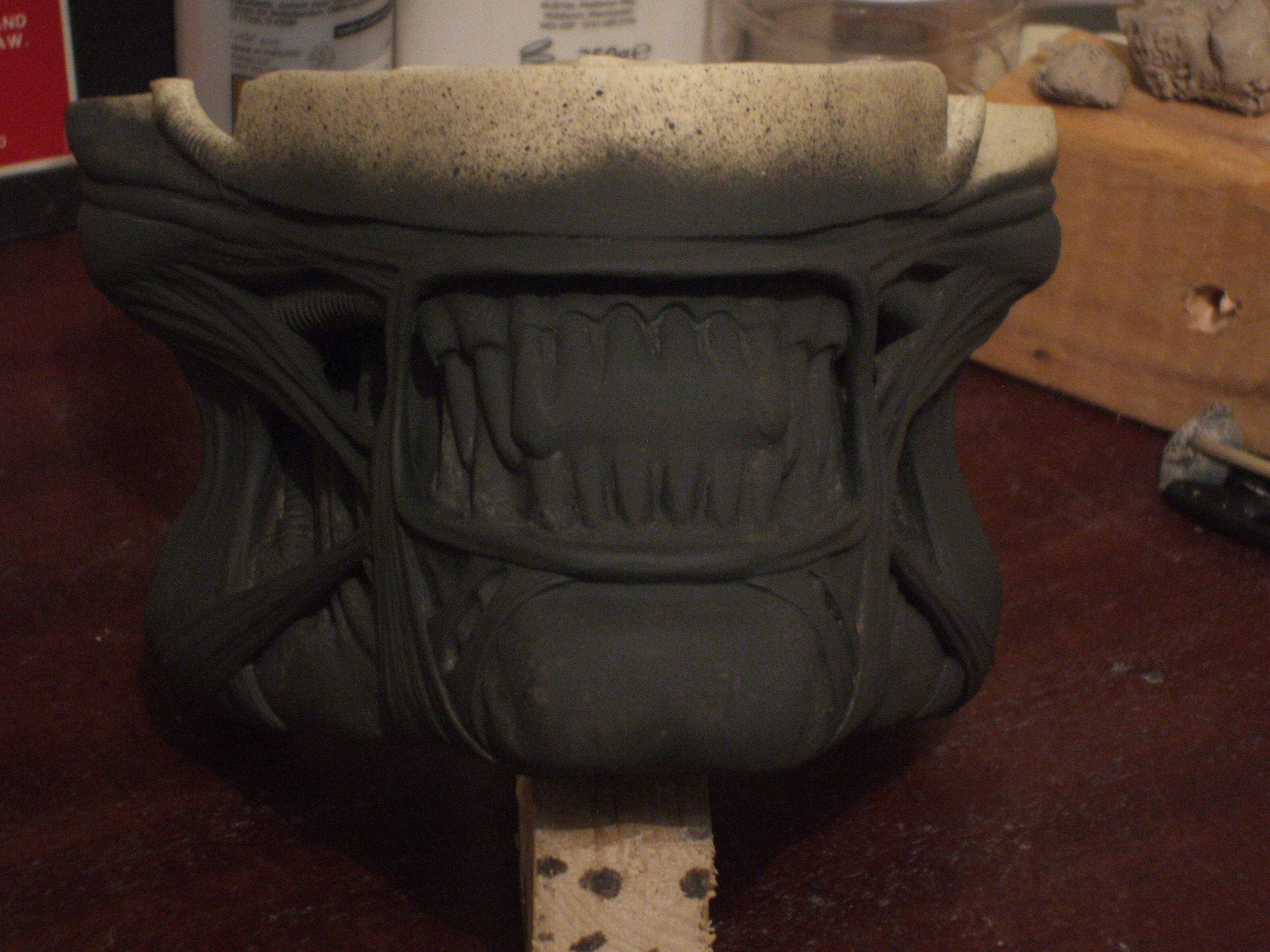

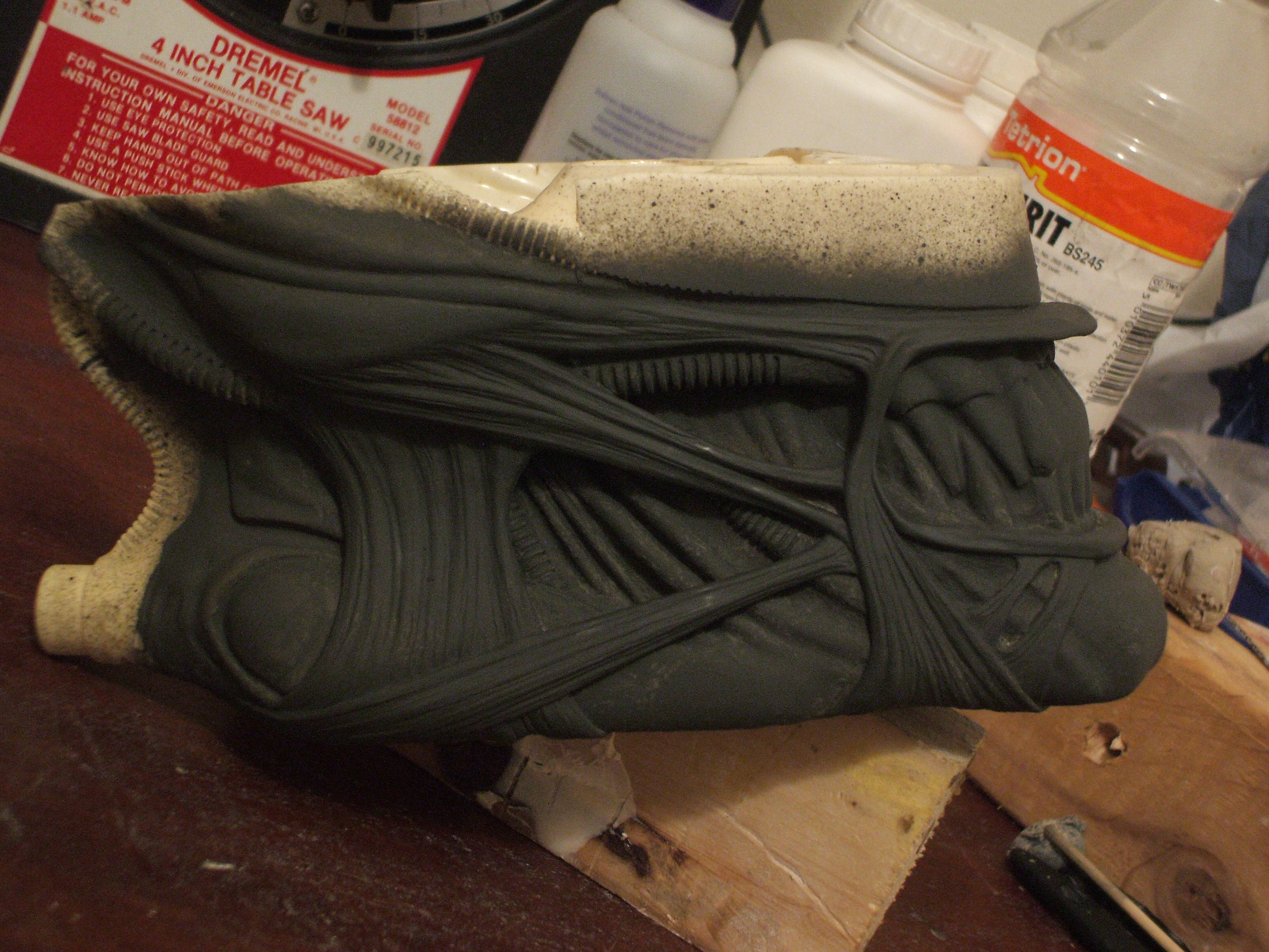

Made some more subtle changes:
Re: Bob the Alien (Giger inspired Alien) Sculpting finished page 45
it's beautiful. :)I'm tempted to copy his tendons on my alien,:ninja but, later, you ask me to pay royalties!:( I'm kidding, of course. :thumbsup
Yes, I like the extra tendon... I didn't really like the hole, but didn't want to say
I like this better. Feels more taut and scary.
Showing more jawbone is an plus too. You don't want him too feel too "fleshy". Hard, skeletal and buglike!

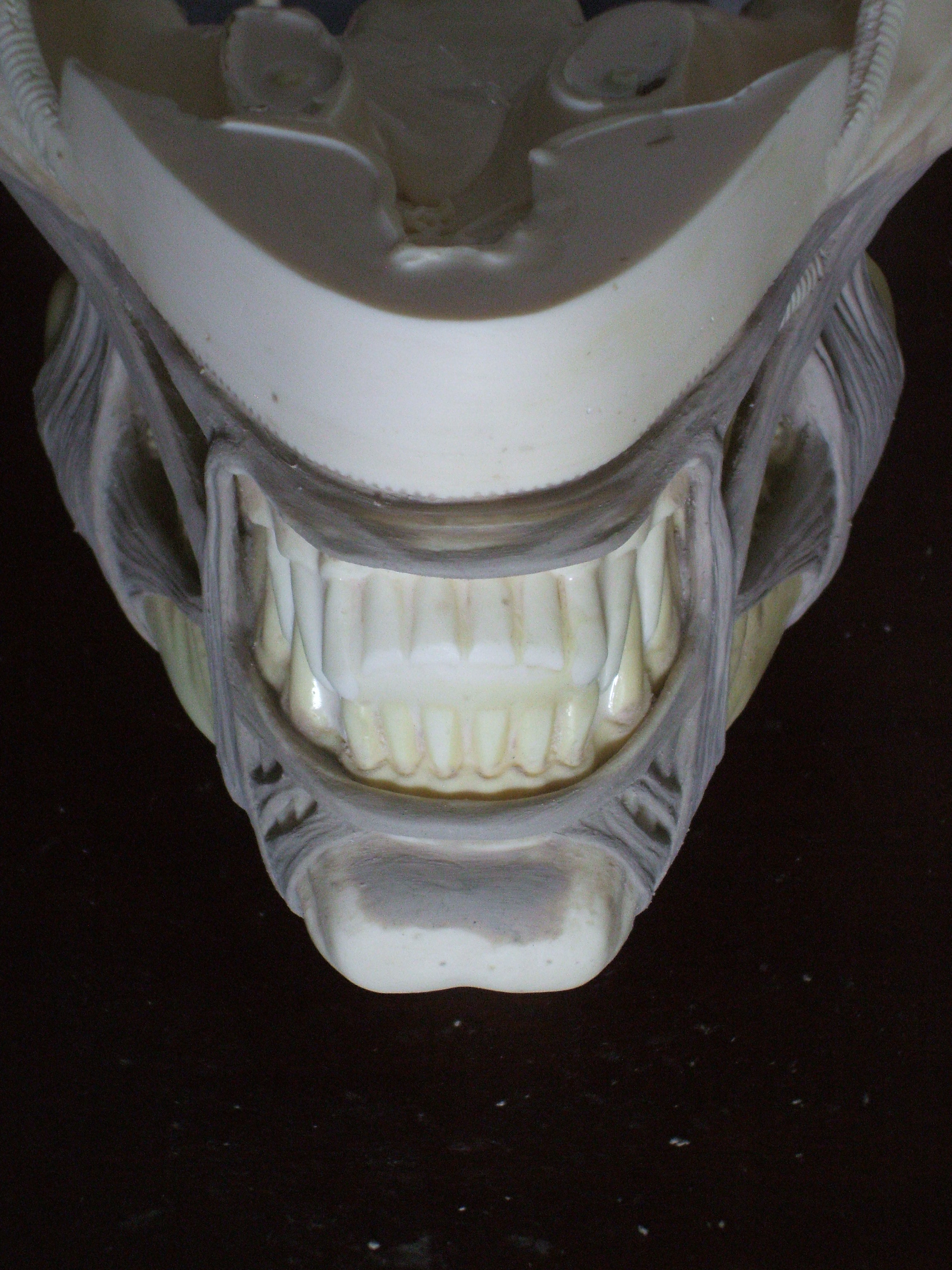

Really GREAT.
Tendons looks so cool.
Technical point for tendons (i'm a newbie, sorry):
The white base is a base mold and you put clay on top to build the tendons, right?
But after, how will you proceed to have the tendons alone in transparent material?
Thanks Bee :) The white part is a part-cast of Bob, bonded together & gaps filled. I've sculpted the tendons onto the cast as you say. I'm not 100% sure how to proceed with this at this point :$ The tricky part is that there's a gap behind parts of the tendons, otherwise it could be treated like a regular prosthetic?? I think I'll have to fill the area's behind the tendons & then make a mould over the whole thing. I can then remove all the clay, put the white part back into the mould & fill the void left by the clay with urethane rubber. If anybody has a better idea PLEASE let me know :D

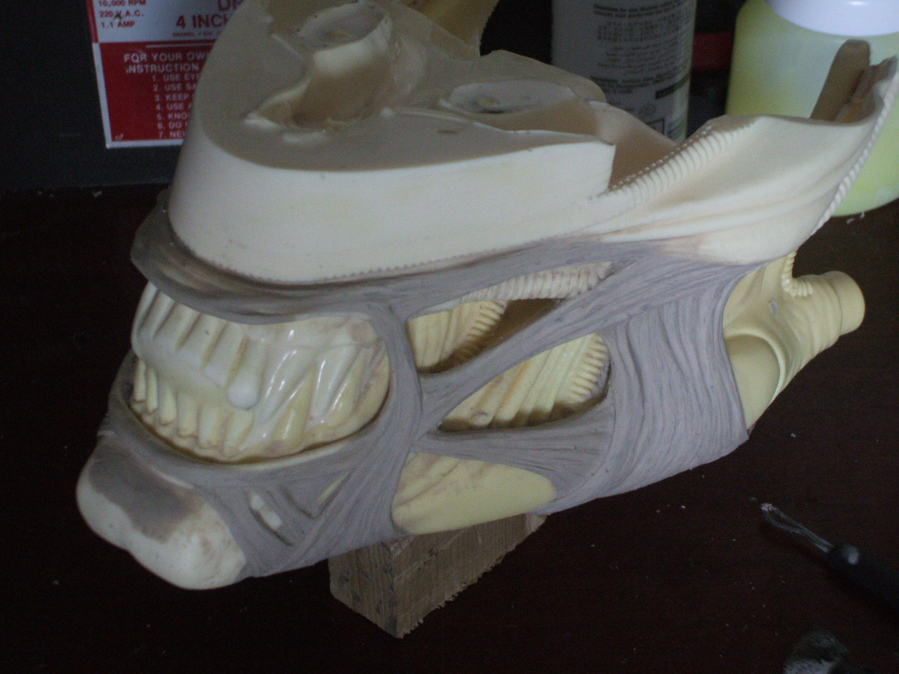

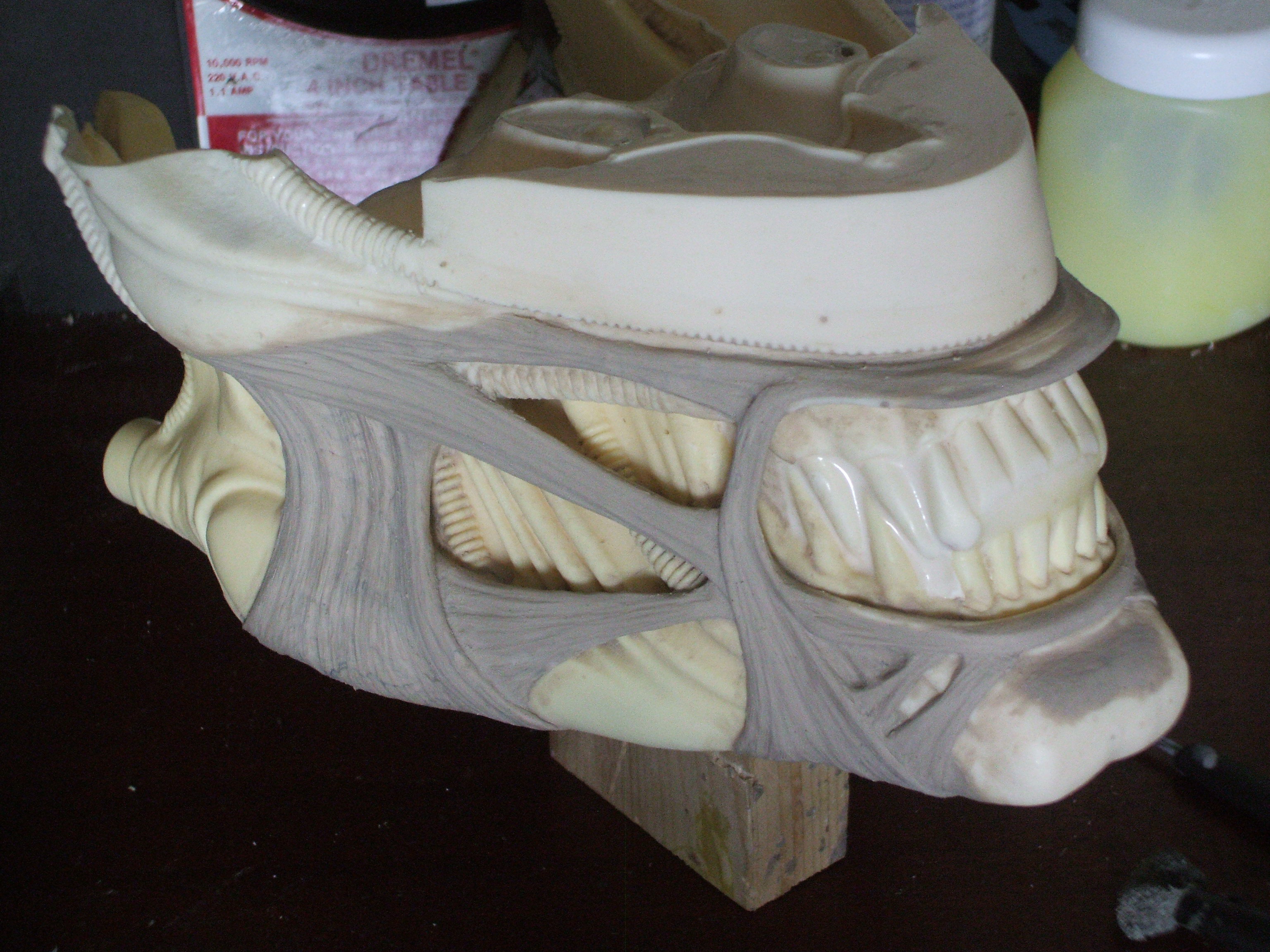

Right, here's the latest: I took a little advise from Alan & I've tried to tighten it all up a bit & give it a kind of a look of a mix of muscle & stretched latex so that it at least has some resemblance to the original. I've also made a couple of minor alterations but that's it now! it has paint on it... done! :D
You're casting technique sounds about right.
You might want to do that then cast a new resin positive so that you can carve down and resculpt the backs of the tendons so they look right shape, texture and thickness.
Then use that piece as your final model to mold.
