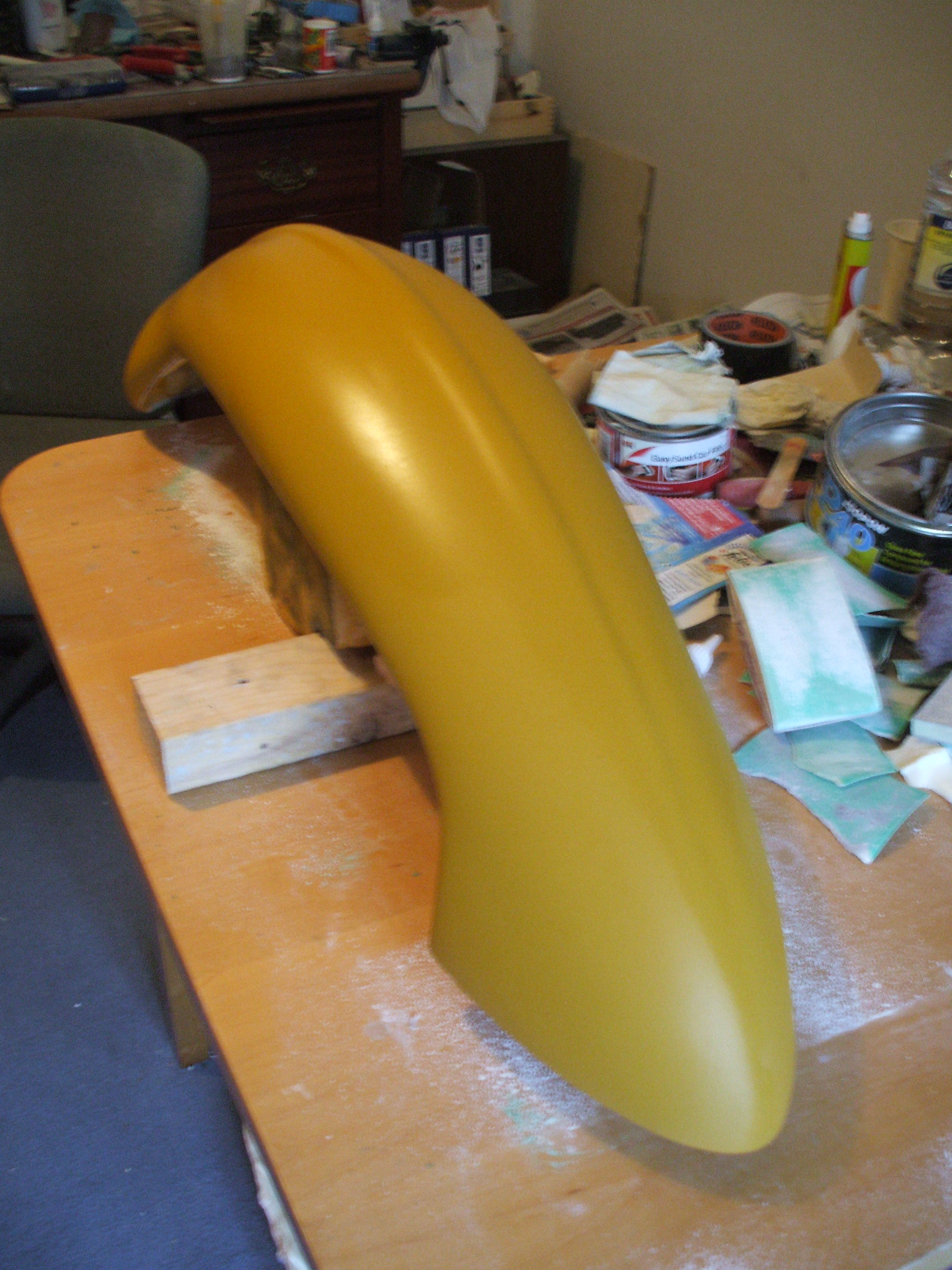

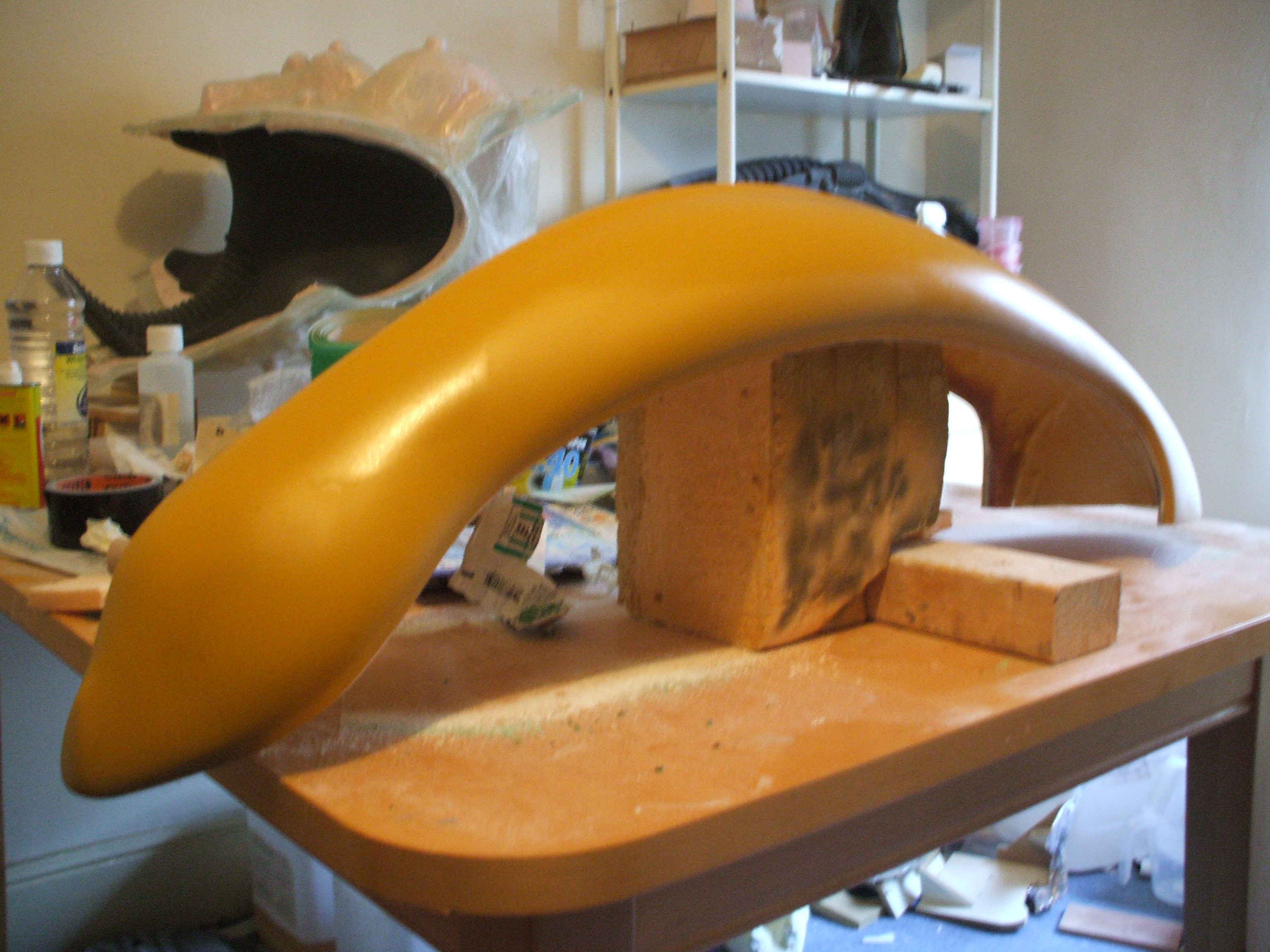

OK, I've cleaned all the silver off as it was only for reference, I've separated the dome from the rest of the head, cleaned up all the undercuts & filler primed it.
I'll let it dry fully for the rest of the day before I do anything else :)

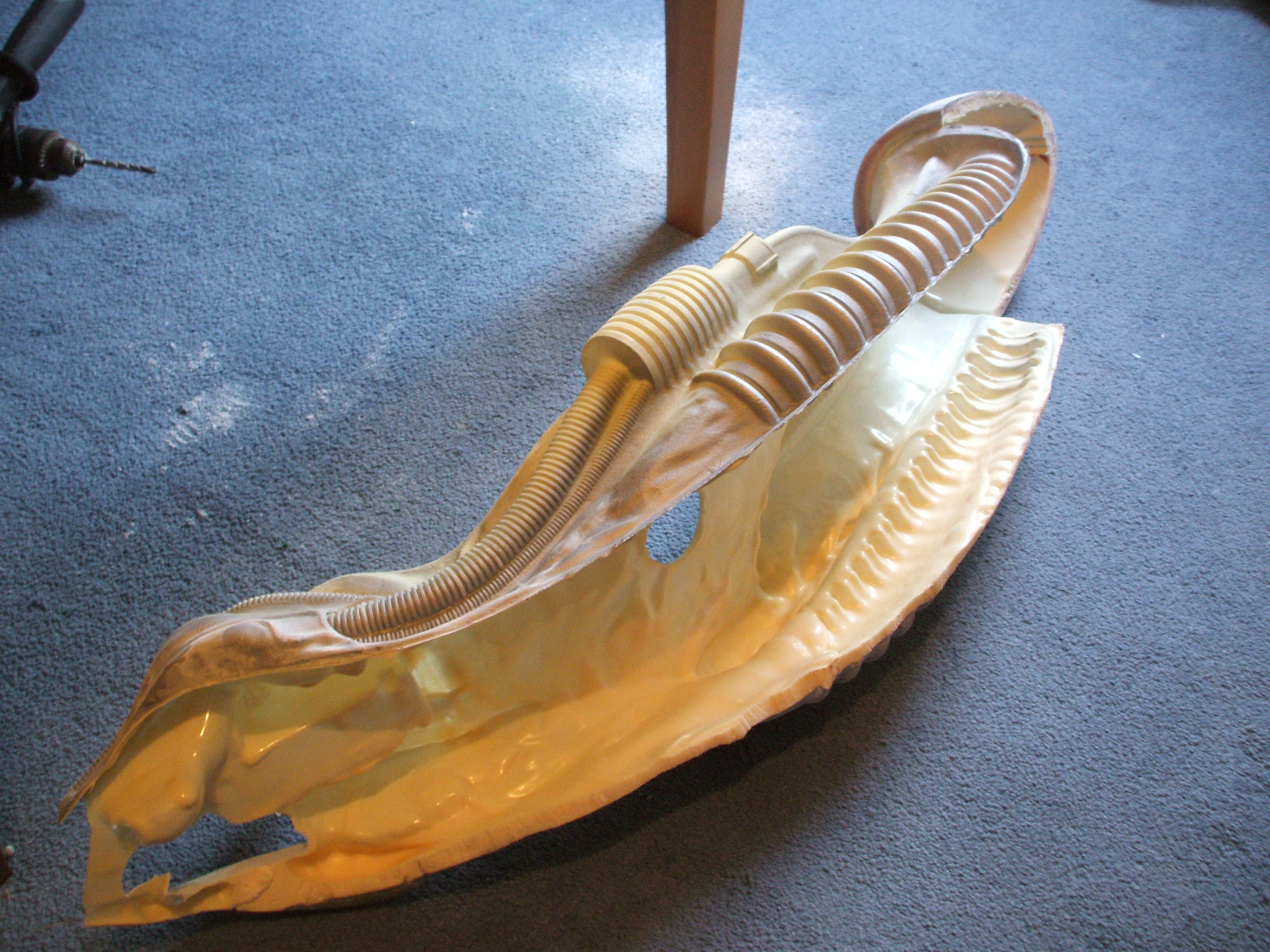

Here's the remains of the head:
& here's the dome buck drying :)
Later on I can start building the supporting structure for it. I'm thinking about making it in cardboard, soaking the cardboard in polyester resin & then adding a layer or two of fibreglass :unsure I might just use the cardboard as a mould & build it in FG :unsure We'll see what happens when I get there, I've got the day to think about it :)

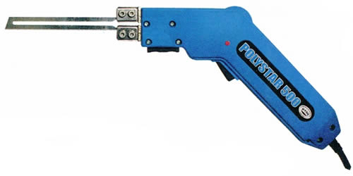

In other areas, if you can get the undercuts, so pronounced, as your mold, you should not see large misalignments with the perimeter of the head. Another problem is the cutting of thermoformed. If you are using a hacksaw, risks of starting cracks and ruin everything. I used a hot knife for polystyrene (not the hot wire).

I also tried it with the Dremel, with thin cutting disks. is very difficult, from identifying the right speed, because you foot down, they break, they can take different directions suddenly, it will not save the cracks. The hot blade, however, is even faster, not aggressive, melt the material and can eliminate small edges and even out the surface of the board. Remain loose burrs, which come off with a fingernail or sandpaper. I'll recommend it, but you're free to try. :)

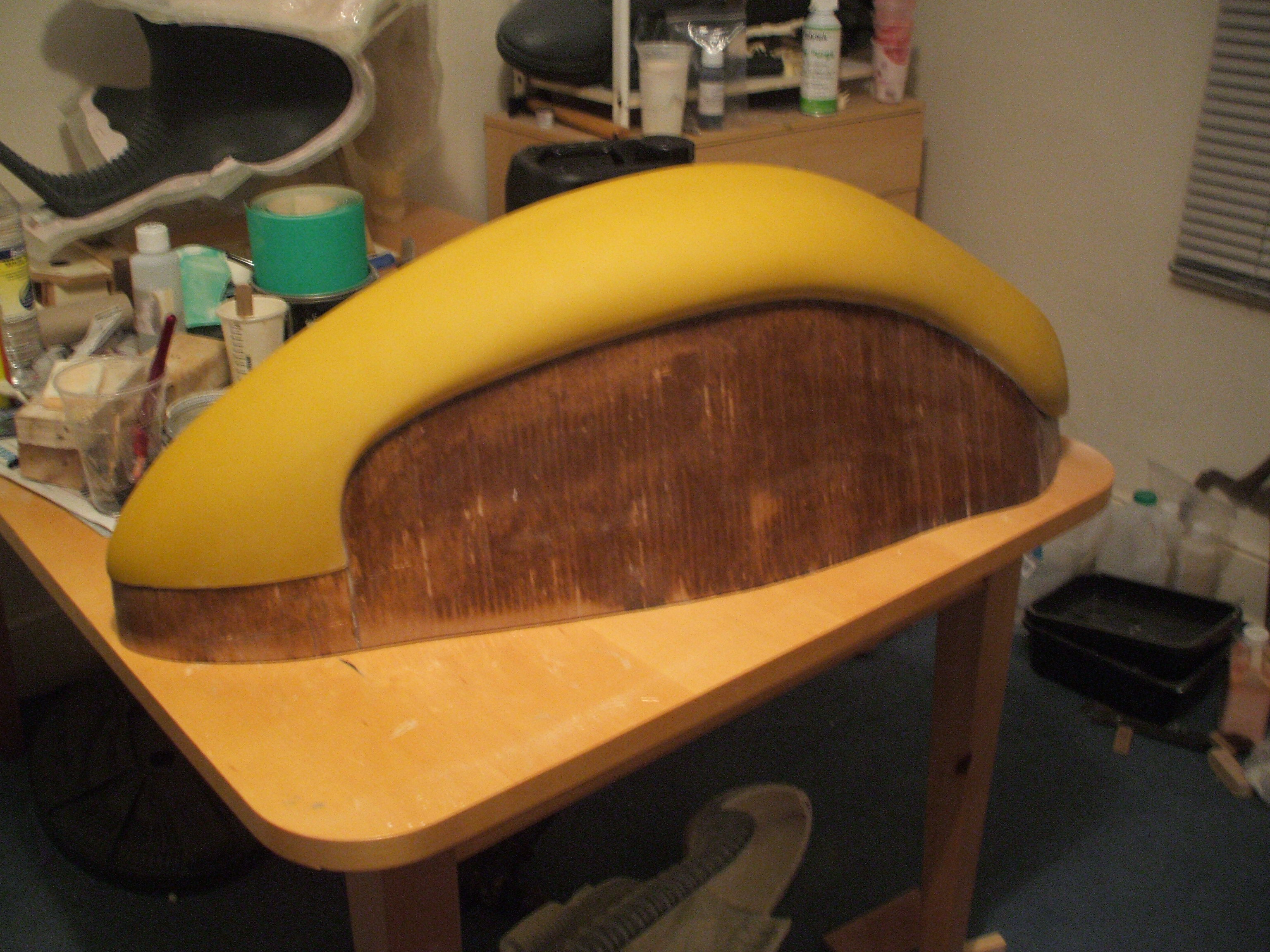

Here's where I'm at so far:
I know it looks amateurish being cardboard but I needed something simple to start this off. The dome (yellow bit) is very strong on its own, its also made using polyester resin & fibreglass over rigid polyurethane foam over polyurethane plastic, all these materials are thermo setting & should not soften with the application of heat. Now the cardboard is glued in place I've soaked it in resin & let that dry. Next I'll start to build up the layers of FG on the inside of the cardboard. Once I've built it up enough I'll start adding cross bracing to tie the two sides together & make the whole thing very stiff.
That's the current plan :)
