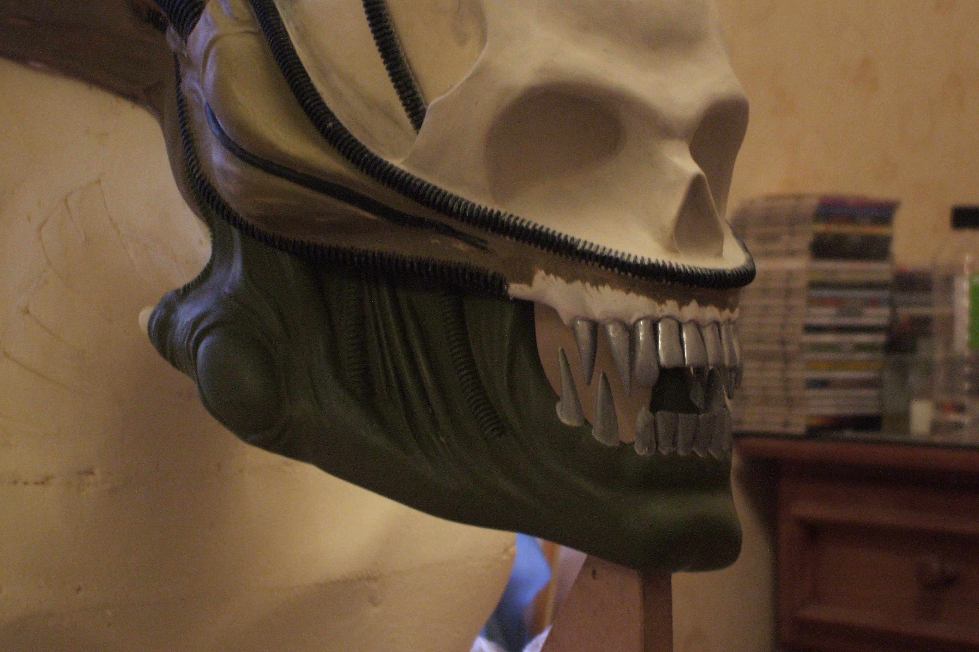

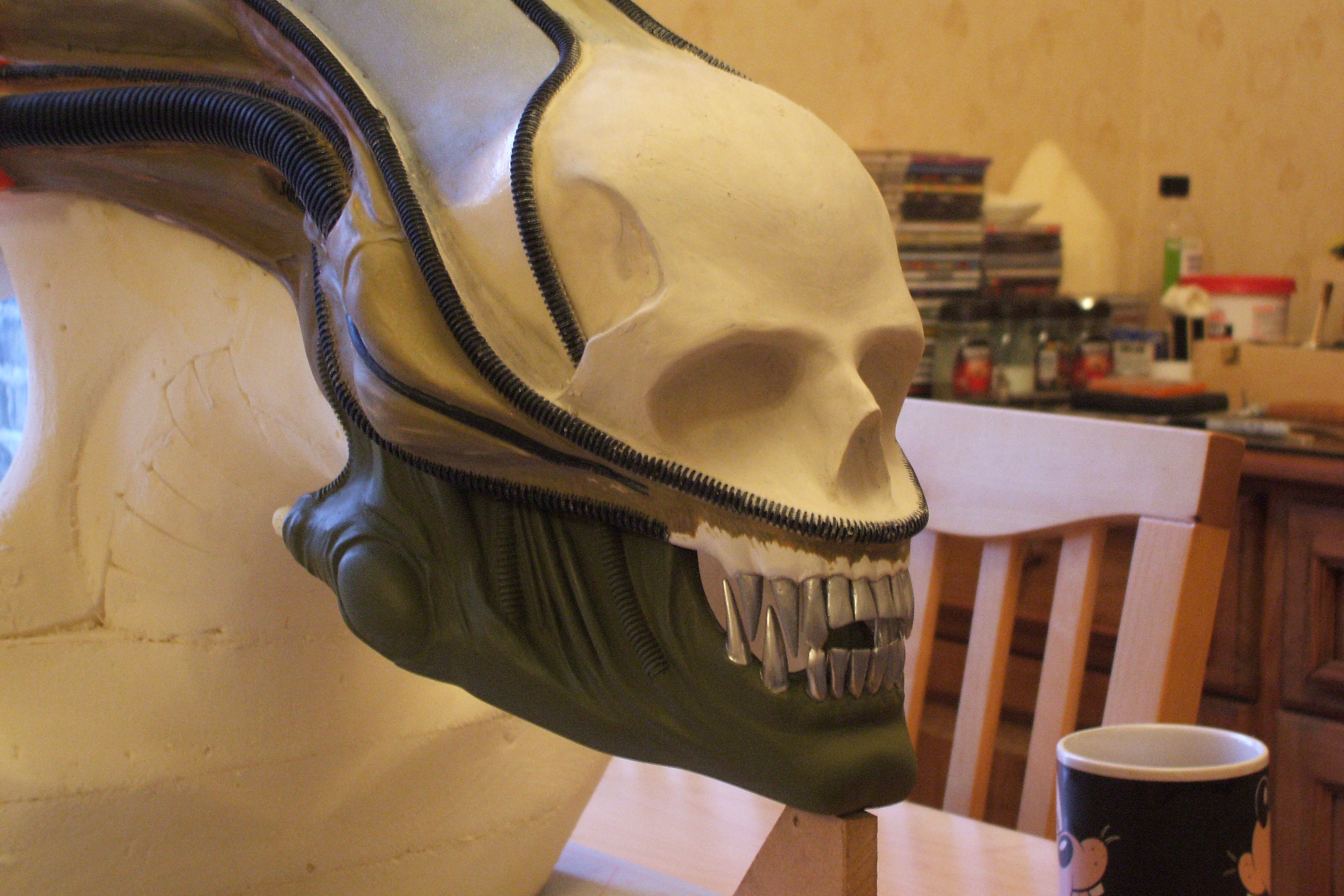

A small update:
You'll probably be hard pushed to see it :lol but I've put 5-6 hours into the jaw today. I've shaved about a quater of an inch off the bottom of the chin & about the same off both sides of the front, then re-shaped it all & carved/sanded the detail back into it adding a slight dimple on the chin.
I also took the tops off of the bumps either side at the rear of the jaw.
I'm texturing the jaw using Humbrol enamel matt paint applied with a bit of washing up sponge, I keep dabbing it untill its tacky & it leaves a nice textured finish.

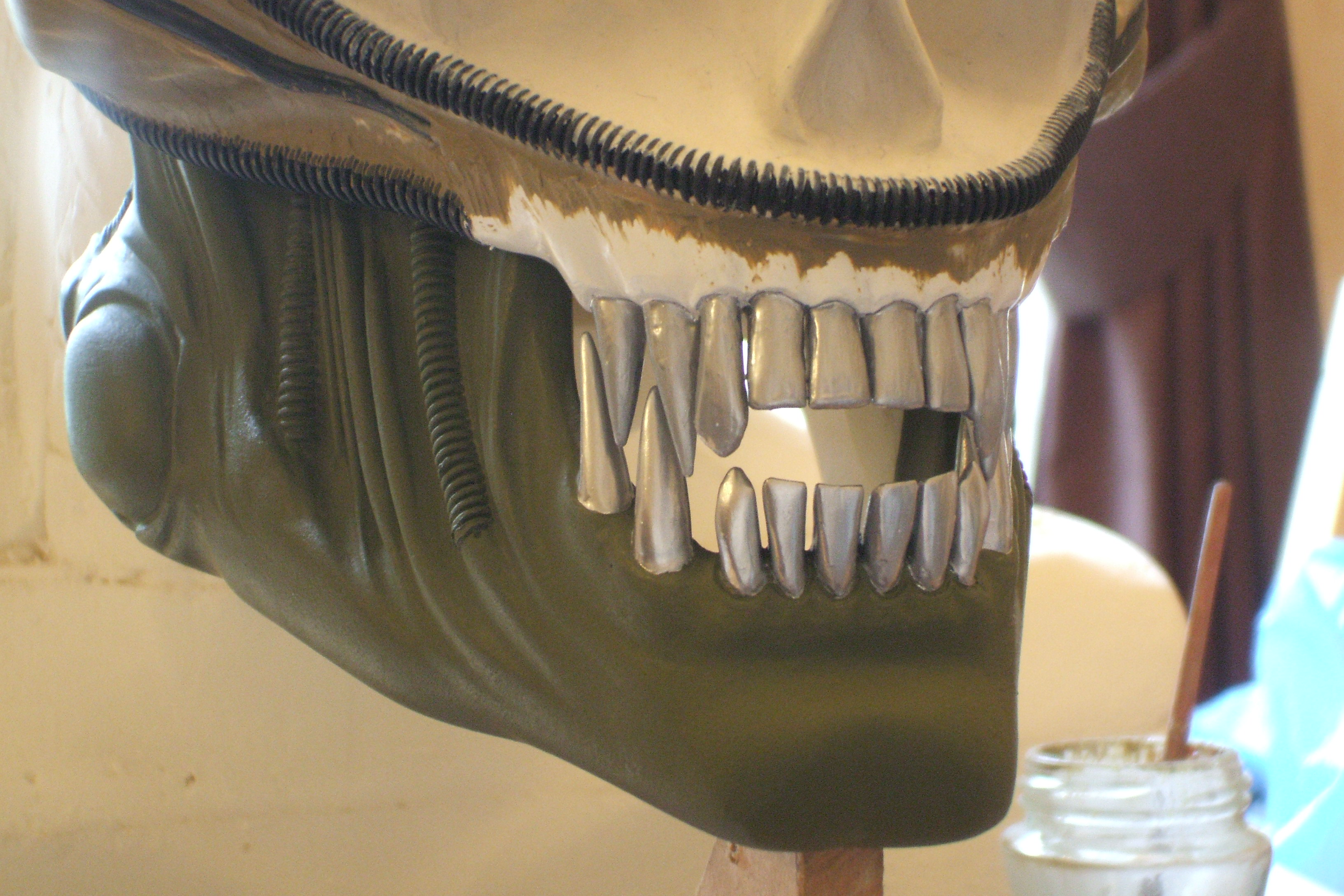

That & Mr Nwerke's suggestion promoted me to also recede his gum in an effort to make his lower front teeth look longer:
Haven't over done it I hope :confused
As a dentist, I like the gum recession as well. :) Wow, all your changes are amazing. Just little things that push this sculpt over the edge!!!!

To have two dentists approval is rewarding :) Thanks. Yeh their only subtle changes but they all add up :) Hopefully I can say the teeth/ mouth area is pretty much done now.

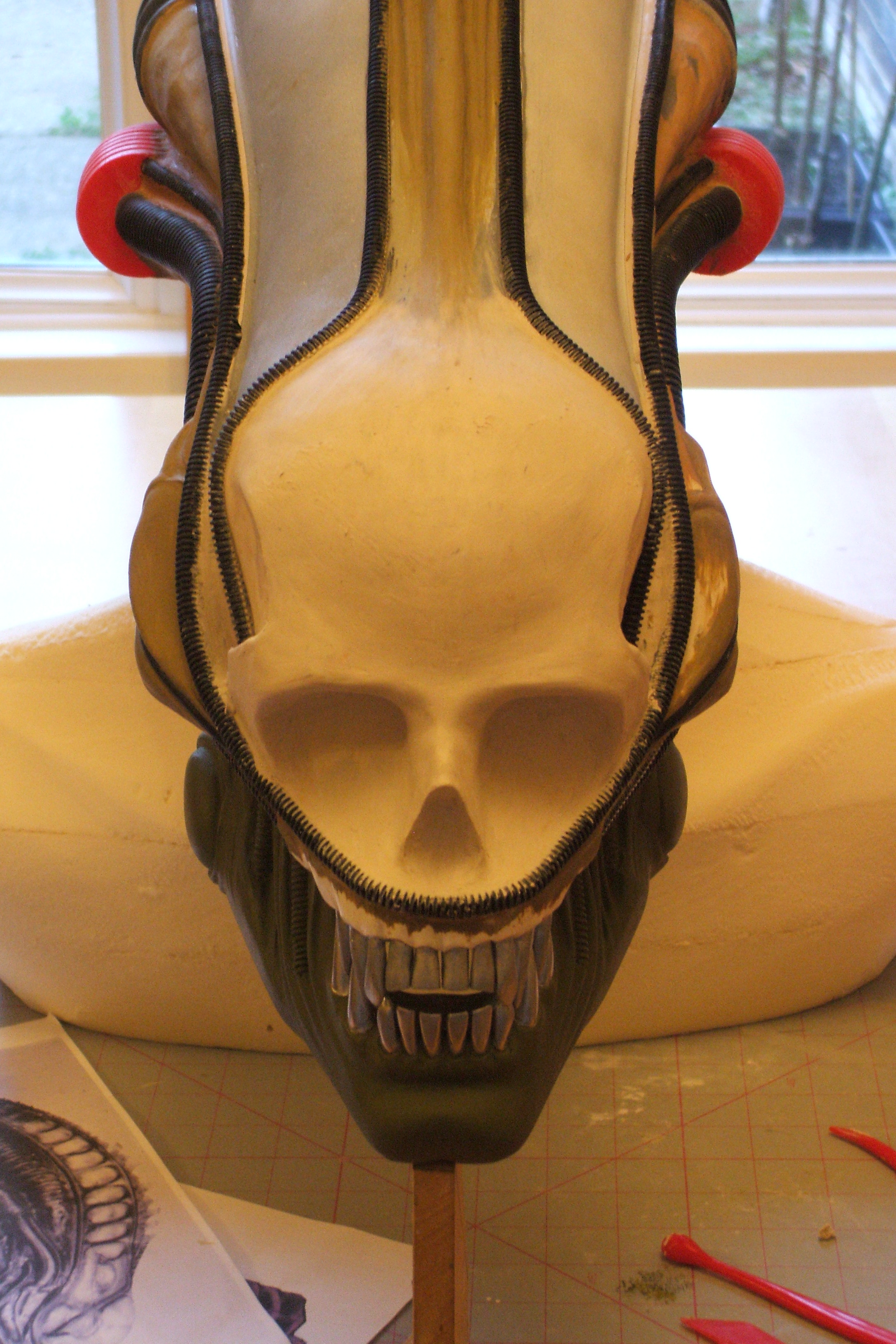

PS I think when you have the lips and tendons in place you're going to stop worrying as much about the jaw. It's going to look *very* close to the real deal. Dug out my refs at last, including other fan sculpts, and this is way the best replica I've seen.
Did find a couple of things though! The two outermost incisor teeth on the upper jaw - their cutting edge actually slopes down/out slightly, towards the canines. The amount of slope varies a bit from prop to prop though. And I haven't yet found an original which had the eyesockets quite as 'angry' as yours. This varies too - some (stunt versions?) are outright 'sad' like many normal human skulls. Some have one of each! Bad casts or damage I guess.

I'll admit I used Sano's for refs on the top front teeth although looking at the remains of the Rambaldi head the 4 front teeth all look flat on the cutting edge but all together they do form an arch :confused . I've been thinking the same about the eye sockets, I think they may be a little big aswell I'll have to have a fiddle with those. I was looking at the bitd pic of the Rambaldi front on view & those sockets are completely different sizes & shape & of course that ones different to the stunt head aswell, it can make things difficult all these differences between the originals.

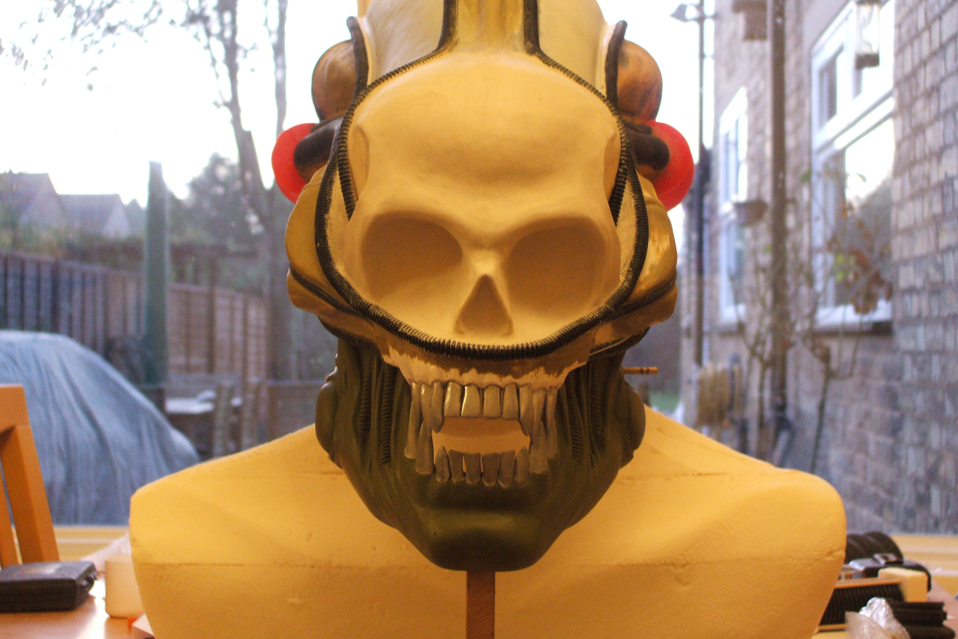

Little update
I took Nwerke's advise & re-shaped the fore head, brow, nose, eye sockets & I took a file to he's top front teeth. I'm really happy I did aswell :):
What do you think??
