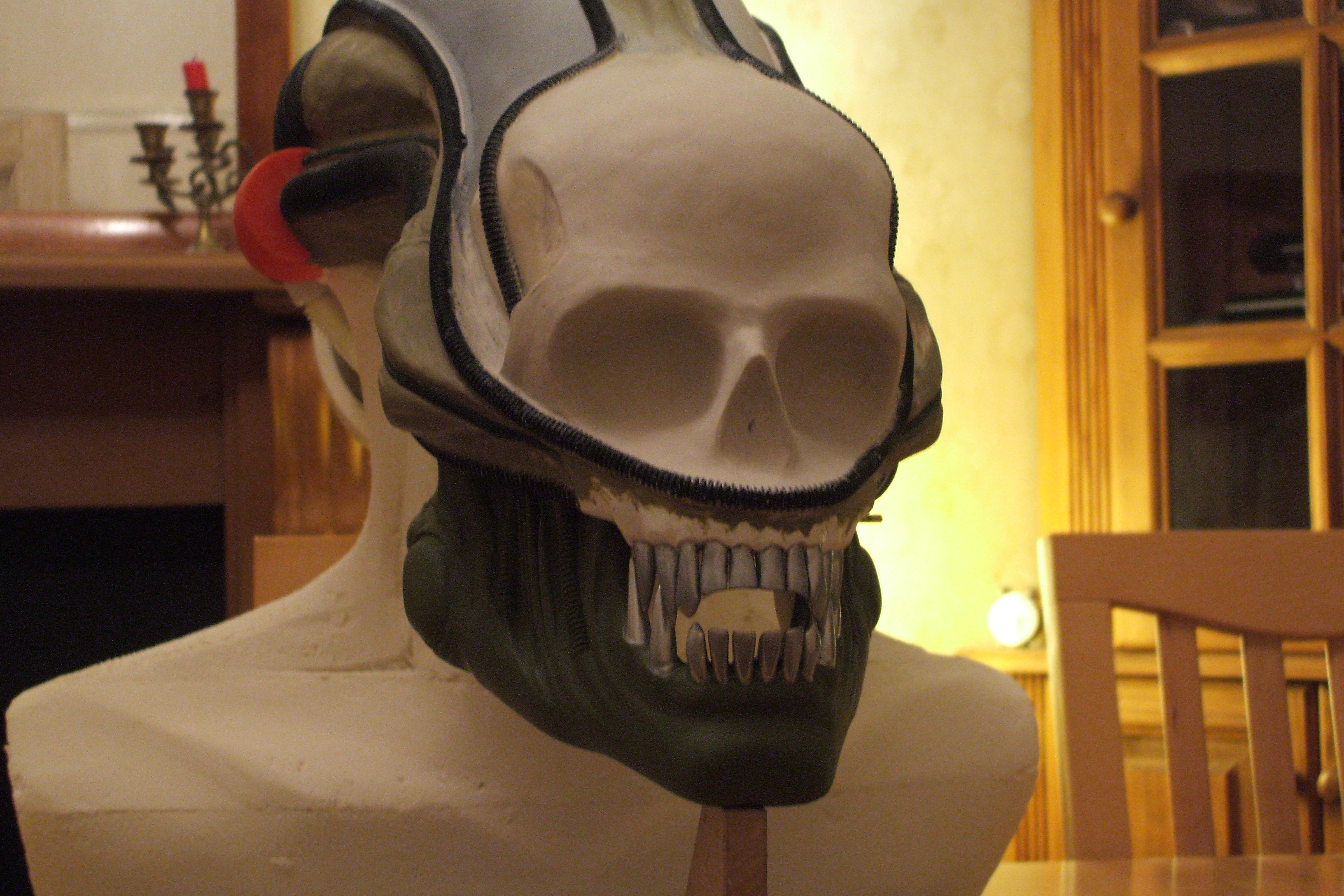

Re-shaped his nose again :rolleyes :)
& I've been smoothing off all the unseen stuff at the back of his mouth so it can be moulded easily.

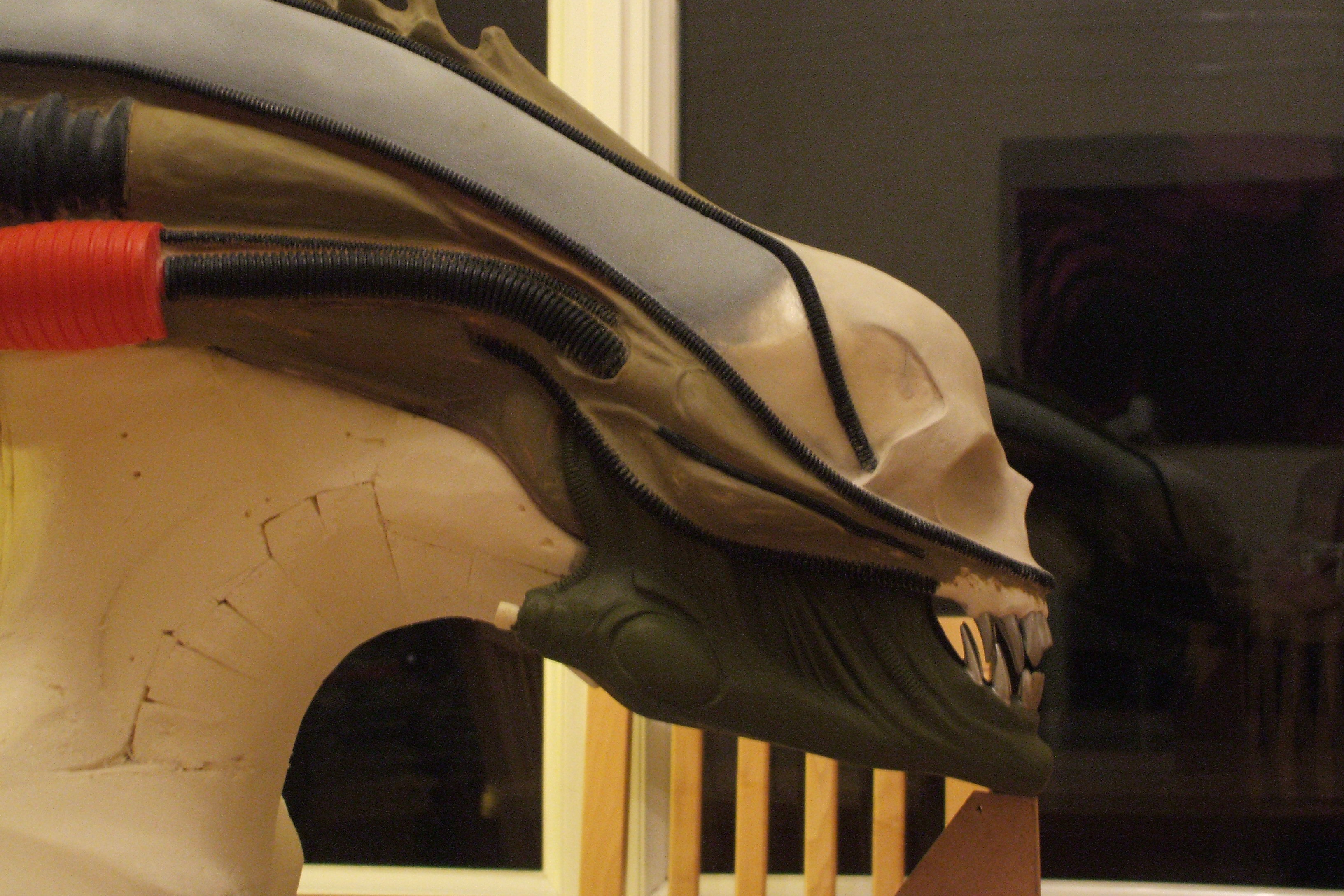

The new pipe for the sides hasn't shown up yet :rolleyes when it does I can crack on with replacing them & then re-working everything around them :)
Well, the pipe has finally turned up so I'll be cracking on with swapping those over soon.

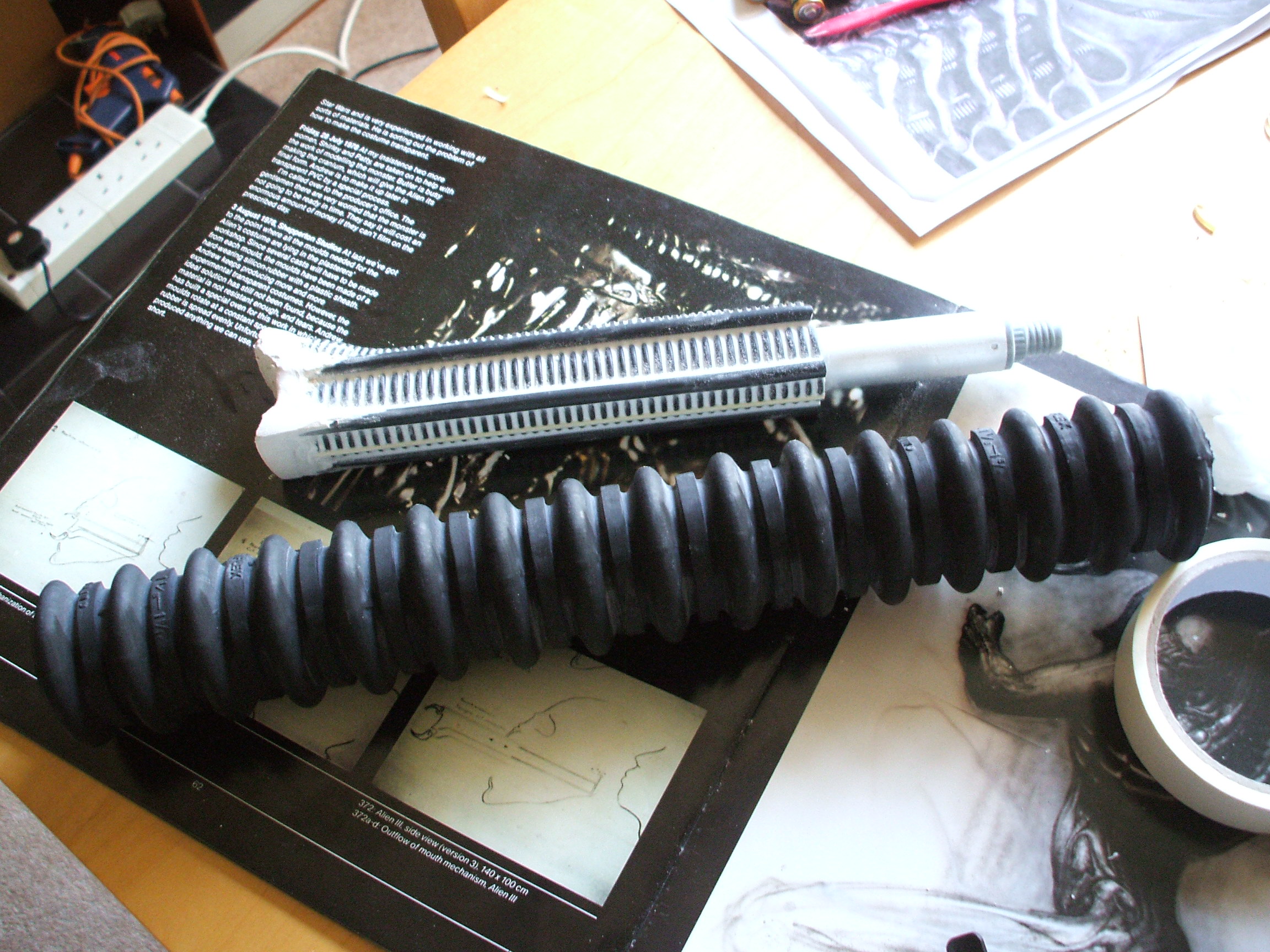

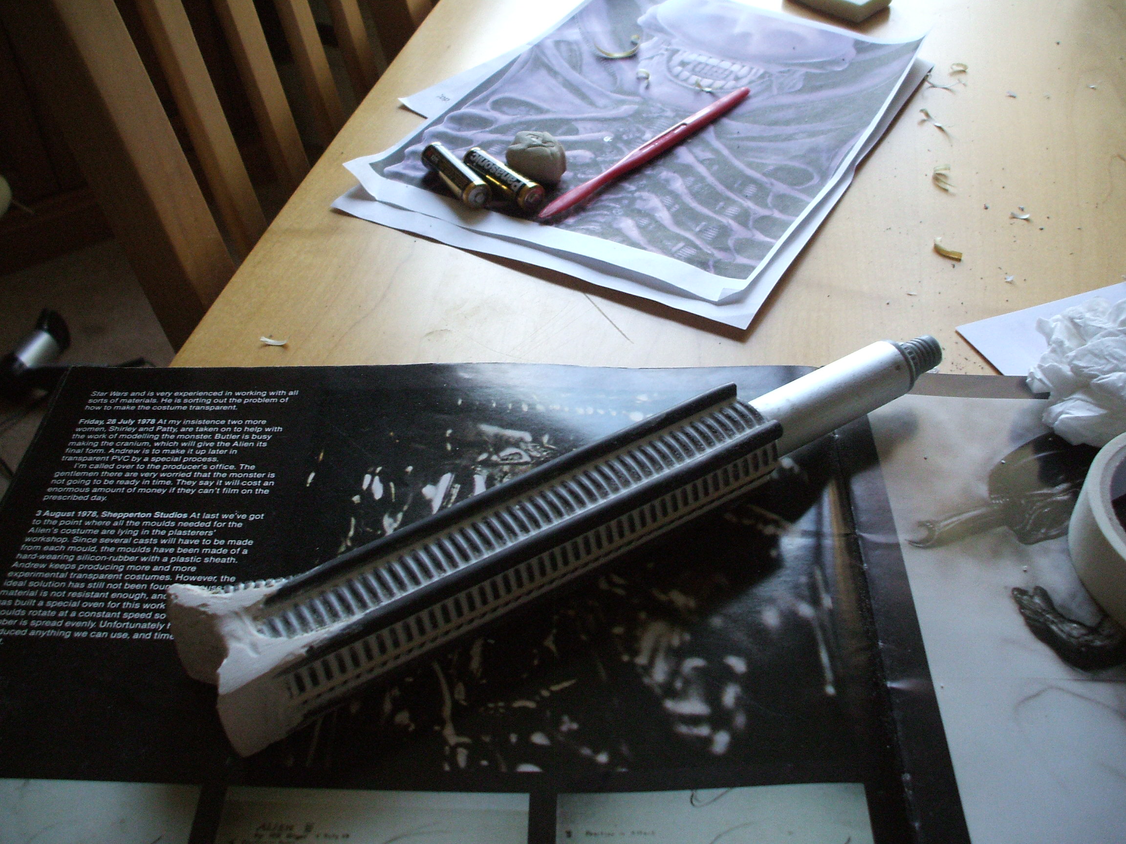

I started work on the tongue the other day, heres a little list of things I used to build the tongue so far:

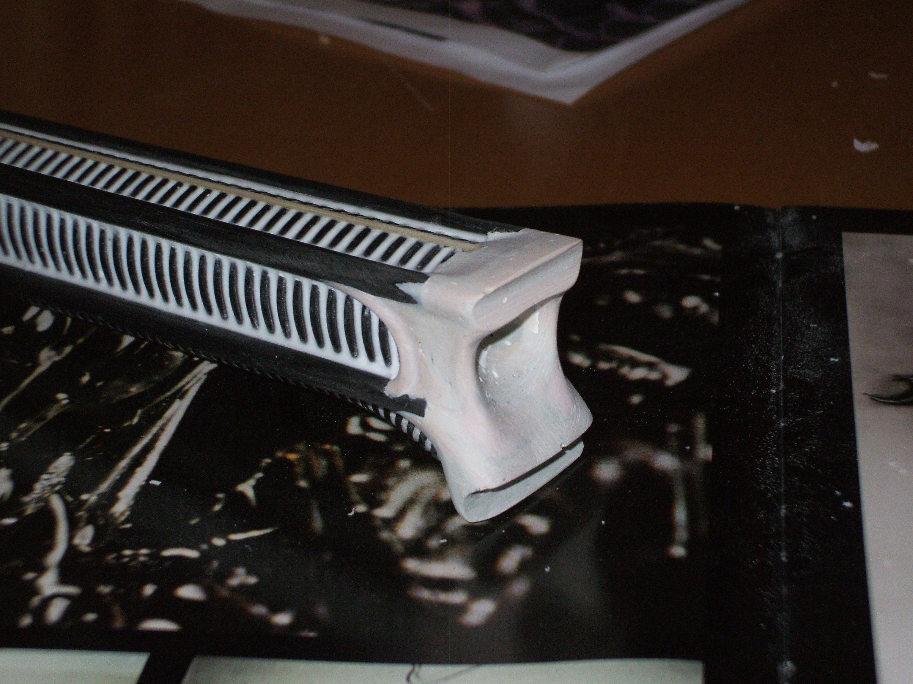

Vacuum cleaner hose glued round an aluminium tube, car loom trunking glued underneath, 4x power cable glued either side & its all blended together with builders caulking. The front part is a wip atm & is being made from car body filler:

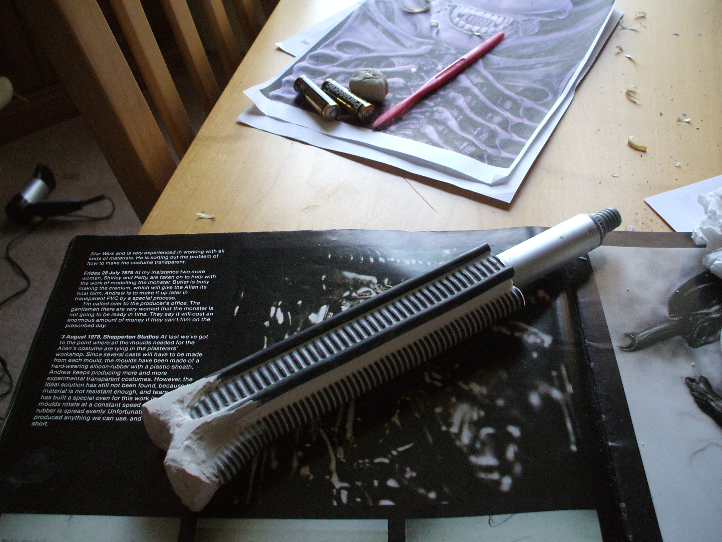

I've got some carving & sanding to do on the tongue this afternoon, I'll update that later.
Heres the pipe, cut to length, trimmed & ready to go:

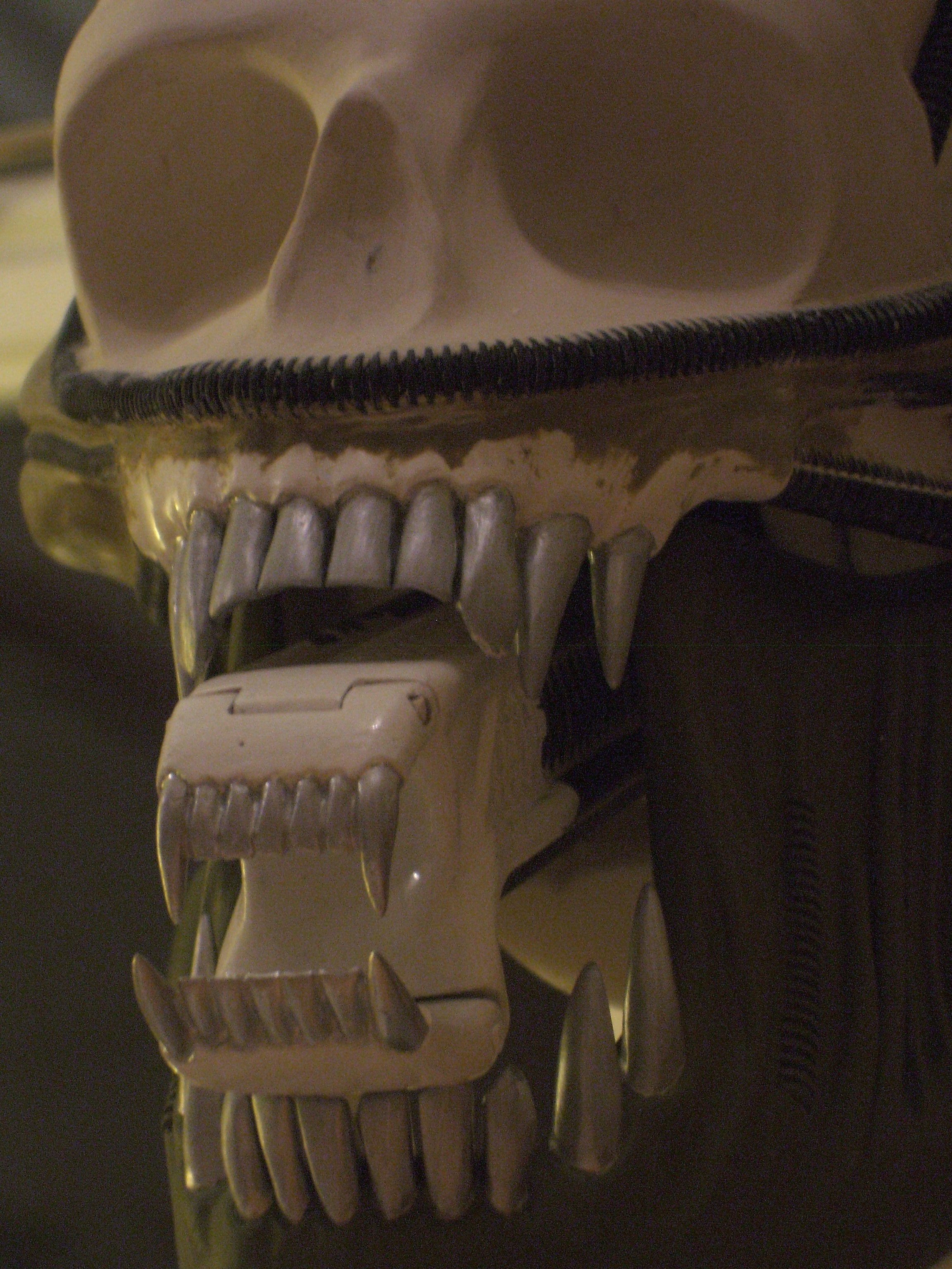

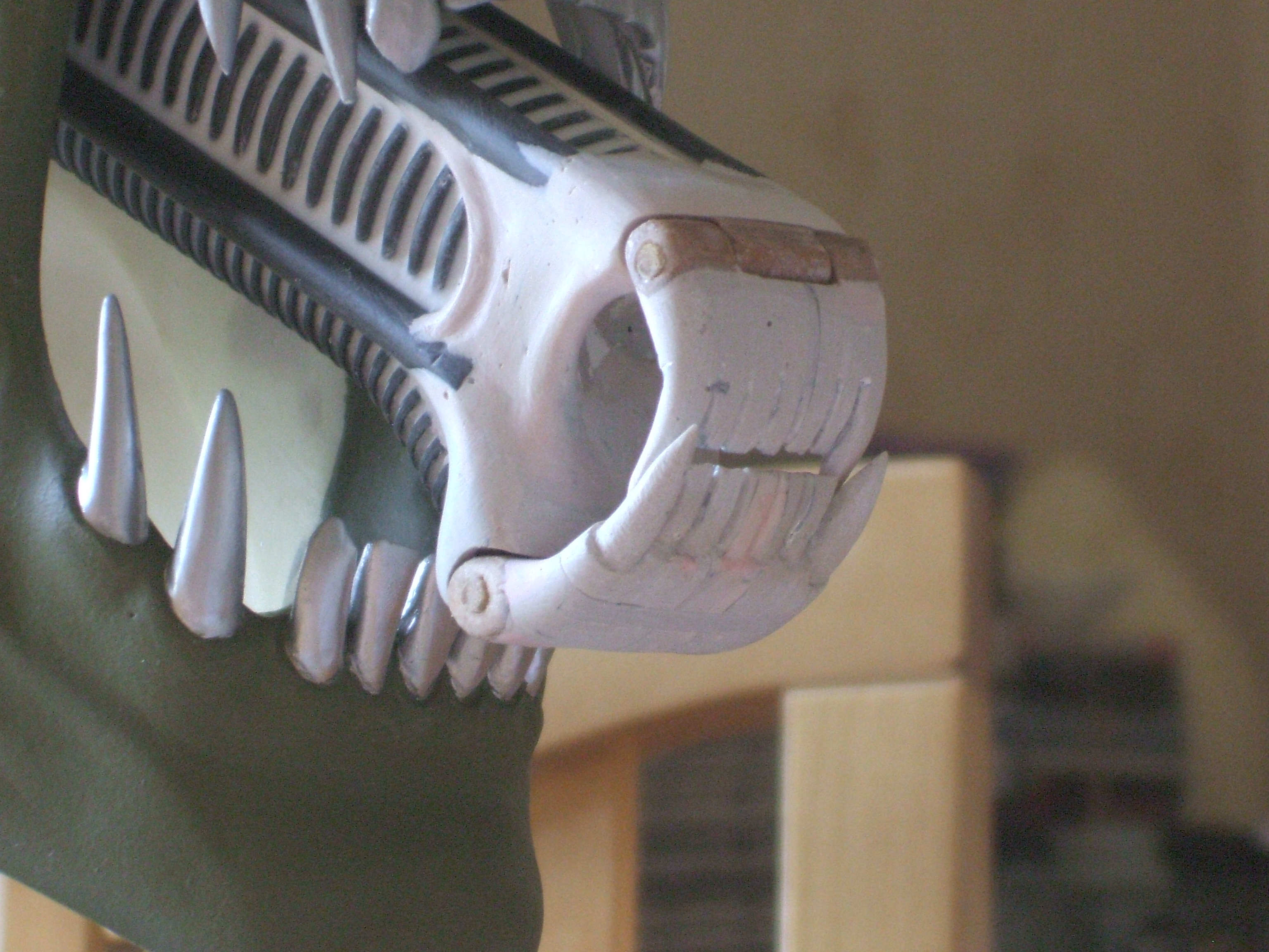

Carving & sanding done for now, just got to knock up some hinges & some teeth:
Headbite me!!!! ;)

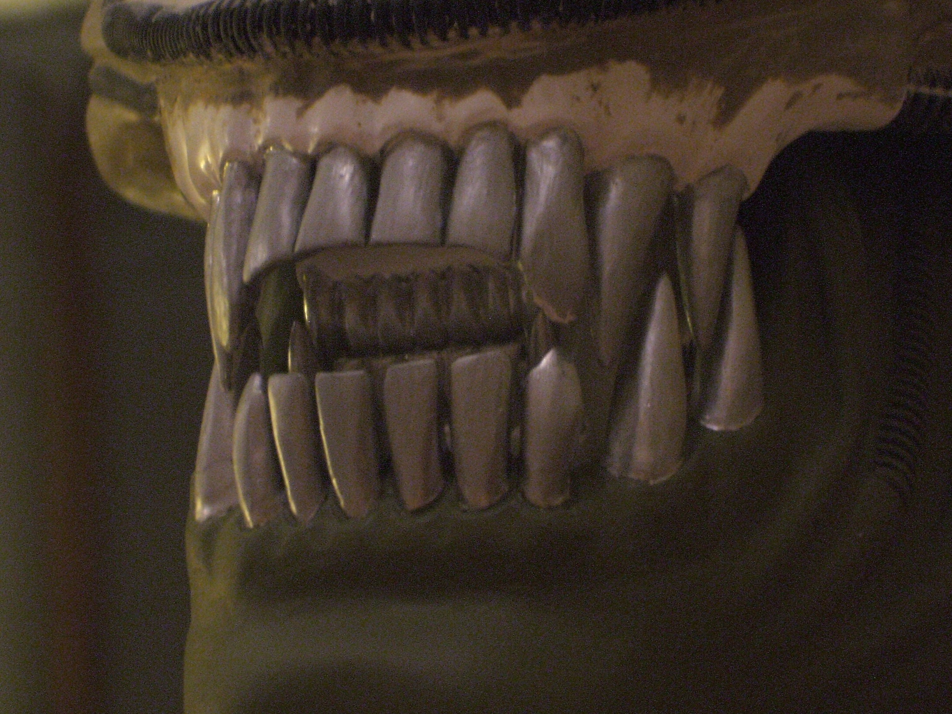

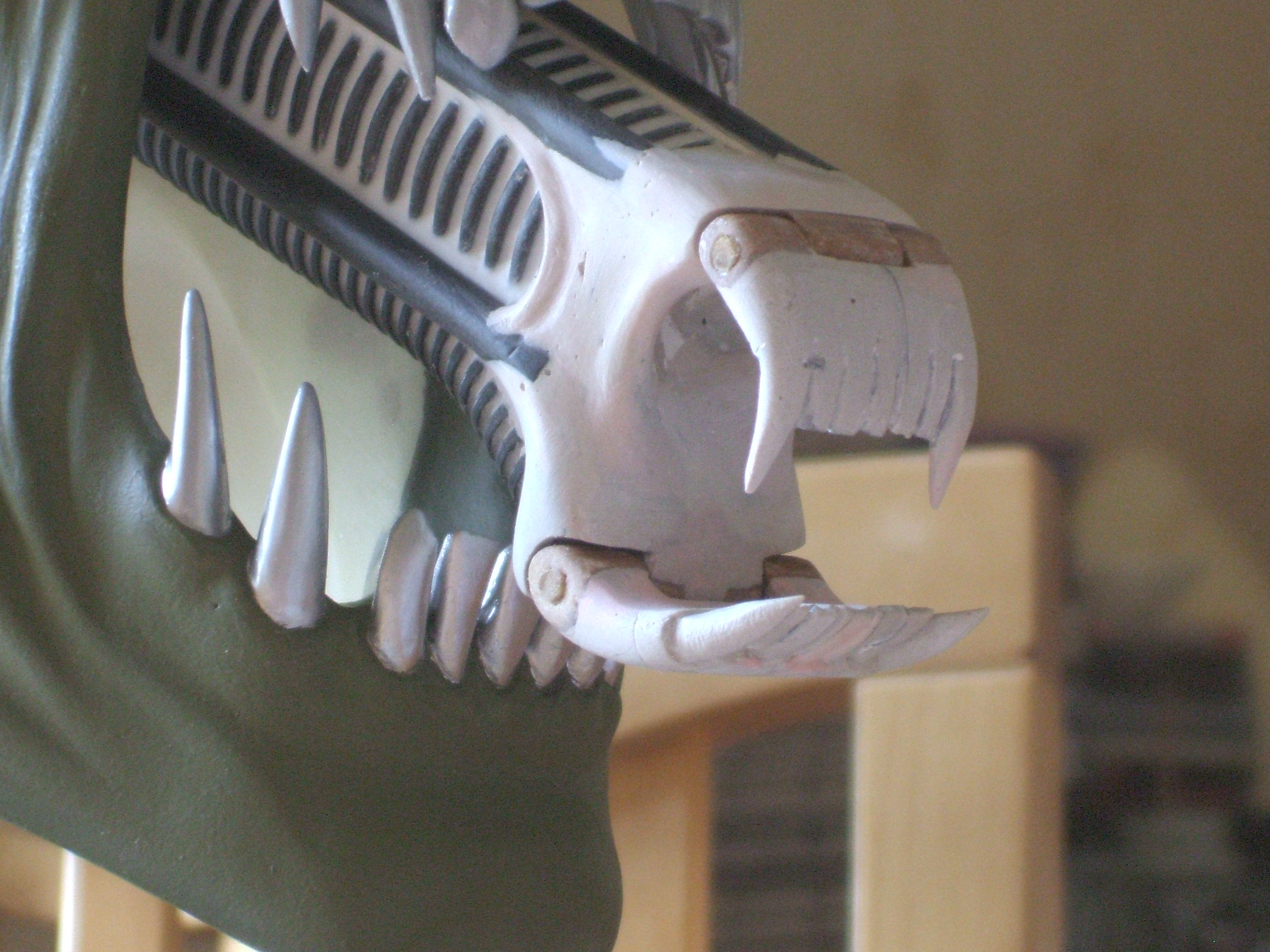

A couple more pics with a splash of paint:
I'm happy with the tongue for now.

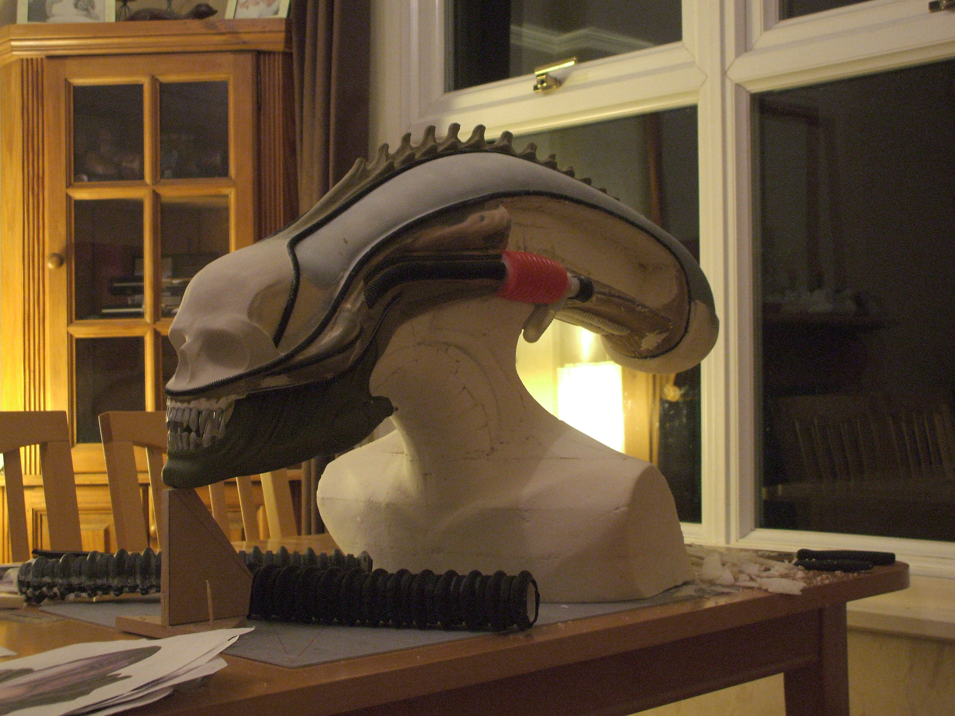

I've started surgery on the sides of his head:
As you can see......big gaping hole in the side of his head.
I've started to fit the new pipe in this side already & while its appart I'm changing the position of it.
Its a very disruptive job & I'll have alot to change arround the pipe aswell, the whole back end needs a bit of a re-think :confused

My plan atm is to fill the gaps in the hinges with non setting clay, mould it, then remove the clay & about 1mm off the carved areas to make it smaller & mould it again. I'll then have two moulds for it.
Then I can make a hard resin cast with the maller mould & hinge the wee jaws, make a soft rubber cast with the larger mould & slip the rubber cast over the resin cast so that it still hinges but you cant see the gaps if you get me.
I could also make the whole thing in just resin & leave it up to you guys to fill the gaps???

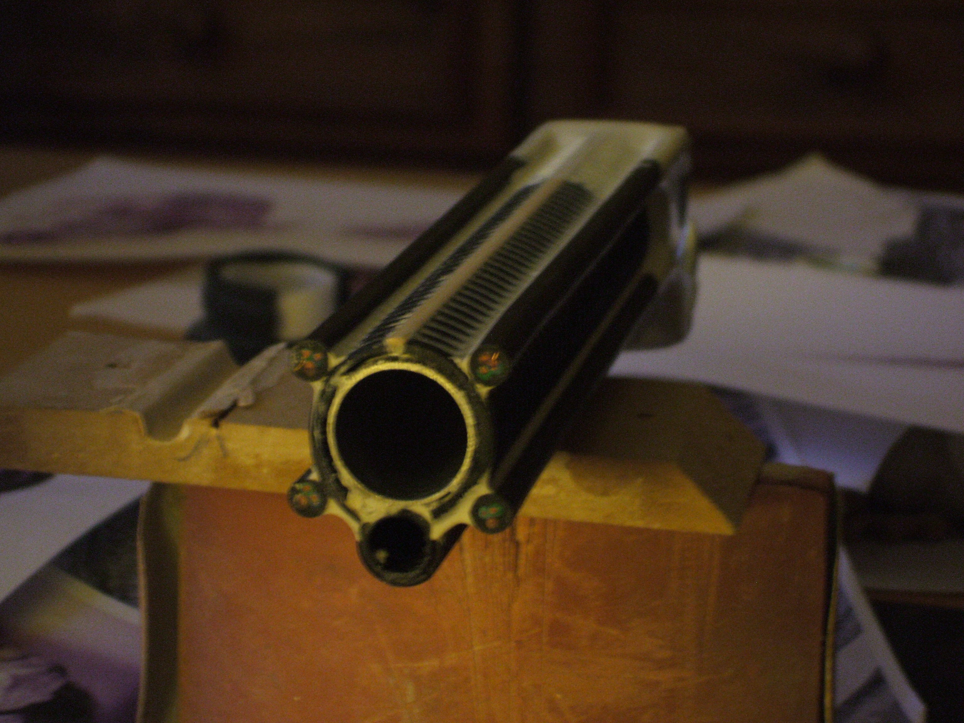

Hi Leigh,
Your build is outstanding! And I love that tongue. I thought it'd make a nice "souvenier" by itself in a display, and not "too" challenging for me.
But we seem to be divided by a common language. Could you define "car loom trunking" so that even a 'Yank' could understand?:lol
Or did you happen to take a pic of the tongue shaft 'before' the caulk went on? That might simplify things for me.
Keep at it man! You got skills!!
Cheers, Jeff

Thanks :)
Car wiring loom trunking or split convoluted pipe. Its used to cover the wiring on cars, you can often see it under the hood on cars like Honda's.
You can buy it very cheaply online in various sizes.
The tongue's components were all glued together with superglue (cyanoacrylate) & the gaps were filled with the caulking. The caulking was applied with a gun then worked into all the gaps with a finger & the excess was washed away with a sponge & water to leave the white bits you can see in the pic, then left to dry overnight.
Heres another pic looking at it from the other end. Here you can see the construction clearly, the white area's are the caulking:
