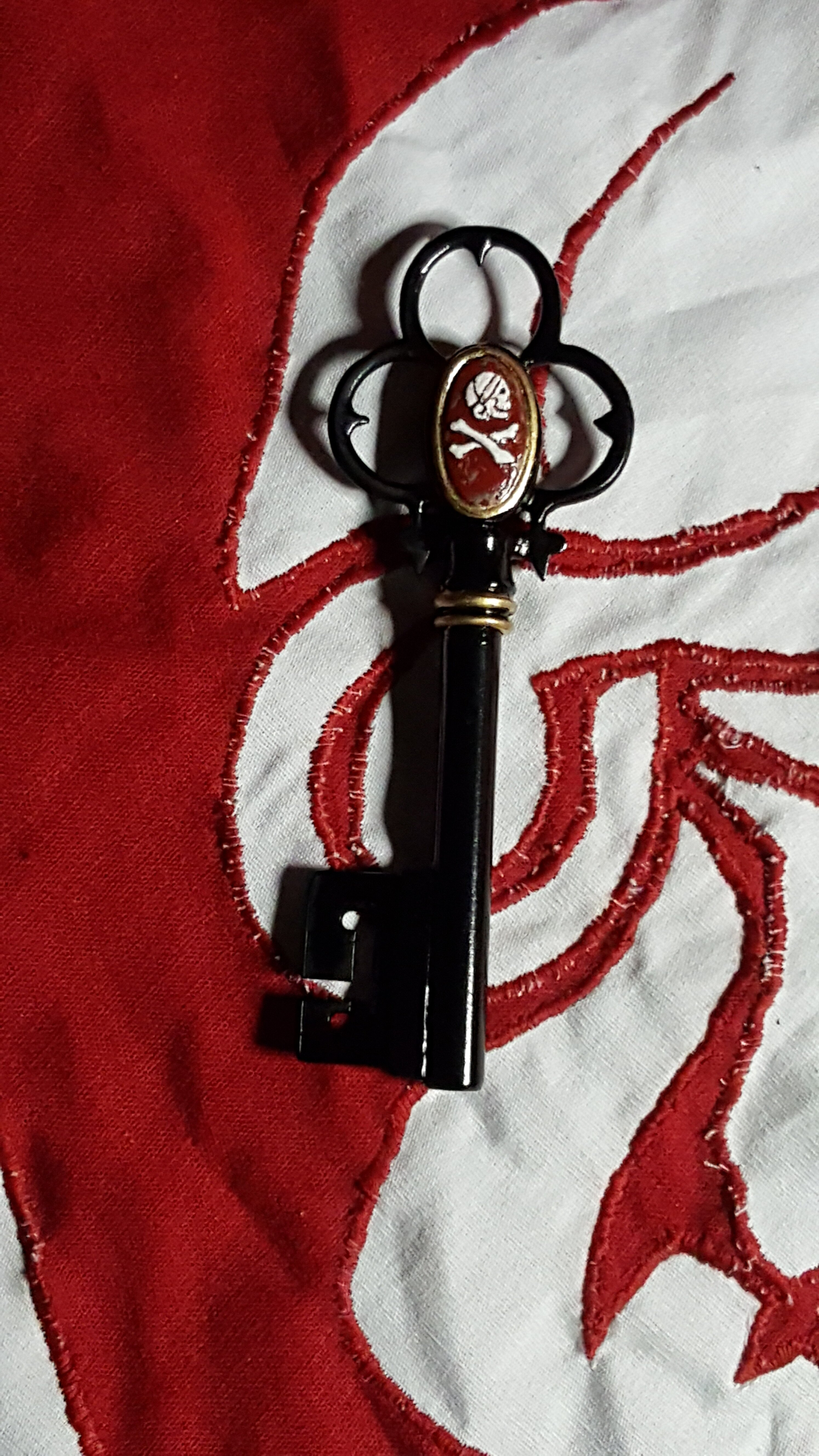

While not period accurate, I made Henry Avery's flag (single sided) from Uncharted 4.
I used light cotton scraps that I had laying around.

Now, if you just display that flag, you wouldn't need expensive bunting wool...unless your plan is to fly that flag on a ship over salt water/wind/rain, etc...I would do what division 6 did: black cotton/heavy cotton + stencil of your skeleton in white paint.;)

But yeah, it doesn’t need to be wool bunting. I would wanna do it doubled sided and sewn, though. Like Division 6’s flag above.
