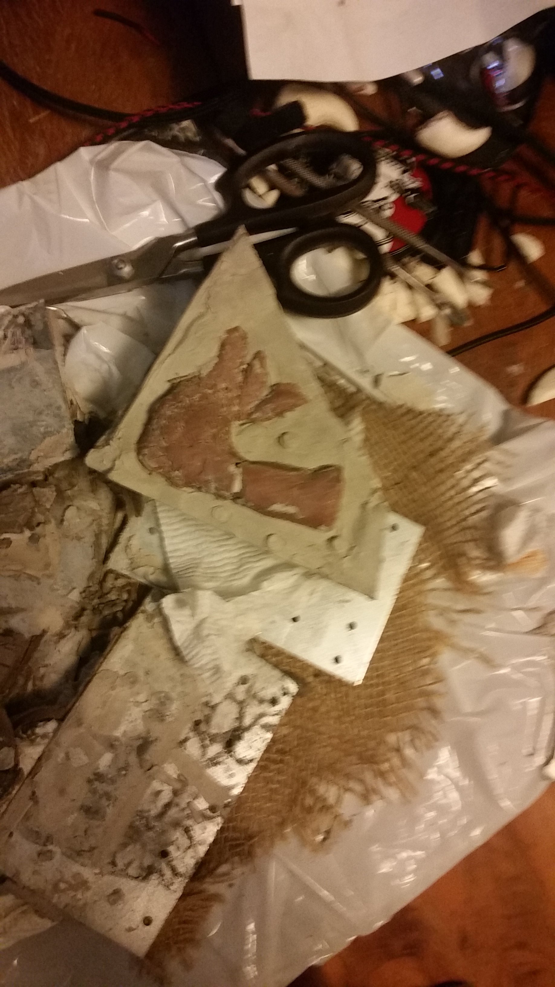

Alright, thanks again for the encouraging words and tips, just mixed up some ultracal, and poured the first half to the the left mandible mold. Added some burlap, and when the time comes to do the second half I'll make sure to add some petroleum jelly, and then wait lol
*another warning*
Small keys like that will bite you in the ass. That works for silicone molds but not stone molds. They will either lock your mold or break off.
I like to be a little more "landscapey" with small molds. You can vary the level of the mold one good time and they will be keyed together really well. I found the pic I was looking for. This is the 1/6 scale dread mold I made as a test. The 'dot' keys didn't work well because of variations. They need to be shallow and wider do work without locking. In the end this mold keys together really well but the edges of the holes in the keys where chipped a little. This mold is made from an Ultracal and is pretty thin with no reinforcement.

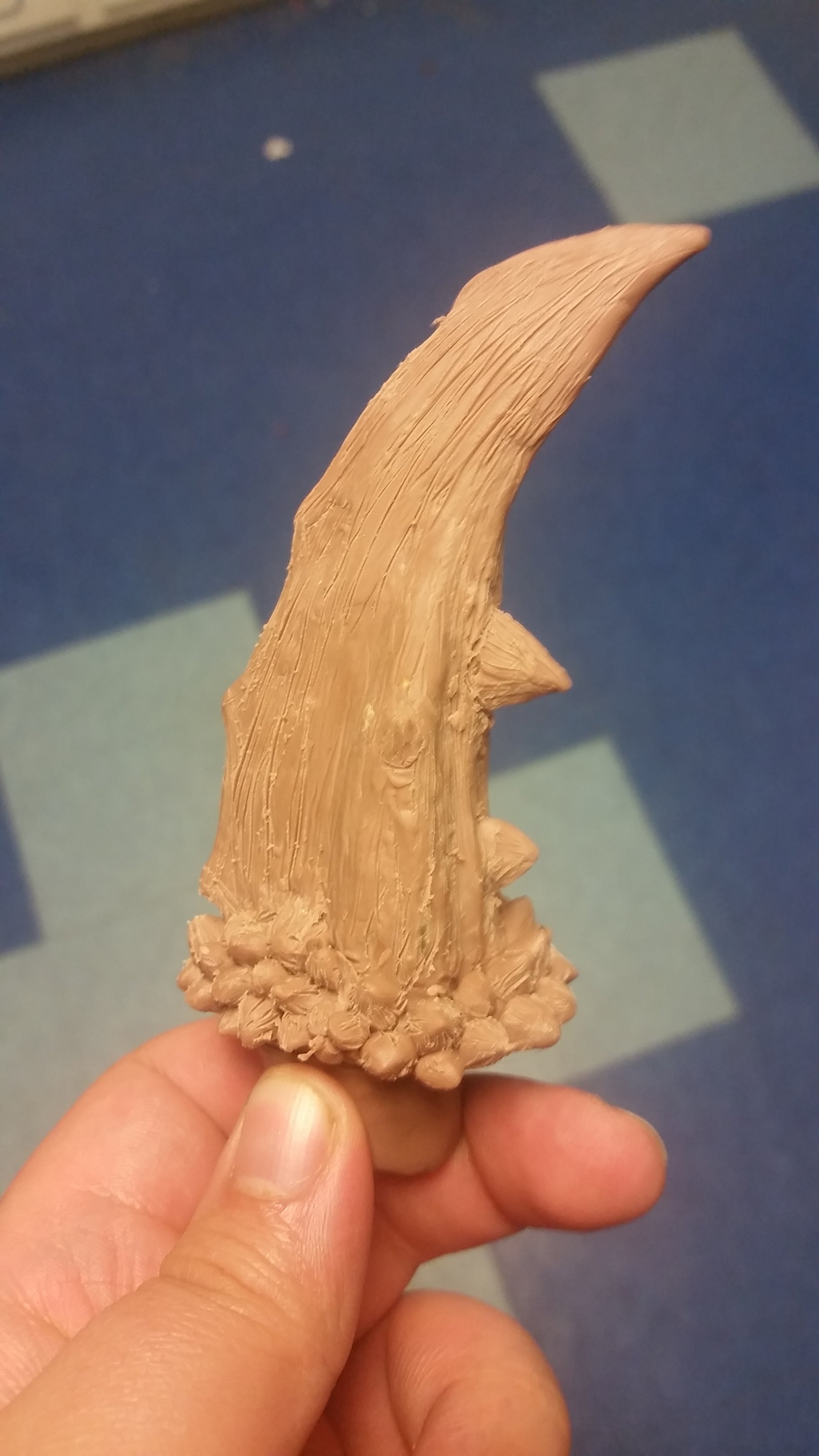

Still waiting for the mandible to cure, Howeverdue to the fact o don't have high hopes for it I decided something was off with Behemoth. .. I made some new lower mandible teeth, and am allot happier. .. I also moved the lower Mandible teeth to the top ... and I really like the look! Currently molding the new teeth
