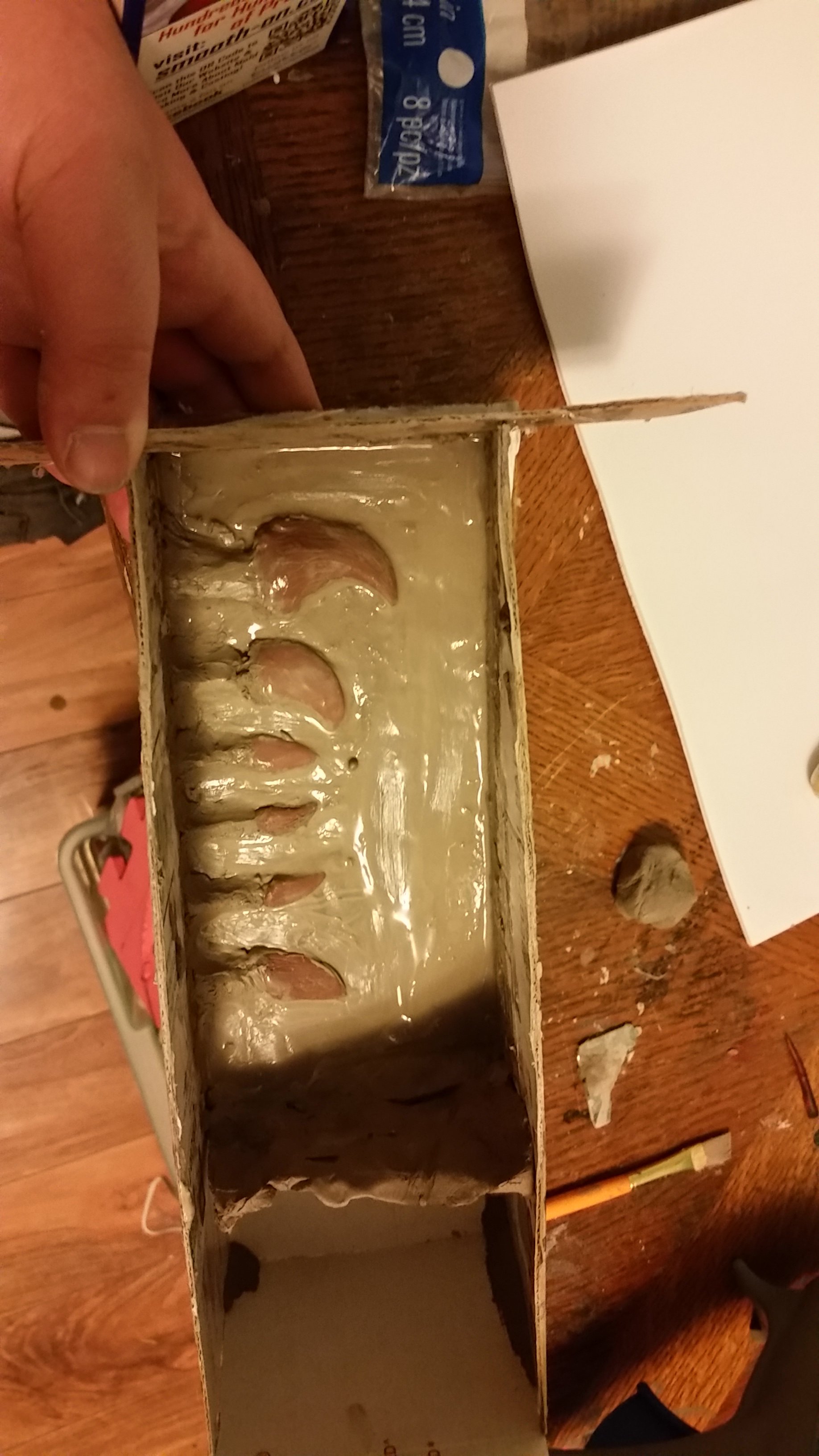

Now molding some of the teeth, I think I will need more rebound25 to finish the rest of the teeth and mandibles. Also, I did forget to take a picture of when the mold keys were in place.

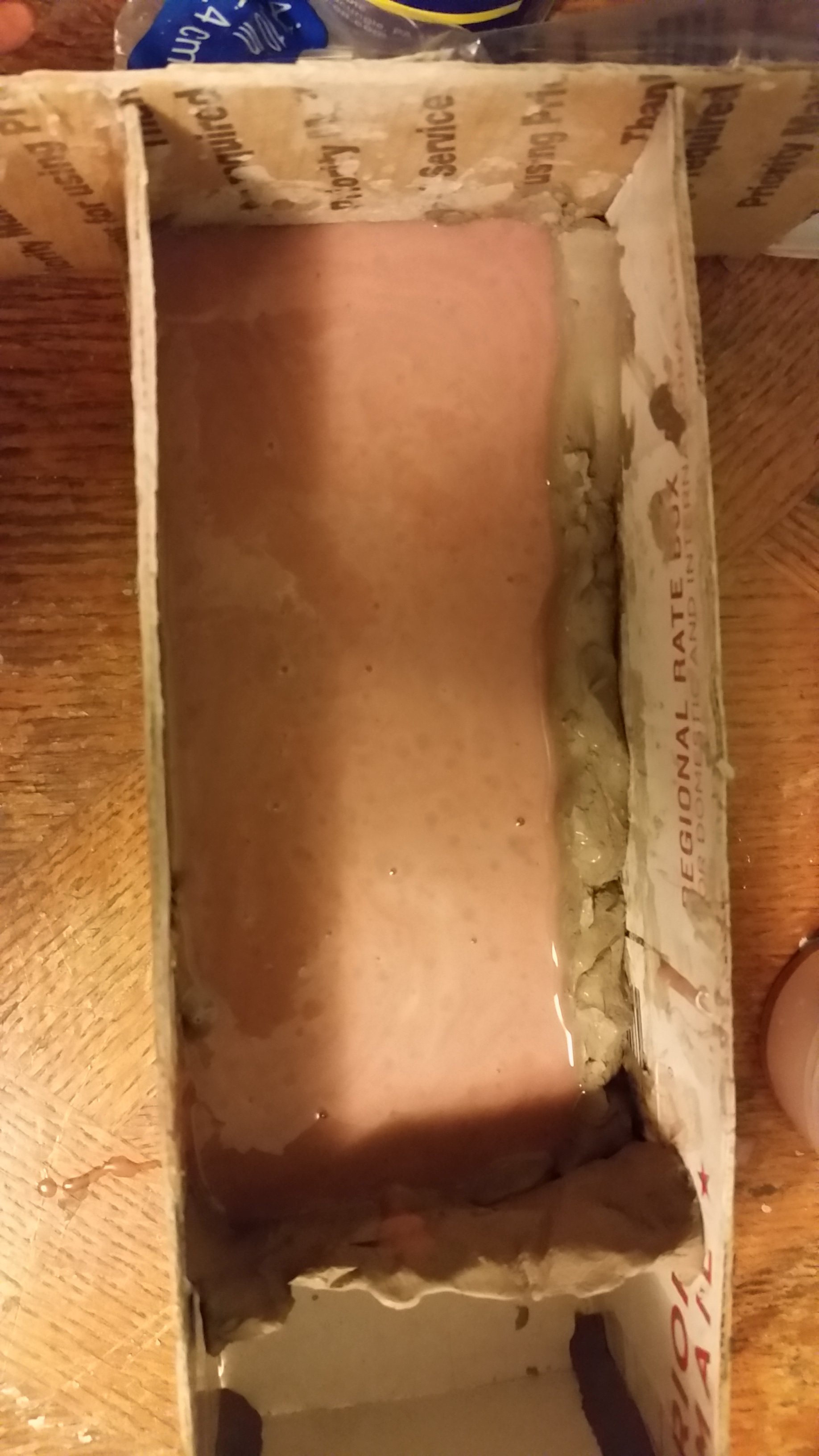

Aaaand I just got informed I made a mistake, it may not cure due to me forgetting to seal it. Also, I poured it on, and from what I could tell it needs to be applied in coats ... fingers crossed though!
Sprayed the mold and teeth with smooth on universal mold release, and now waiting for the second half to cure.
