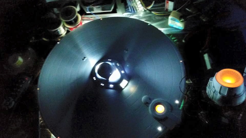

The clear parts make it easier to give a light effect for an area with a spotlight on it?
A technique I believe called Raytheon lighting
essentially you put the LED on the inside right against the area, sand a bit of you light blocking away and the LED makes the plastic shine like there is a spotlight on it.
This is not my pic, but it gives the idea
