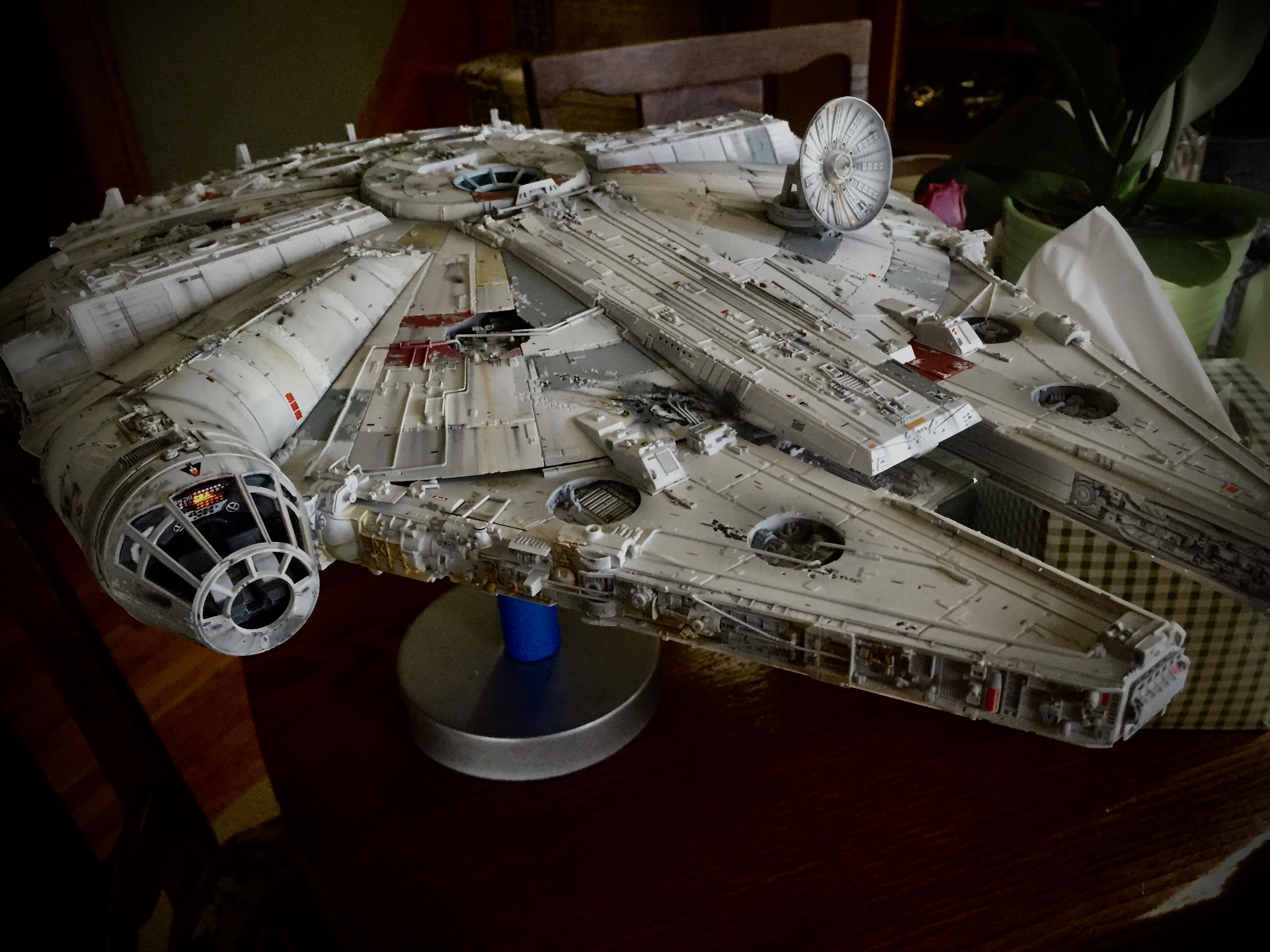

Bandai 1/72 PG Millennium Falcon (also the Revell Germany rebox)

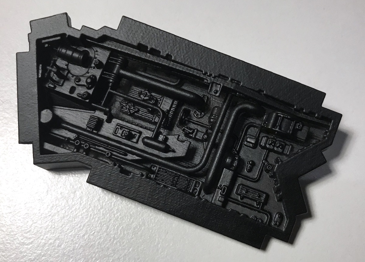

Final ESB maintenance pit, with a bit of black primer.
Then I had to put too much AS-20 over it, and wrecked it. Dammit!
Unfortunately that’s a 3D acrylic print. It’s pretty absorbent and what works on styrene tends to trash prints. :/
Phew!
The paint hadn't cured - I sprayed it yesterday. So isopropyl alcohol was enough to dislodge most of the offending material! And in my experience, IPA seems to dry out 3D printed plastic but doesn't destroy it.

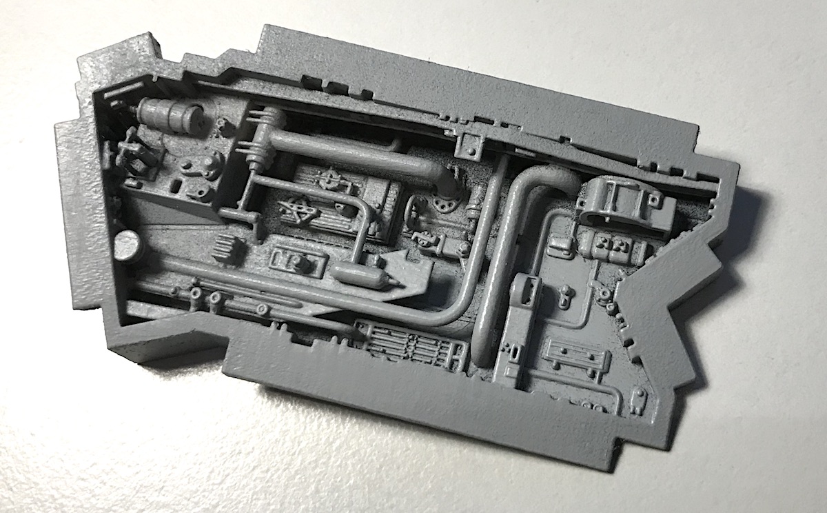

Salvaged and resprayed with a little Tamiya fine grey primer.
3D printing is so awesome. After weeks of work as this virtual thing on my screen, now there's this actual physical object. :)
Also, I should note that this is the "busy" version of the pit. In addition to all the components that I could see in the documentary photos, I've filled in a bunch of blanks with other stuff for fun. Mostly based on other kit parts from kits known to have been used in the five foot Falcon.

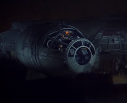

I must have glanced over this, it's hilarious that you got a little light in there! I never thought that could have worked, but it looks like you got it spot on.
Yup, that was one of the reference pictures I used! I drilled into the back of the upper control panel and embedded an orange nano SMD I got from modeltrainsoftware.com. On the 5-footer it looks like the control panel graphic was photo etch or some other opaque material with the circles cut out. I tried to make a decal using your graphic, but it was too transparent. I ended up printing the graphic twice on regular #20 paper and overlapping the two prints. That makes it just translucent enough to let the right amount of light through. It would be great if someone could make a photo etch for your piece, but what I did worked. The 5-footer obviously had other lights in the cockpit, but there's only one shot in Empire (underneath Cloud City) where you see anything besides the one upper control panel. Thanks for noticing!
