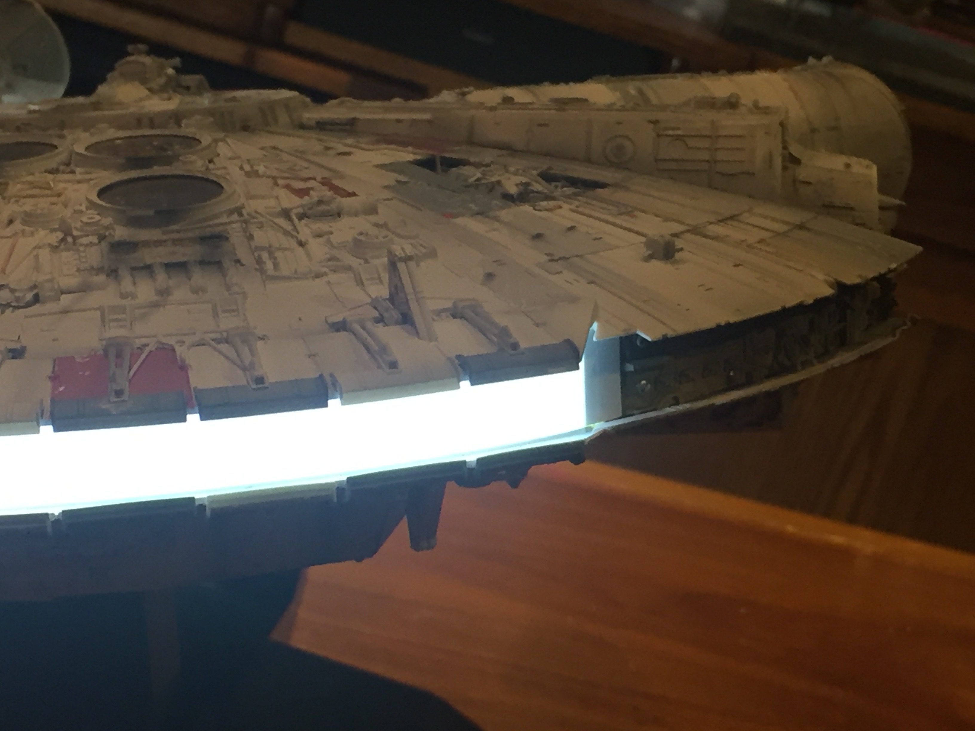

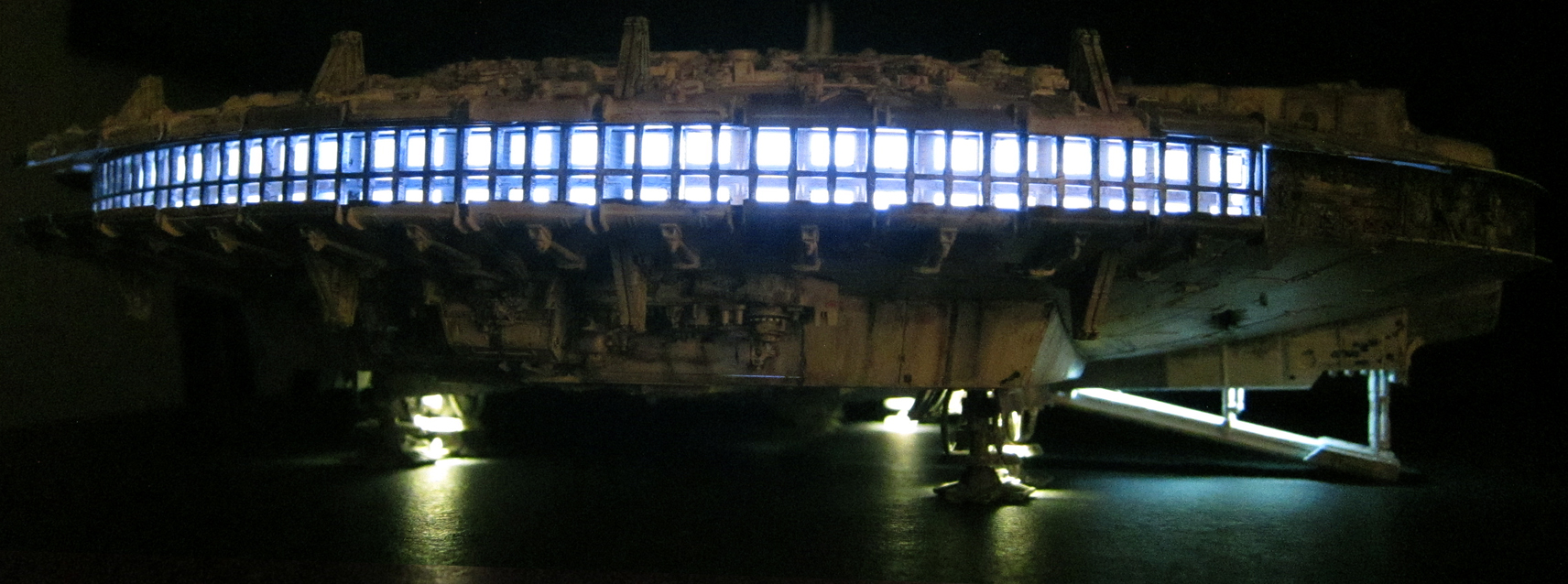

What to do, what to do? The grille looks better when powered off. The milky plastic looks better powered on...

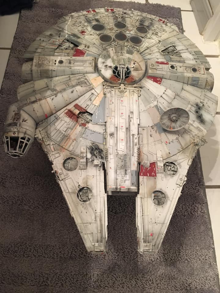

Anyway, hey look... a Falcon PG pic. With engines lit:

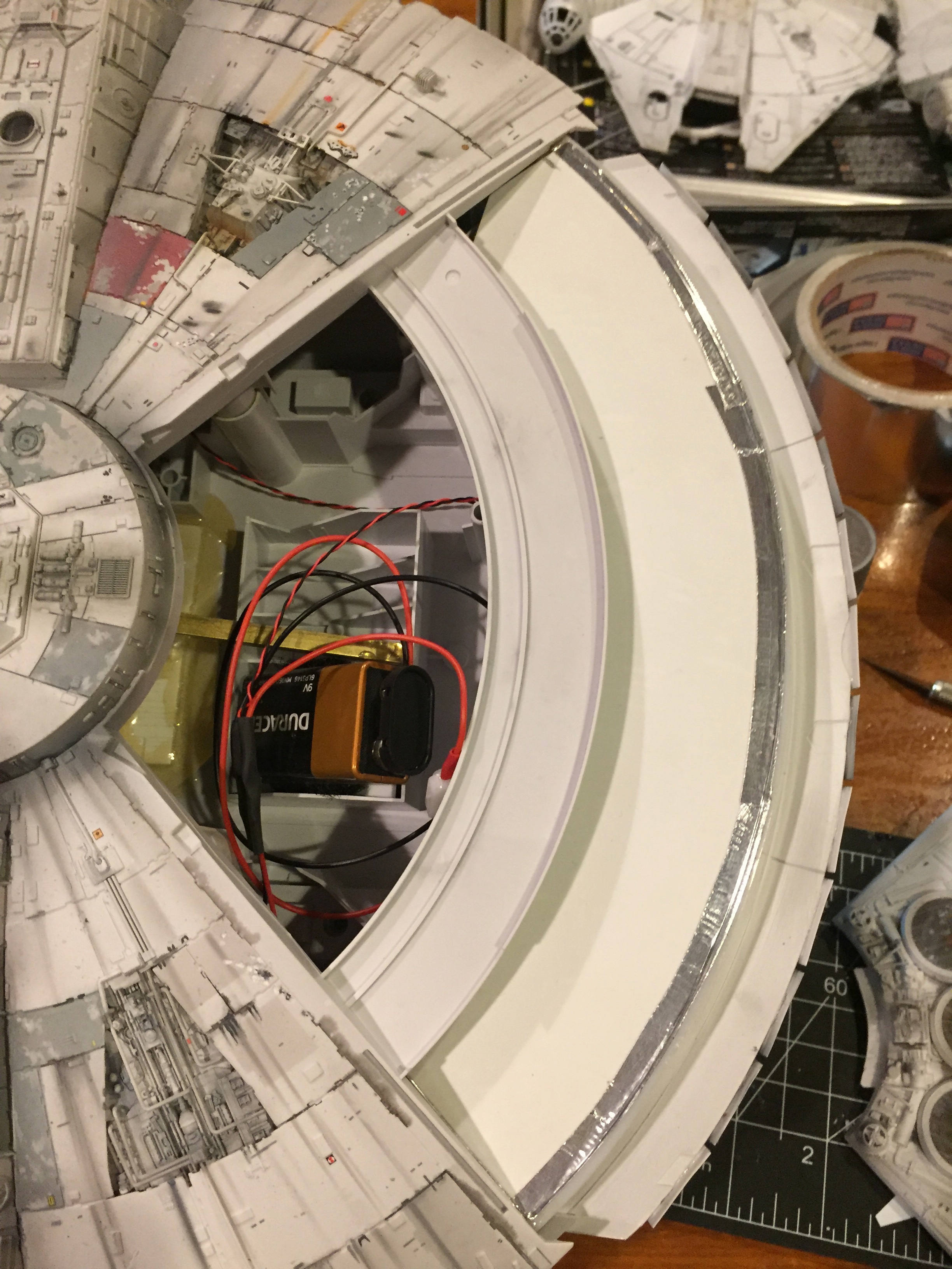

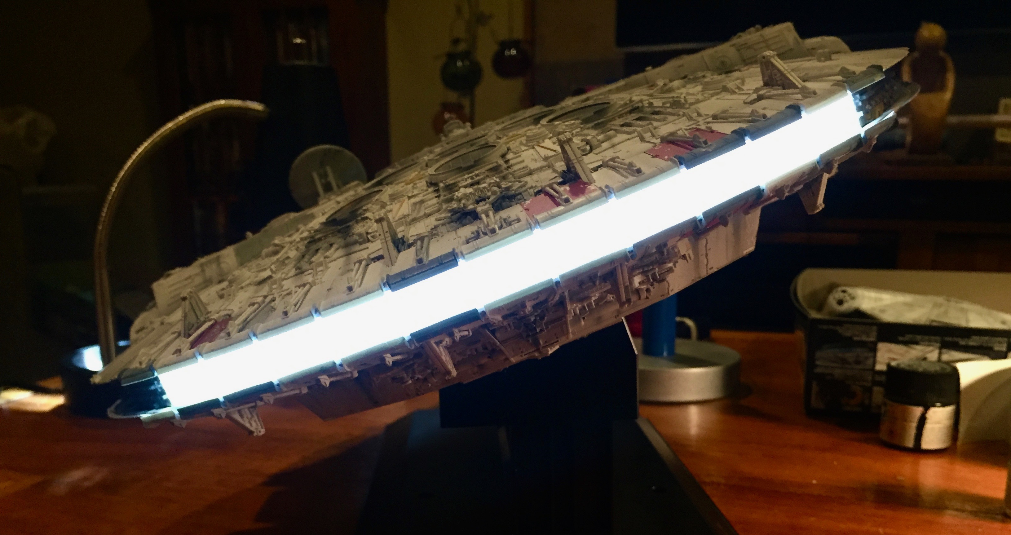

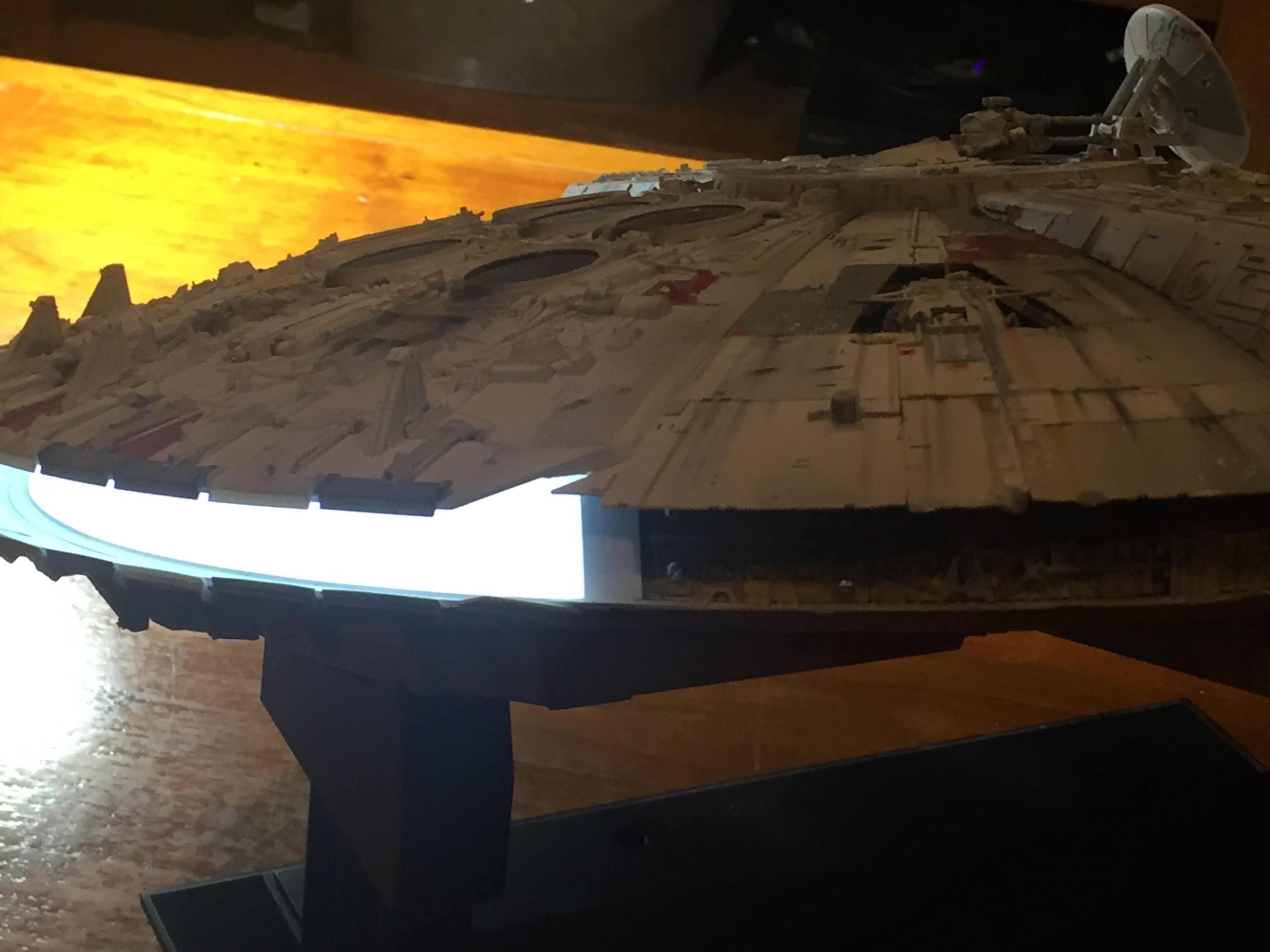

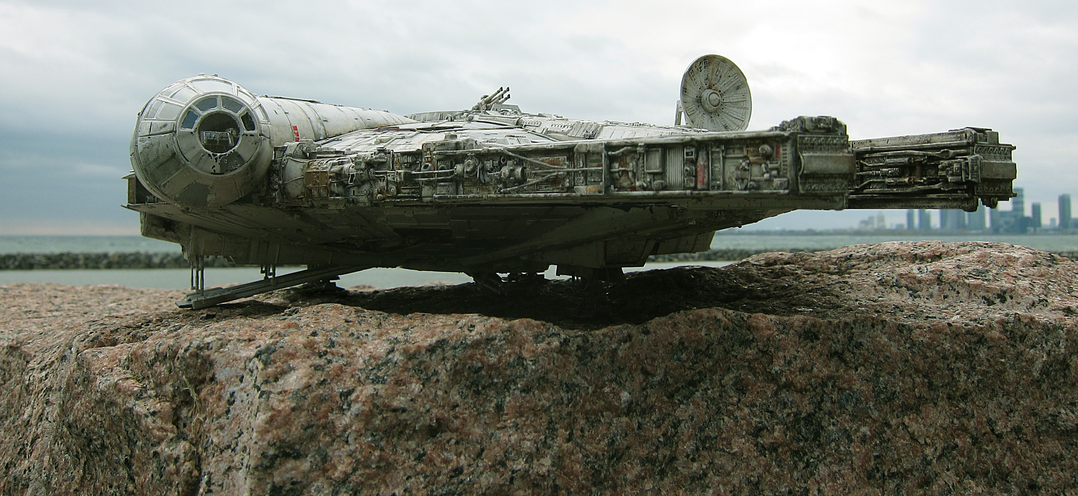

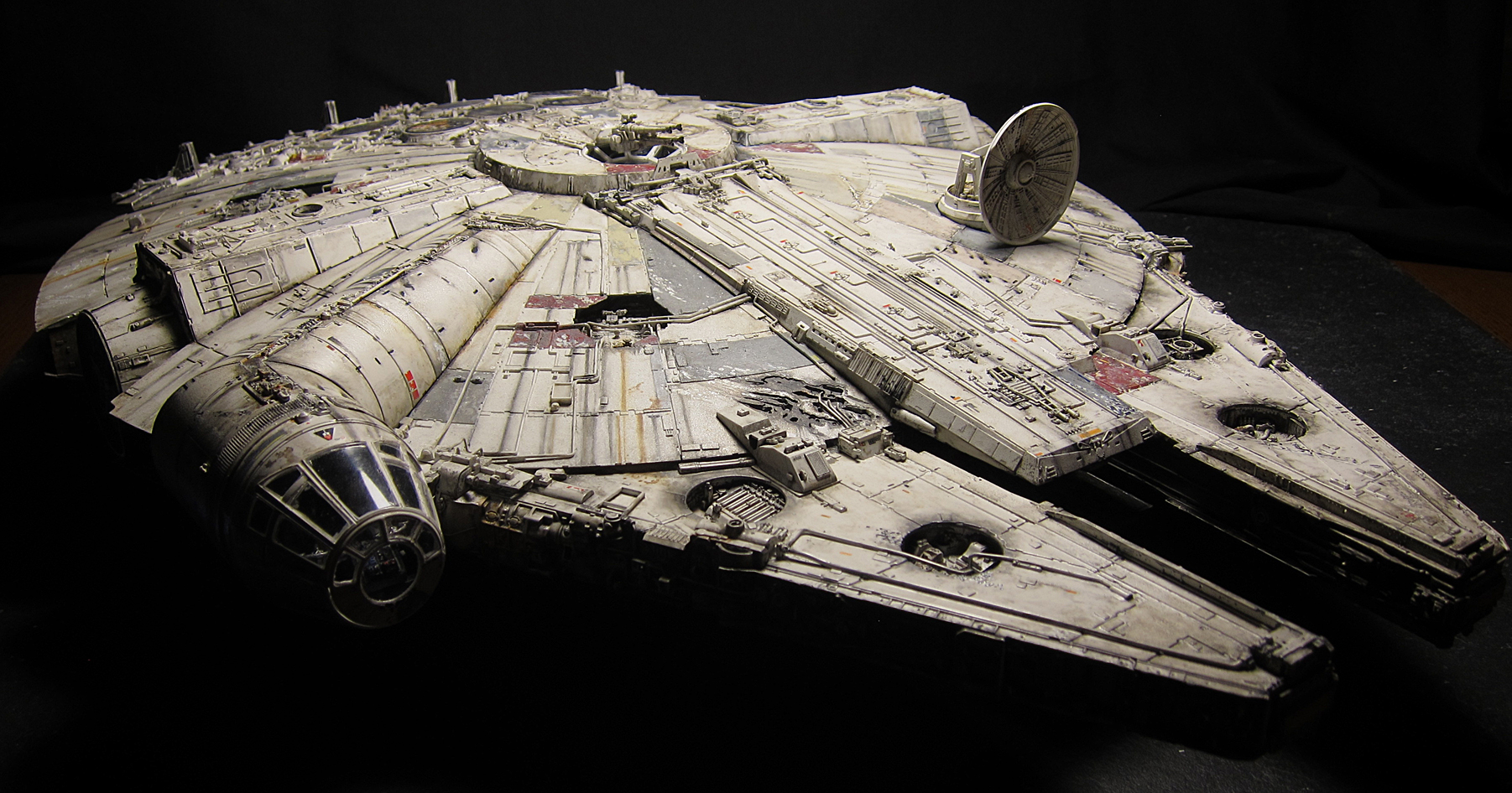

Thanks guys! The engines are one of those compromises where you have to pick your poison. There's virtually no way to get a screen accurate (at least OT) glow using the grid, but without the grid the "parked" look is just a white strip. That was a contributing factor in my idea to make this build represent a specific snapshot in time for the 5-foot model. The solution was pretty simple: the two rows of LED strip lights were stuck directly on the outer arc of Bandai's translucent diffuser, using the diffuser only as a support. I got the "milk glass" as an acrylic sheet at a home improvement store (Menards) and bent the cut strip using a heat gun around a metal form of the same circumference (a kitchen stock pot). Then I taped curved sheets of white styrene above and below the finished assembly to act as a both a light block and to help bounce the light around behind the acrylic strip a bit.

Excellent! I've used some higher end light diffusing acrylic in the past on my MPC adventures, works pretty good. I cut a piece of a 2x4 with the same curve as the ships read end, then I'd cut the strip of acrylic and balance it on the wood, stick it in the oven till it softened up, then reach in and pull it out with welding gloves and form it to the wood by hand till it cooled. I tried the old lady's hair dryer on hot but it seemed to take too long. my method crude yes, but effective. I love what you've done here, it looks nothing short of perfect! :thumbsup

Sweet, thanks for the summary. I may totally rip your idea off as it looks much better than the grill, to my eyes at least. Don’t get me wrong, I do like the grill, but this just brings me back to when I was a kid and first saw the Falcon. Would I be going too far if I asked what dimensions your ‘milk glass’ acrylic strip was cut to?
RIP ME OFF! I rip everyone else off, it's only fair! :lol The strip is 5/8" wide. The length was determined after I bent the strip by putting it into position. I'd make the strips cut from the sheet of acrylic extra long not only so I could get a nice clean arc when I bent it, but also so I could get 2 or more strips per bending attempt. This way I was able to get 6 or so good quality engine pieces and sold the extra to other RPFers. If I ever make another one of these (and I'm considering it), I'll bend up some more and let people know when they're available.
That's brilliant, thanks very much mate. Appreciate the advice.

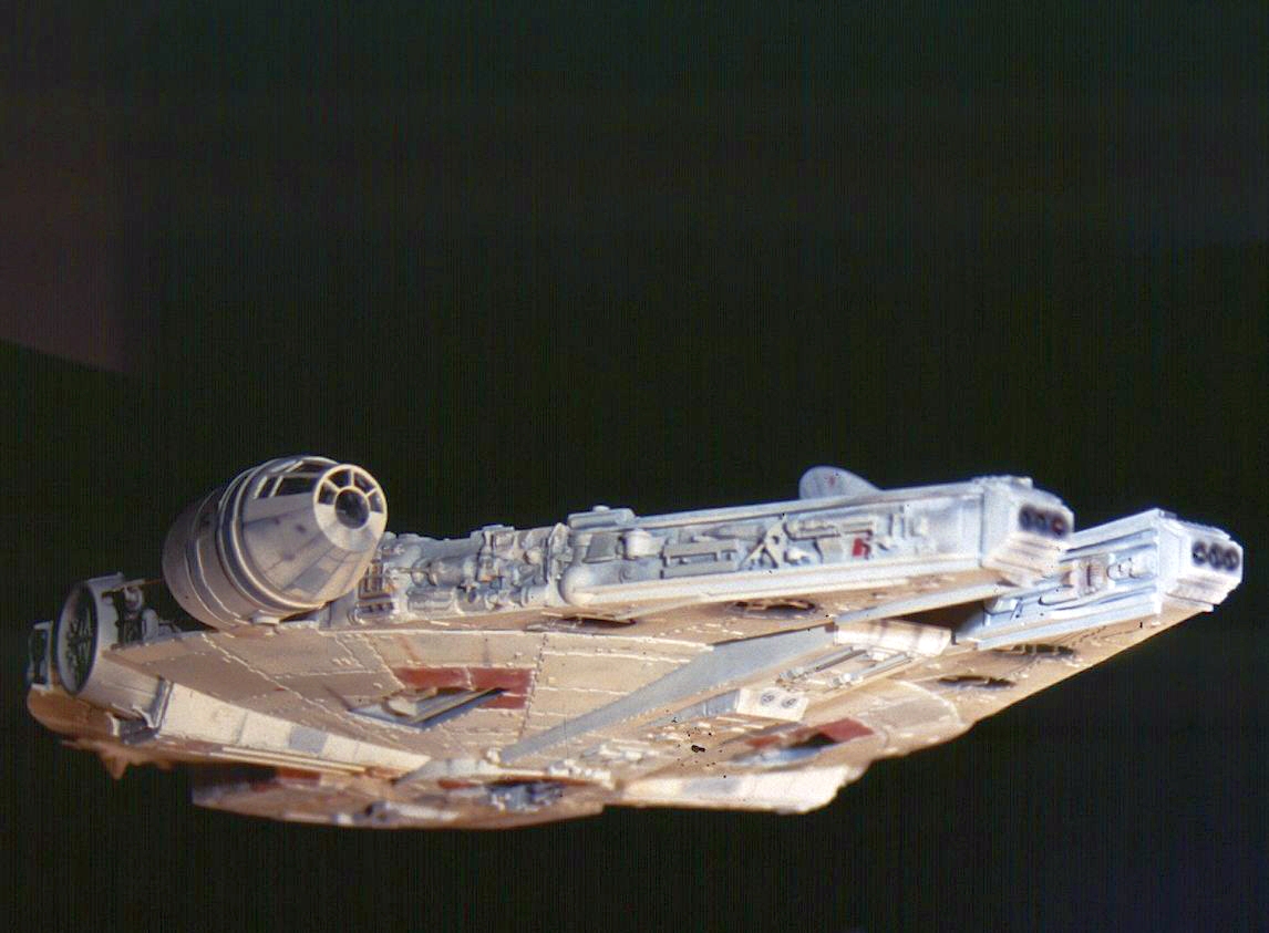

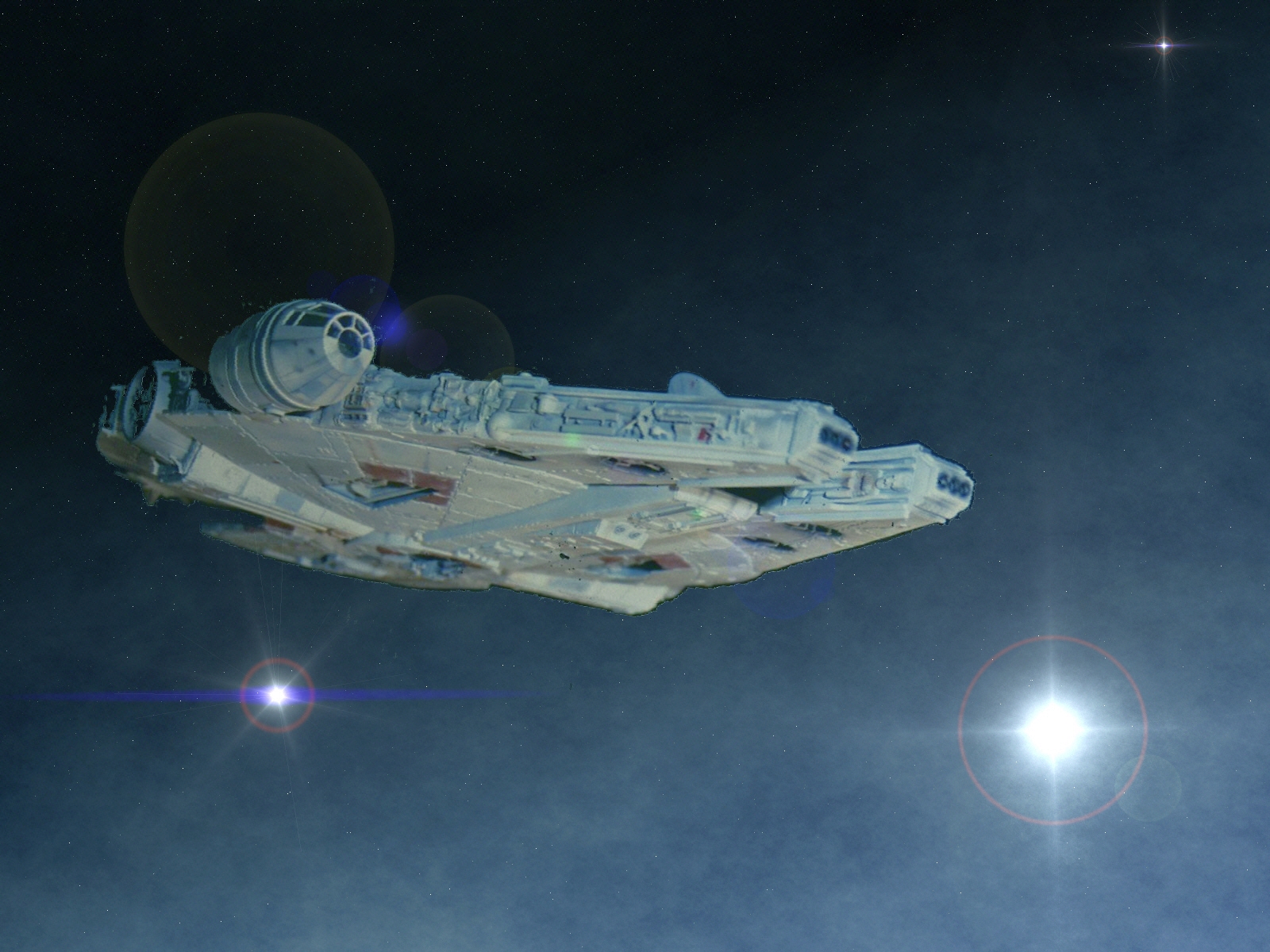

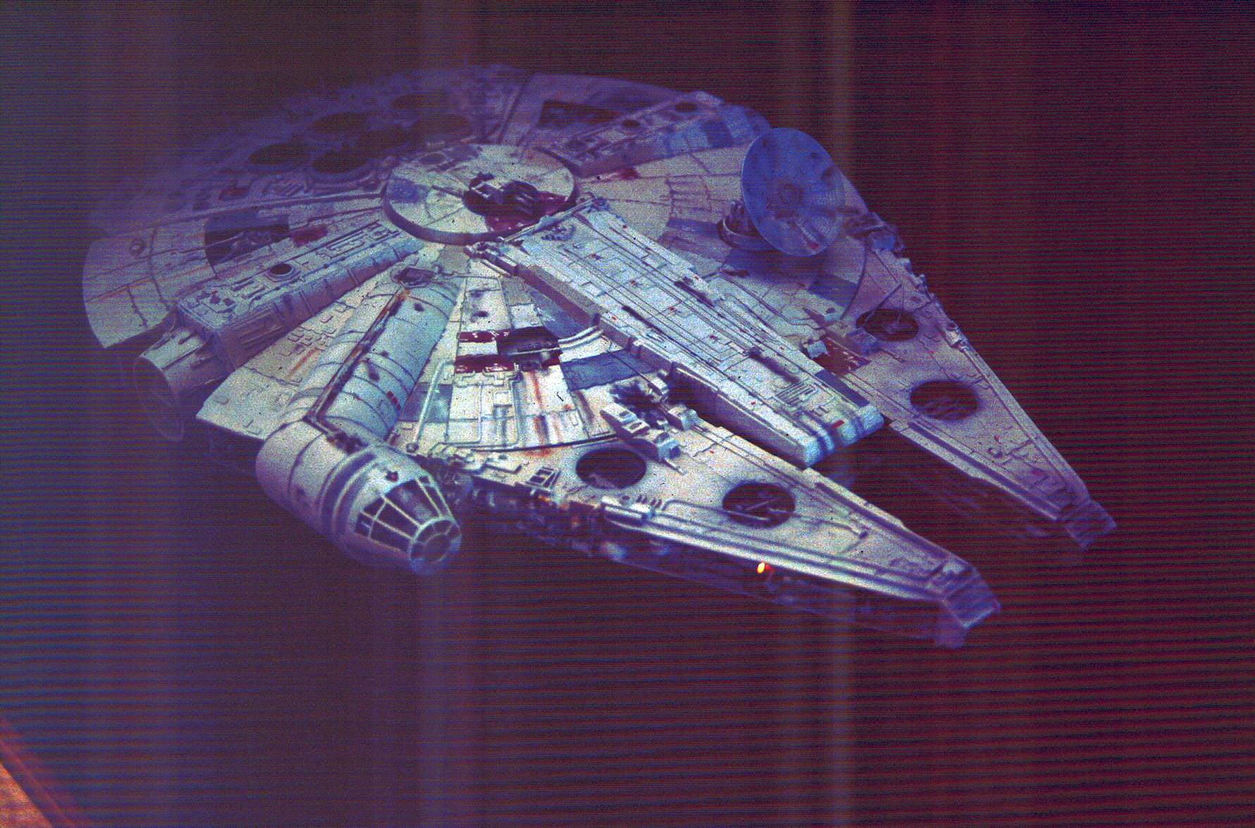

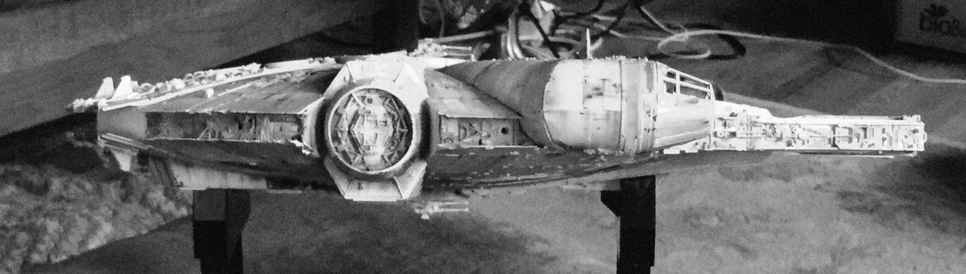

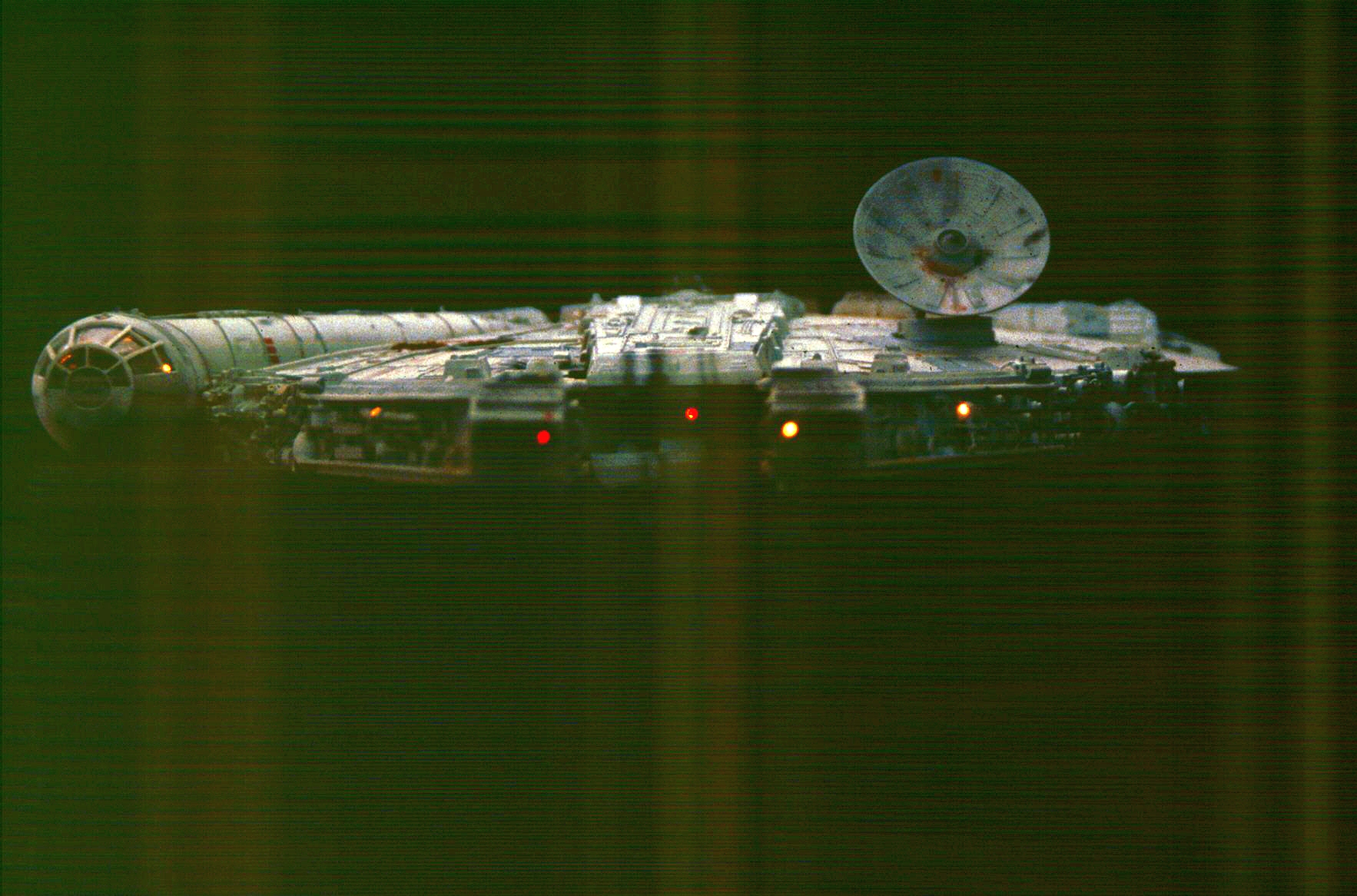

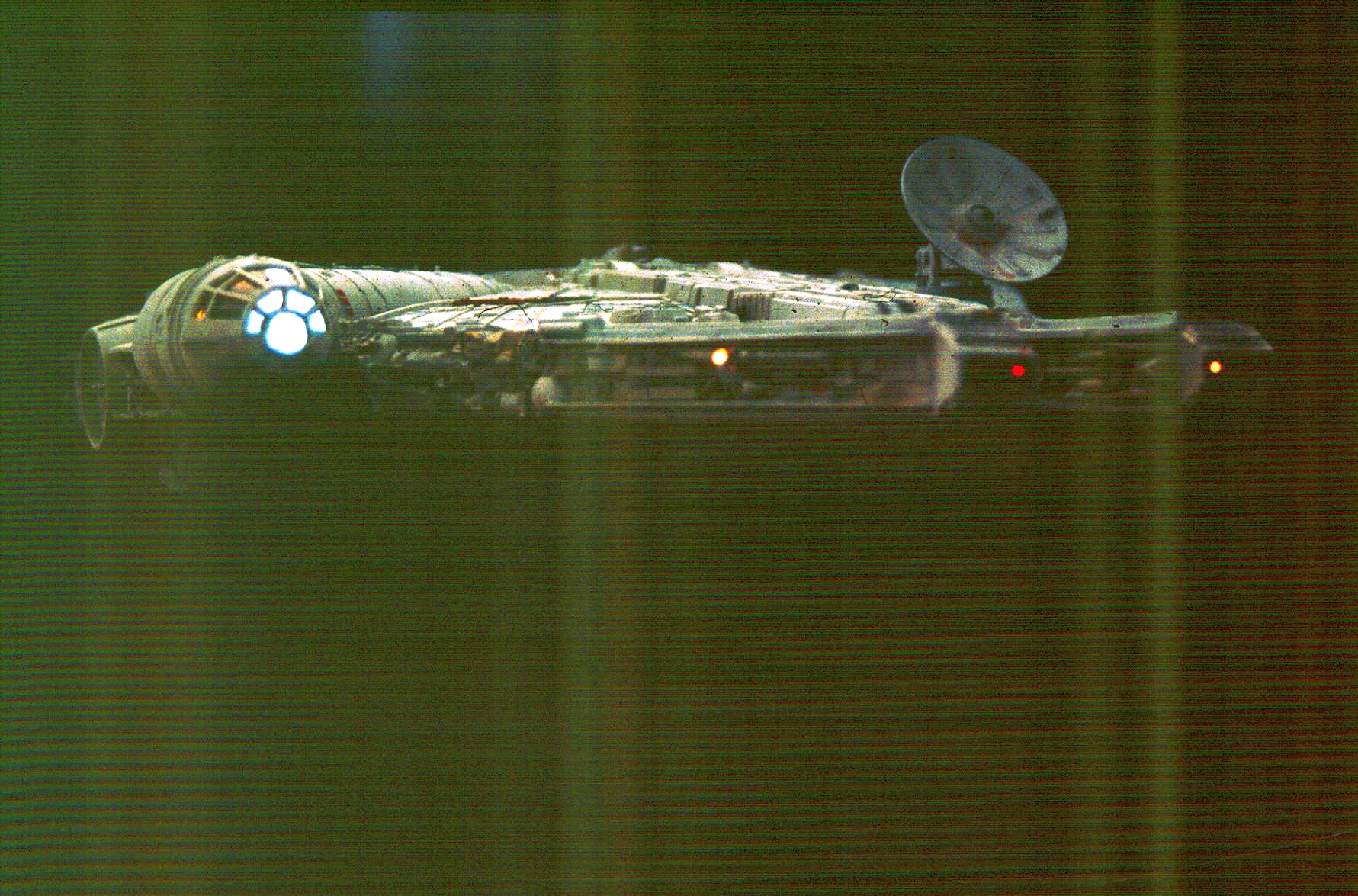

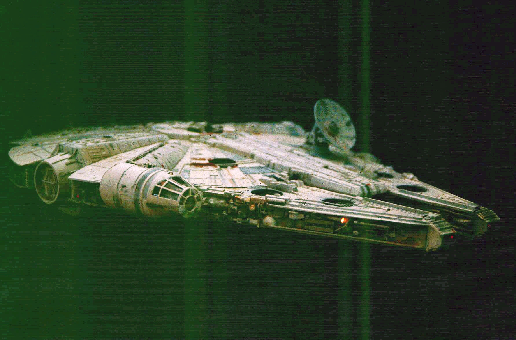

That's my old MPC/Ertl Millennium Falcon, which I built around 1989, with modified mandibles and new sidewalls from Sheet-Styren and some greeblies from other kits, which I put on more on a gut level, than screen-accurat (well at this time the best picture to get of the falcon was the boxart :) ). Also tried lighting the kit. I am still keeping it in the cellar... the Bandai is still waiting on the shelf to get the more accurate an more presentable piece in the living room. (sorry for the poor quality of the pictures, the are scans from old dia-positives, when I tried to make some effect-pictures back in 1990 :)

Awesome for an '89 build, heck it's awesome for now, love it! The only thing that really gives it away is the dish. So you had the skills long before I showed up to the party :thumbsup
