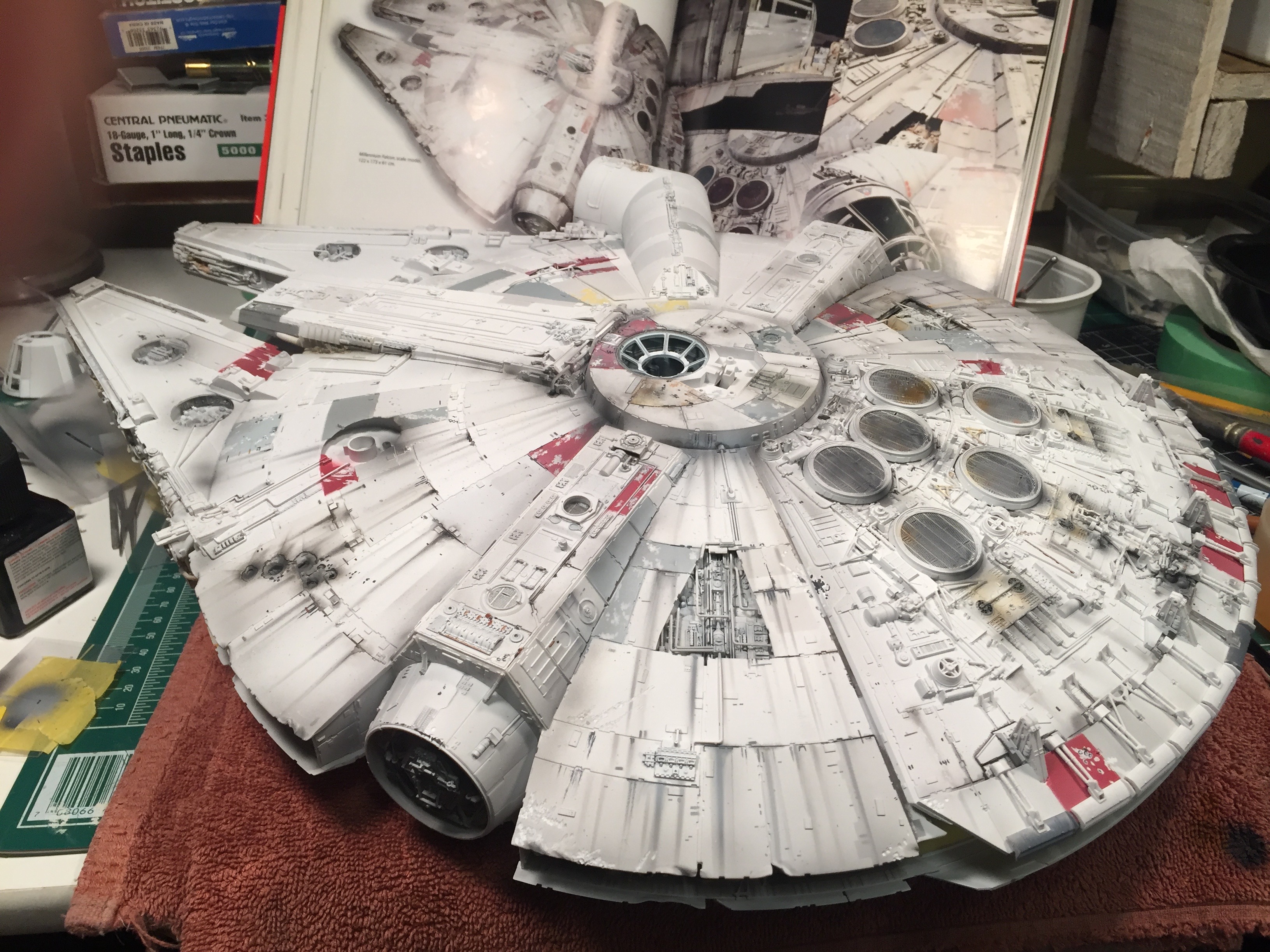

Made some progress on the upper hull. Still needs tweaking, but overall happy. It's important to stop periodically to look at the model under a variety of lighting. More than once I finished a section only to look at the model under normal room lighting to find certain streaks or shading were way too dark and had to be misted back.

Moving on to the front starboard quadrant and cockpit tube...
Utterly Gorgeous
What a beauty

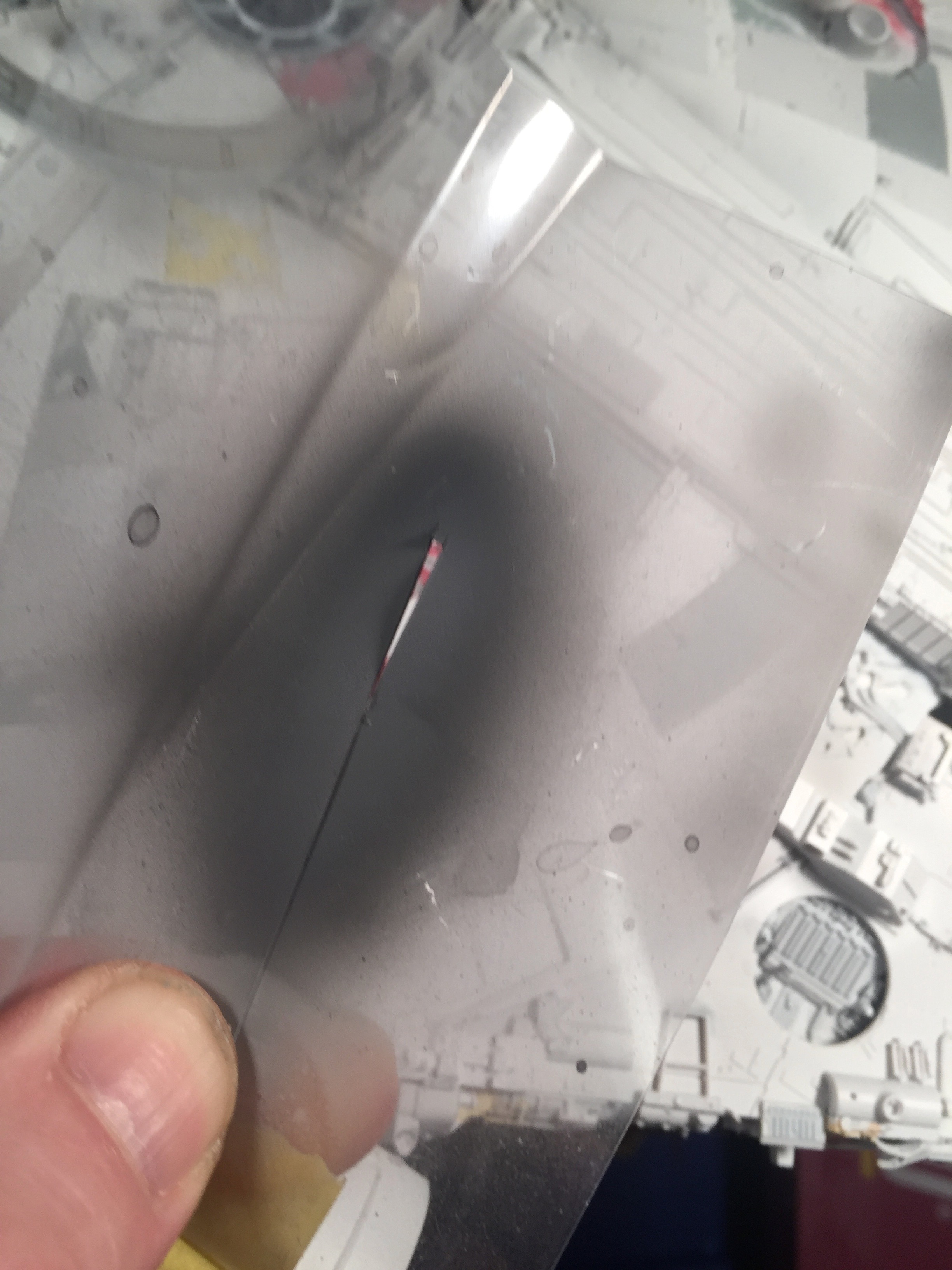

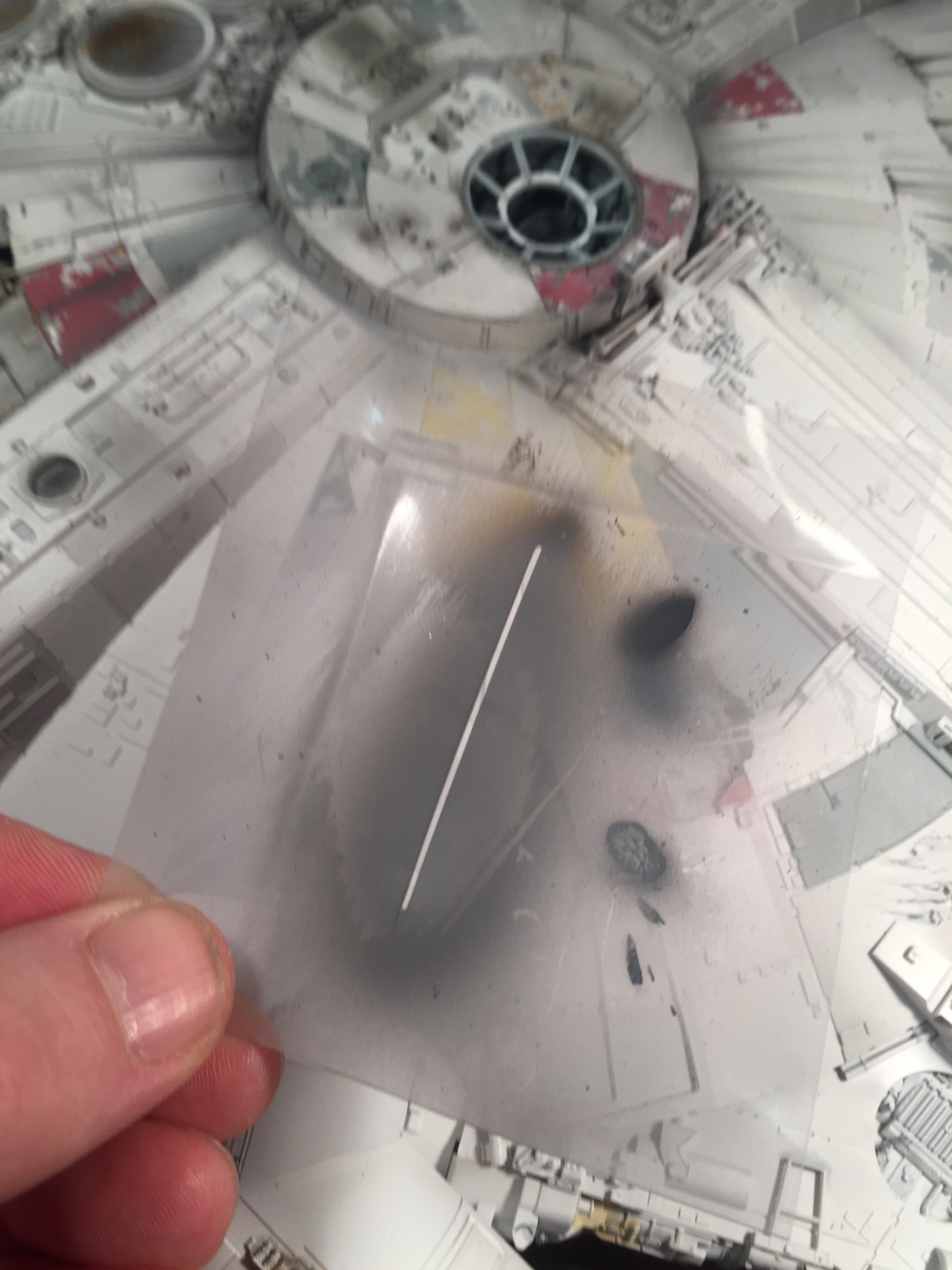

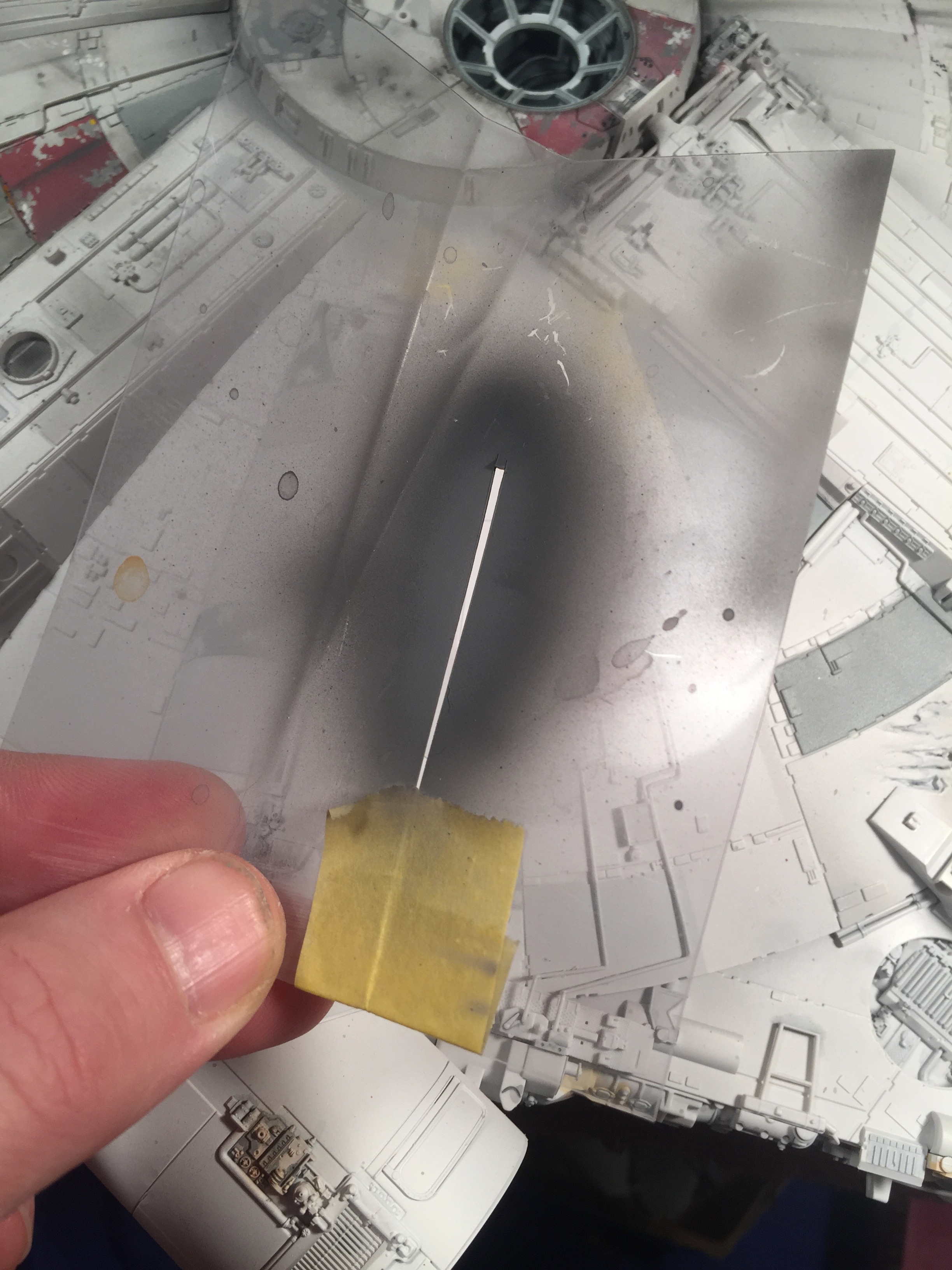

Thanks man! I'm using a couple masks made from clear plastic scavenged from some packaging. One is a straight narrow slot to give straight streaks and the other is tapered to make the tapered streaks. I've been holding them various distances from the surface to soften or sharpen them. It isn't 100% precise. On some I've scraped the streaks down using a blade or lightly sanded them to soften them. I think the key is to have a variety of sizes and softness in layers. On some panels, the streaks are wide and very soft and on others they are narrow, sharp and darker. I gotta say, the grime mist on top really pulls things together.

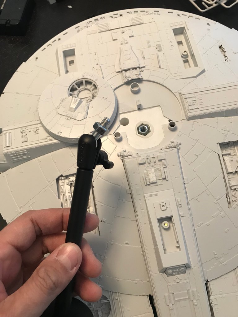

need some info... please. from this pic, that was posted a million pages back, i’m trying to find the name of the mounting bar that wasn’t used here. pretty sure it’s a camera mount, but does the owner know the manufacturer?? please and thanks!?!

Thanks for the compliments, guys! The streaking technique I use is pretty low-tech. I made three masks out of thin clear sheet plastic and used an Xacto to cut thin strips out. One mask was a narrow straight rectangle and the other two were tapered. I used clear plastic so I could see where to position each streak.
On the tapered ones, I cut the tapered end all the way to the edge of the plastic so that I could flex the plastic back and forth to narrow or widen the taper as needed. I'd hold the chosen shape using some tape. When it was time to paint, I would use tape to mask off the top of the panel on the model where the streak would start (to avoid the streak starting above the panel line) and then hold the plastic mask in position. I'd hold it a couple millimeters above the surface of the panel while spraying, varying the height to soften (farther) or sharpen (closer) each streak. I usually held the mask at the bottom of the taper so the bottom would be a little farther away from the model surface than the top. This helped the streak fade from top to bottom. On some of the really faint, wide streaks I just used some ground gray chalk pastel and a stiff brush to put them directly on the model. If the painted streak wasn't quite right (which happened a lot), I'd either scrape at it lightly using a blade or give it a light sanding to get it closer to what I wanted. Where needed, I also brush painted little blobs at the top of some streaks to indicate the oily source of the leak.
I definitely recommend airbrushing the streaks to give it that authentic 5-footer look. Most of the streaks are narrower and fainter than you think. It's better to have a lot of faint streaks than it is to have fewer darker ones, IMHO. Keep the streaks from getting too uniform in thickness and darkness. Build up layers. Mist with some hull color to blend and finish up with a dusting of grime and viola!
To be honest, I kind of rushed the painting this weekend because I'm recovering from surgery and couldn't stay vertical for too long. This isn't a perfect technique, but it's working pretty well.
