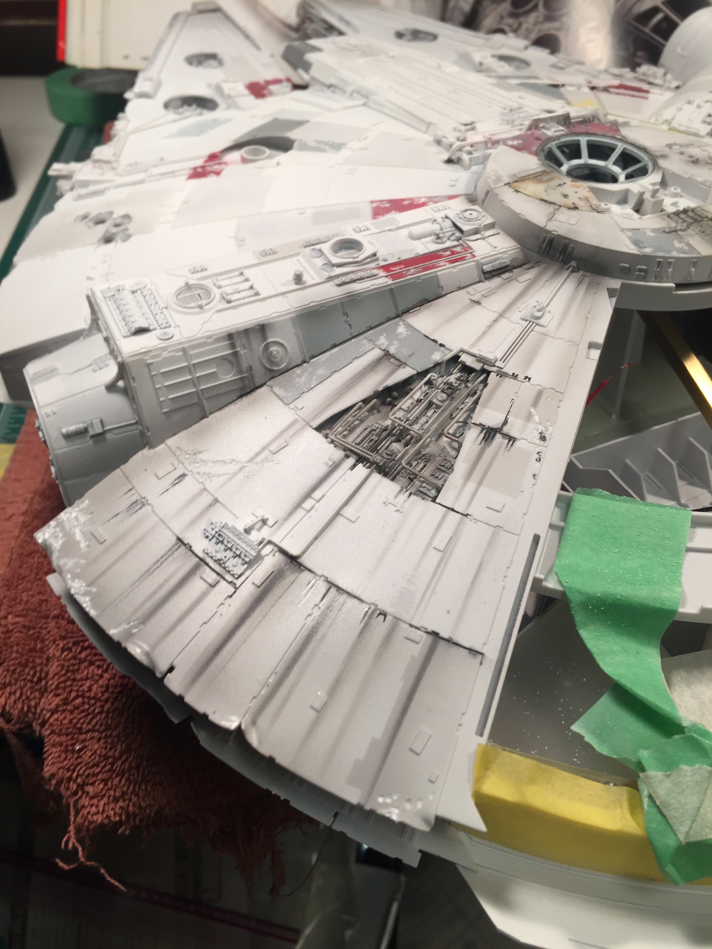

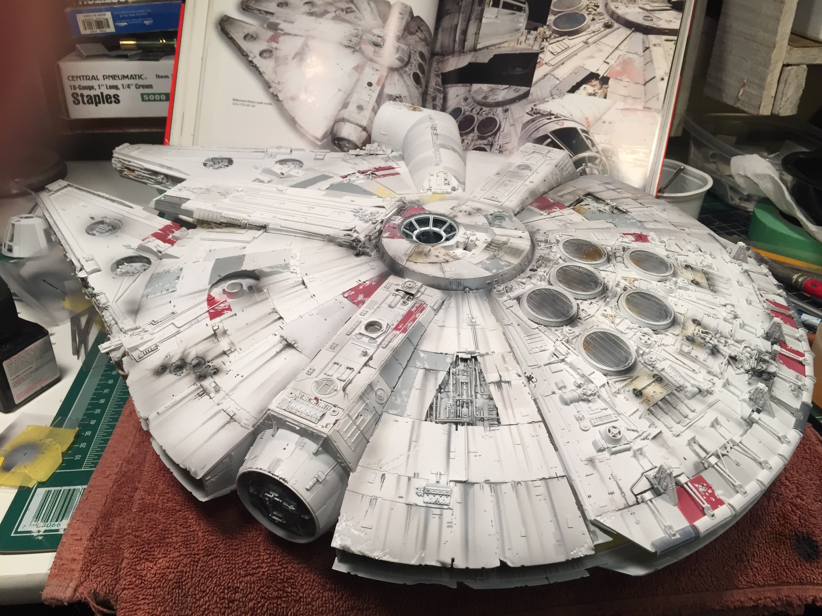

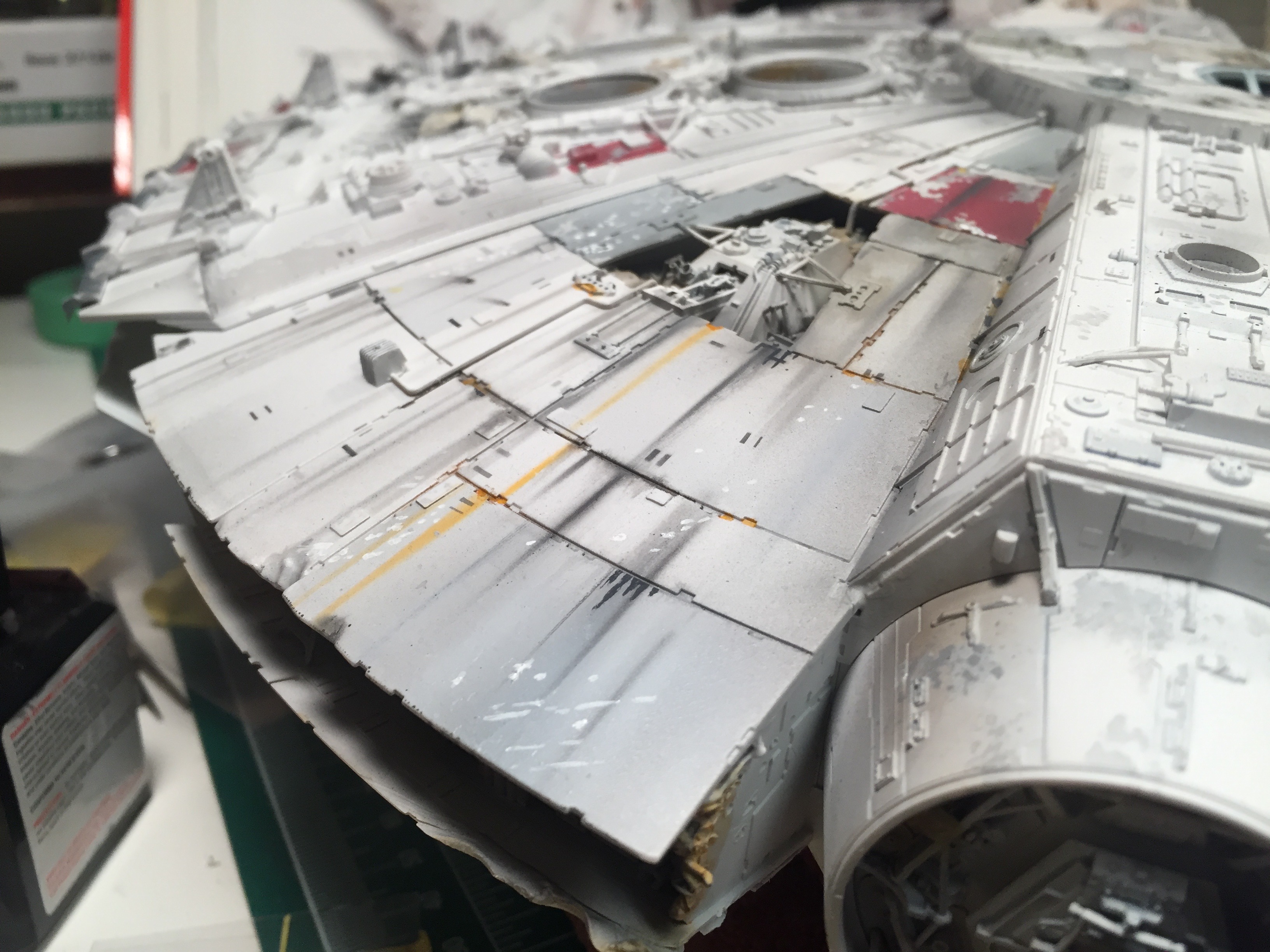

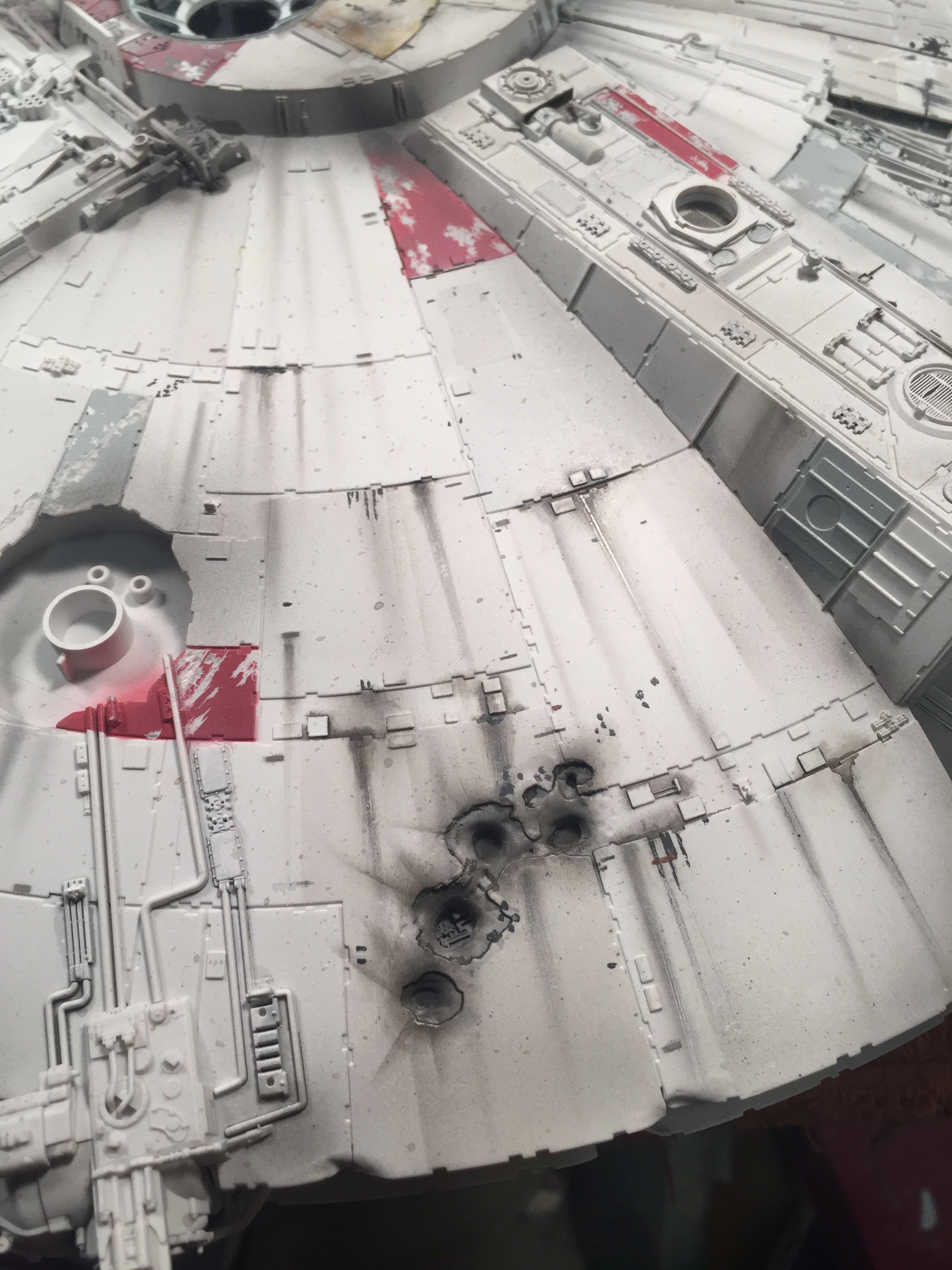

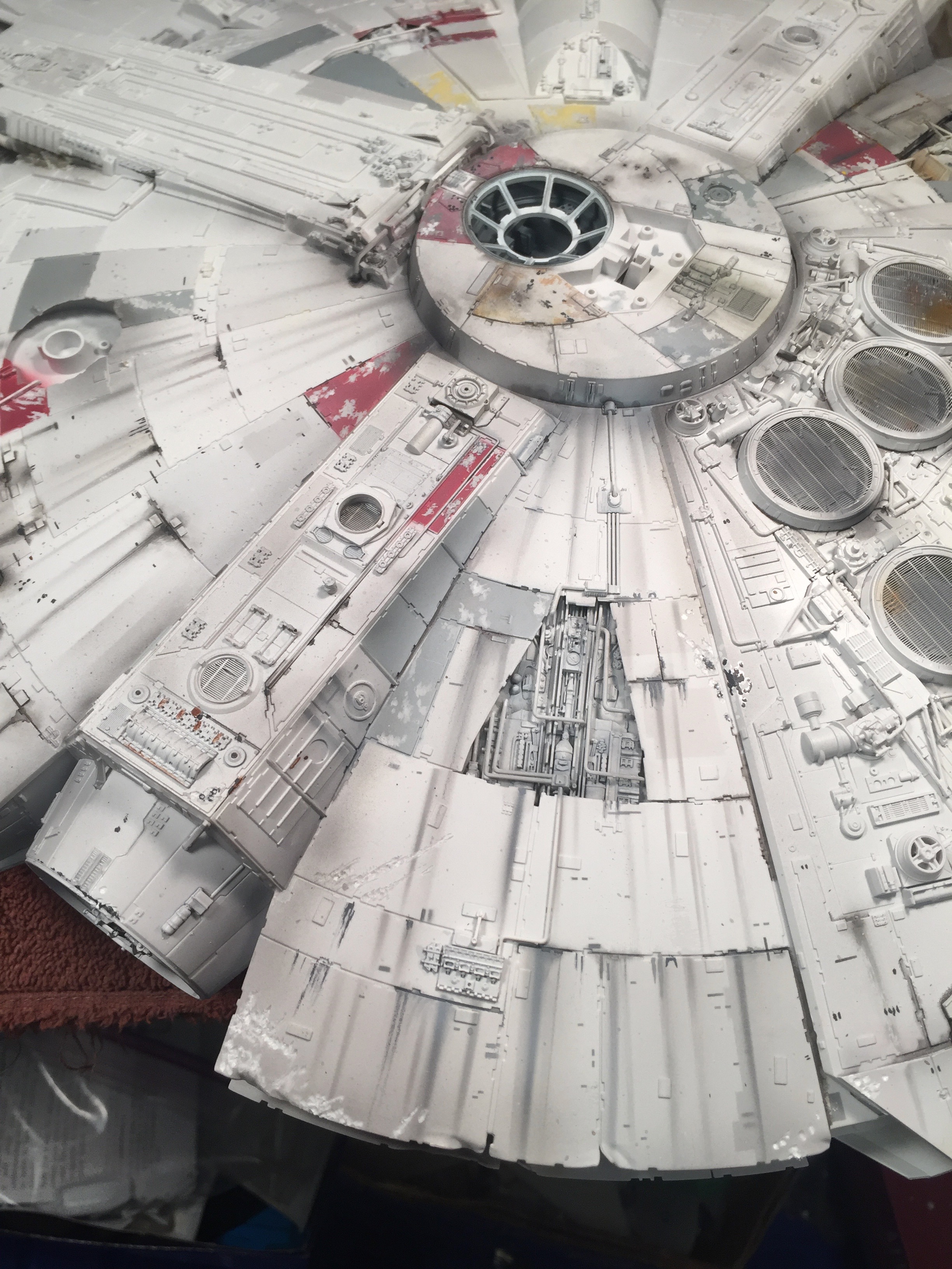

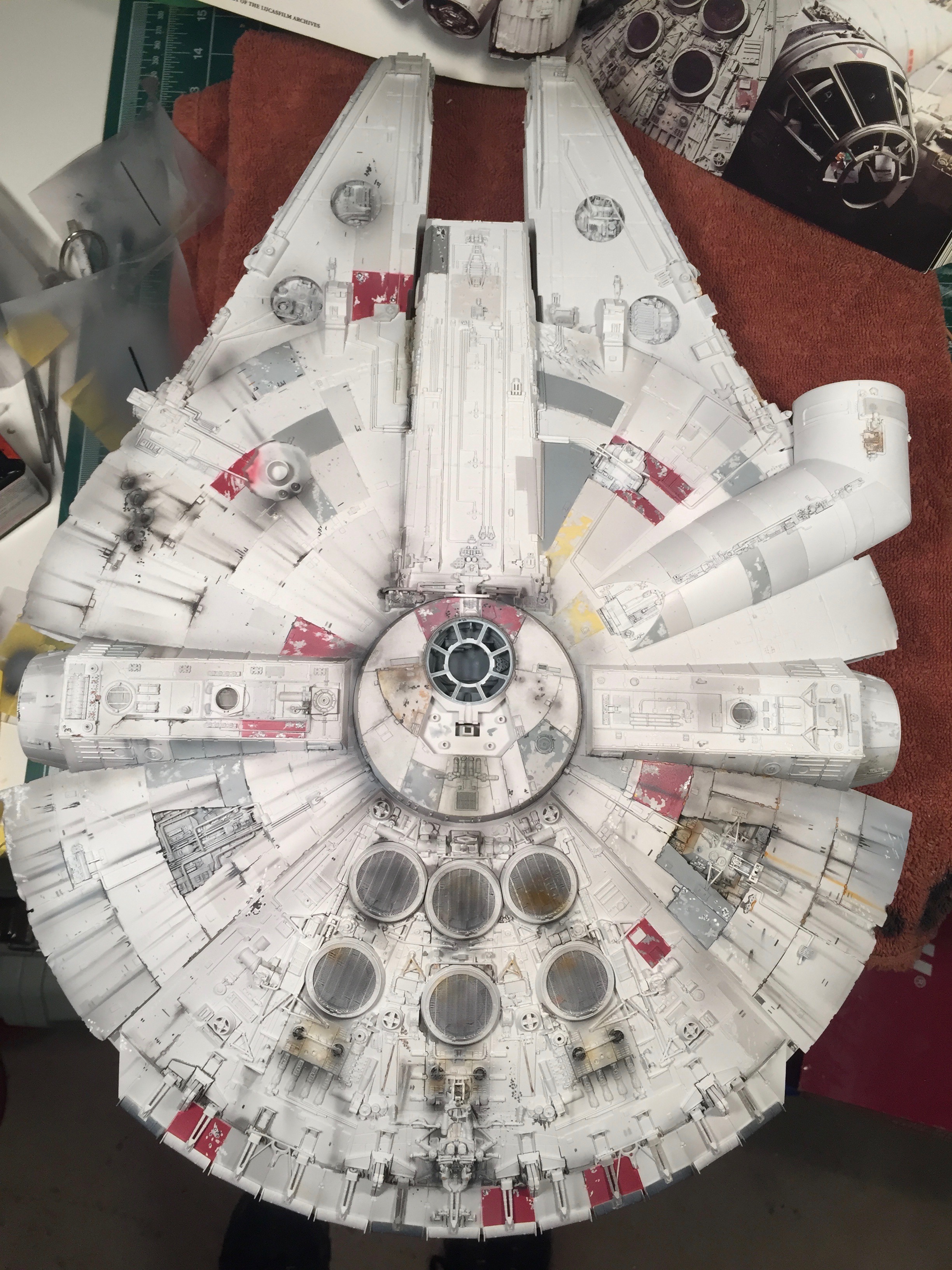

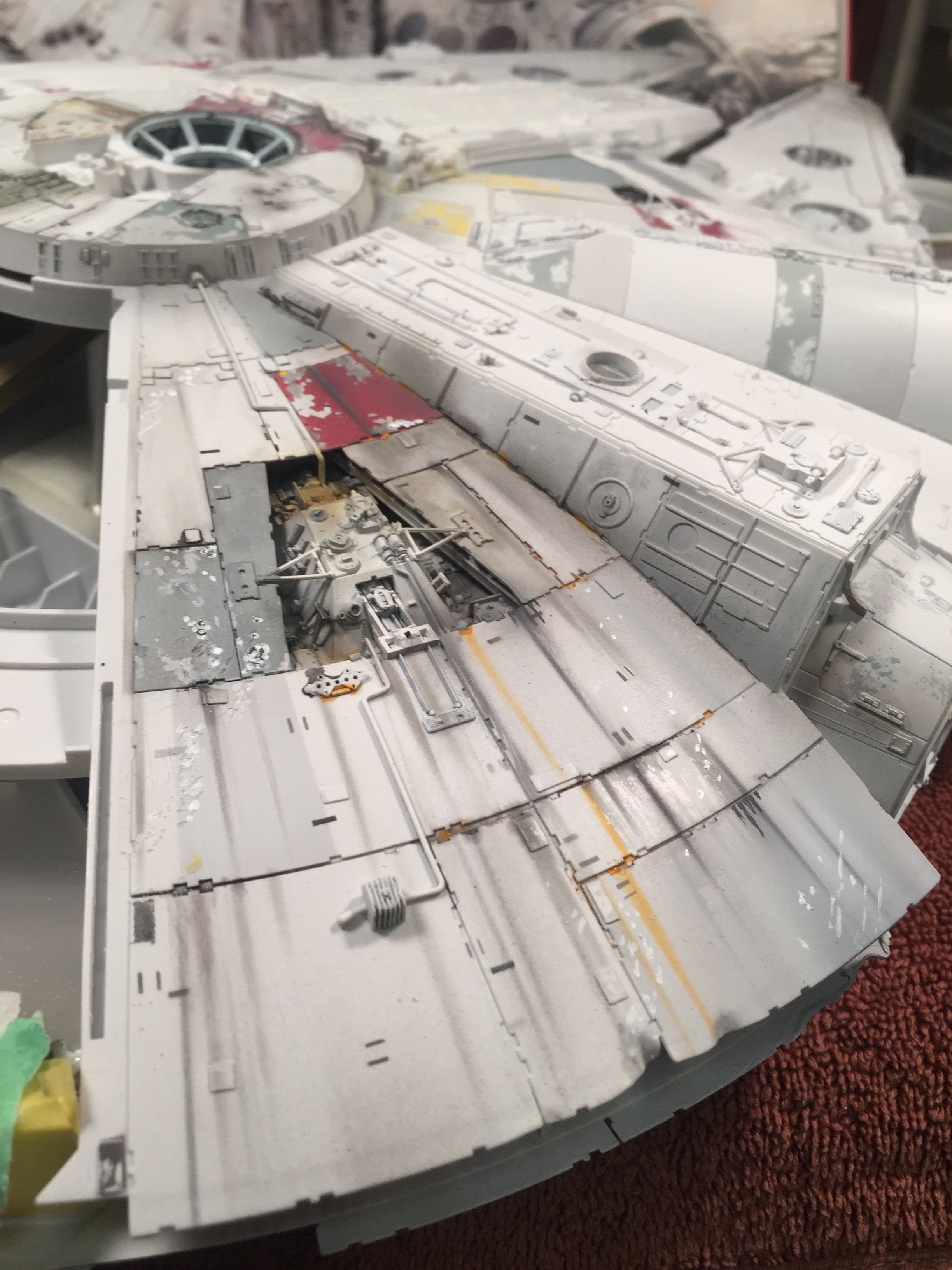

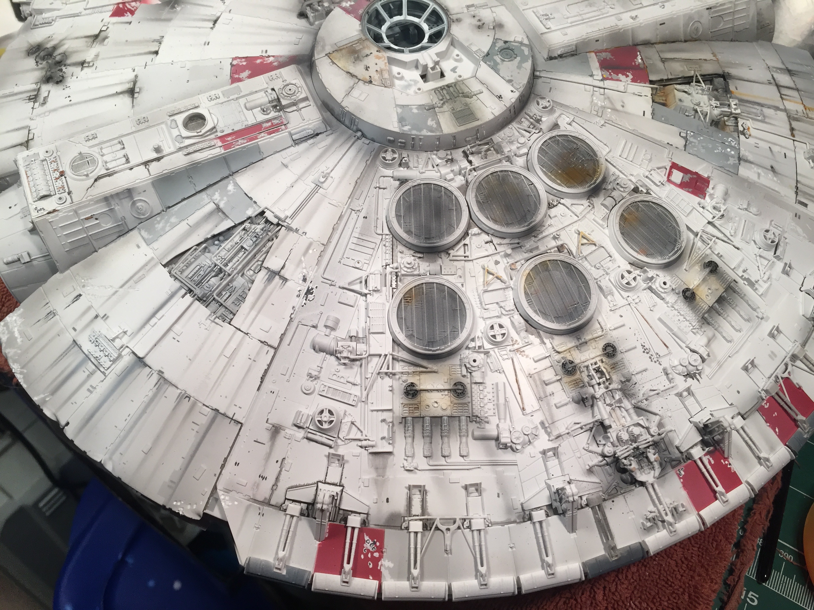

Made some progress on the upper hull. Still needs tweaking, but overall happy. It's important to stop periodically to look at the model under a variety of lighting. More than once I finished a section only to look at the model under normal room lighting to find certain streaks or shading were way too dark and had to be misted back.
IMG_9061.jpgIMG_9056.jpgIMG_9070.jpgIMG_9074.jpgIMG_9080 (1).jpgIMG_9086.jpgIMG_9088.jpgIMG_9089.jpg
Moving on to the front starboard quadrant and cockpit tube...

Awesome work!!
How are you doing the streaking?
Re: Bandai 1/72 Millennium Falcon
Awesome work!!
Thanks man! I'm using a couple masks made from clear plastic scavenged from some packaging. One is a straight narrow slot to give straight streaks and the other is tapered to make the tapered streaks. I've been holding them various distances from the surface to soften or sharpen them. It isn't 100% precise. On some I've scraped the streaks down using a blade or lightly sanded them to soften them. I think the key is to have a variety of sizes and softness in layers. On some panels, the streaks are wide and very soft and on others they are narrow, sharp and darker. I gotta say, the grime mist on top really pulls things together.
Yeah, i misted the outer areas and crevices with grime as well.
Does indeed pull everything together.

Those streaks look perfect. In my case, I'm constantly fighting myself not to do too much. I keep imagining myself as my teenage daughter putting on makeup for the first time. Less is more, honey! :lol
Same here.
My problem is that ill do an airbrush pass and think it isnt dark enough so then I hit it a few more times...and then when I remove the mask its too dark. Lol
