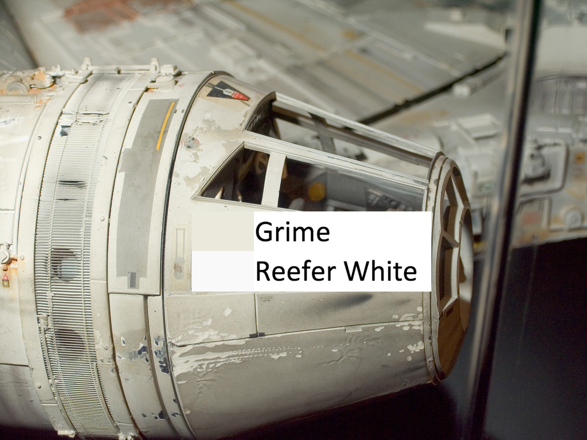

Got a question - I made some notes over a Fantastic Plastic photo of the cockpit area. I see where the Reefer White base color is now -- it's exposed by the dremelled areas. So is it the Grime that will darken the Reefer White? And there are 2 Grimes in the Archive-X range. Should I get the EX-001 or EX-002?
https://i.imgur.com/zKNDAnW.jpg
I guess this is why the 5-footer looks whiter than the 32-inch. They used Grime or 50-50 Grime and Reefer White on the 32-inch while they used straight Reefer White on the 5-footer.
Or is that actually a Daz White underneath and the Reefer White to darken it? (in which case where would the Grime be used?)

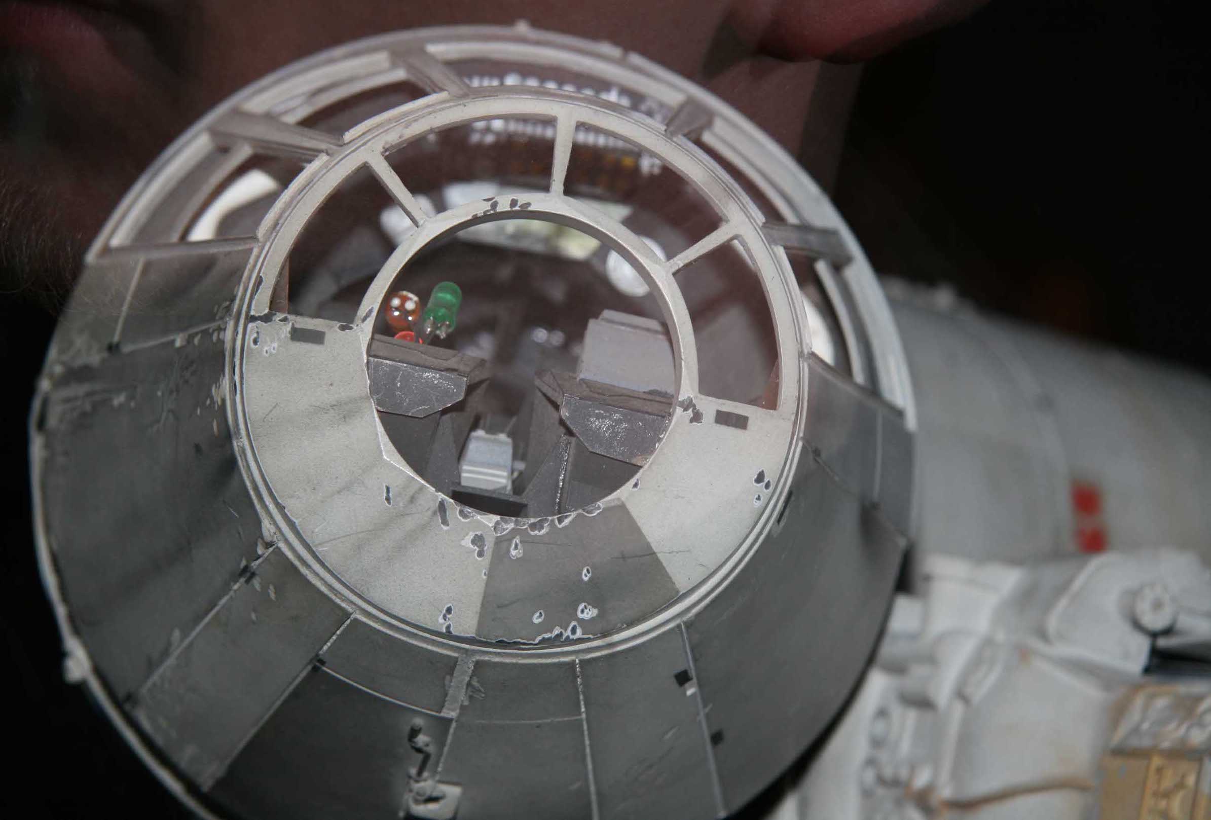

Oh you mean like this?
I'm wondering though because this looks like paint on top of white on top of black. The effect of grinding the surface would create the effect easily -- maybe they used black styrene here? But in that case, what paint would the white be and what is the final paint on top? And if the final paint were Reefer White --- where is Grime used for?

If I'm remembering things correctly, they used the cockpit cone and the radar dish from the original pirate ship model (That became the tantive 4) which means that it could very well have been white styrene, while the cockpit tube was black styrene.
Re: Bandai 1/72 Millennium Falcon
I think you're right Astroboy, none of the early construction photos of the 5' Falcon I can find have the cockpit cone attached. However, it does appear that at least the front section of the cockpit was black styrene underneath.
Crackerjazz, is that darker patch under where you indicate 'Reefer White' the 'Grime' ?

Good eye!

Hi David, I want to know what color that patch is too. Still wondering where the Grime goes -- whether it's sprayed on over the Reefer White entirely or in spots or just misted on.

So we're all in agreement that the 5-footer base color is Floquil Reefer White from a rattle can. So what, then, is the gray color that seems to be over-sprayed all over the ship? Is that "grime"? Do we know the specific color?
