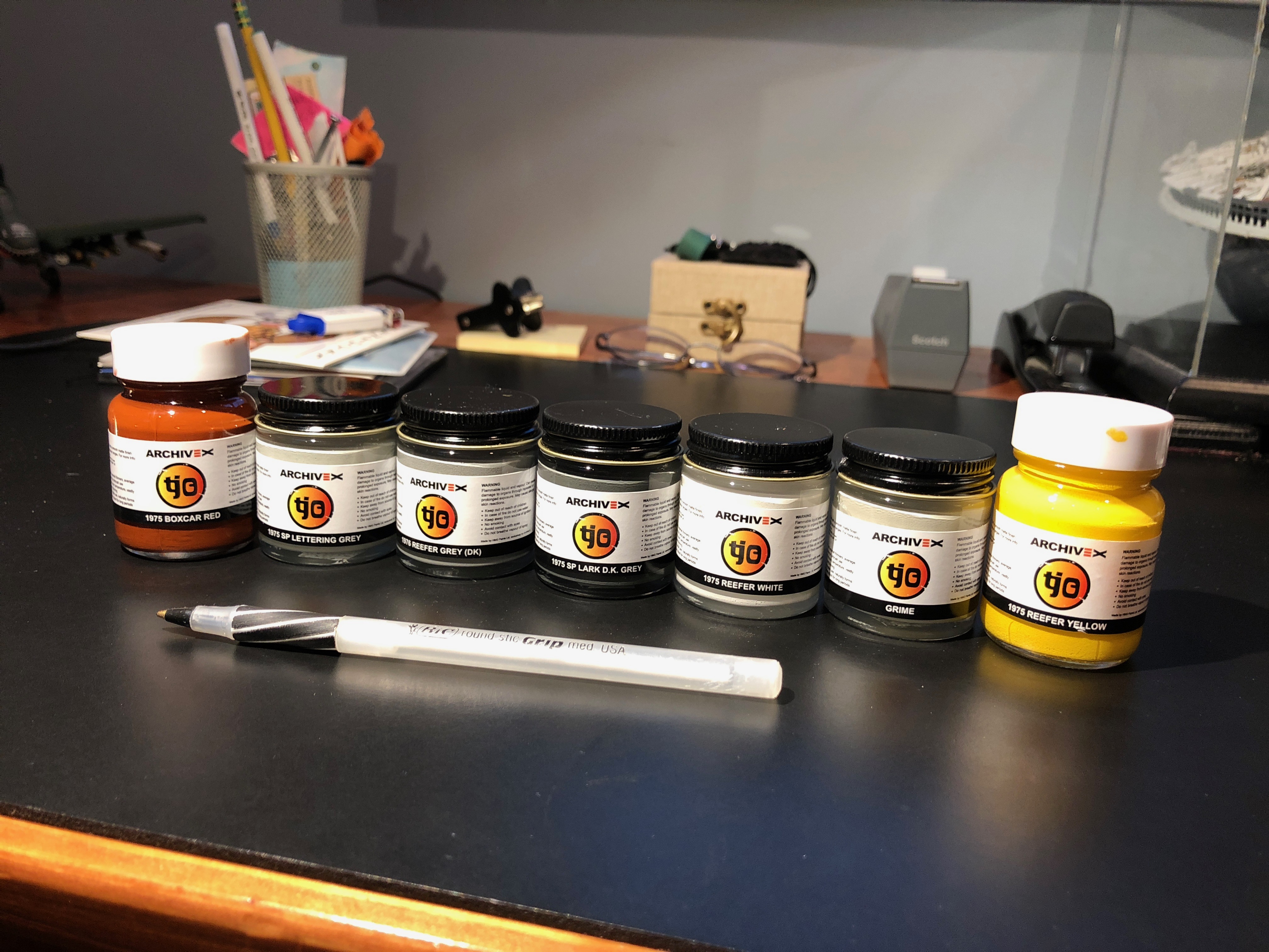

Yay, my Archive X paints arrived from Guy today. He shipped them November 11th, so that's pretty quick considering a) I live in Northeast US and because they are enamel paints b) probably came across the pond via submarine.
In any event, he wrapped each jar individually with a ton of bubble wrap, then wrapped all of the jars in even more bubble wrap, so everything is intact. Not cheap paints, but highly recommend his service, at least. Hope to use them soon. :D
(and yah, that's the back end of the FM Falcon on right side of photo and nose of Hobby Boss A-10 on left)

Nice!!! A complete set for worry-free painting. I need to consult with the budget minister once more : (
Re: Bandai 1/72 Millennium Falcon
Exactly why I got them--not cheap, but eliminates need to obsess over the correct base color.
Which....frees my mind to obsess over everything else. :lol

For the 7 he has there...roughly $112.
Ouch...really? I can see that for a much larger model, but not for one this big. Other than the base coat, there's very little paint needed
I think I'll just mix my own Tamiya paints. The as-20 is a good enough base coat and the rest of them are pretty easy.

The Archive-X paints are definitely worth it for those who obsesses over perfect authenticity. I may spring for them on my Bandai PG Falcon, especially if he comes out with acrylic versions.
I got the full legacy set of 25+4 colors. I pretty much only do Star Wars models so it made perfect sense to me. Not only does each bottle stretch way farther than acrylic equivalent, they're THE Star Wars colors. Can't wait to use them when I get around to this beast.
