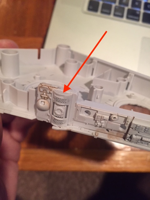

BTW, I think I found the first Bandai "error" worthy of a small modification. On the front starboard sidewall, the greebly from a DML/Dragon/Revell 1/9 Kettengrad kit (part #8 indicated on the donor I.D. chart) needs to be thinned and the top rectangular shape needs to be drilled out. The series of vent holes below should also need to be drilled out, but I think I'll just fill those holes with some panel wash and call it a day. However, that rectangular hole is visible when looking over the top of the starboard mandible.
View attachment 774405View attachment 774406View attachment 774407View attachment 774408
Thought this might interest those who want a more accurate replacement. Found it on Shapeways.
https://www.shapeways.com/product/V...con-1-72-kettenkrad-greebly?optionId=64019325

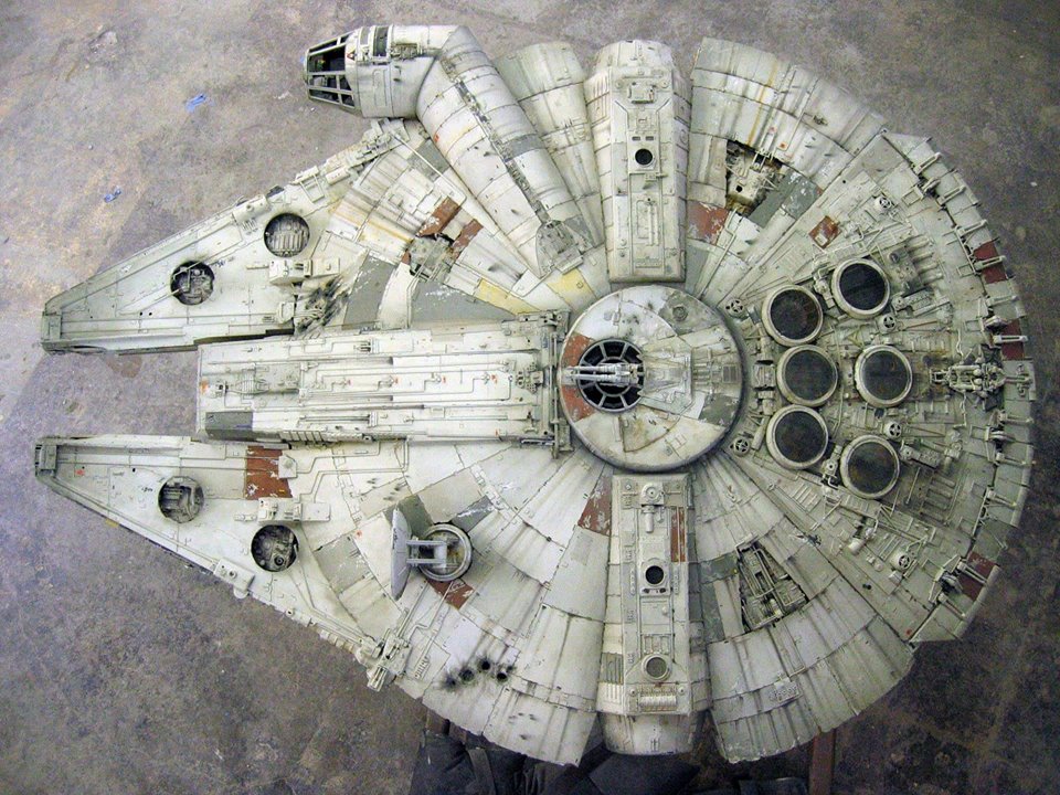

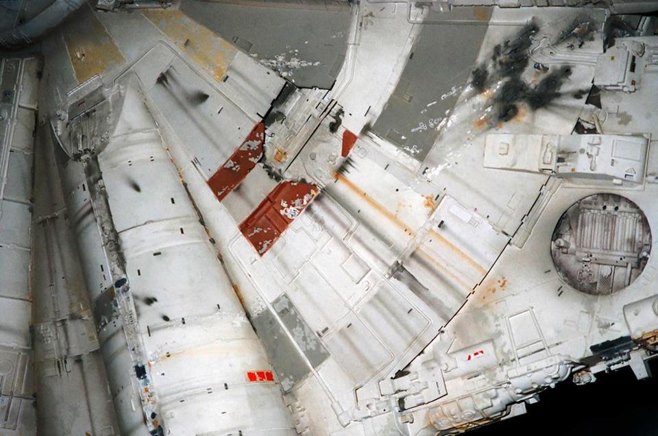

These are images that Guy Cowan posted on Fb.....(originally posted by Jason Eaton a while ago)
They were taken by Bill George of ILM,....Guy also had this to say:"Some personal Pics of the Five Foot falcon taken By amazing Model builder Bill George, Having been a key personal at ILM for many years and knowing what he's talking about its interesting to see and read his explanation of how the 5 foot falcon was painted White not GREY, as a few of us keep saying but sometimes people just don't seem to understand it..... Amazing pics. Not quite DAZ white but Reefer White :), from a rattle can over blackish prime"
attachment.php
attachment.php

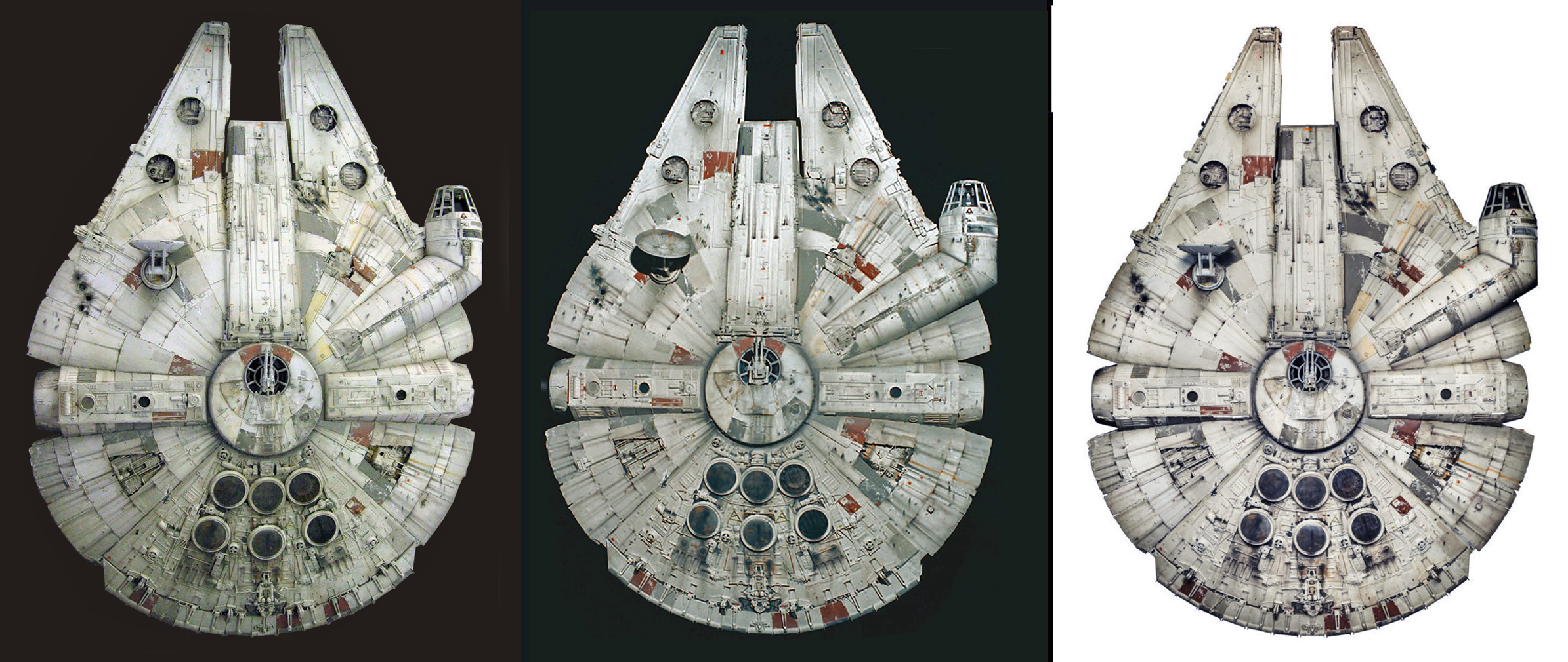

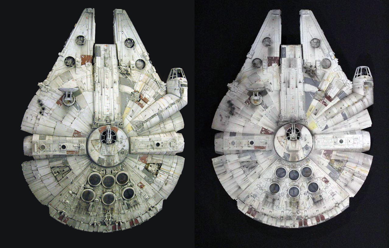

I did a bit of Comparison work.....This is the Bill George image (L)....the Chronicles image (centre)...& an image from a group of SW props (R)
attachment.php
The Bill George image with John Simmons PG Falcon
attachment.php
https://www.therpf.com/attachment.php?attachmentid=775419&d=1511472700
https://www.therpf.com/attachment.php?attachmentid=775420&d=1511472700
Wait, are those the actual five footer? Or an amazing repilica?
Sent from my Pixel using Tapatalk

Wow, thanks for those Bill George images, John! Are there any more of those? And thanks for those comparison shots. Now I understand why the DOA paint I used to compare to AS-20 was so dark -- it was Grime and not Reefer White. But then I don't see any Reefer White from the DOA range.
I've therefore narrowed down my search to Archive-X --- looks like it's the definitive paint range for PG builders. There's so much in there, though. There's like 23 paints for the ANH falcon and I wanted to get the basic ones for now as I'm on a budget.
Got a question - I made some notes over a Fantastic Plastic photo of the cockpit area. I see where the Reefer White base color is now -- it's exposed by the dremelled areas. So is it the Grime that will darken the Reefer White? And there are 2 Grimes in the Archive-X range. Should I get the EX-001 or EX-002?
I guess this is why the 5-footer looks whiter than the 32-inch. They used Grime or 50-50 Grime and Reefer White on the 32-inch while they used straight Reefer White on the 5-footer.
Or is that actually a Daz White underneath and the Reefer White to darken it? (in which case where would the Grime be used?)
