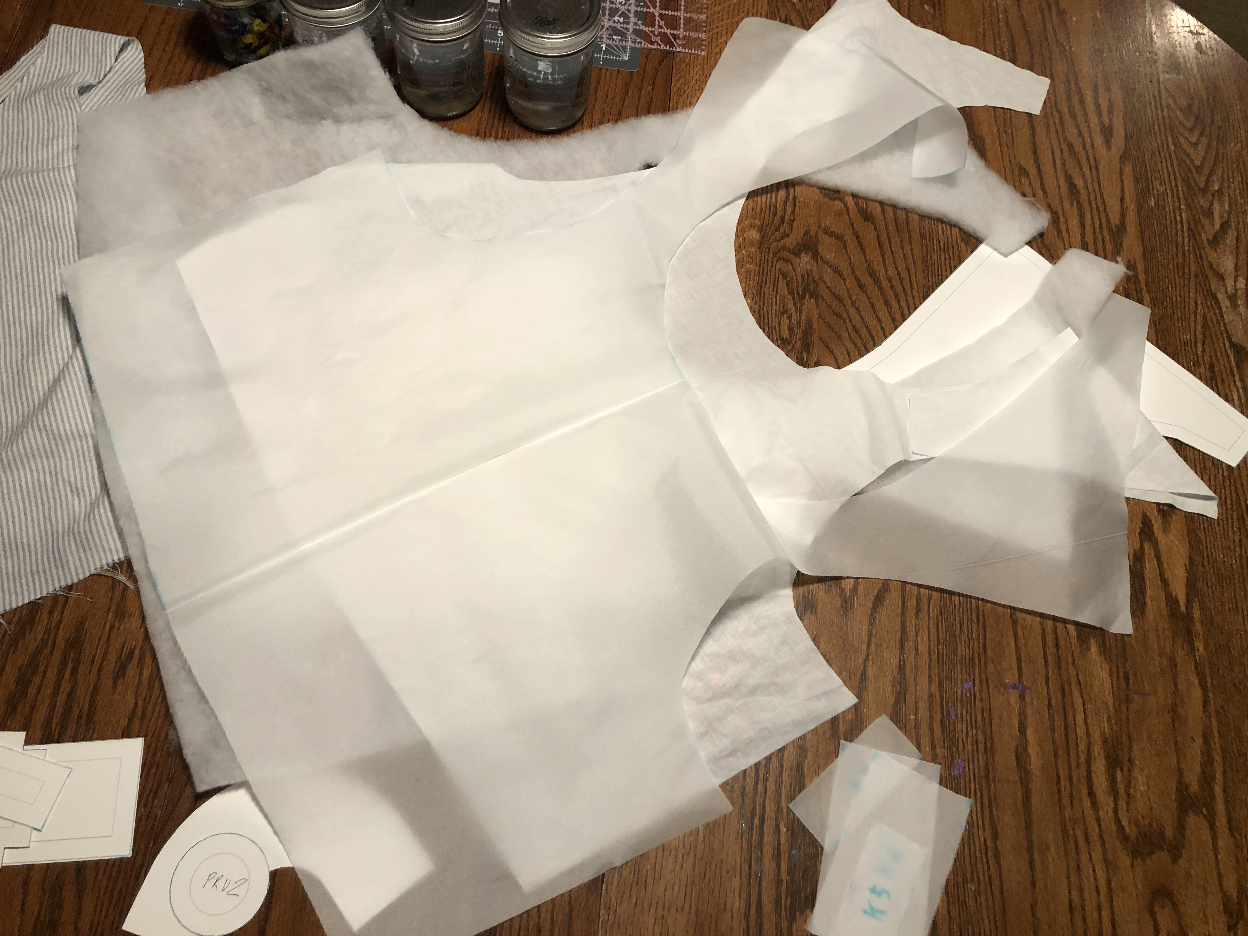

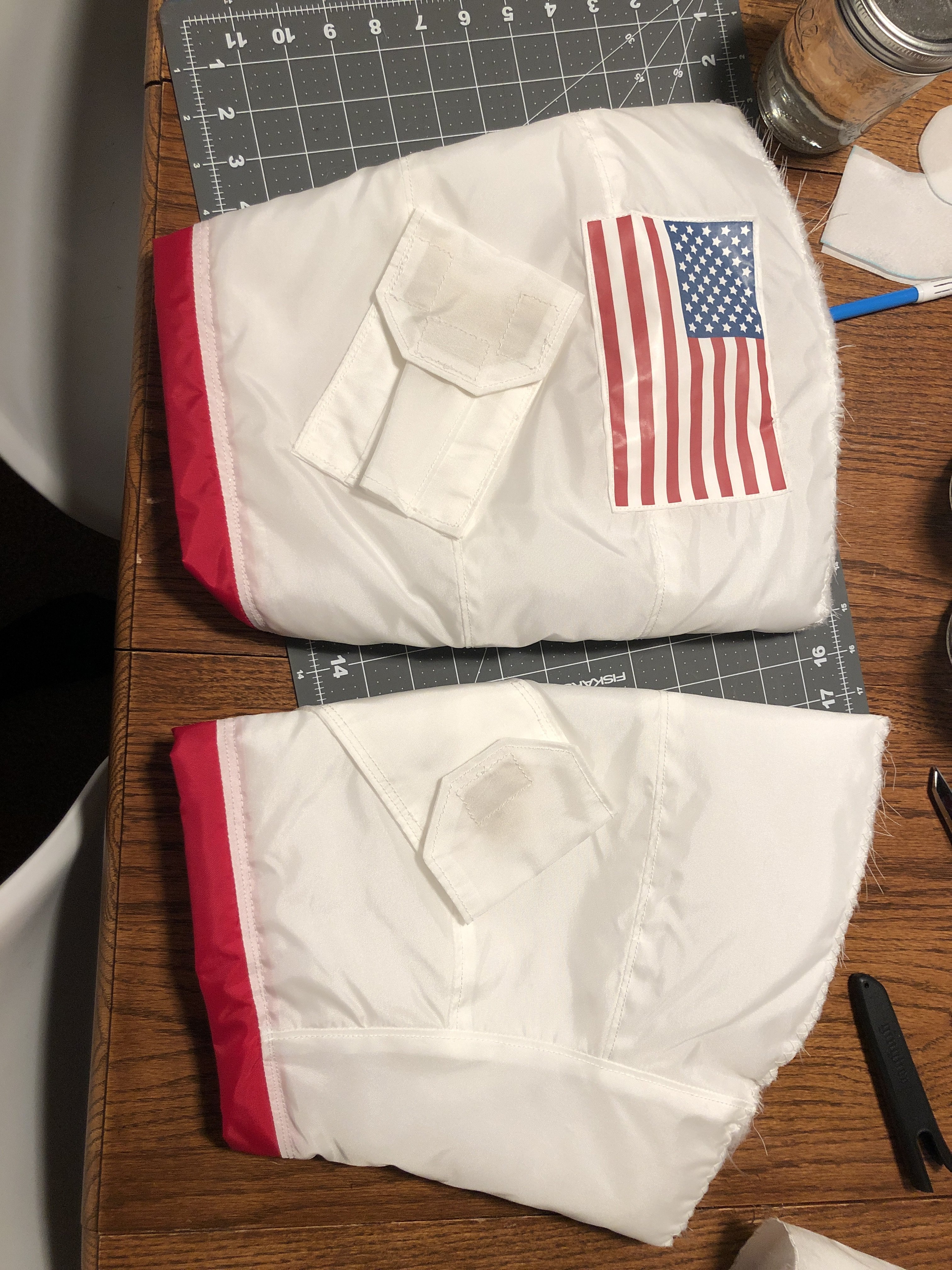

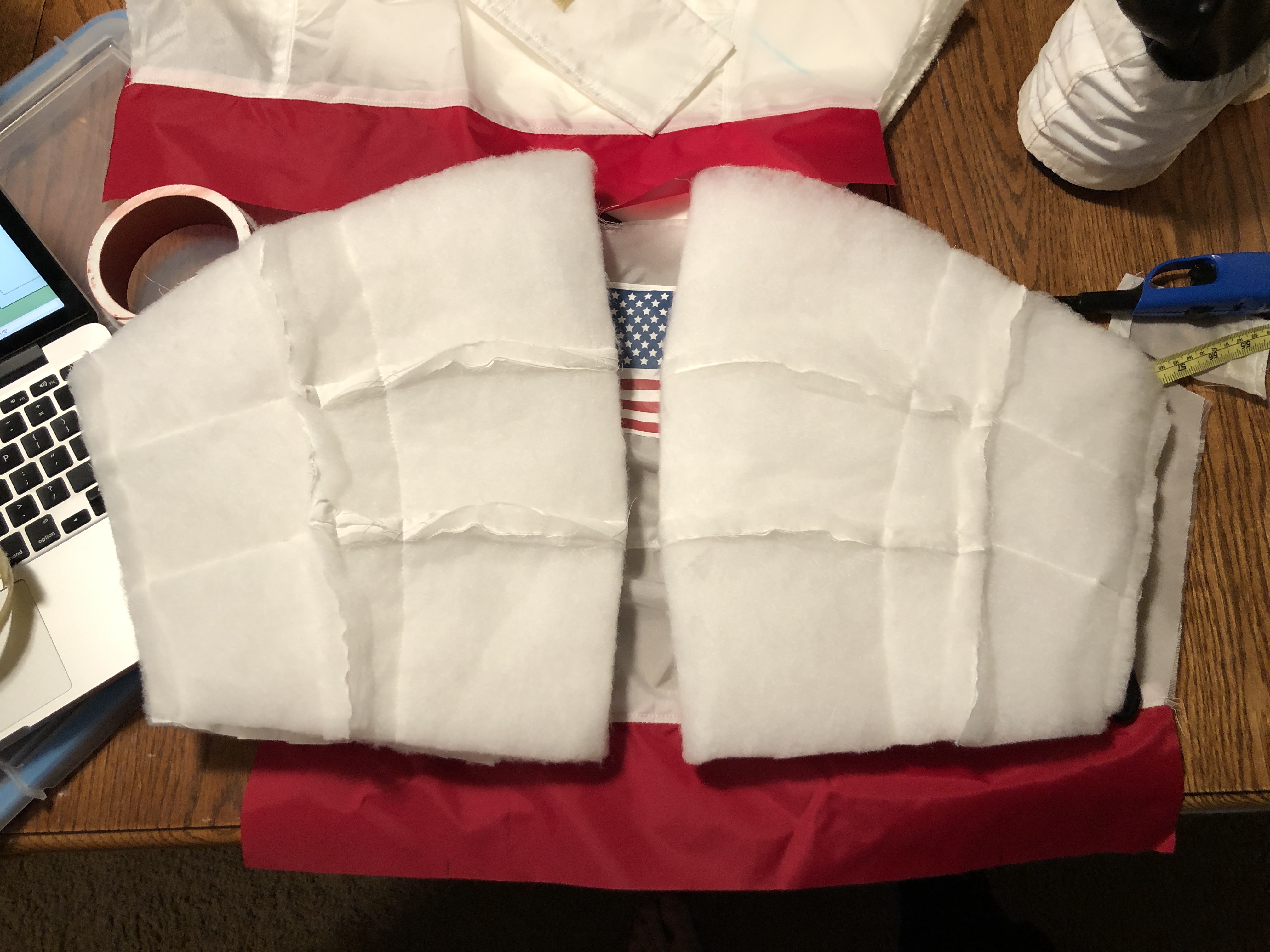

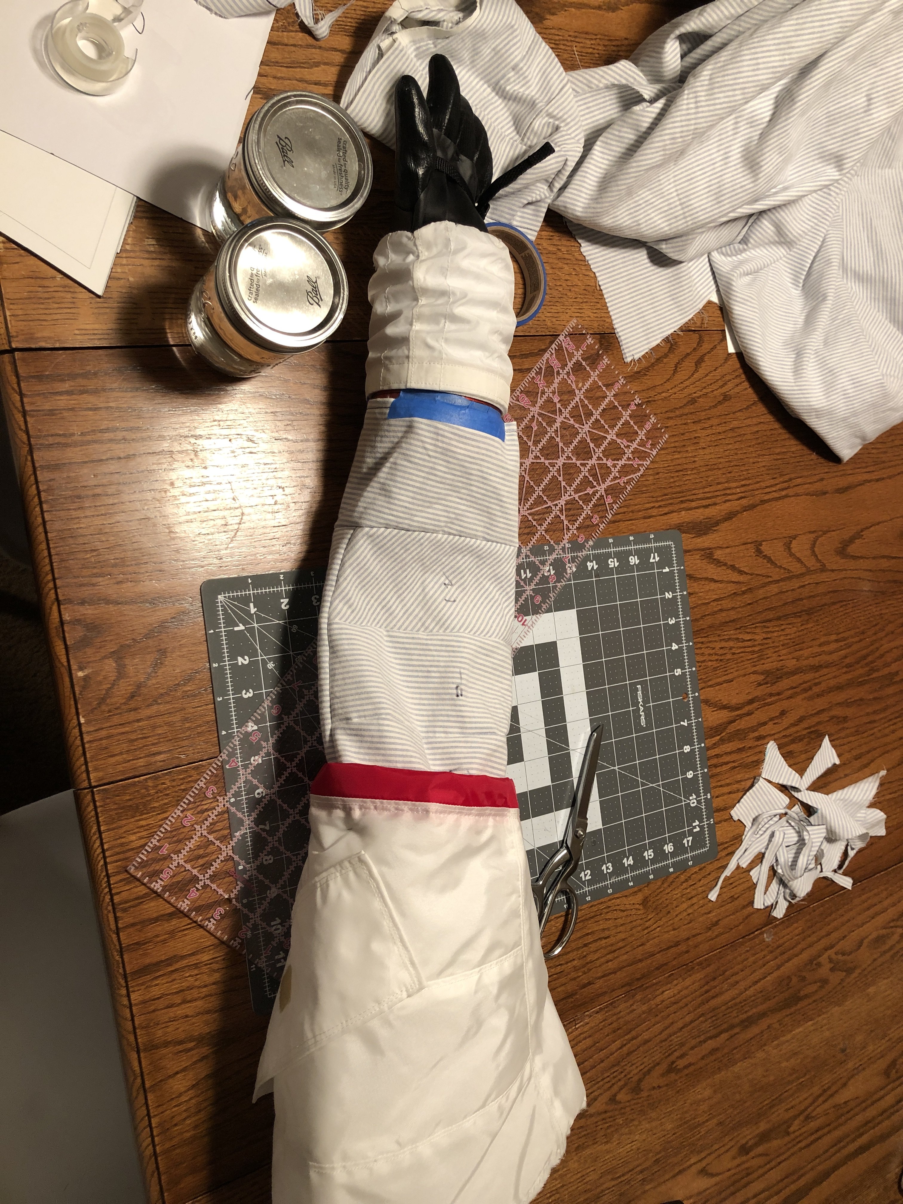

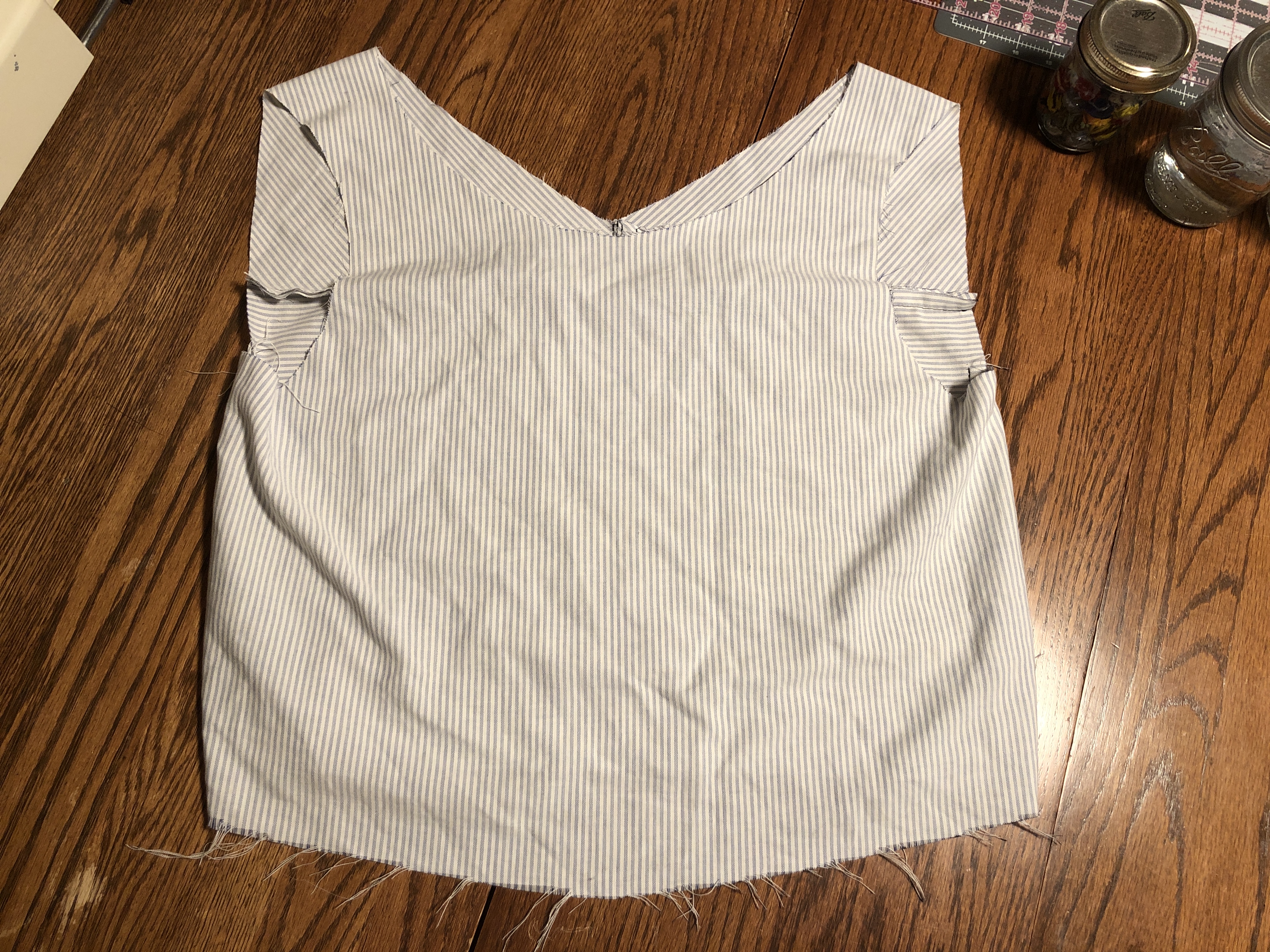

I’ve pulled fabric patterns for a couple pieces from Mr. Nagata's post to get me started, but I haven’t done much with them other than a couple test pieces with scrap fabric.

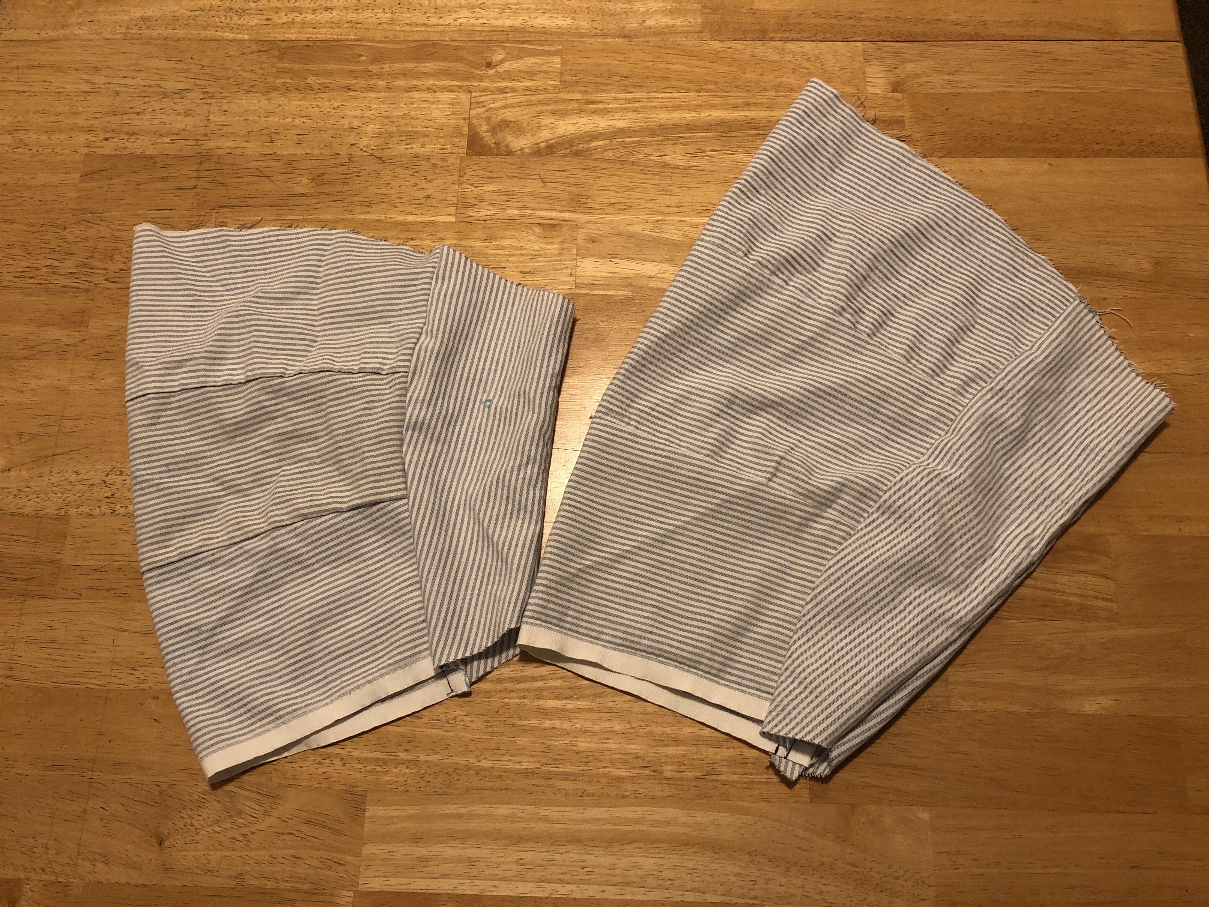

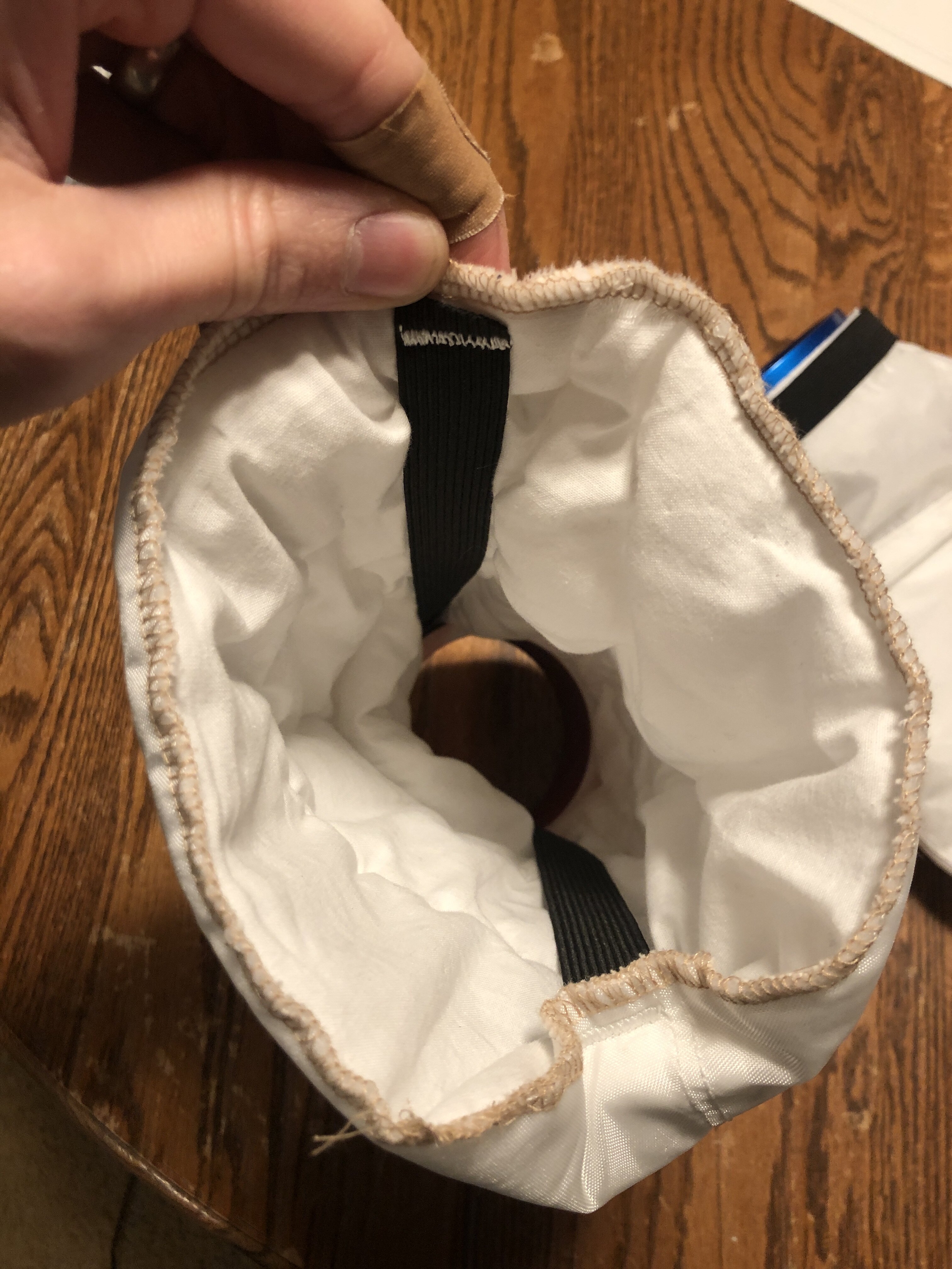

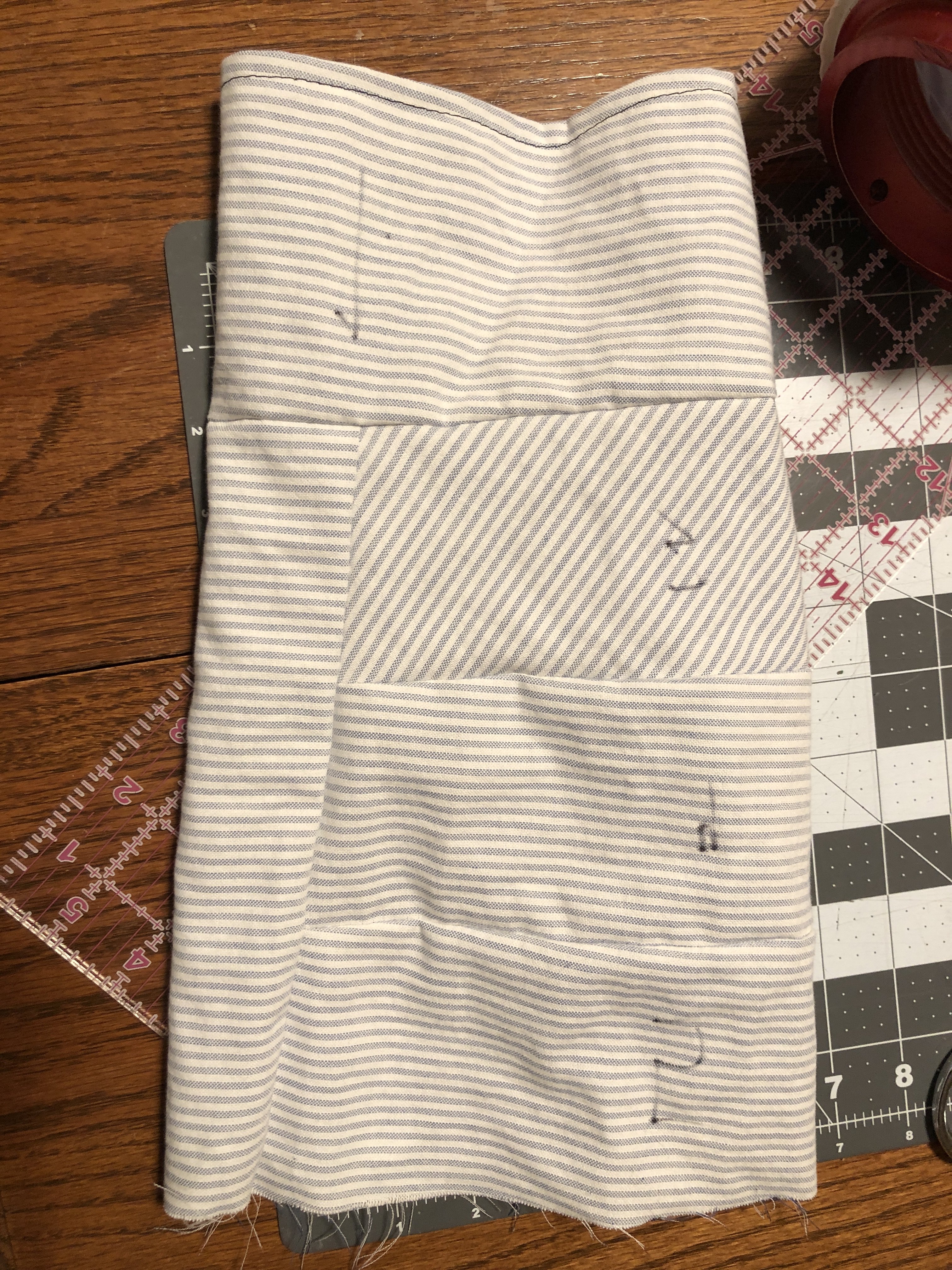

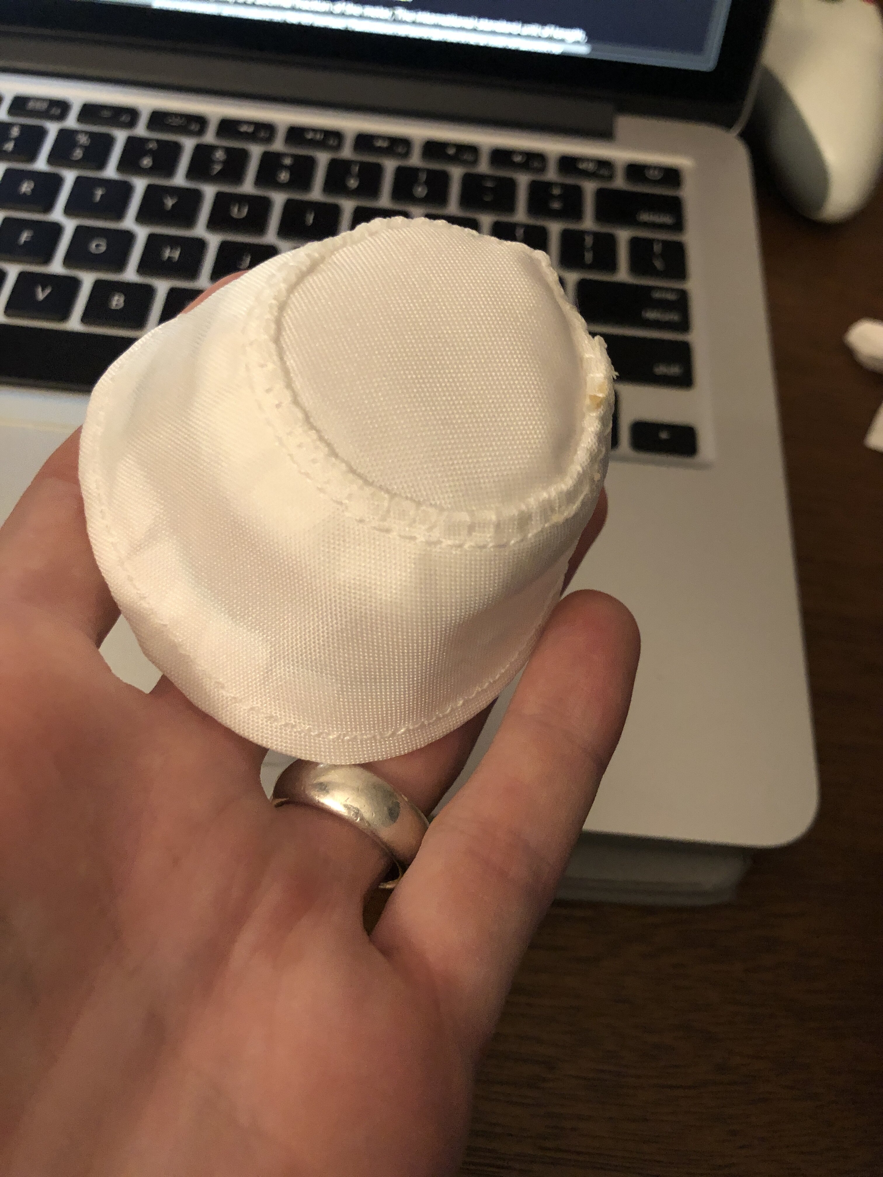

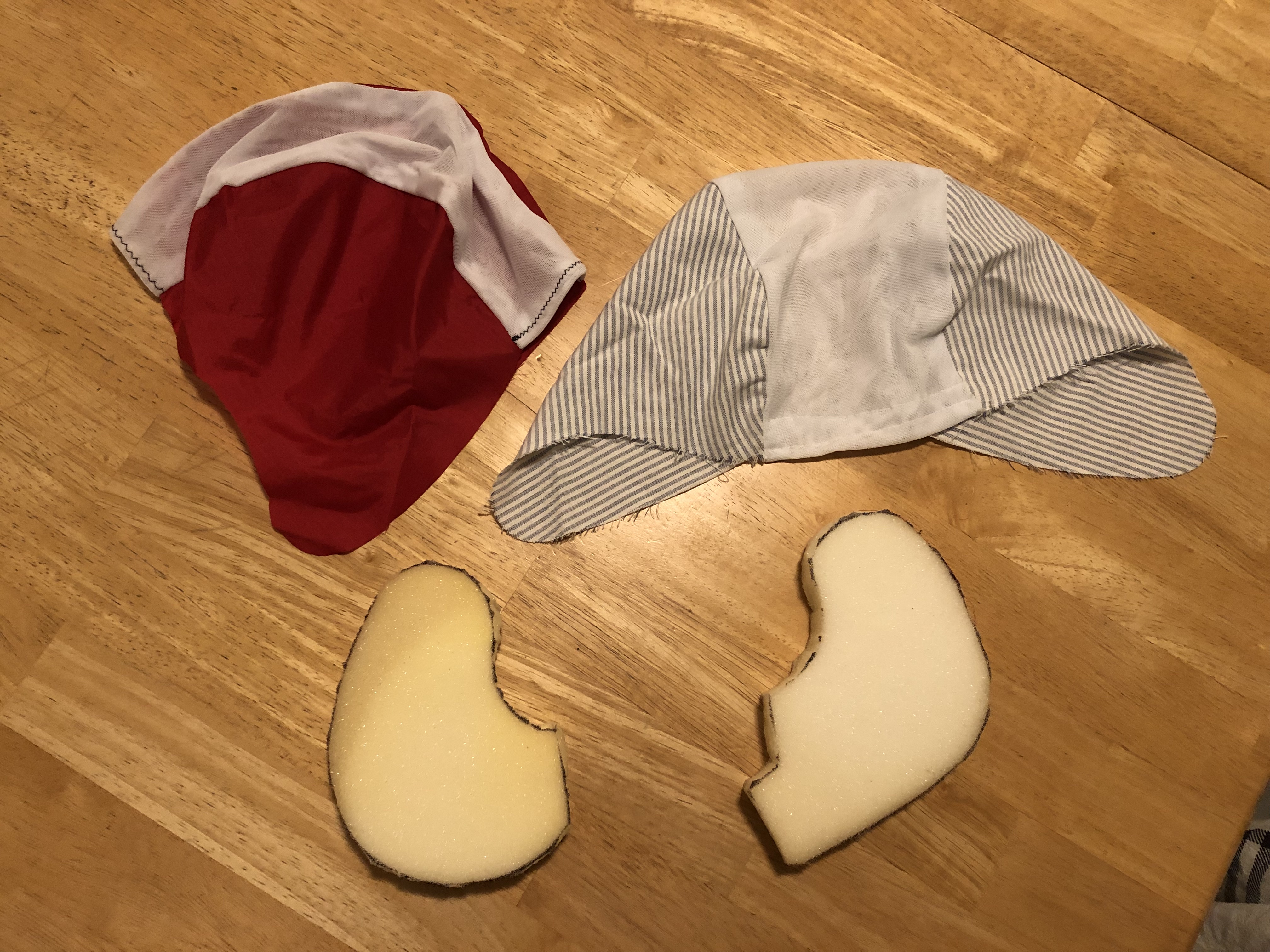

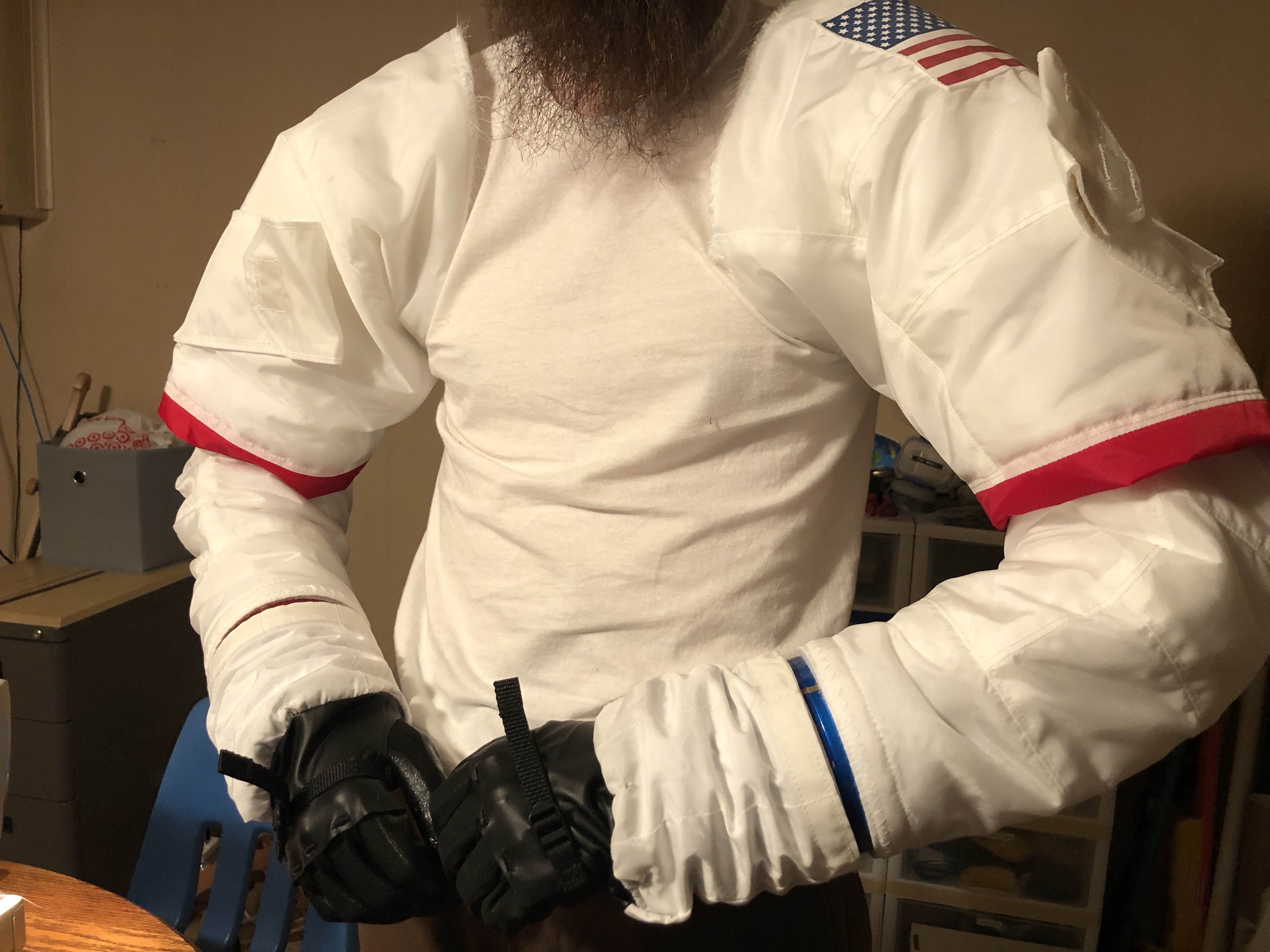

I’ve done a couple test pieces of the shoulder to try and get the sizing right for me, and I did some tests of the snoopy cap, using scrap nylon and power mesh (which I’ll also use in the final). And I cut out the shapes for the ears out of foam, which will eventually sit in pockets on the cap.

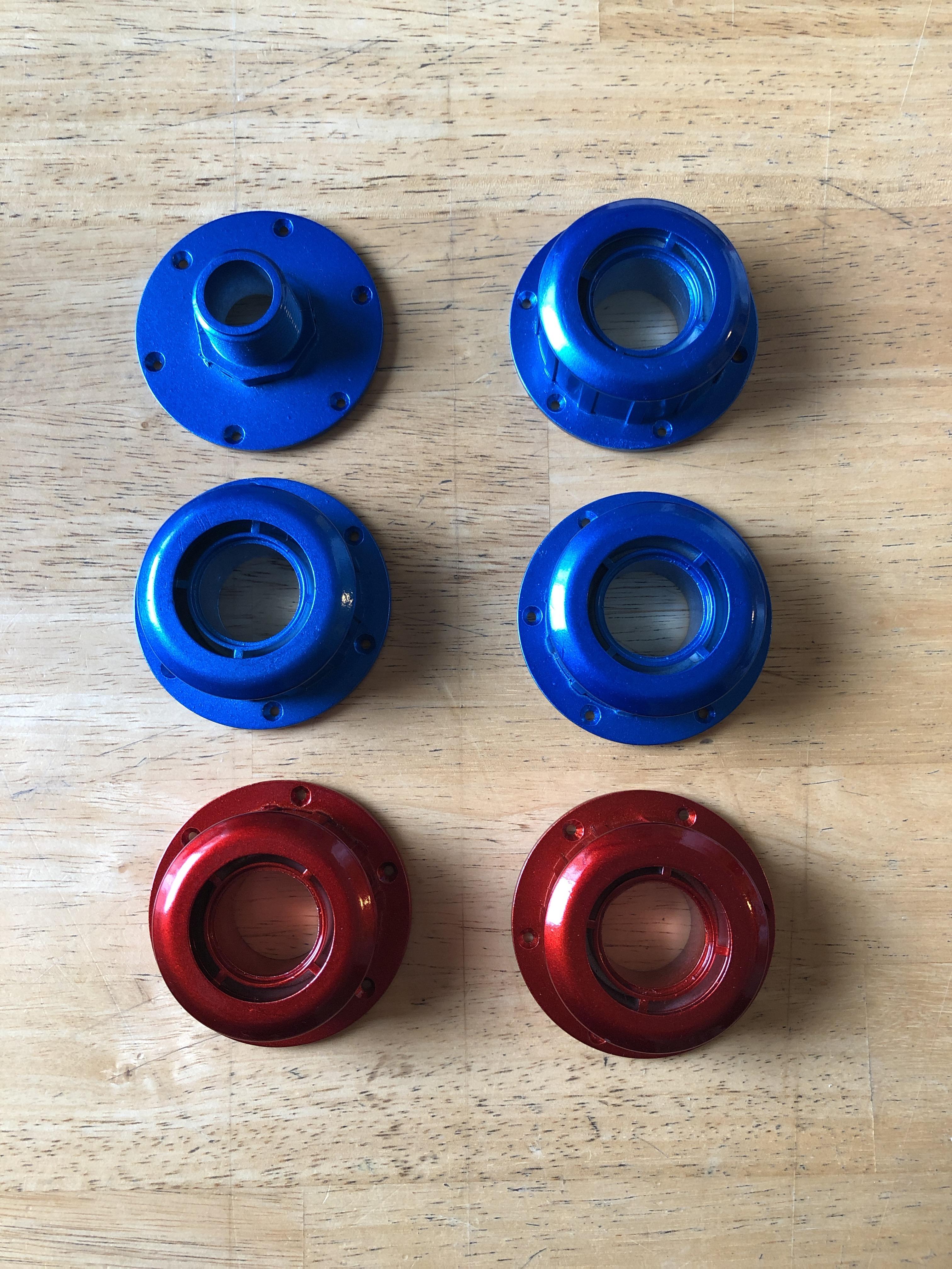

For the chest connectors, I started with a 3/4” PNC union.
I screwed it apart and removed one of the connectors and ended up with this.
Than I used my Dremel to widen the hole on the front side.
For the flange with the screws, I started with a 3” PVC test cap, and used a 3” hole saw to cut out a disk, a smaller hole saw to cut a hole just big enough for the back connector of the union, and then drilled and countersunk screw holes around the edges.
The electrical connector was the same deal, but I used a 3/4” threaded adapter instead of the union.
I then painted everything with Dupli-Color Metalcast (ground coat and then red or blue where appropriate). It worked really well and came out looking great IMO.

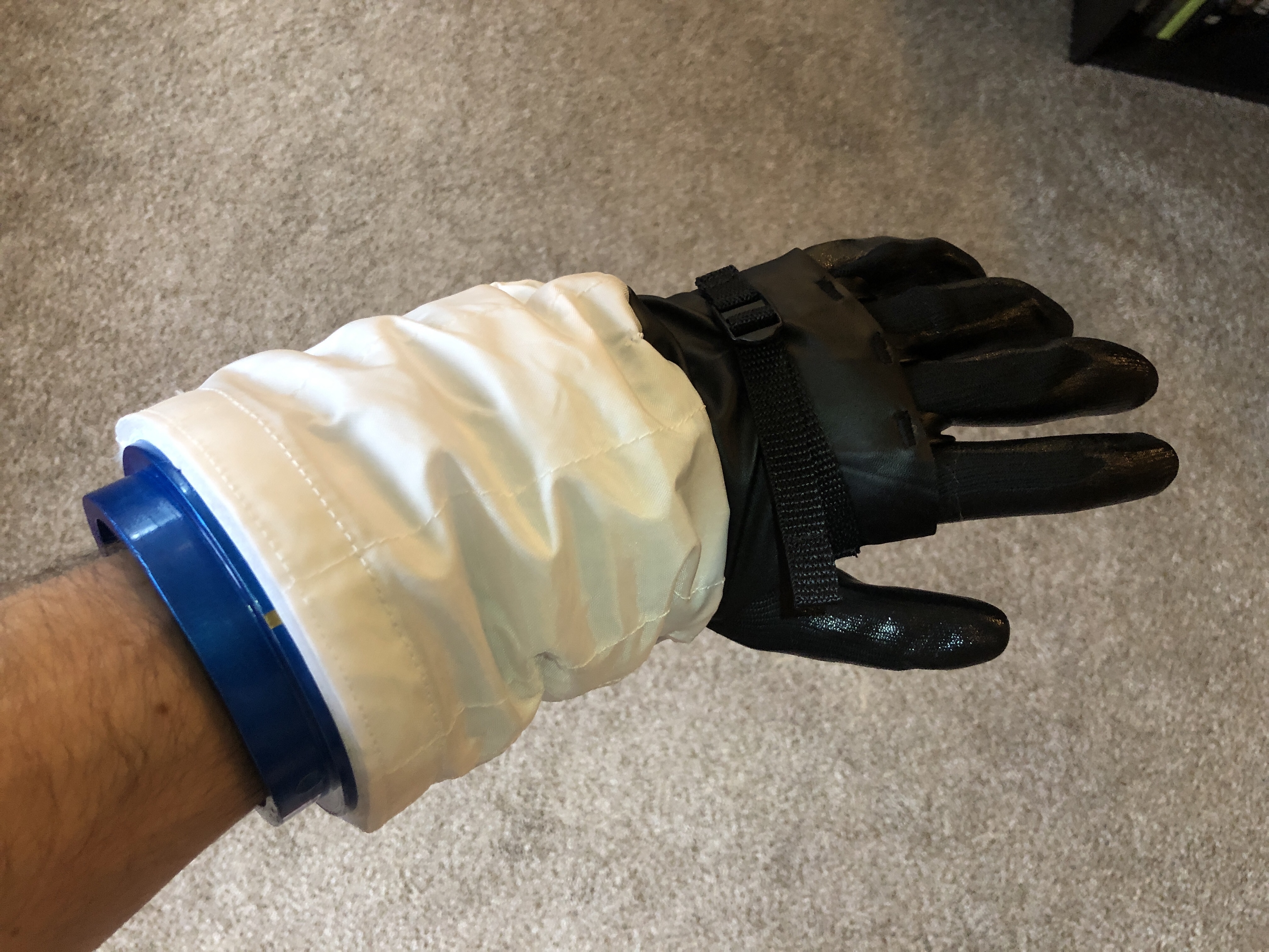

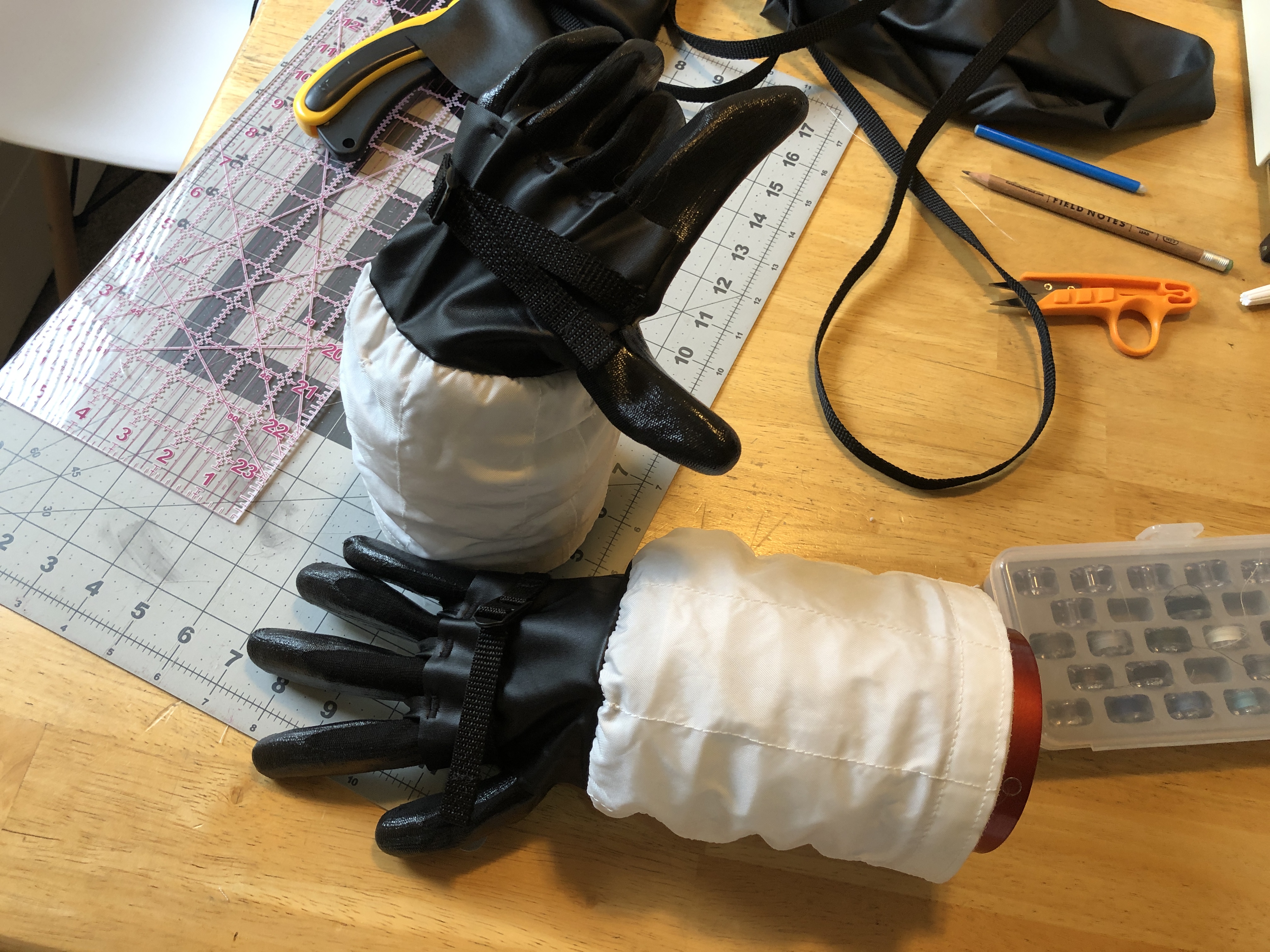

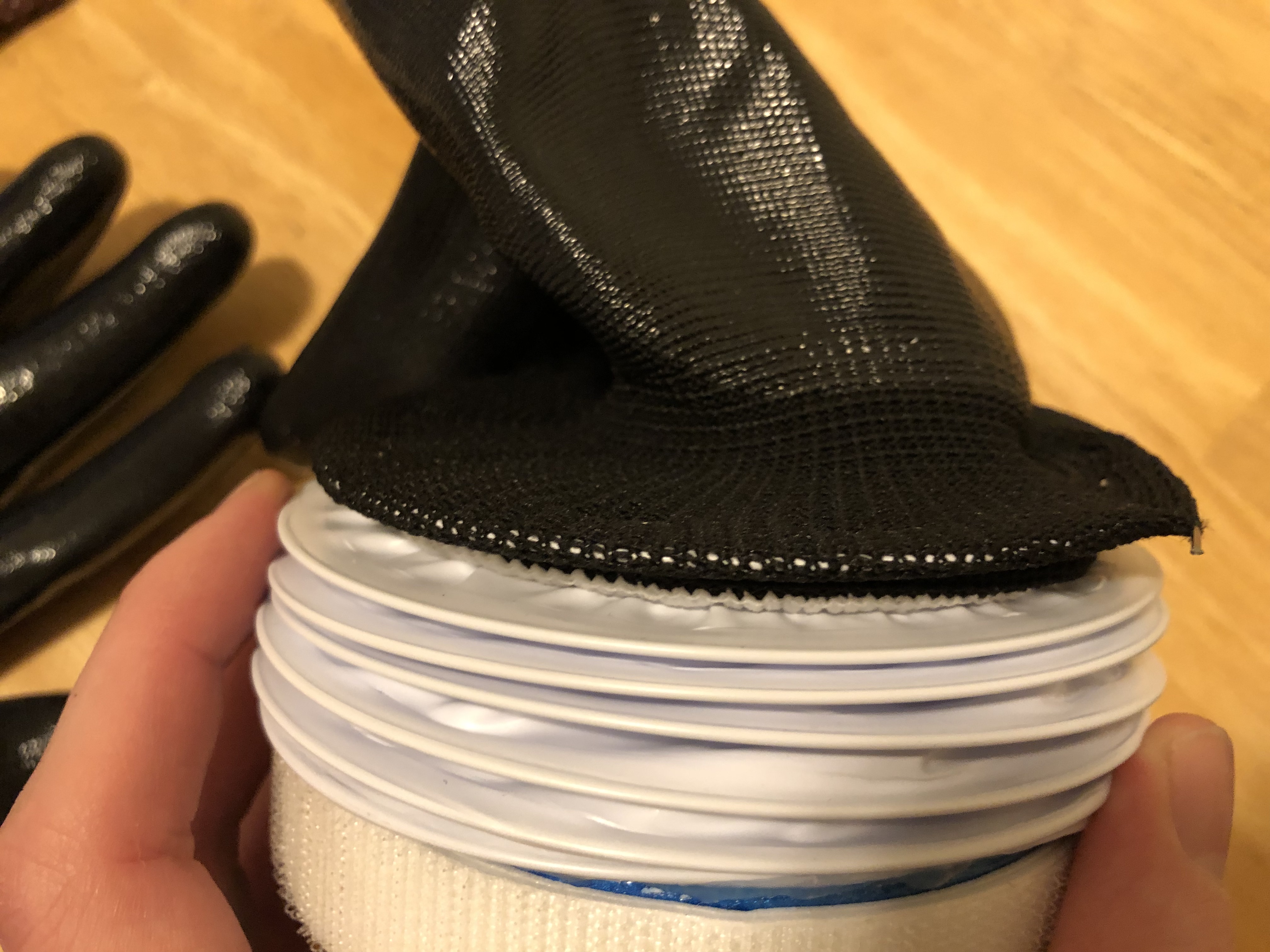

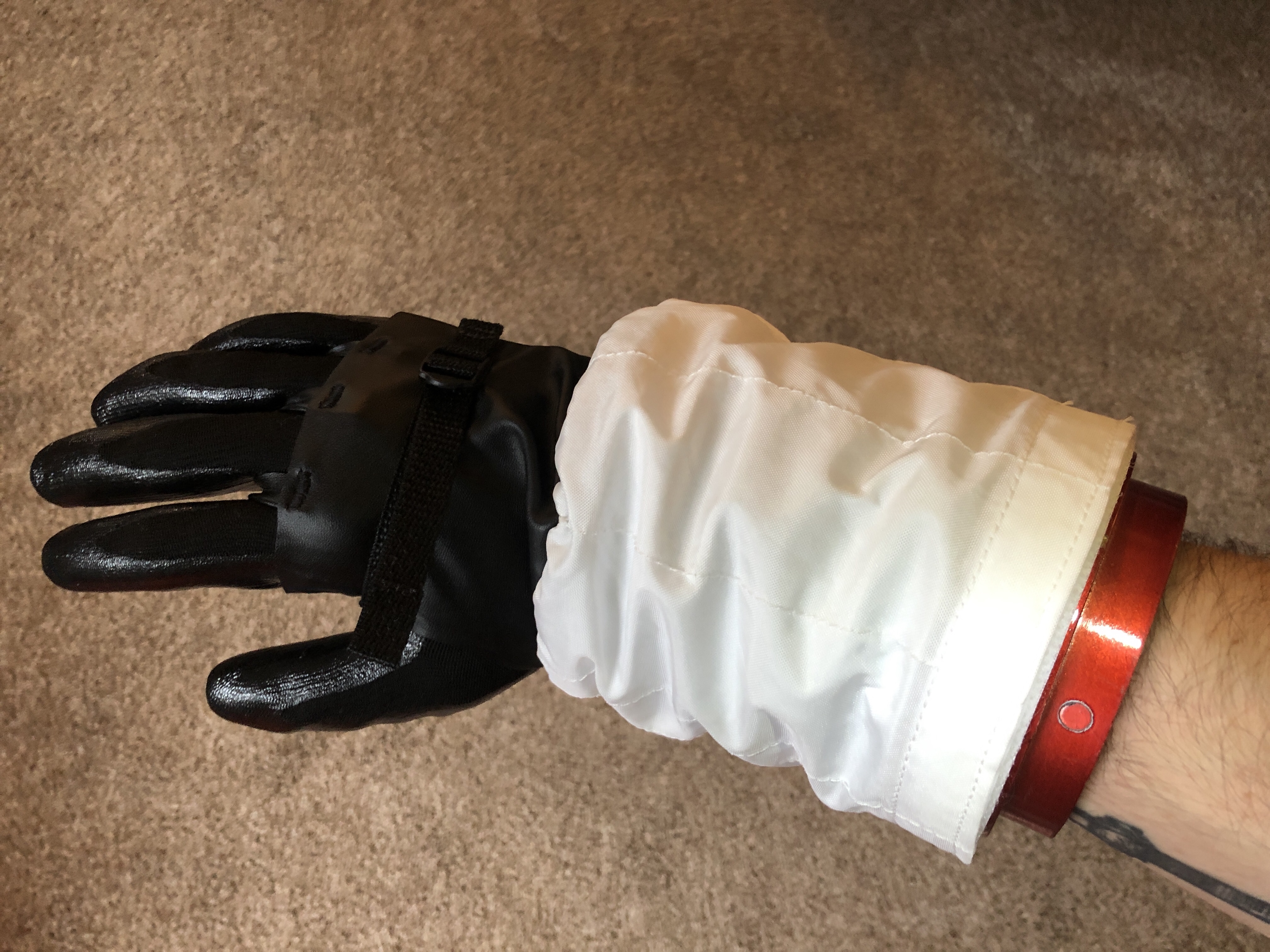

The glove construction I used is very similar to what Mr. Nagata did in his post. I used 4” white vinyl duct as the convolute and stapled polyurethane-coated work gloves from Harbor Freight onto one end.

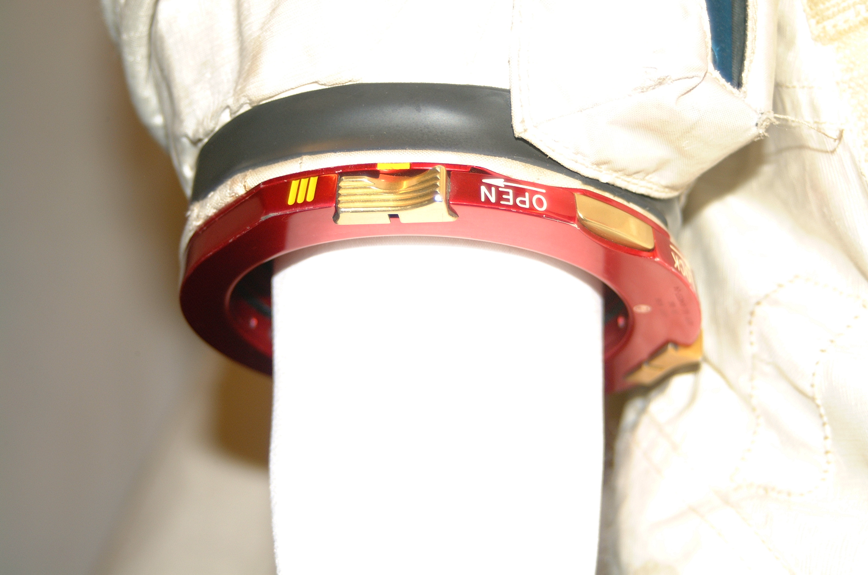

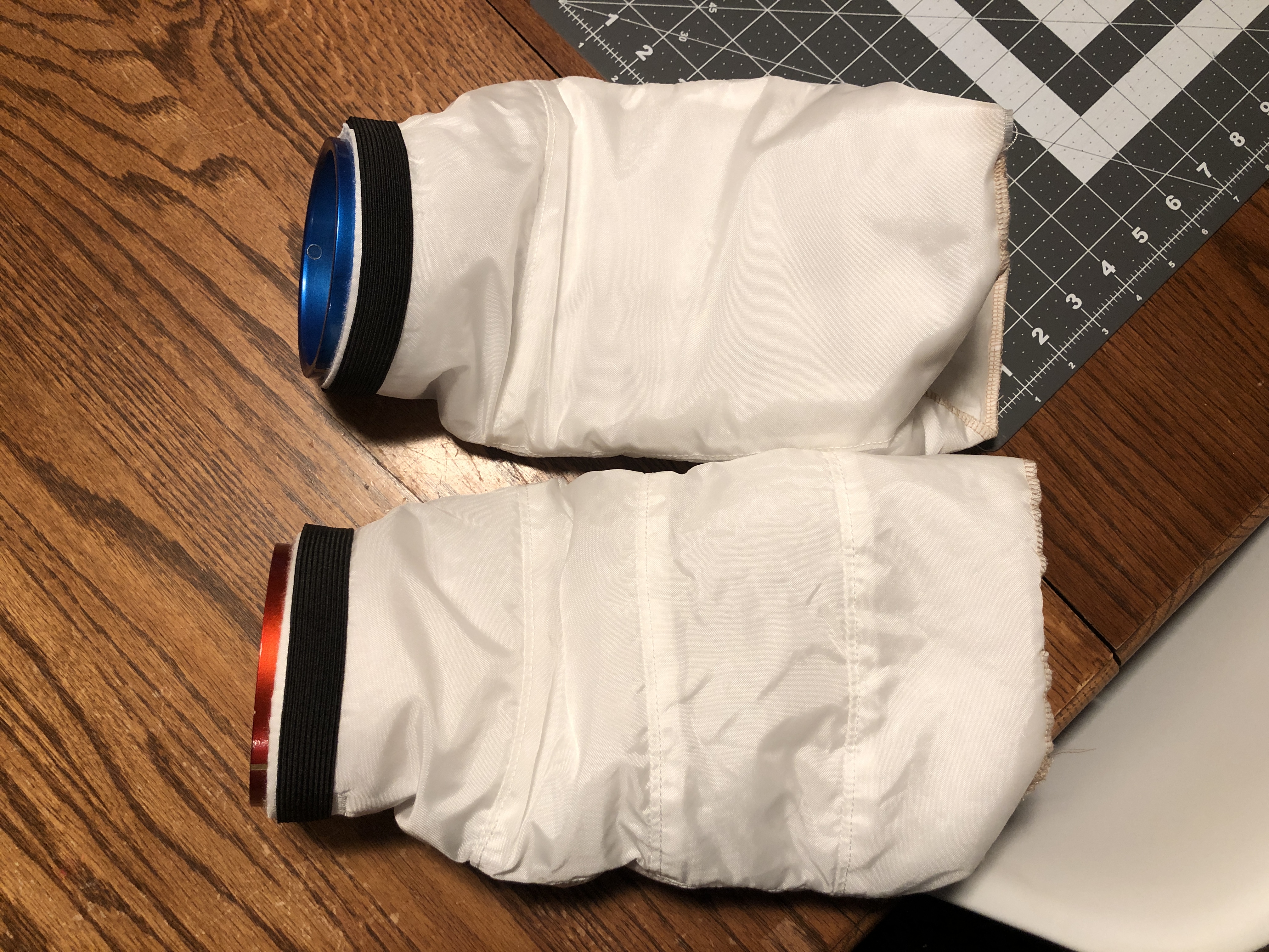

The wrist rings are also PVC parts. The glove side is a 3" spigot female PVC adapter. I trimmed the smaller-diameter side to length and sanded off the bumps on the other half.
The suit side is a 3” coupler that I cut right in half and used the two halves for each side. The narrow side of the spigot adaptor fits right into the coupler. I also drilled holes for magnets to hold them together. And then painted with Metalcast, same as the chest connectors. I added velcro to each side which will be the connection to the fabric, once I get there.
I started working on test pieces for the glove fabric. The transition from the White Beta cloth to the black fabric (Vinyl? Pleather? Not sure what was used originally) was really doing my head in. The black fabric always looked too wide compared to my reference. But after some help from my sewing wizard mother, I think I got a test piece that’s looking pretty good.
The test piece uses ribbed jersey fabric, but I got some stretchy, black pleather to use for the final piece.

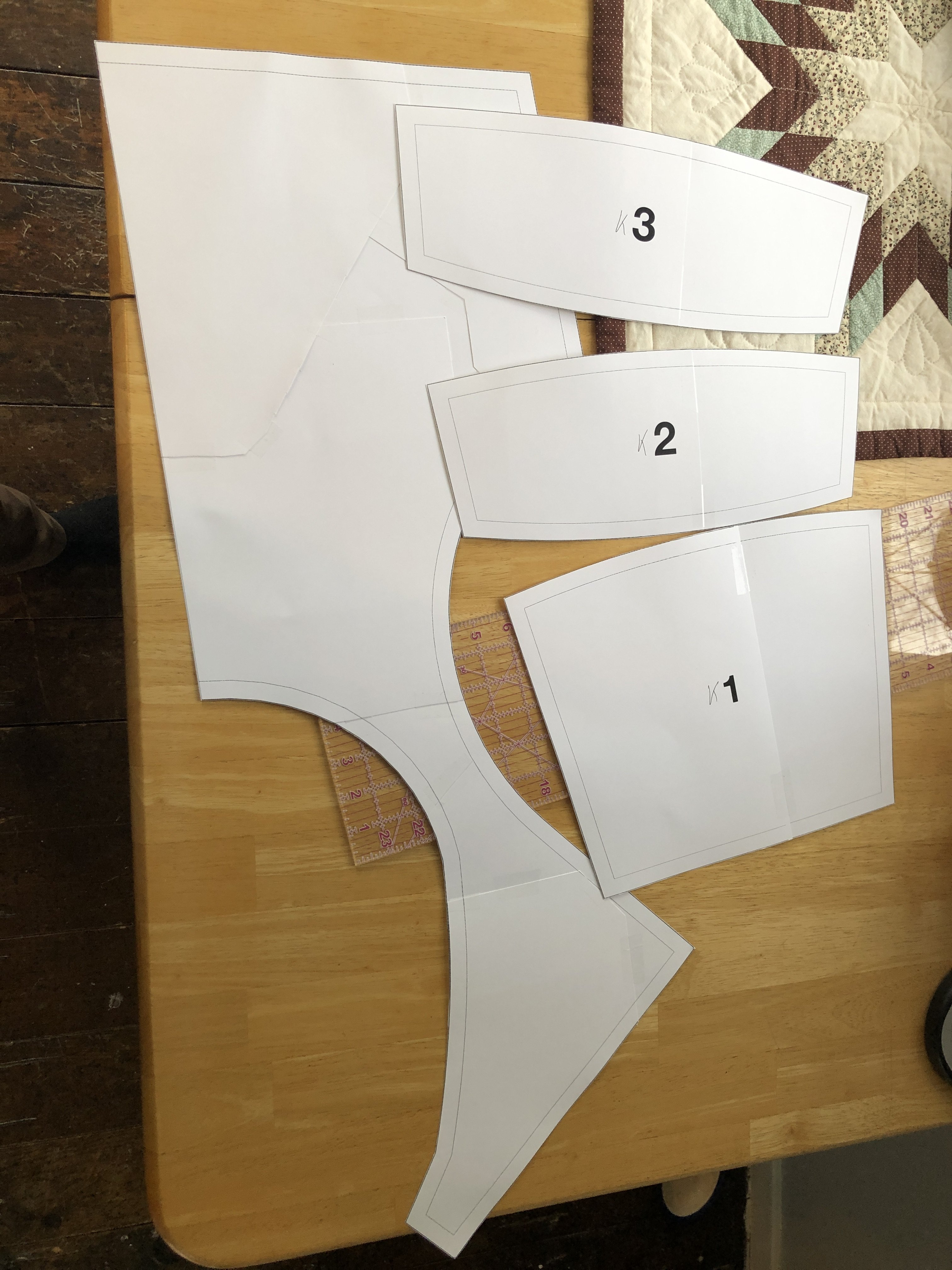

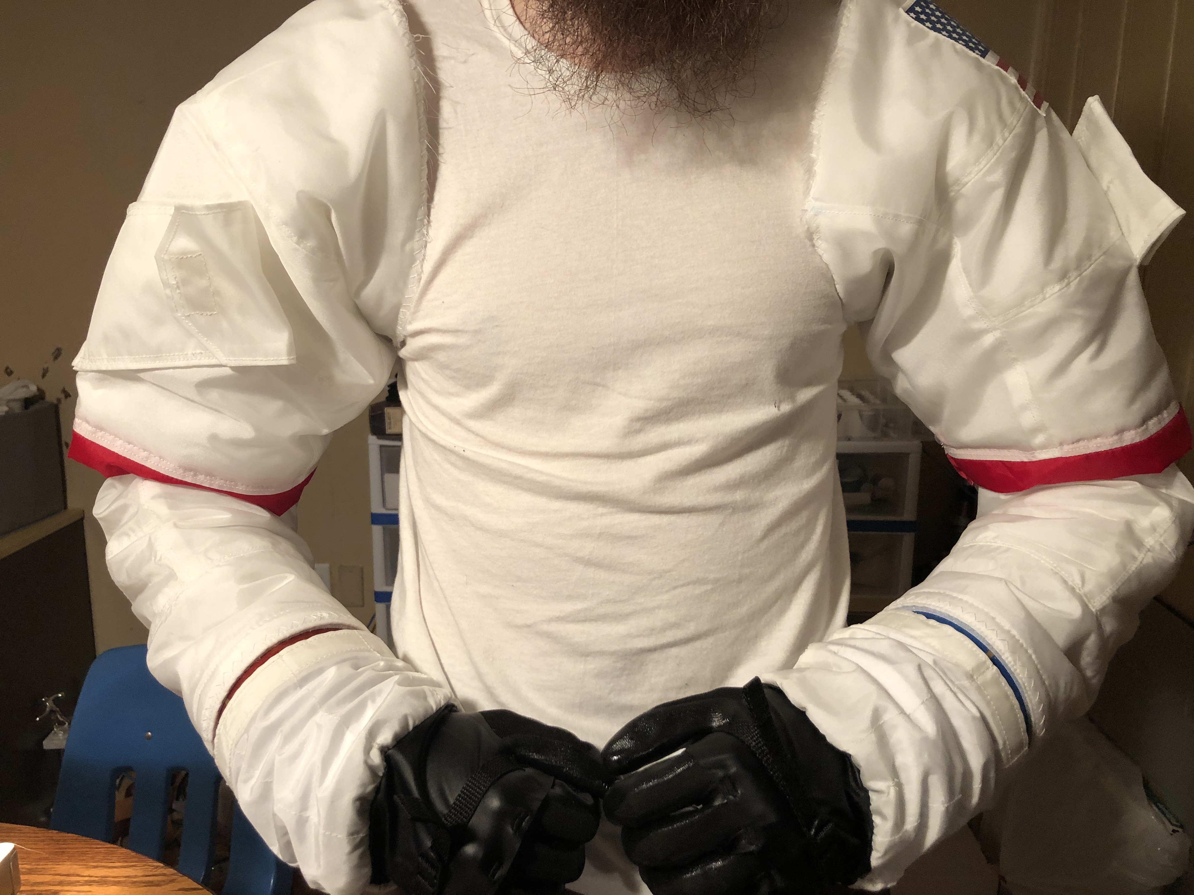

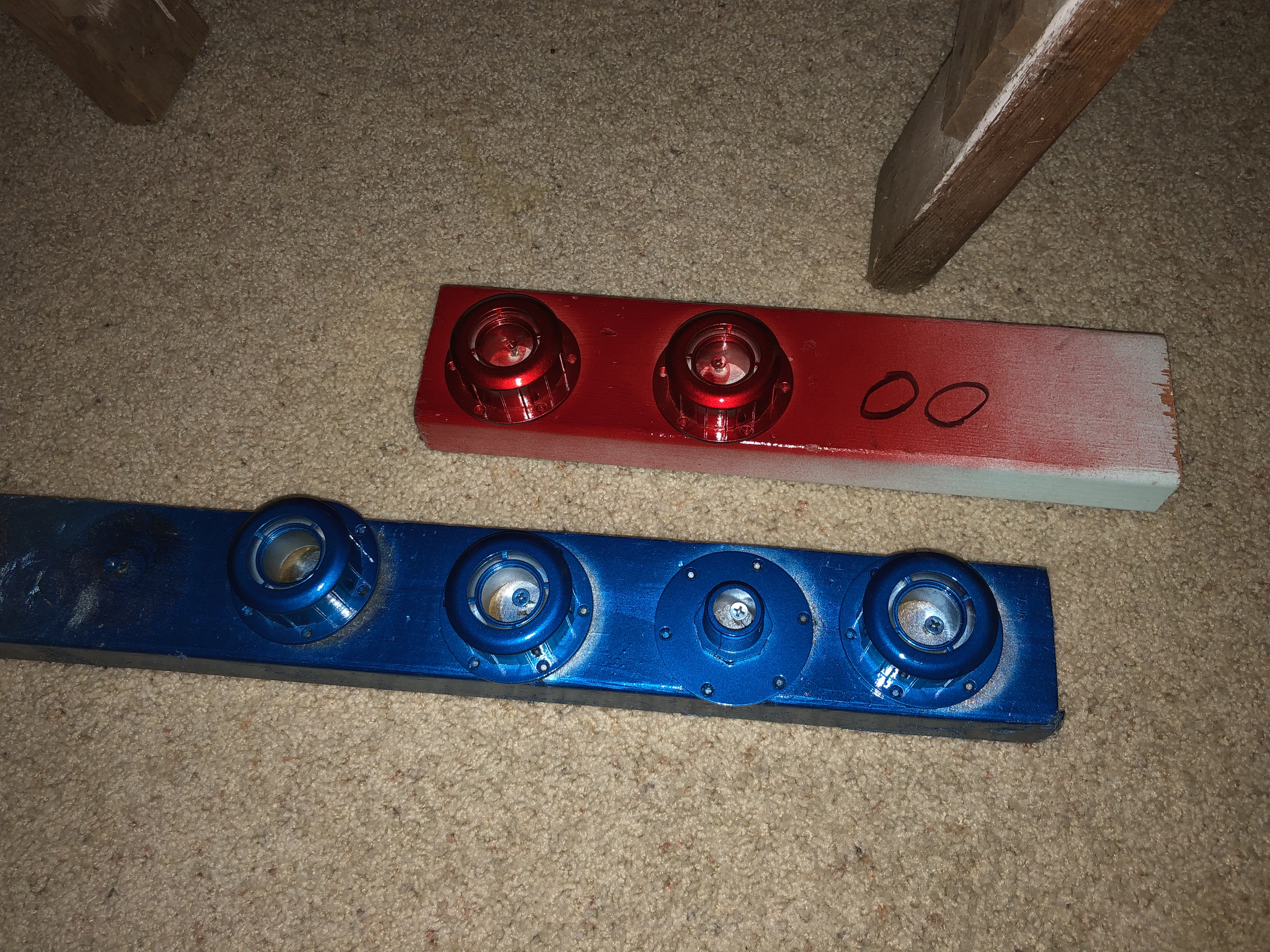

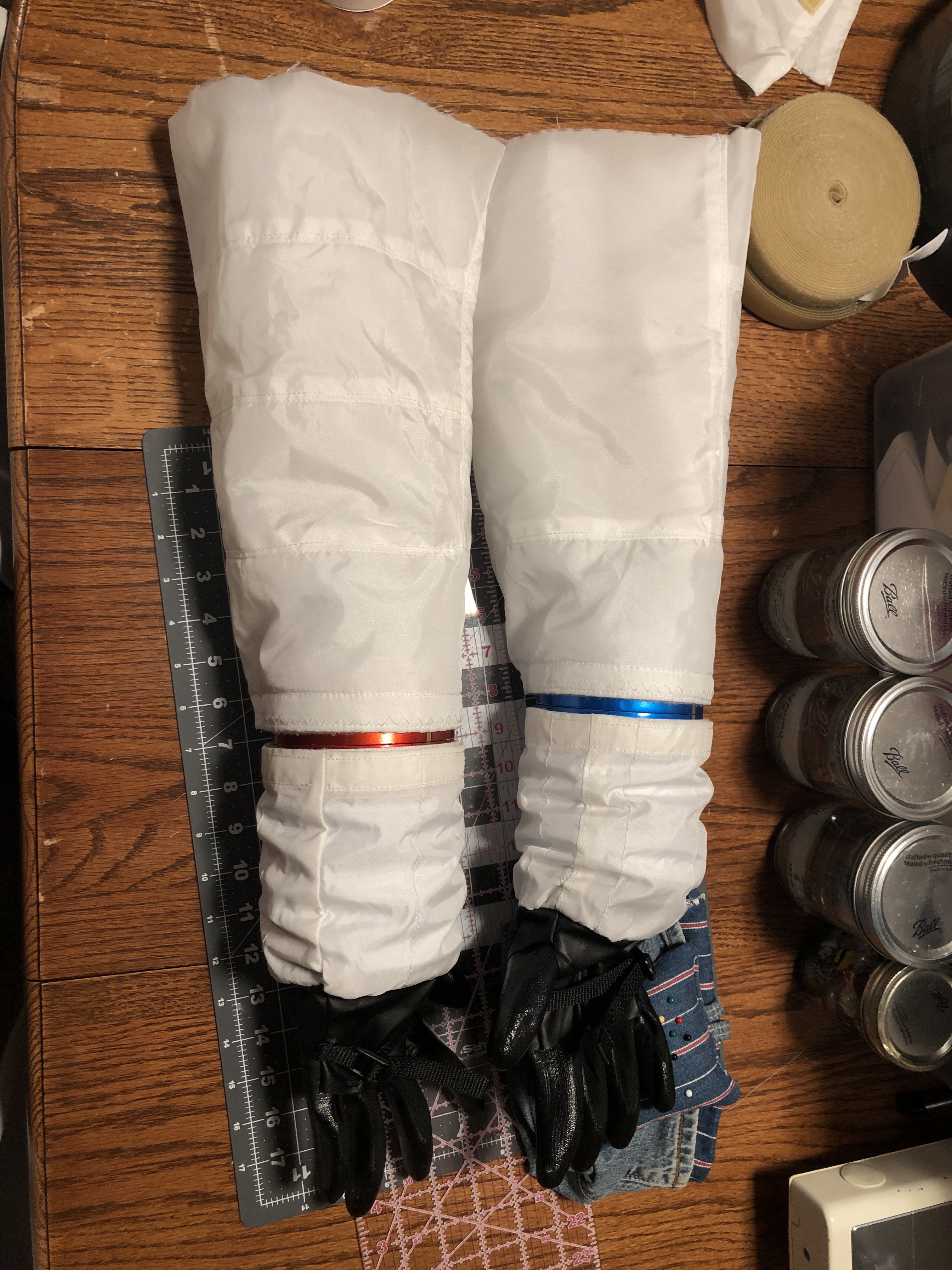

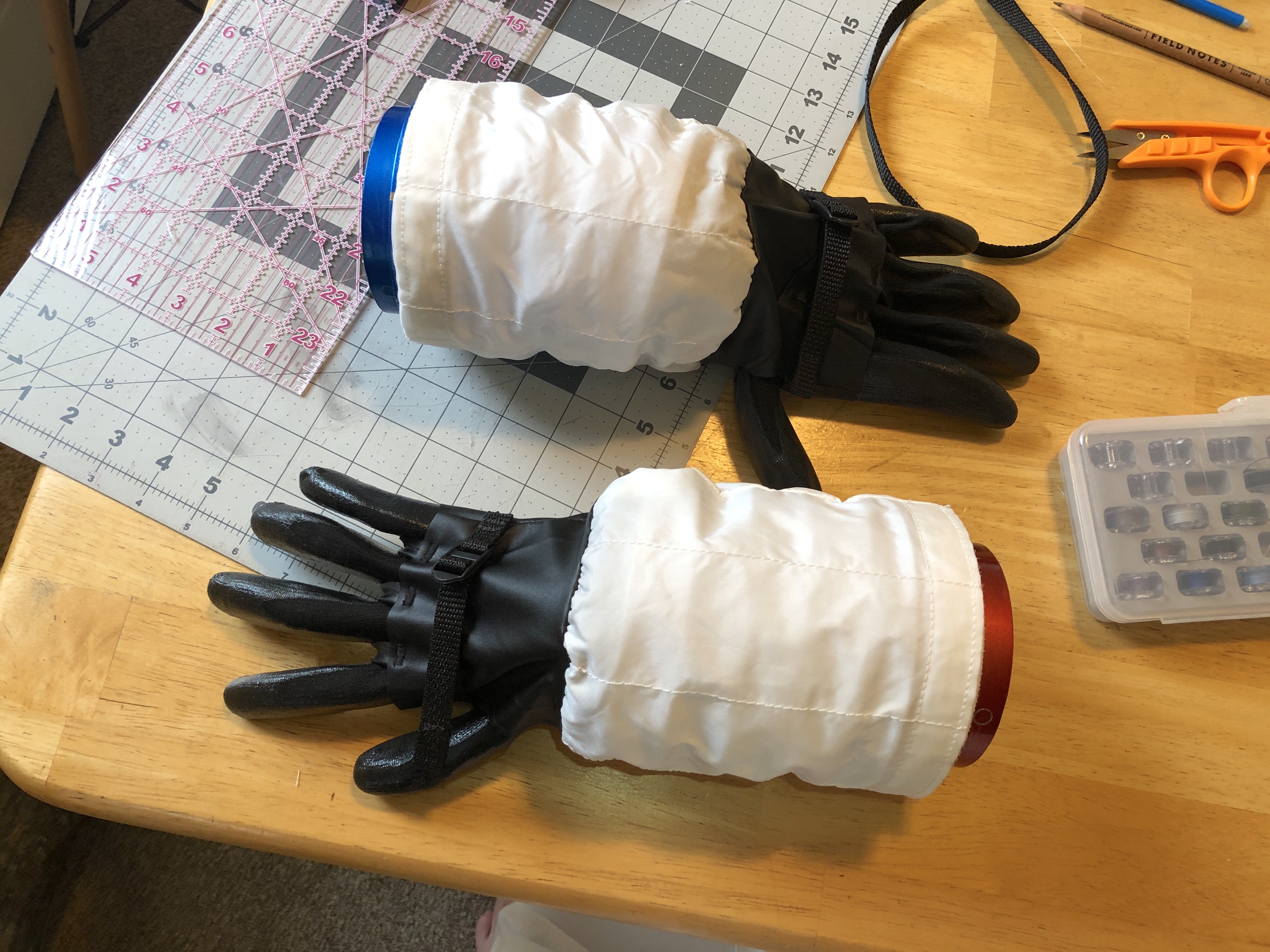

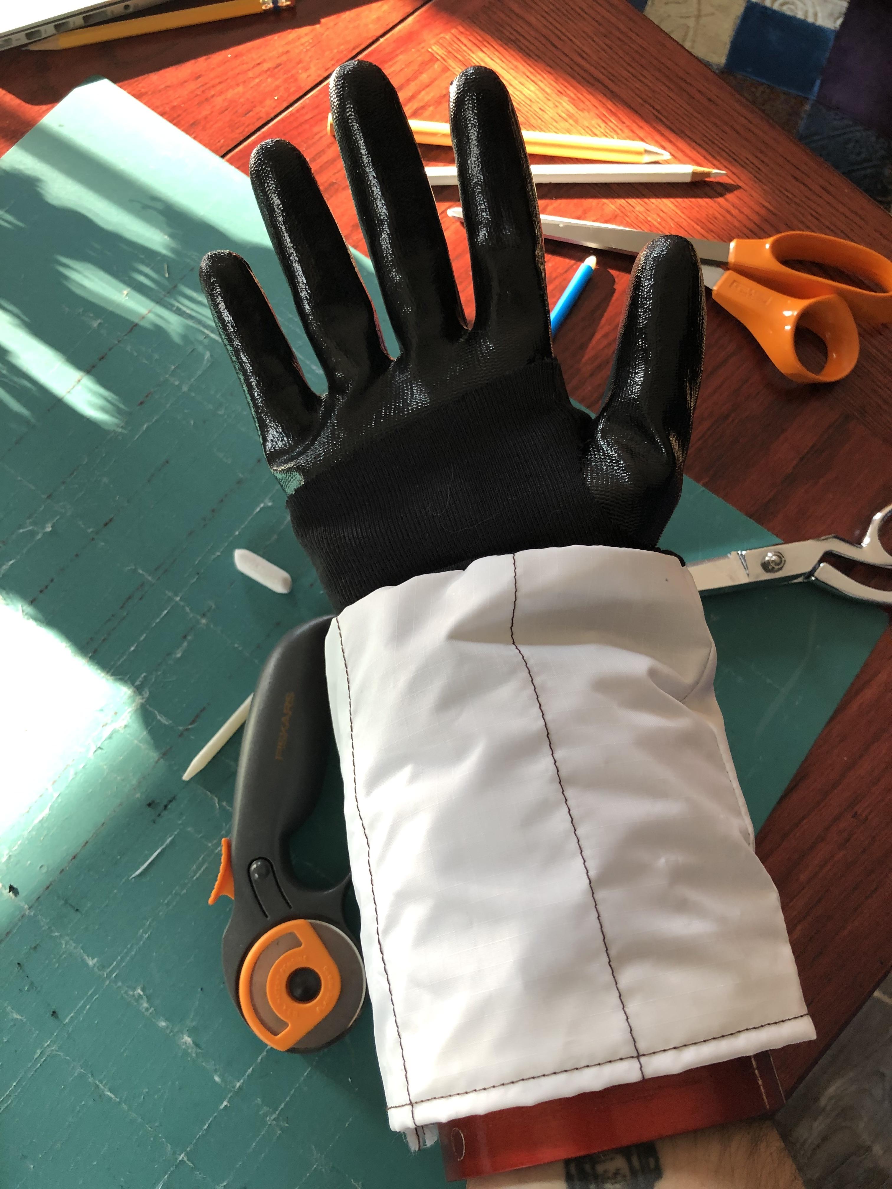

I’m planning on using Joann white sport nylon as the Beta cloth, and ironing board fabric as the Chromel-R.
Construction-wise, I plan to go the route Nagata did in his post. Meaning lining it in velour and velcroing boning on the inside to give it structure.
