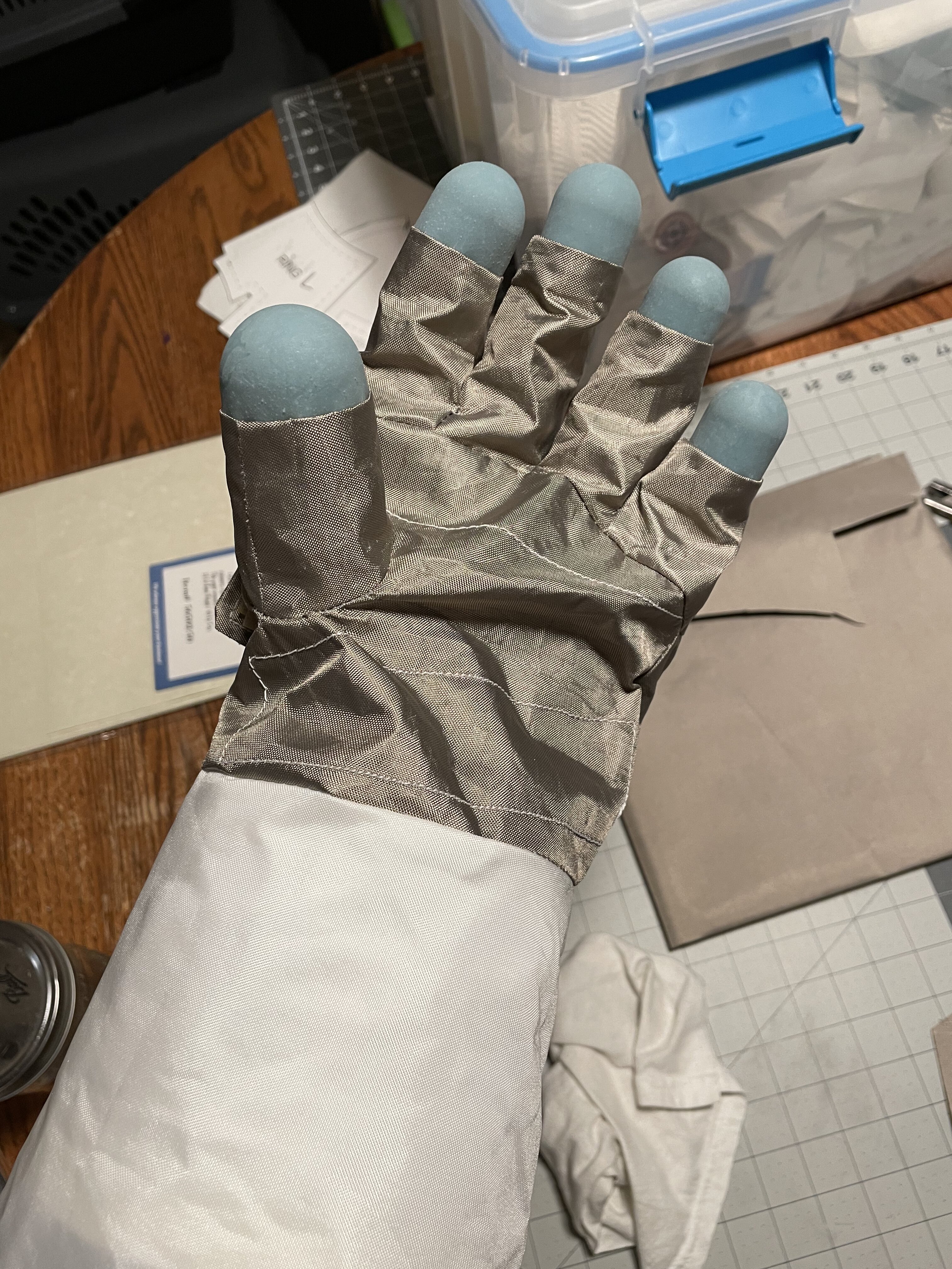

I’ve been quite busy for the last almost year.

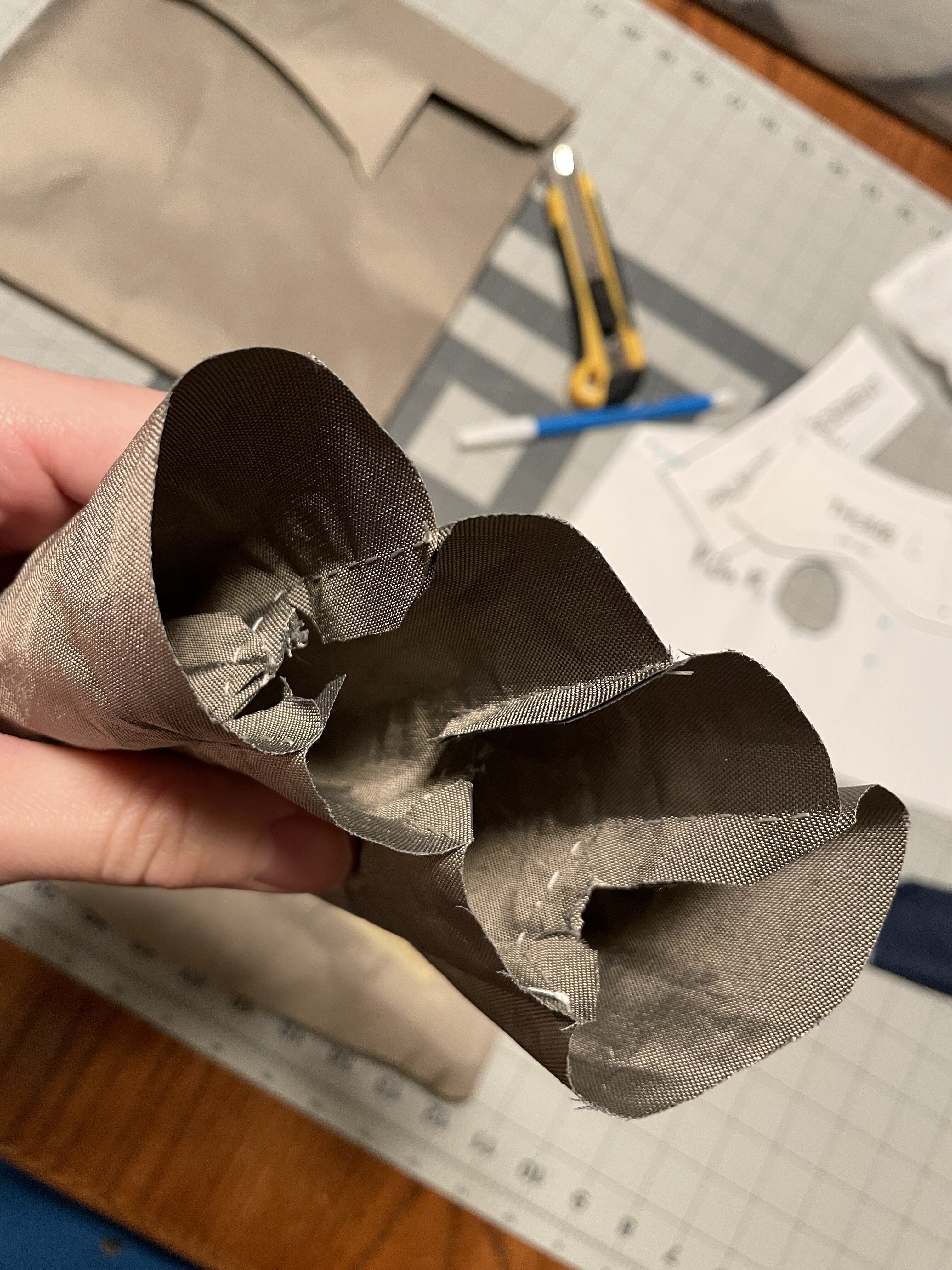

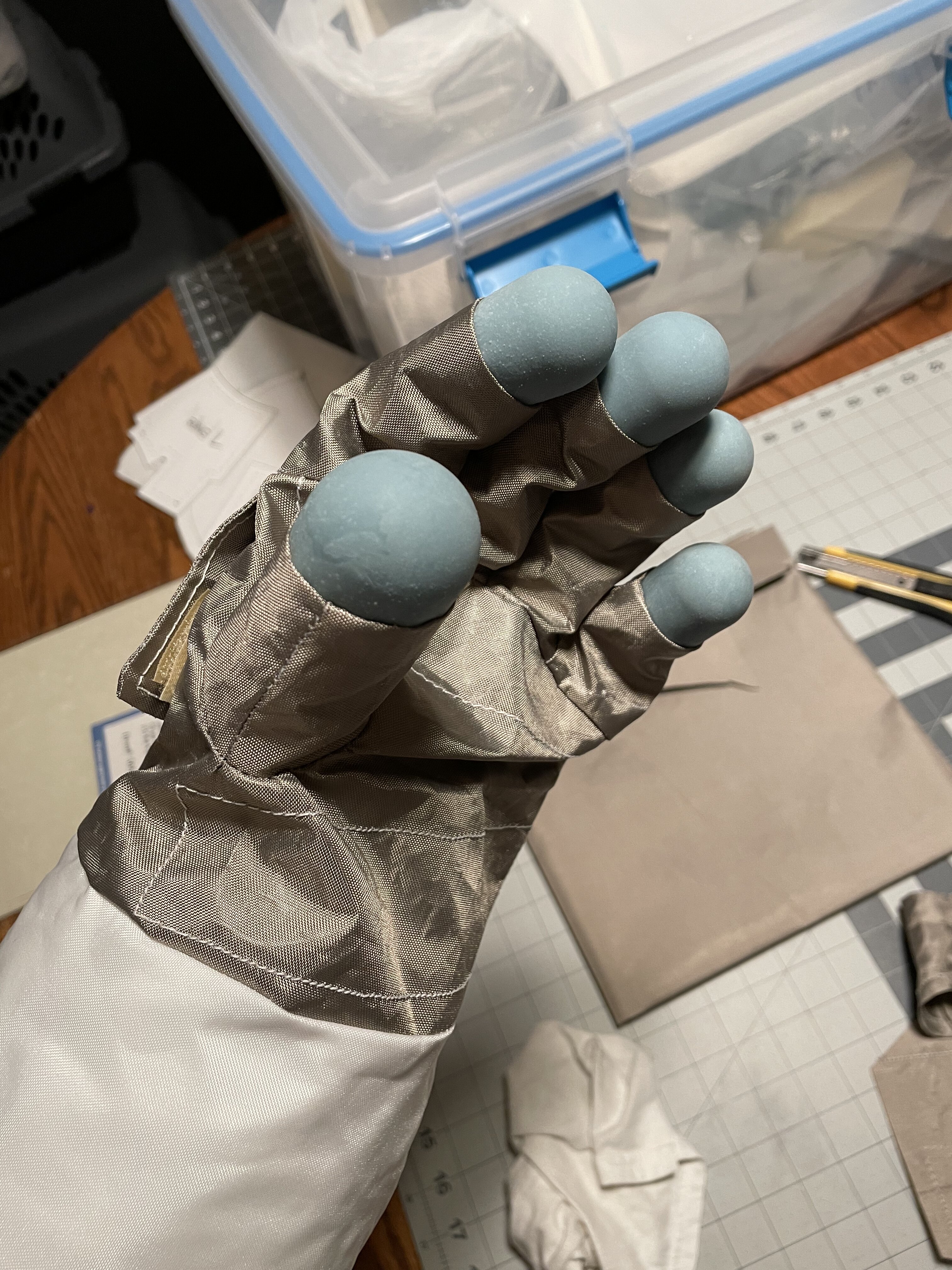

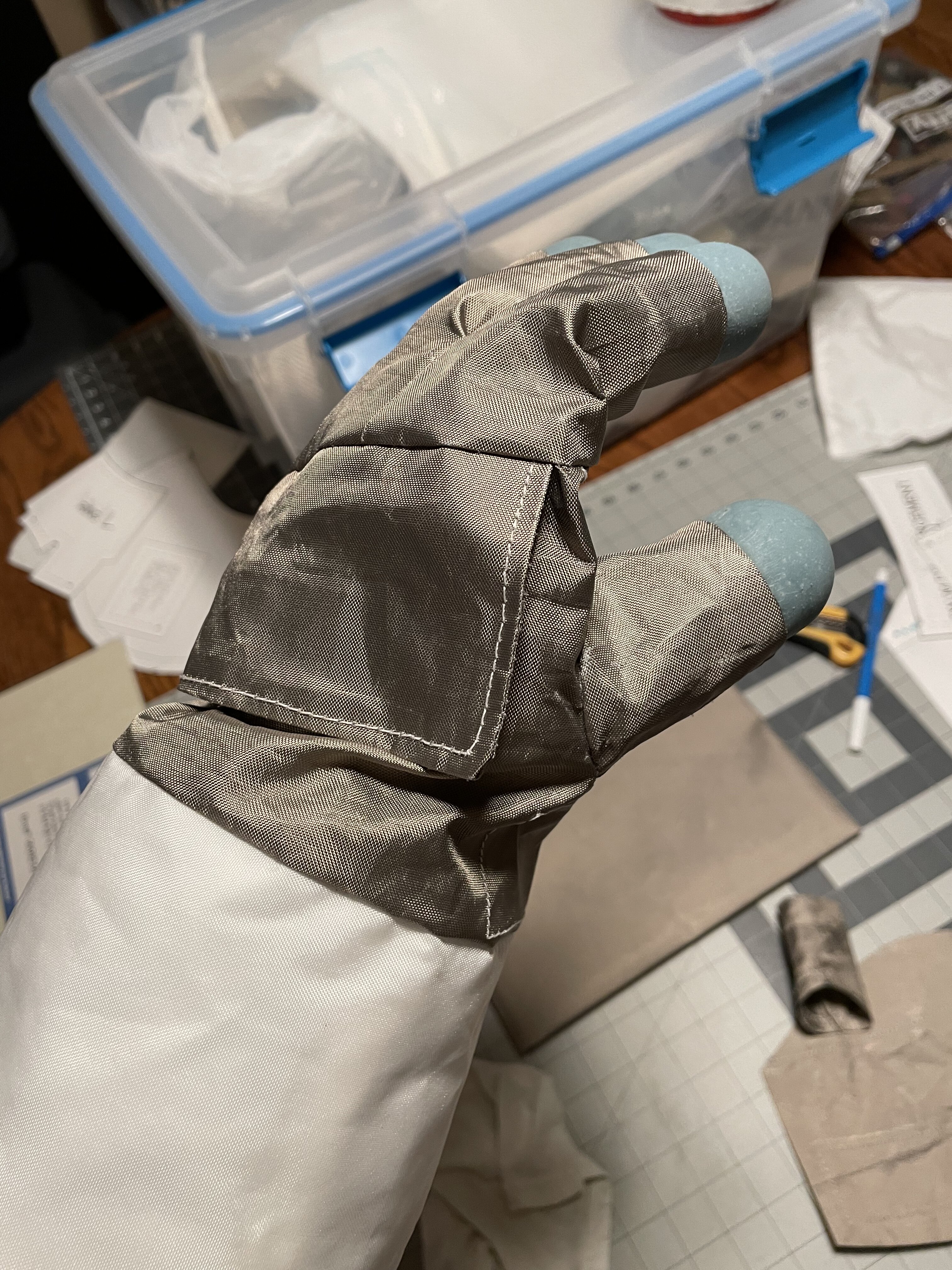

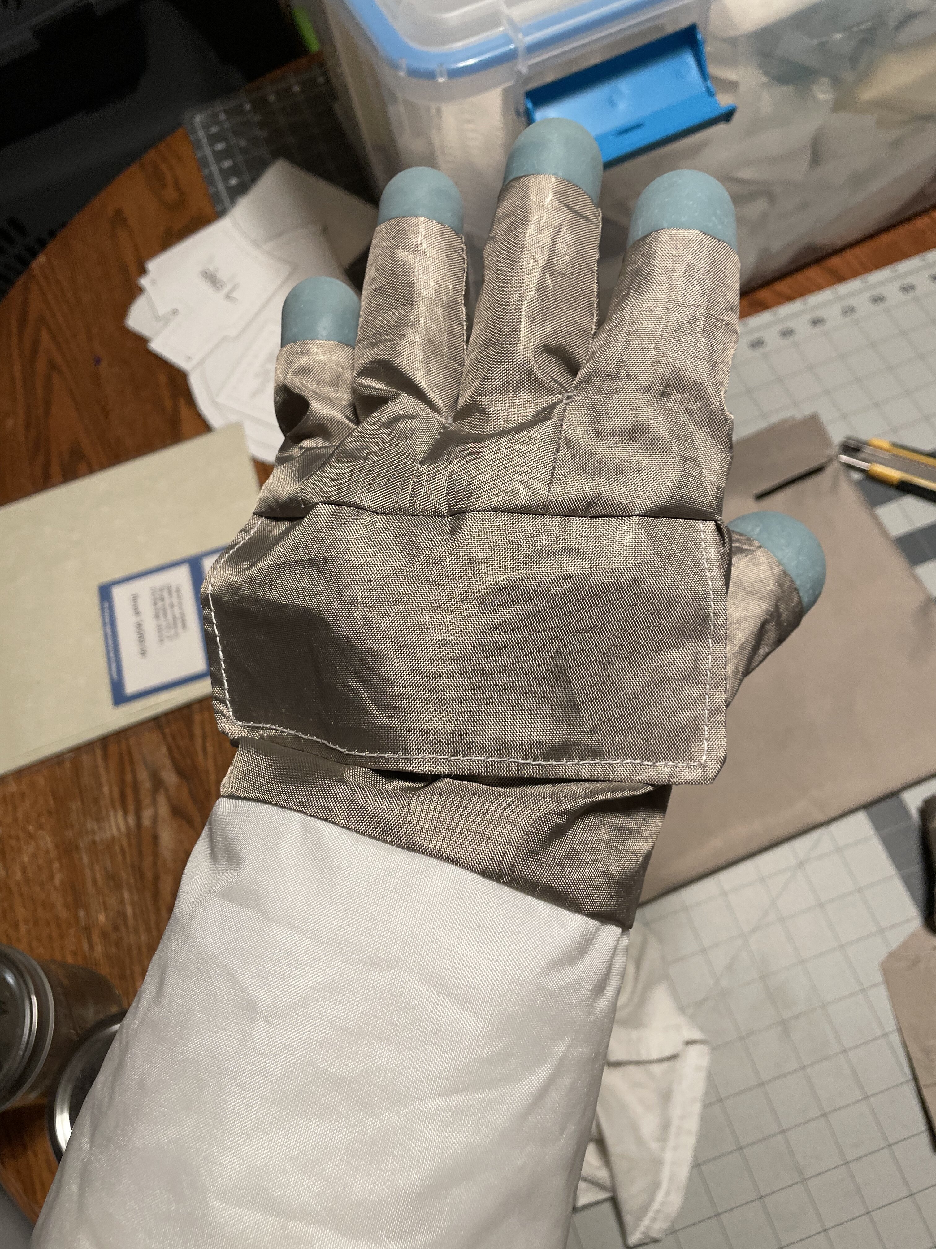

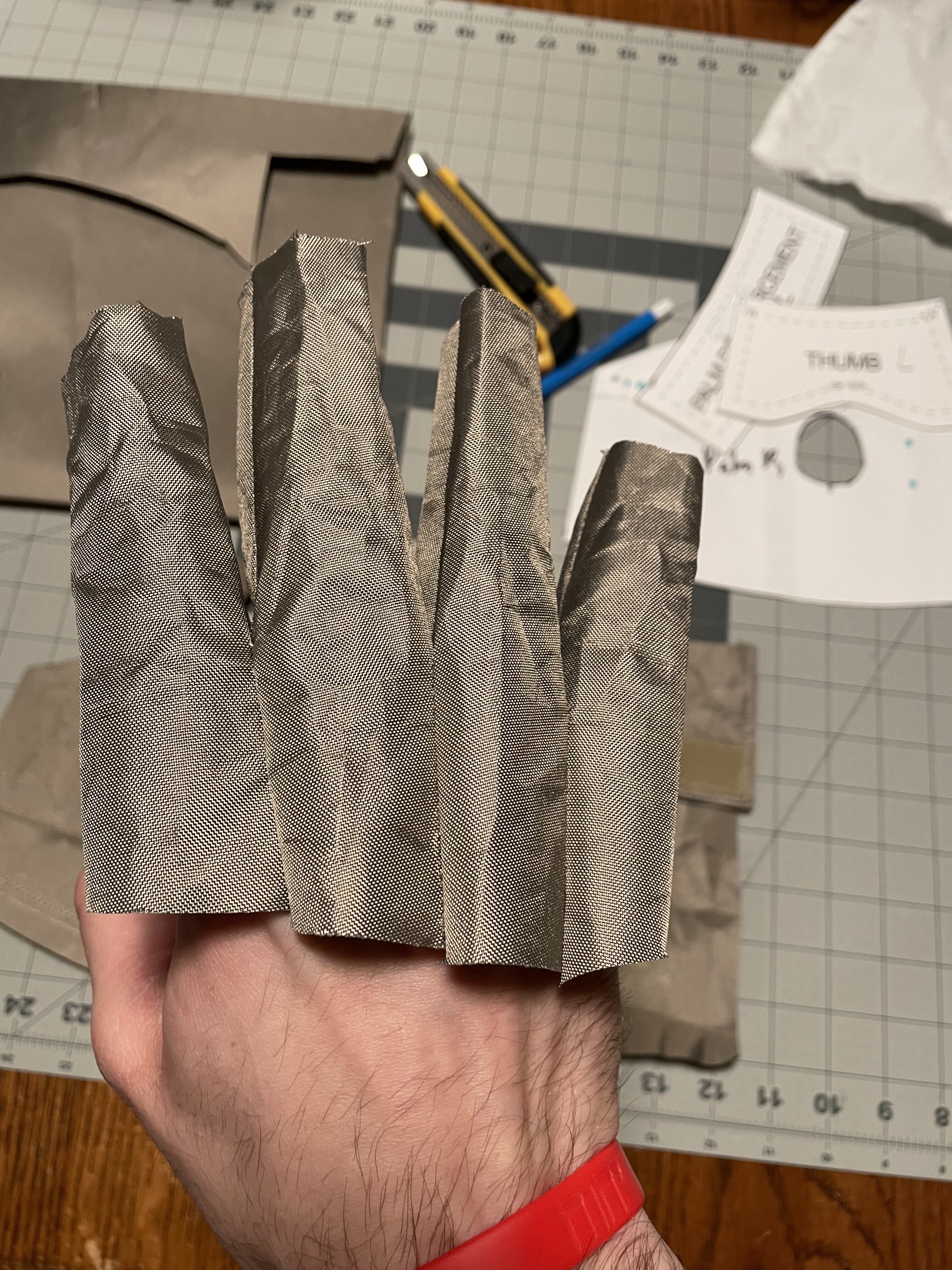

But my EVA gloves are finally finished. I used kenlandrum’s pattern, the same nylon as the rest of the suit, RFID fabric I found on eBay, and rubber finger tips I bought from Global Effects on eBay. I’m so glad I found those finger tips, because I don’t know how I would’ve done it otherwise and it assuredly wouldn’t have turned out as nice.
I ended up hand sewing the fingers together and hand sewing the tips to the end of the fingers.
View attachment 1460502View attachment 1460503View attachment 1460504View attachment 1460505View attachment 1460510
And here’s the finished glove. I’m very happy with it.
View attachment 1460511View attachment 1460512View attachment 1460513View attachment 1460509
The shaping of kenlandrum’s pattern turned out very nice.
I had to make some adjustments to get the end of the fingers to fit my specific finger tips.

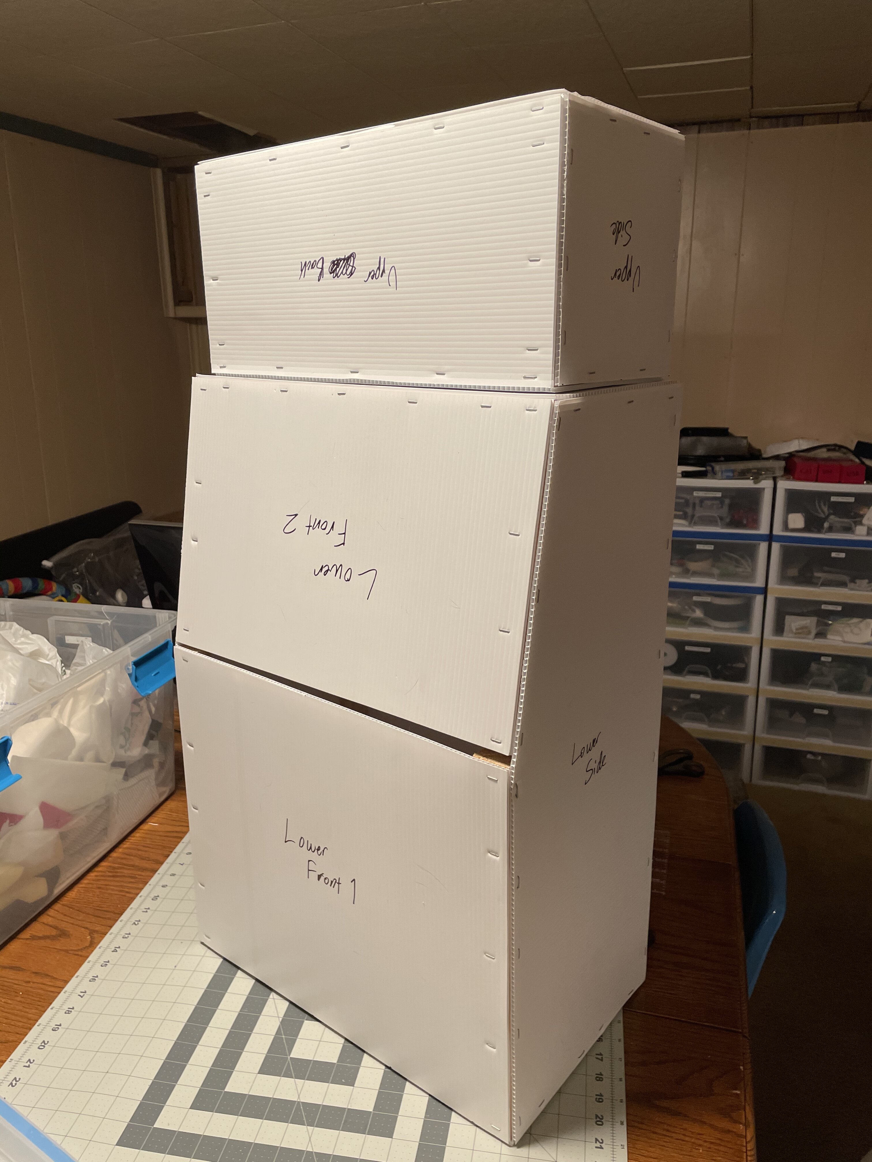

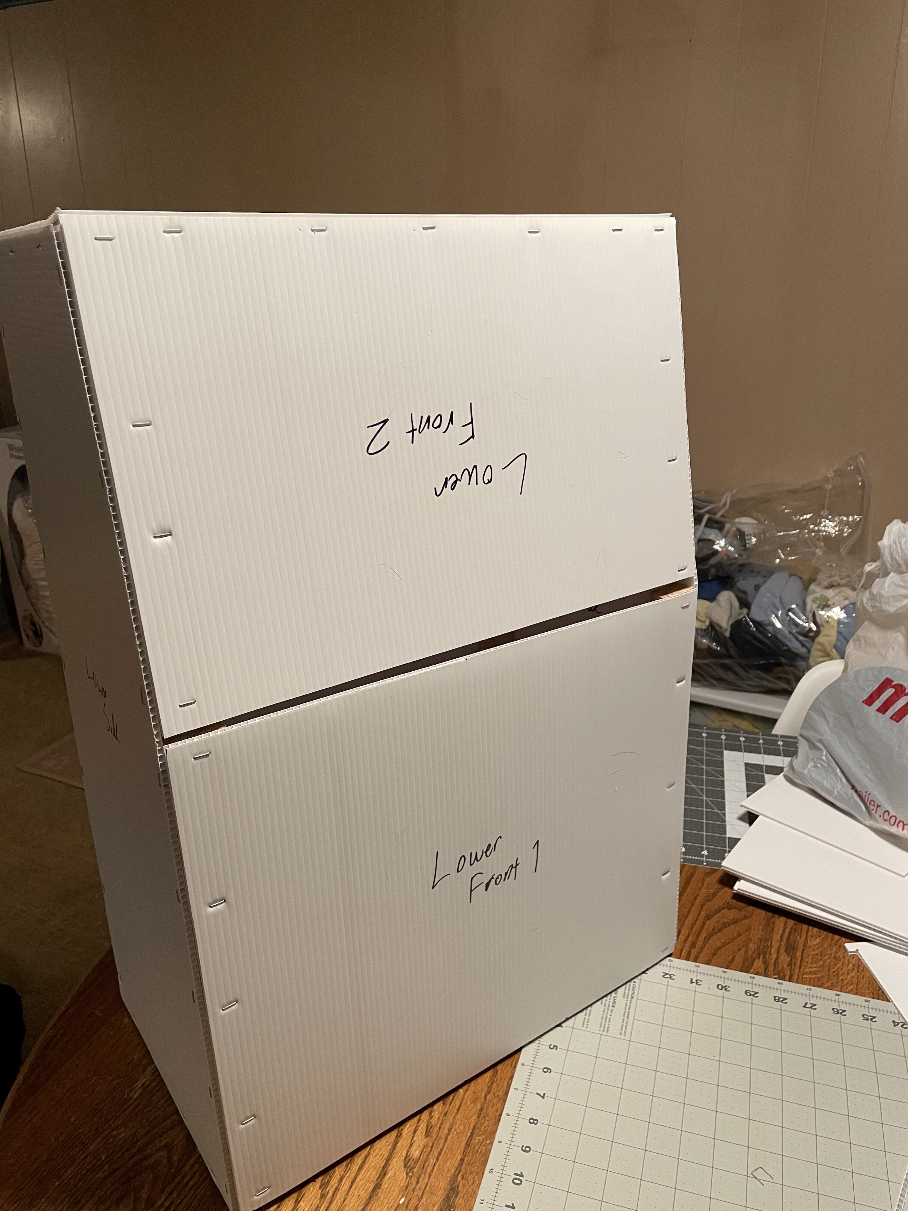

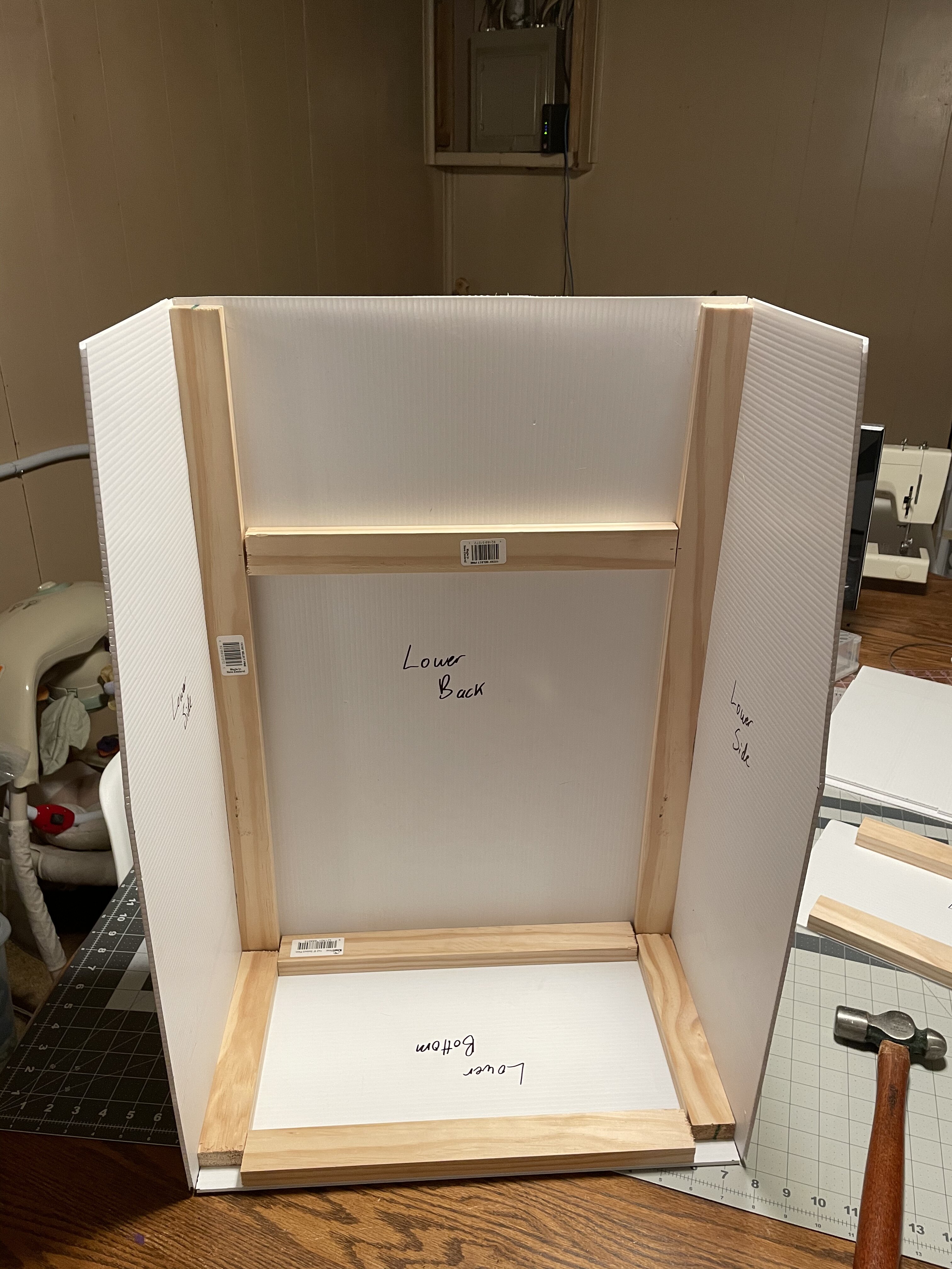

I also did some work on the PLSS. I used plastic corrugate stapled to a 1x2 frame. So my main structure is done, minus attaching the carry handle to the back. After that, I’ll cover it in a layer of batting and nylon.
View attachment 1460499View attachment 1460500View attachment 1460501
The only work I have left on the suit itself is attaching my pressure release valve, and then making the pressure gauge and gauge cover.

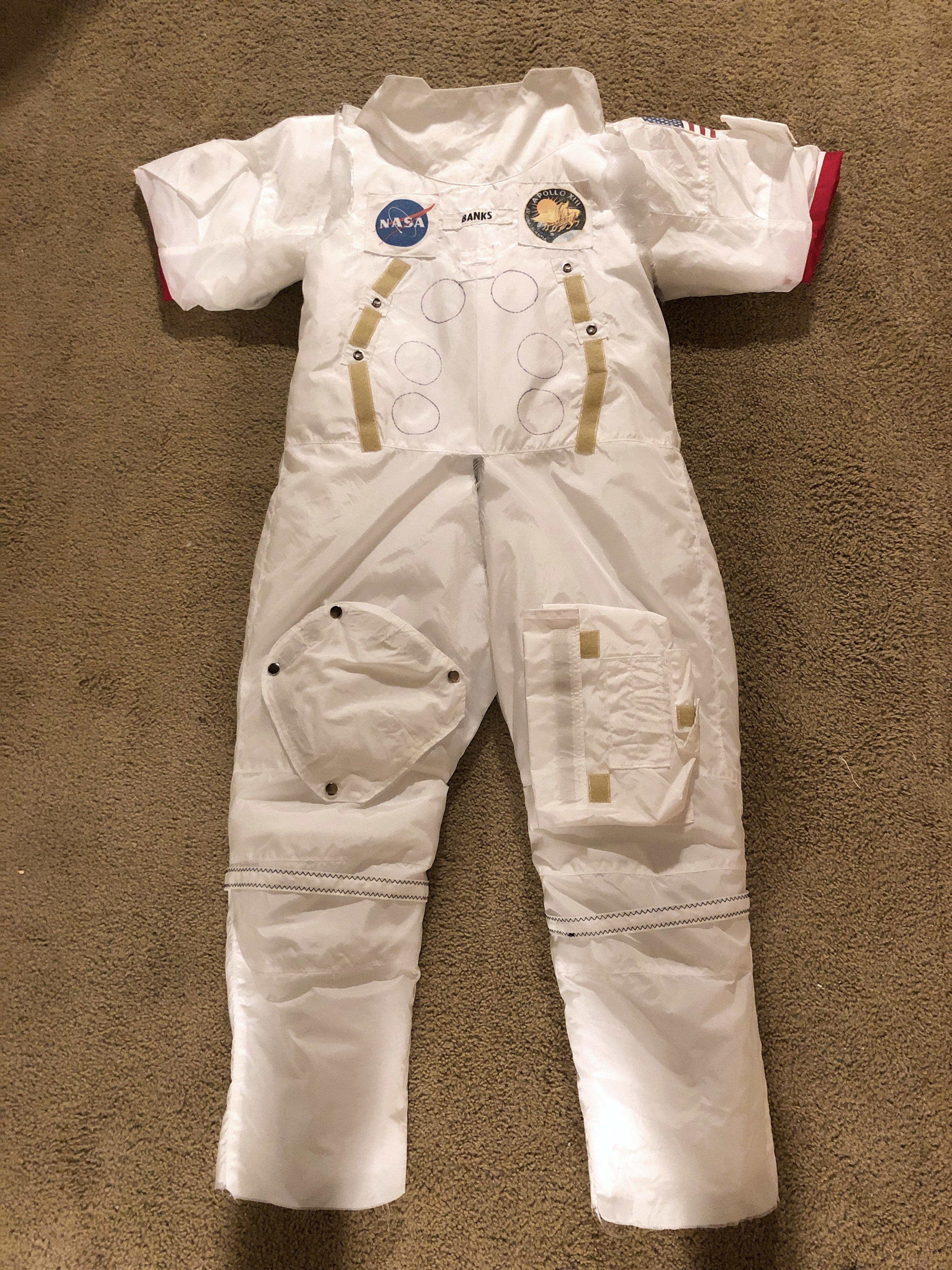

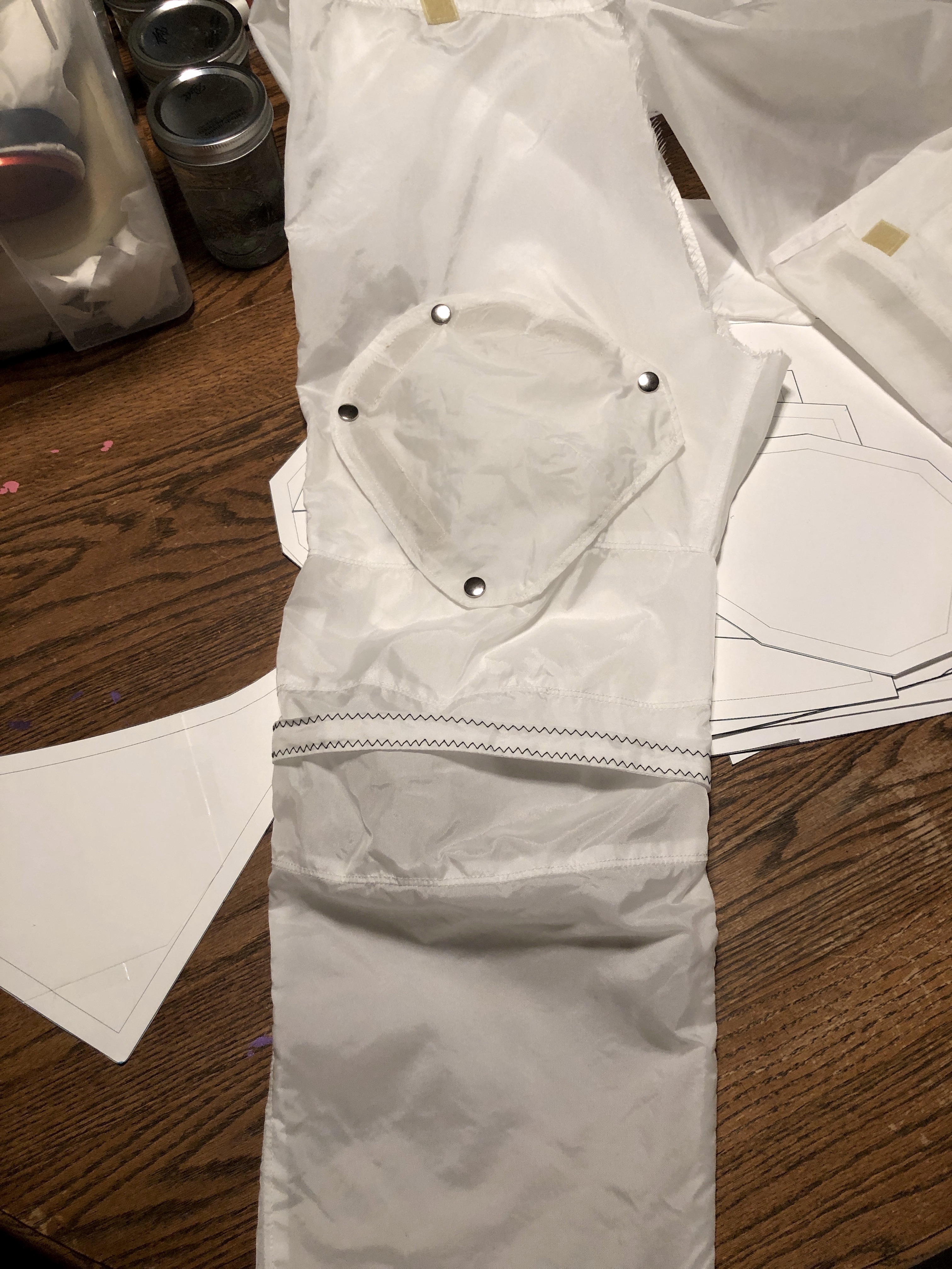

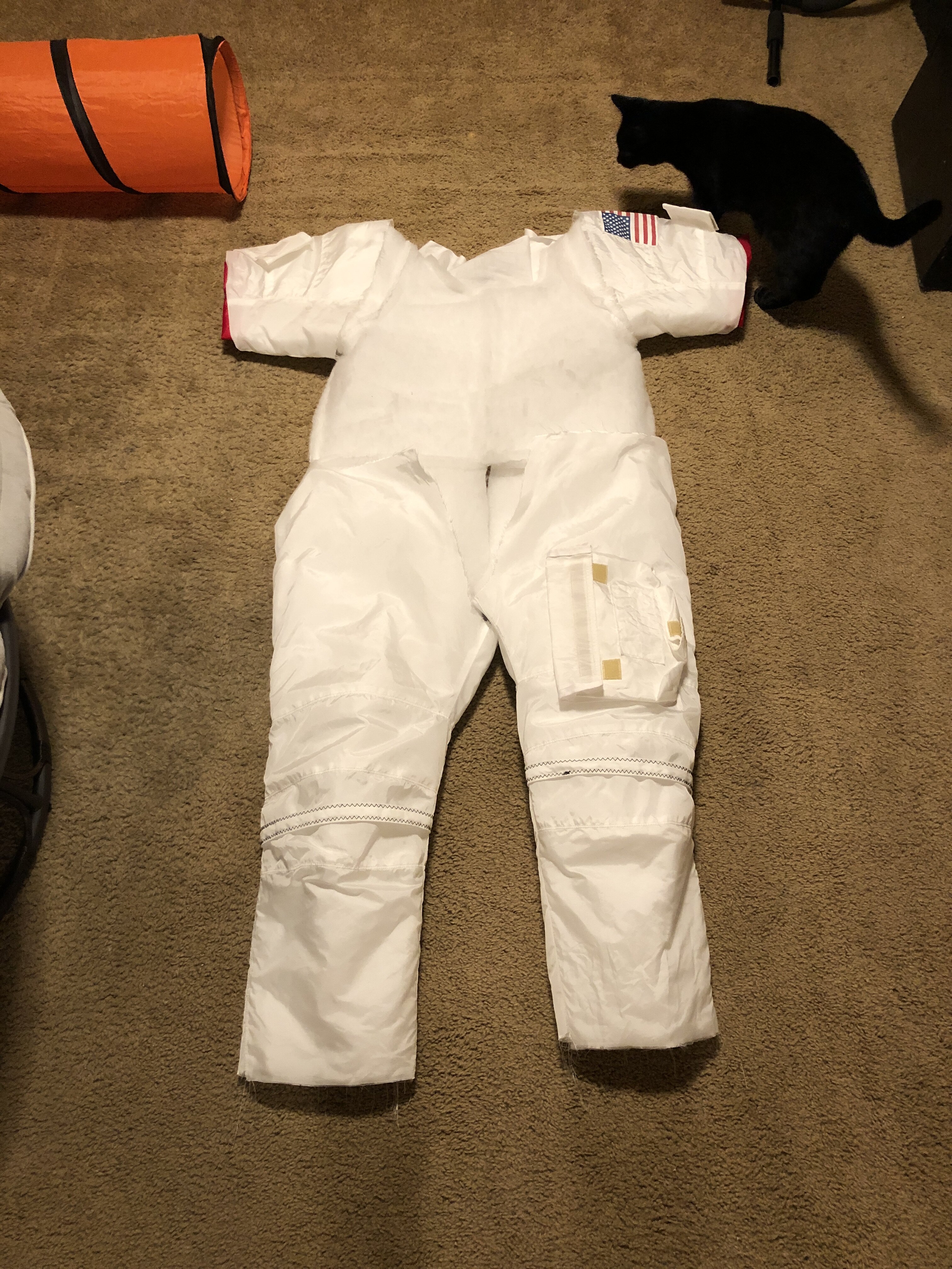

More progress on the legs!
I got the leg pocket attached and the leg loops sewn and attached. And I decided to slip then onto the padding layer to see how they were looking.
(and some cat tax, courtesy of Frodo)

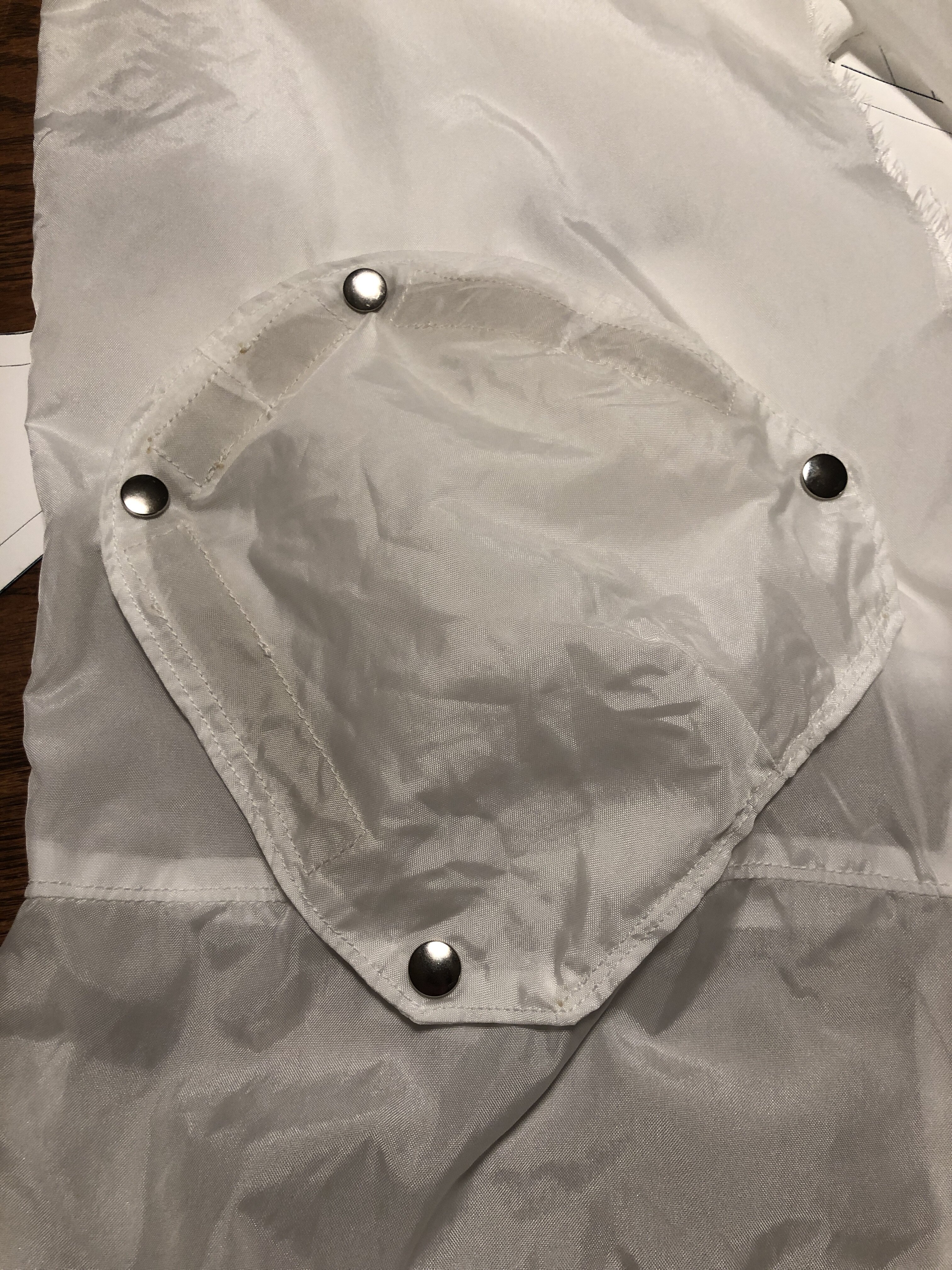

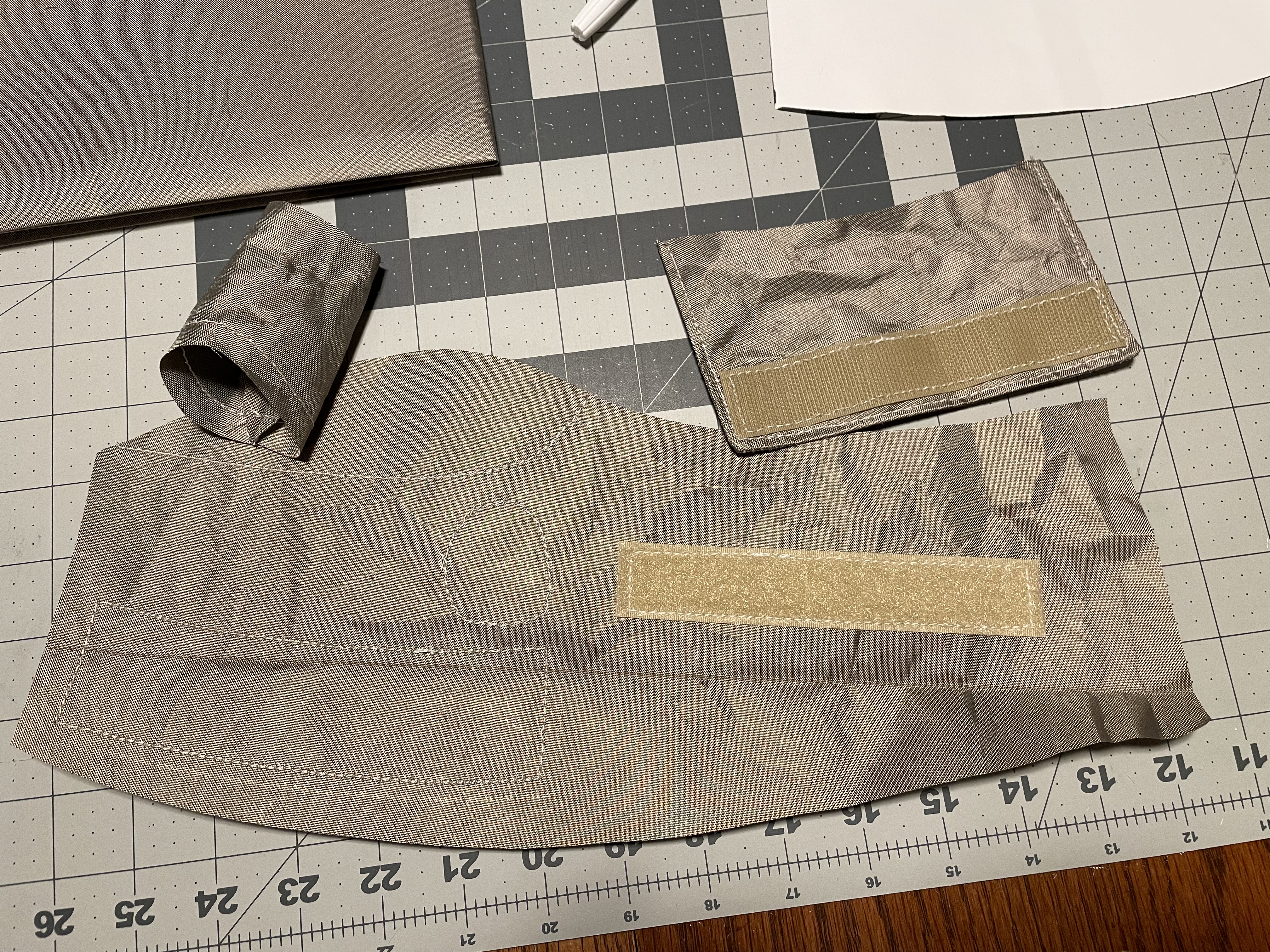

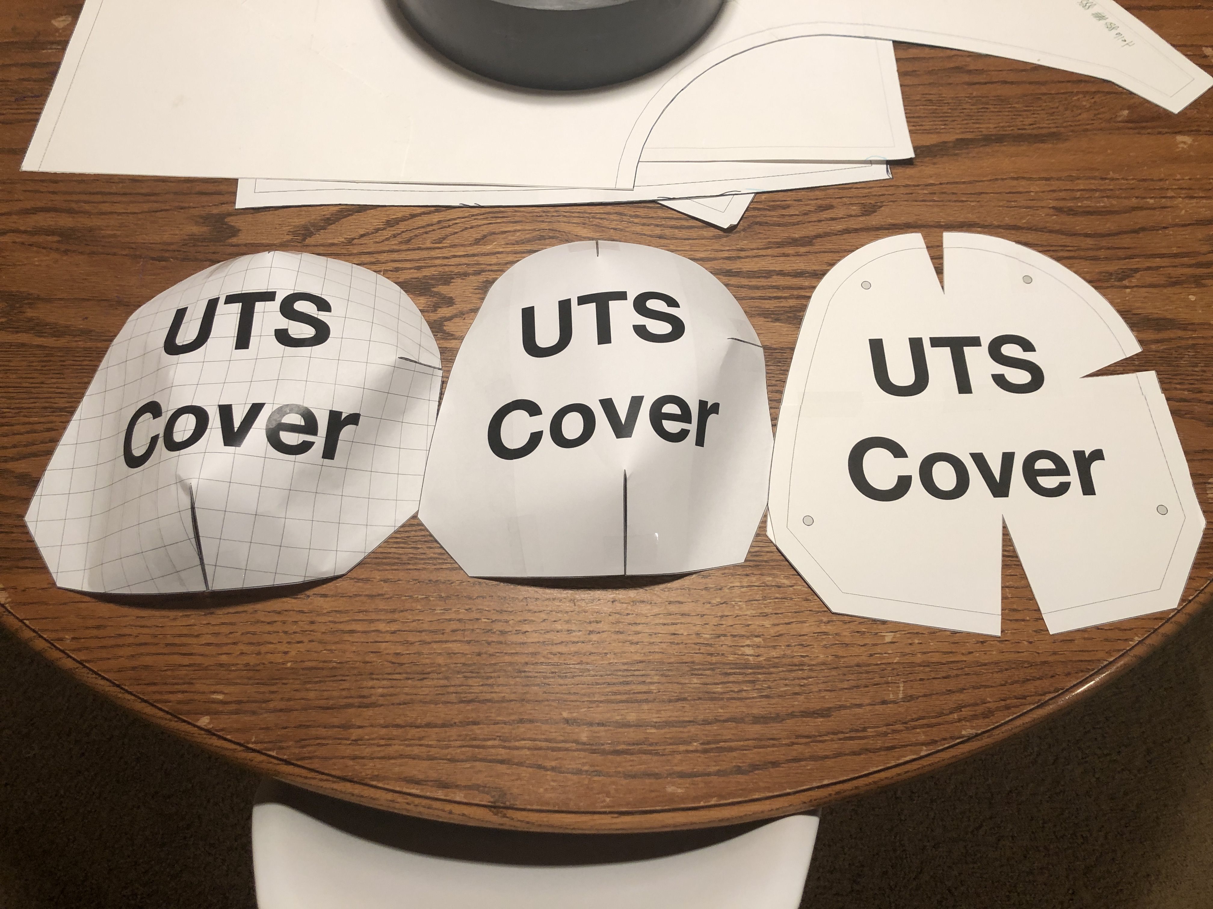

After a few tests with some paper, I think I have a good pattern made up for the UTS cover.
And I got it sewn together, attached snaps and velcro, and attached it to the leg (note to self: sewn velcro on before attaching snaps; much easier.)
View attachment 1302045View attachment 1302046

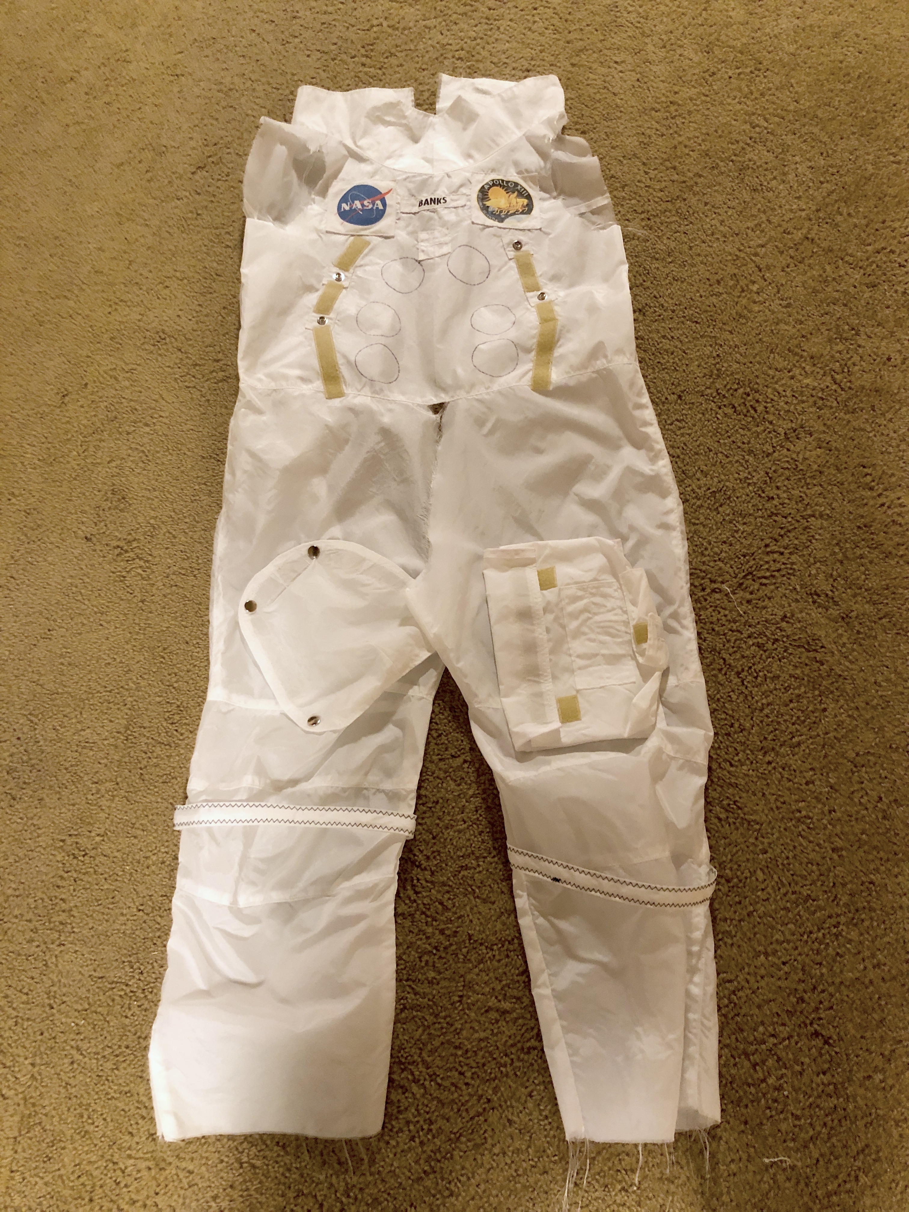

And then I was finally able to attach the legs to the torso! This feels like a big moment.
I couldn’t wait and I slipped it all over the padding layer, so I could try the whole thing on.
I think it’s looking great and I can’t wait to finally have the two layers attached.
But, I need to wait until I get the front buckle and buckle cover attached before I can do that.
I don’t have a 3D printer yet, so I ended up ordering a front buckle from kenlandrum on Shapeways; that way I can make some progress in the meantime.
I’ll hopefully get the buckle cover and zipper cover sewn up in the next couple days.
