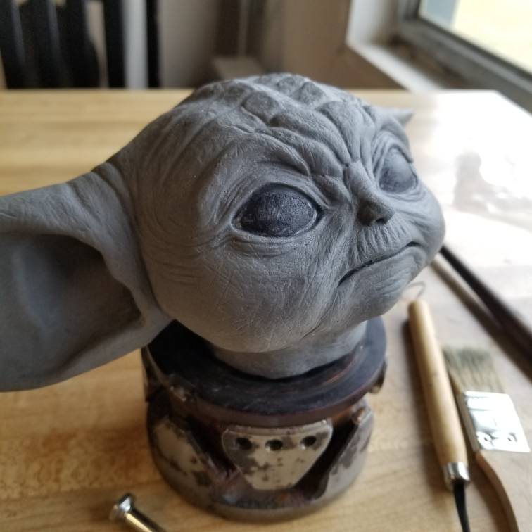

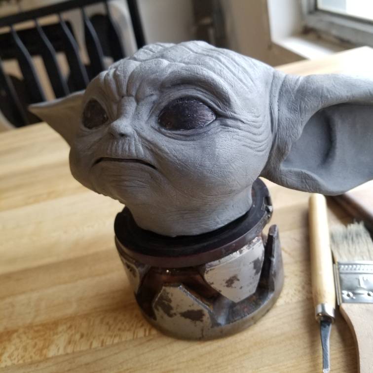

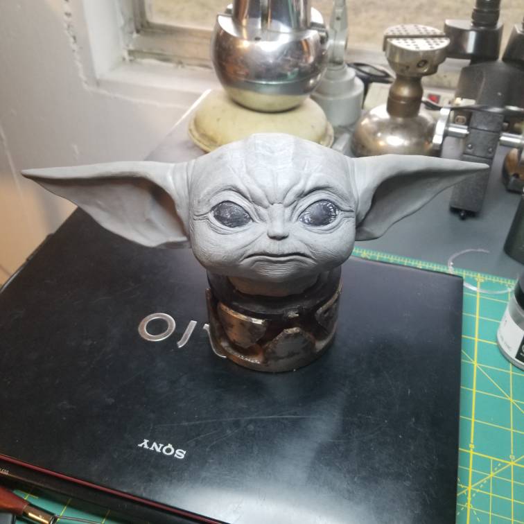

Been working on a sculpture of Grogu from the Mandalorian. Trying to get as close as I can to screen accurate (with hands and feet too) and make a mold of him.
I am debating on what final material would be best for the final casting: resin, prosthetic silicone, latex? Would like to hear thoughts from some people with more experience. Let me know what you think!

While I like your sculpt a lot, I feel that it`s an old version of the character. That`s fine if you theorize that Grogu will never ``grow`` in height, but will get old like Yoda for example.;) (y)
