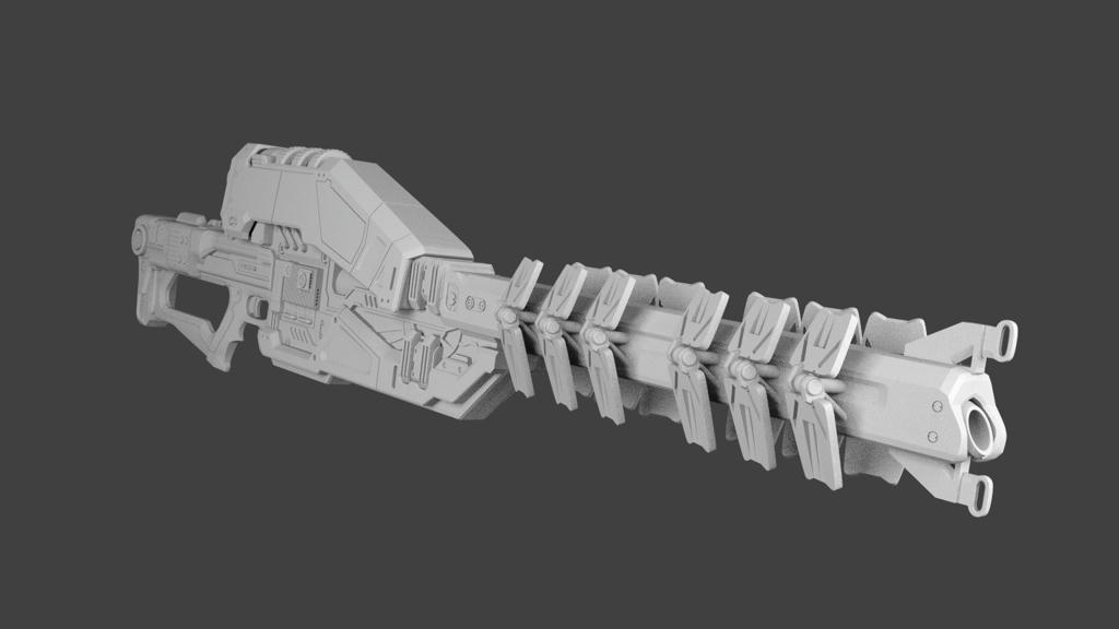

Definitely not what I expected, but OK it does look pretty cool, with a District 9 feel. I'm using Bungie's original concept images for reference, and would expect the final printed weapon to be about 4 feet long. Enough jibberjabber, here's progress so far:

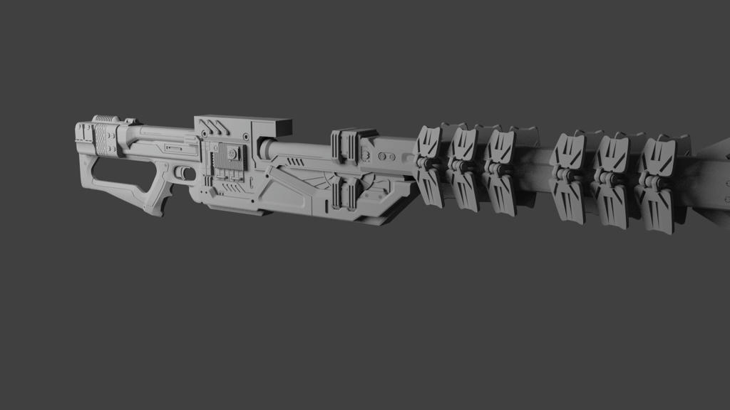

Barrel section, with movable flaps and full barrel:
Work on the main body. A lot of little details in the concept art that I don't think ever even are visible in the game, but whatever I think it looks cool:
A lot of work to go, but it's moving a lot faster than I expected. As soon as I figure out what I'll do with this when I'm done, I'll let everybody know here. Thanks for looking!

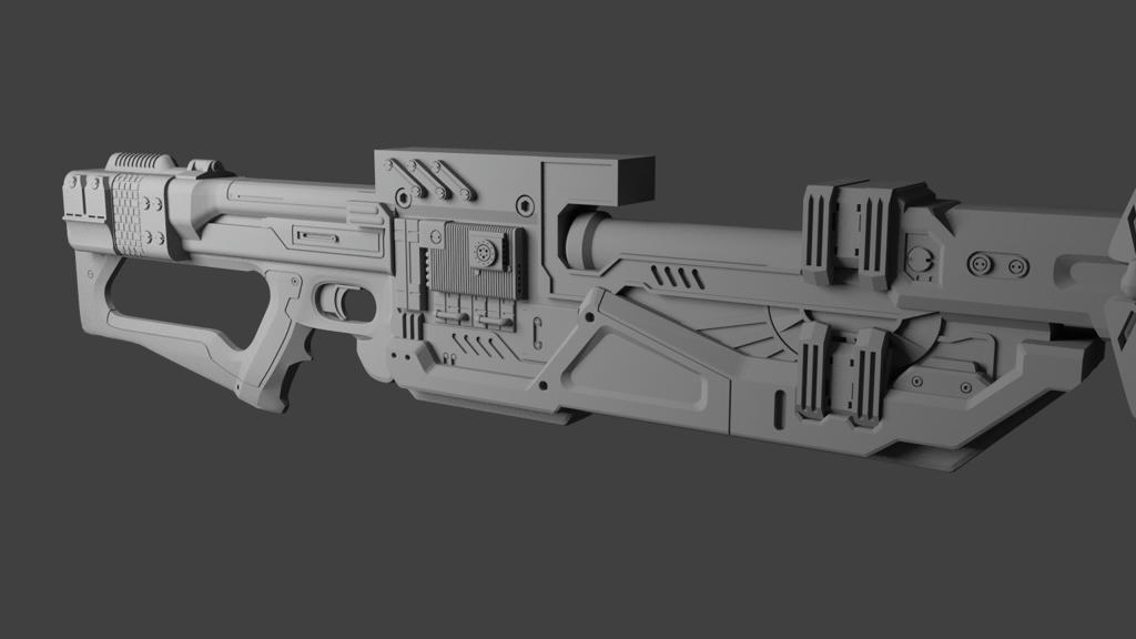

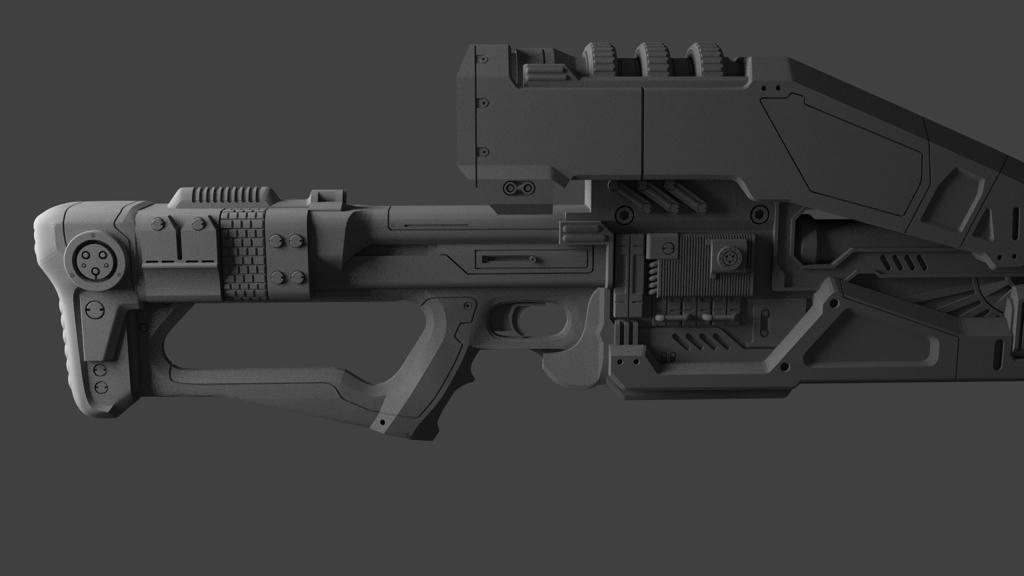

Getting there. :) Onto the rear assemblies, starting with the grip and trigger mechanism. Trigger, safety, and fire selectors will be actuating, and I'm modeling in channels and a control box in the upper bulkhead for electronics. About 1/2 done:

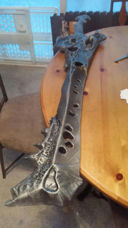

Yeah I know. :) But I've got a few cheats too. When I modeled out the Crota sword (that beast is 4 feet long), I added pipe channels and oriented the print parts so they could be skewered together onto a PVC pipe core. Stuff like that cuts down the print time by a bit, and also helps to align parts during assembly. Also, the guy I work with just got the new printer in, and it can run 16x18x16.... INCHES. Gotta love that.

Yup, Crota was fun, just crazy organic bone/stone/whatever it is:

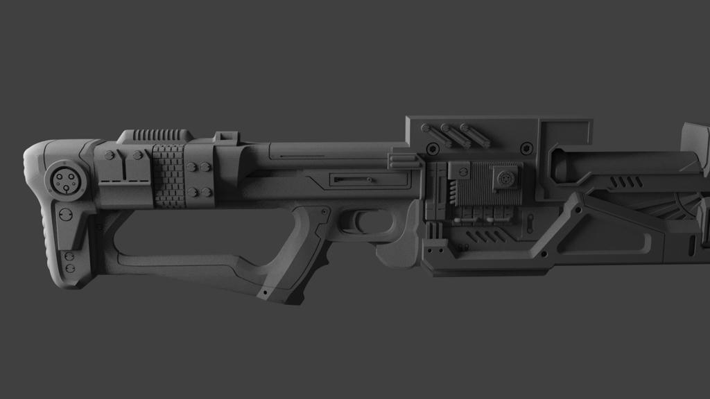

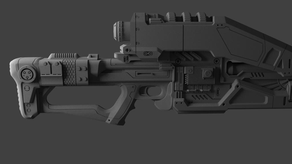

Onward and upward! Upper shroud and scope fore section completed... Just have the aft scope eyepiece and metering to do:

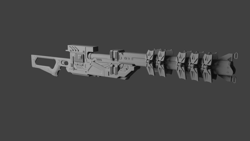

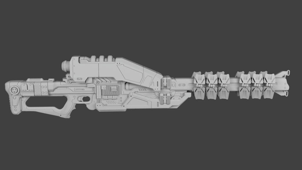

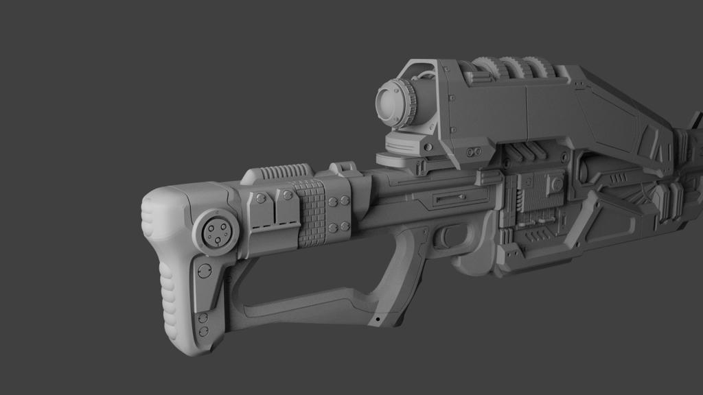

Speaking of anyways, DONE. Well, done with the modeling and the geometries for 3d printing, still gotta work out the individual print sections but that's cake. Sorry for poor light rendering, but I ground out the last of it this evening and didn't want to be bothered with hi-def renders just yet. :)
Thanks for looking! I'll get my plans for these file sorted out shortly, and hopefully have a print on the way in a bit. :thumbsup

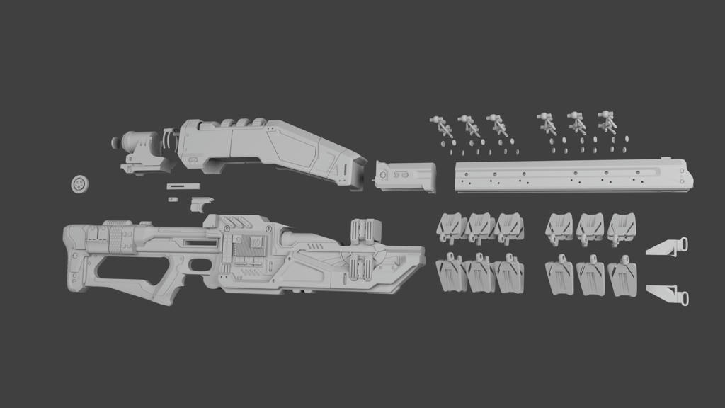

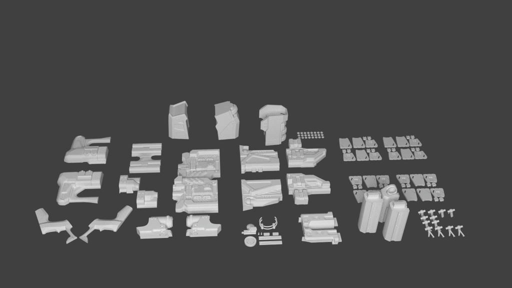

If you don't mind me asking, why are you printing all the 'fins' rather than casting them?
Now that, sir, is an excellent question. I do eventually plan on offering this up to one of the free online 3d print archives, so this configuration lets someone who has nothing but a printer and a few pounds of filament to get the rifle completed. If I was looking to sell this beast, I'd definitely just be printing one of all the duplicate parts and then cast from there. Incidentally, that's also why the components above are all cut within the 7X7X7 parameters; just making sure that down the road most anybody should be able to print the parts.
