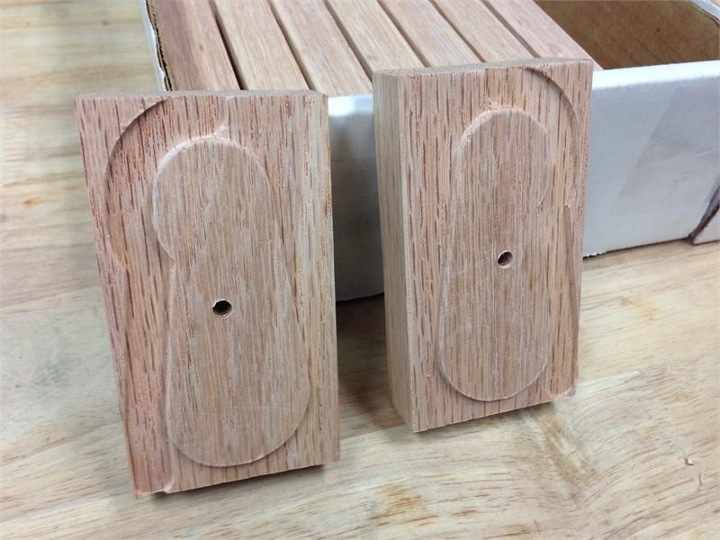

Dave will be working on the wood grips for the Mauser after he finishes the Capt America belt buckle this week.
Will post progress. This is the inside so far...

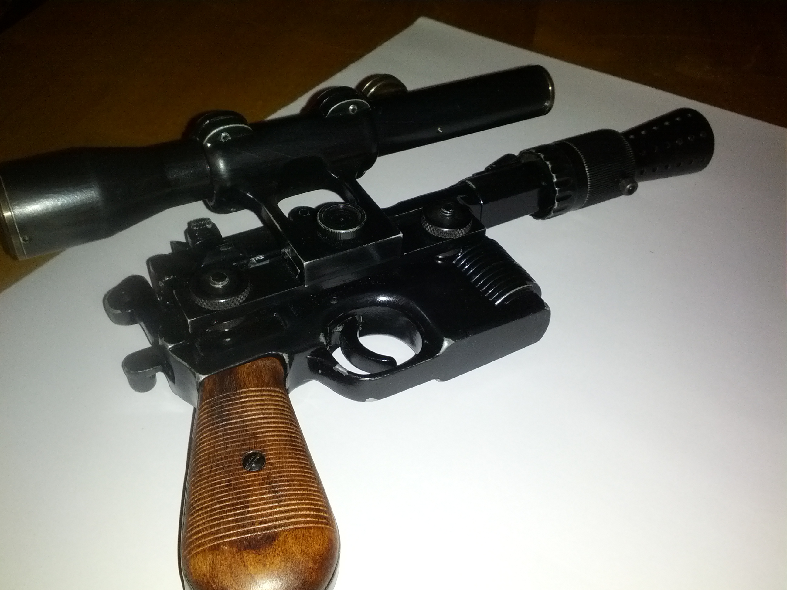

Hey everyone - I am finishing my ANH blaster and I have a really quick question:
How to work out the issue of getting the screws through the steel scope to hold in the brass end pieces (so it will be locked in place)?
I was thinking of making a very small drill hole in the brass end pieces and then use the screws.
Is there a better or different way of doing this?
Also, thank you to Dave, Pat, and Carson for this awesome kit! I love how mine has turned out. This was my first prop build and I had a lot of fun working on it. :D
That is they way most did it I think.
...turn the scope rings so the slots face the way you like.
screw in the tiny screws so they touch the brass ring and to mark the brass location or use a thin scribe or marker
you can either dimple or drill a hole as you suggested to lock the rings in place Or
trim the tiny screws so they will just put pressure on the ring to hold it in place in case you want to be able to turn the rings in the future.
Can't wait to see your blaster!
