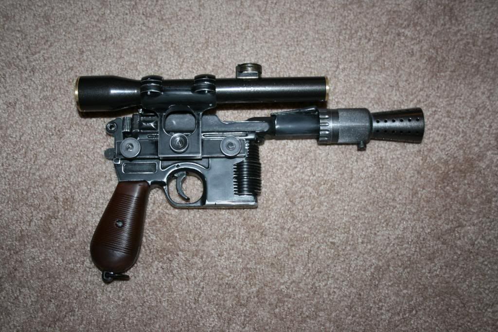

Hey All,
I accidentally cracked my rear crystal on the scope drilling a hole to receive the small screws, so Dave hooked me up with another set. Thanks so much for making this journey possible!! I used JB Weld to help secure the front grill, the barrel parts, and the flash hider to ensure there was no rattling of the parts. Here's my final DL-44 build up with weathering:
Started with the Denix:
Scraped off the paint, sanded off the Denix logo, and drilled/tapped holes
With the mount attached:
Now assembled and painted:
The mystery disk side:
Top view:
I didn't go for screen accurate mods to the Denix or the blaster weathering, but I'm very happy with the final product.
-JD
Good work, but if I may suggest a couple tweaks:
Move your scope BACK some. There should only be about a 1-1.5mm gap from the windage knob to the first clamp/ring.
Second, you may want to file your barrel down a little and move the bull barrel closer to the body of the gun.

It's sure a cool thing to hold isn't it?
Thanks scottjua! Coming from you, that means A LOT. I've admired your builds for some time. Good tips! I'll tweak her a bit. It is ridiculously awesome to hold!!! I brought her into work and a local gun store... Everyone freaks about about Han Solo's gun...they love it!
