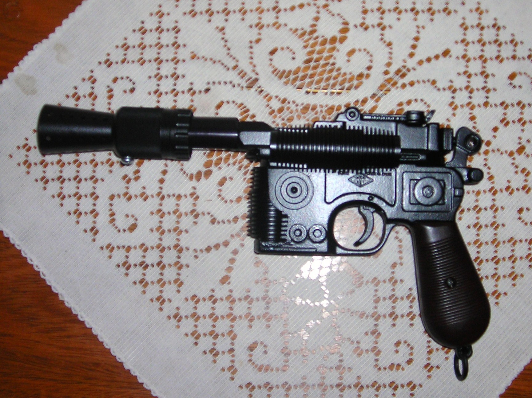

This build looks great! Good job! I was wondering if you could point me in the direction of where you got your barrel? Did you machine it yourself or did you purchase it?
This build look great! Quick question, where'd you get your barrel and antenna? Did you machine it or purchase it? I'm looking for some for my DL-44. Thanks!
