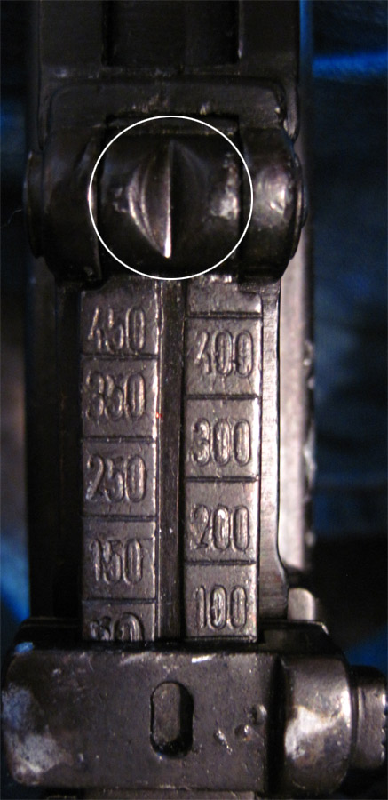

The main reason I hate Denix. The sight sphincter. :lol
Re: ANH Hero DL-44 Discussion - Three ANH Greeblies FOUND, Update in 1st Post
I made mine look a bit better by squaring off that V notch. not perfect but better. You can also eliminate it if you give up the movement of the sight by just filing it flat and filling the pin slot. Put fake pins in the frame. Wont move but will look better.
