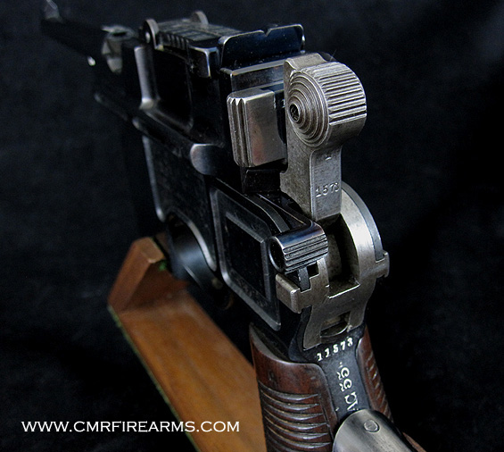

Roughly put, the "flattop" is the prewar/early war small-ring hammer. The "camel hump" got added about when it was chambered for the 9mm parabellum round (the "Red 9") and stayed on with the wartime commercial and M712 versions. I can't remember offhand which is on the gun used for Han's blaster and I don't feel like looking at the moment. *lol*

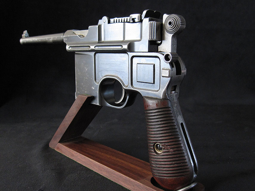

Don't forget the extremely early (and extremely rare) "conehammer" variant, my personal favorite of the variations:

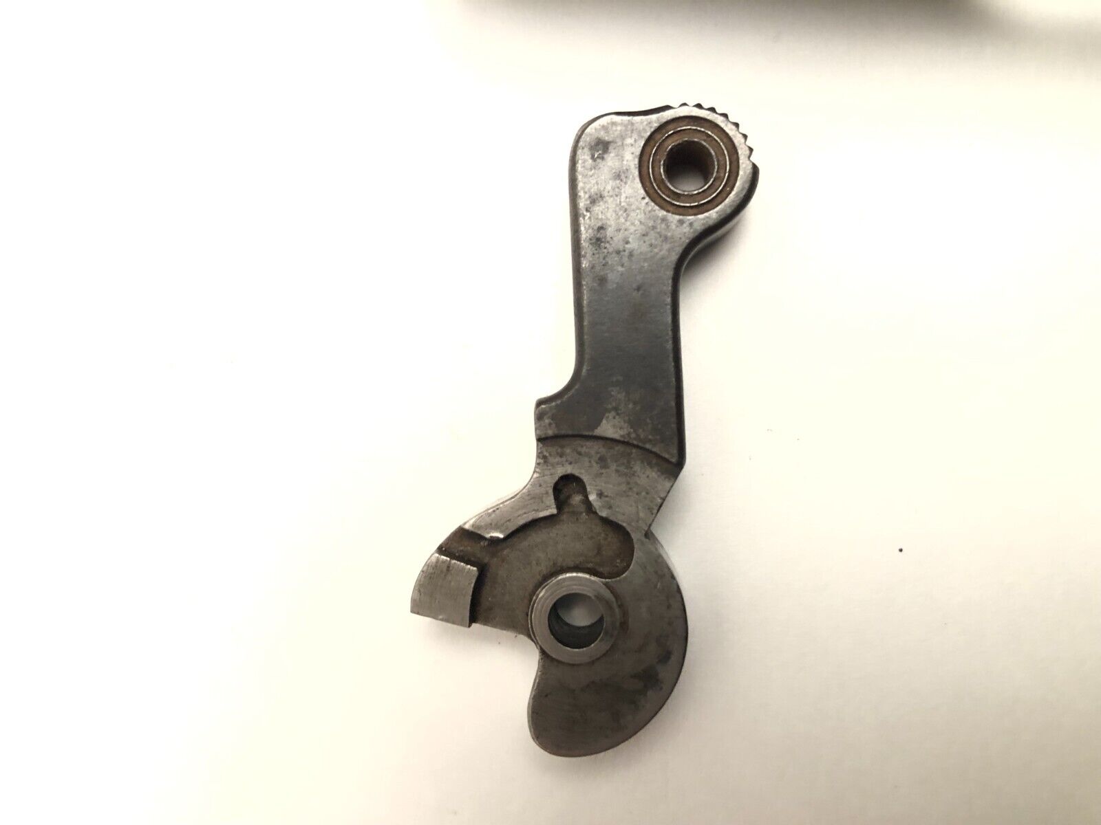

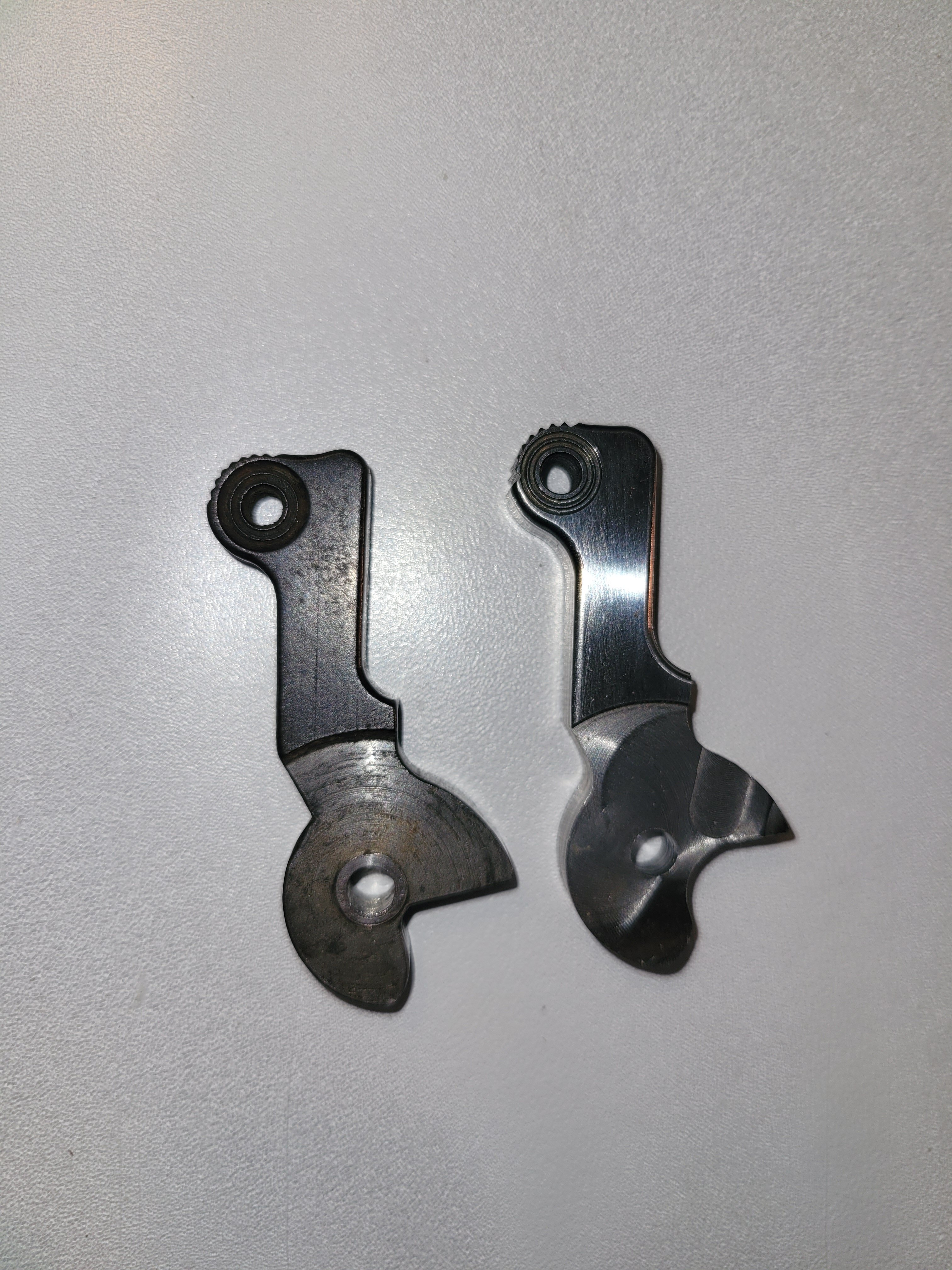

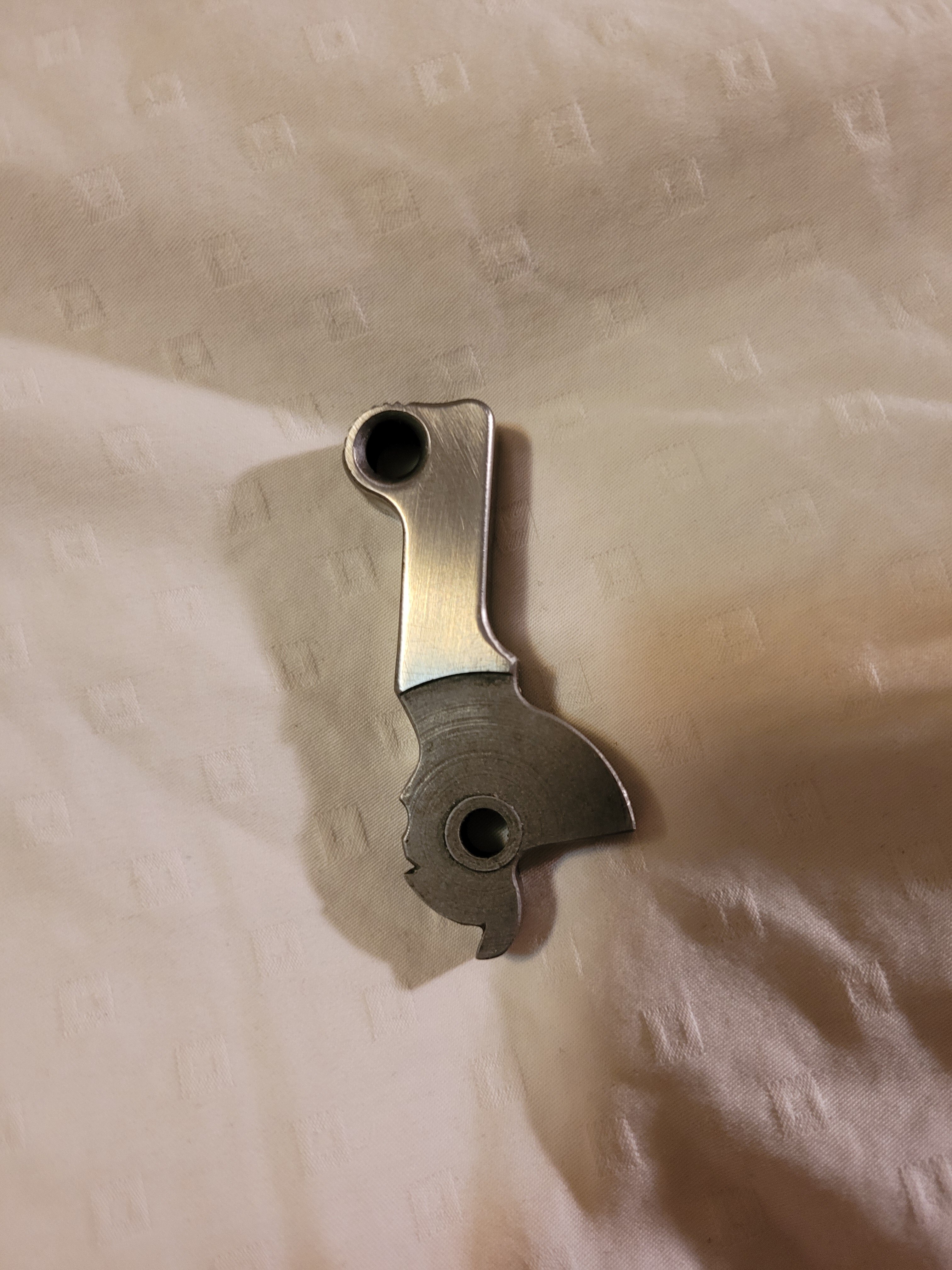

Btw, is anyone here intimately familiar with the different hammer variations of the Mauser C96? I recently purchased a vintage hammer online that supposedly should match the style of the Hero's (with the intention of cramming it into one of Chris' steel C96s), but in person the cut of the hammer is noticeably different.
Both the top "hump" of the hammer and the circular grooves are noticeably larger than on Chris' reproduction, and while the seller has agreed to try and help me find the accurate hammer via a return/swap I'd just like to hear everyone else's 2 cents.
(Left real, right repro)
Chris' replica is the correct style so you're looking to hunt one of those down. I would also try and find one that has the "NS" New Safety logo if you can.

Which I suppose loops back around to some of the subject matter of the thread. I am not averse to using replica components if they are accurate to the originals, in hardness as well as shape. Would the stuff Chris makes work swapped into an actual firing Mauser?
Likely not as his stuff isn't case-hardened like actual gun steel is (and I think altered to fit mechanics of his replica). Although, it is possible, from what I've read, to case harden steel at home. Case hardening doesn't require much more than a good consistent high-temp heat source, oil, and a toaster oven. From what I've read, you get the steel to a glowing red color, then dunk it in the oil, and after it's cooled, popped into a small oven to bake in ~300F for a few hours until the surface reaches a yellow color, which is then left to cool on its own.

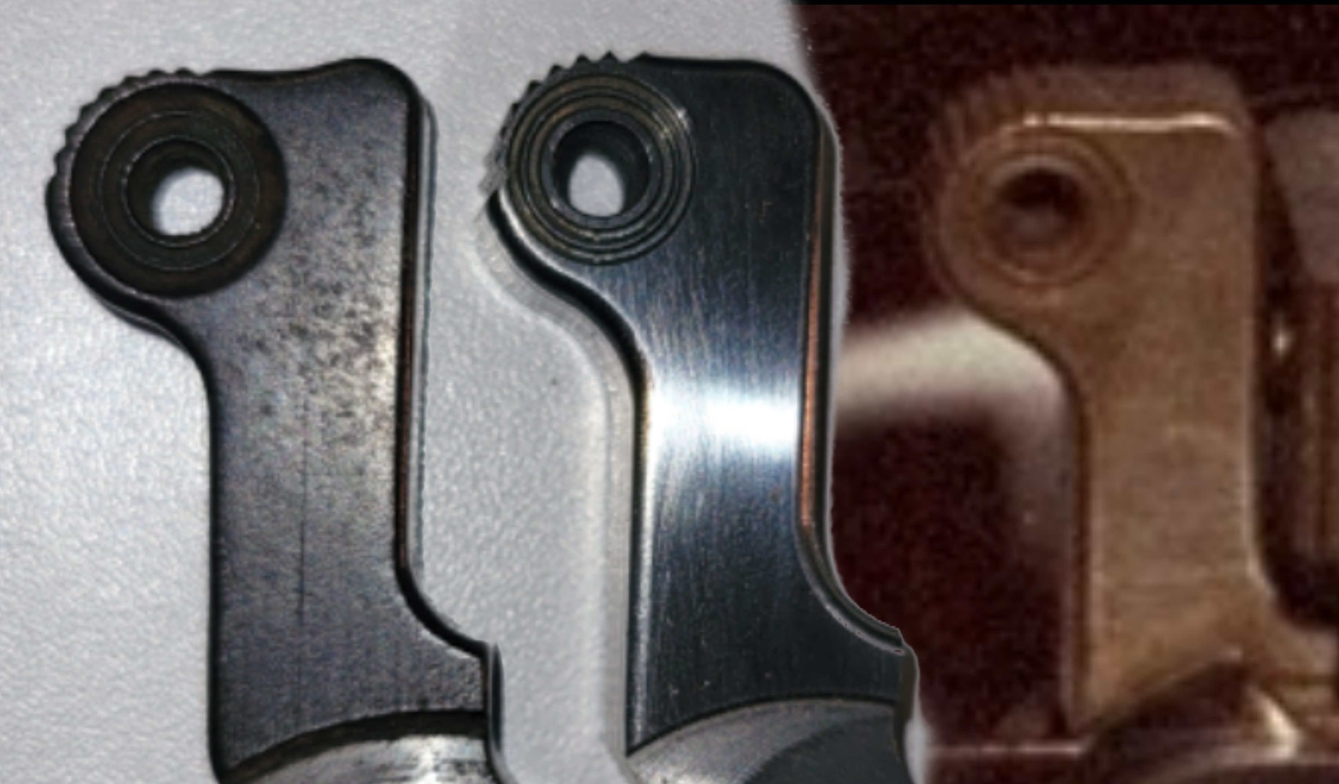

I’d go with the real one you bought simply because it’s.. well real. For what it’s worth I think it’s always best to look at the actual film prop itself and head in what ever direction you think to be more accurate..
I have actually softened and quenched several parts of Chris' steel C96 myself, as I wanted to get the steel.of the upper soft enough for me to hack off the sleeve barrel and tap the upper to receive one of Todd's threaded bull barrels. So tempering them back isn't too difficult at all.

And I probably will go with a real hammer, just likely not this one. The seller I picked it up from has a few more in stock and has agreed to look to see if he has any of the flat top variants in his inventory, which I am hopeful of. I'd just rather not have to grind off the "camel hump" of the real hammer unless necessary, as permanently modifying real parts is a bit more daunting to me lol

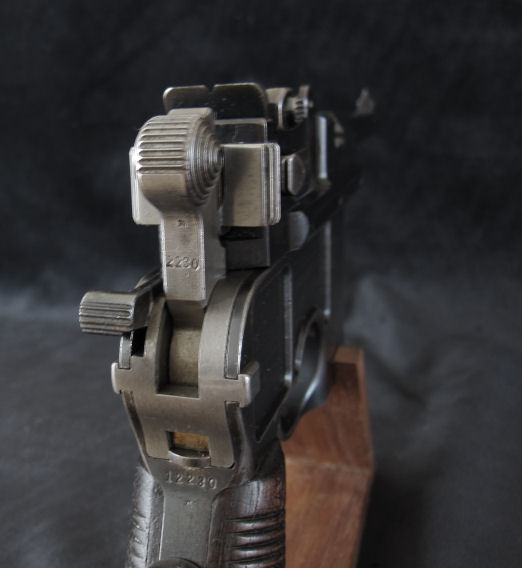

Whelp, so much for an easy exchange :(
I'm not sure if the seller was mistaken (even though I was VERY clear with the model I wanted), but the flat-top variation I thought I would be sent after returning that first hammer turned out to be an unmarked type 3 variant instead. At this point I'll probably just ask for my money back outright.
(What I thought he was sending me)
