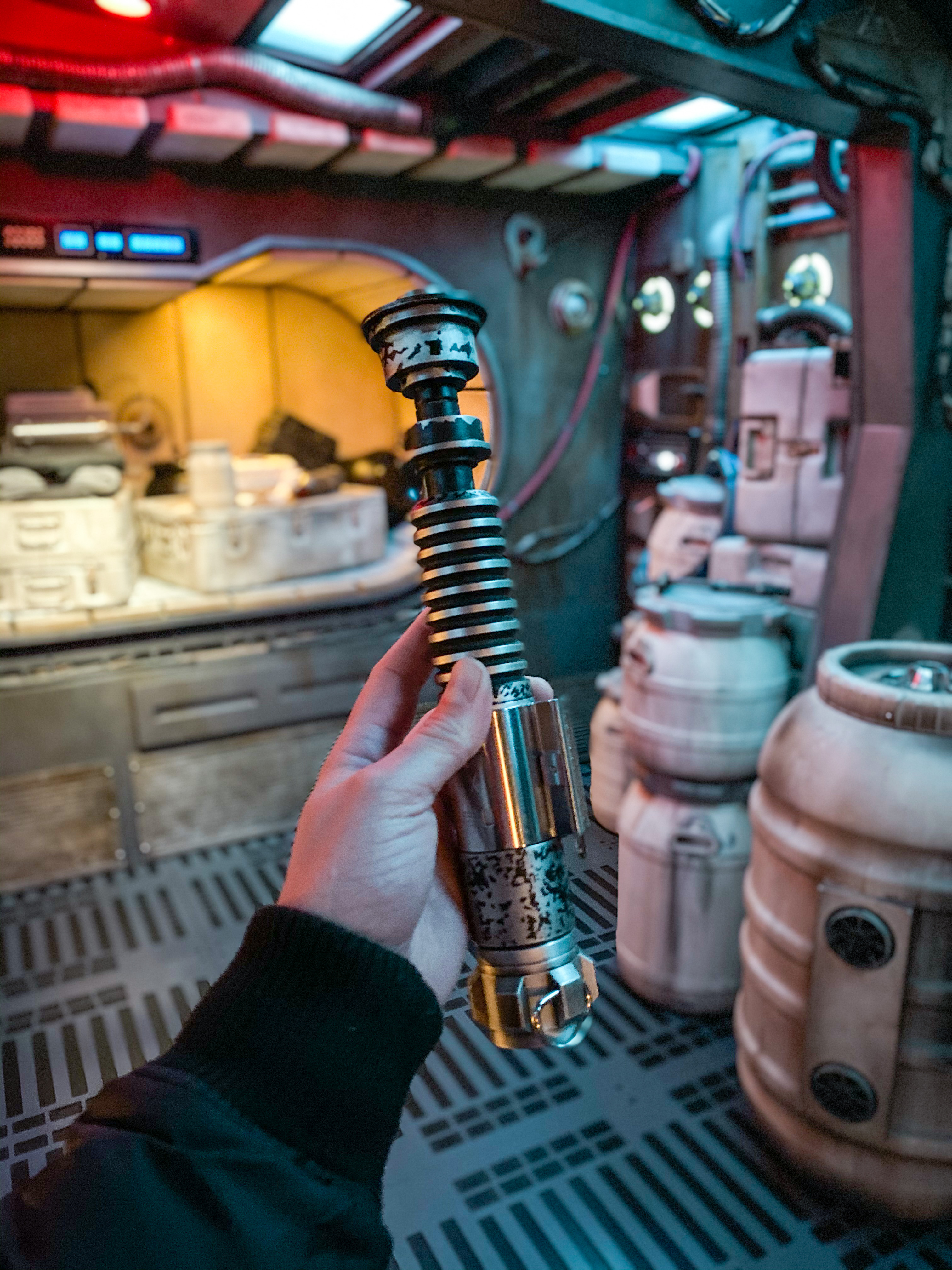

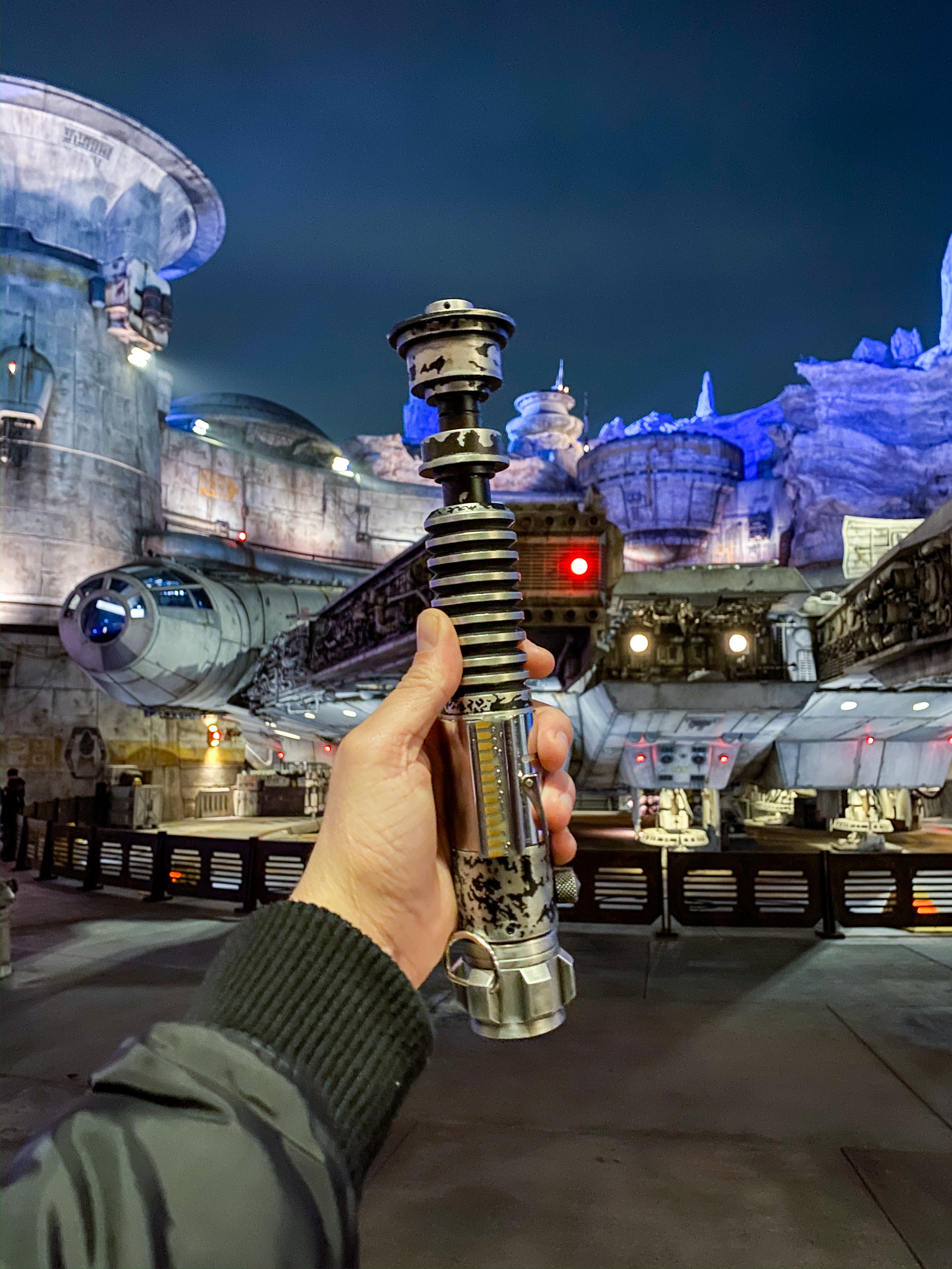

Here’s my progress! Used the Oxi Clean method! I love the look of it!

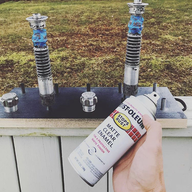

Halliwax when you clear coat, do you do the entire hilt put together or do you do each individual piece including the inside?
I tape off the windvane section and coat the entire thing 3 times
Very light coats.. to the point where when I’m done with the coat it doesn’t look wet
Pictures have filters so it’s not showing the V2’s true color...
Halliwax Any reason you don't clear coat the windvane as well?
Because the windvane needs the burned gloss finish to mimic the profile picture exactly
Coating the windvane with clear matte will not get it to look like Brandon’s profile picture
I go over this in the video a few times, not to clear the windvane
All your hard work is negated if you do
