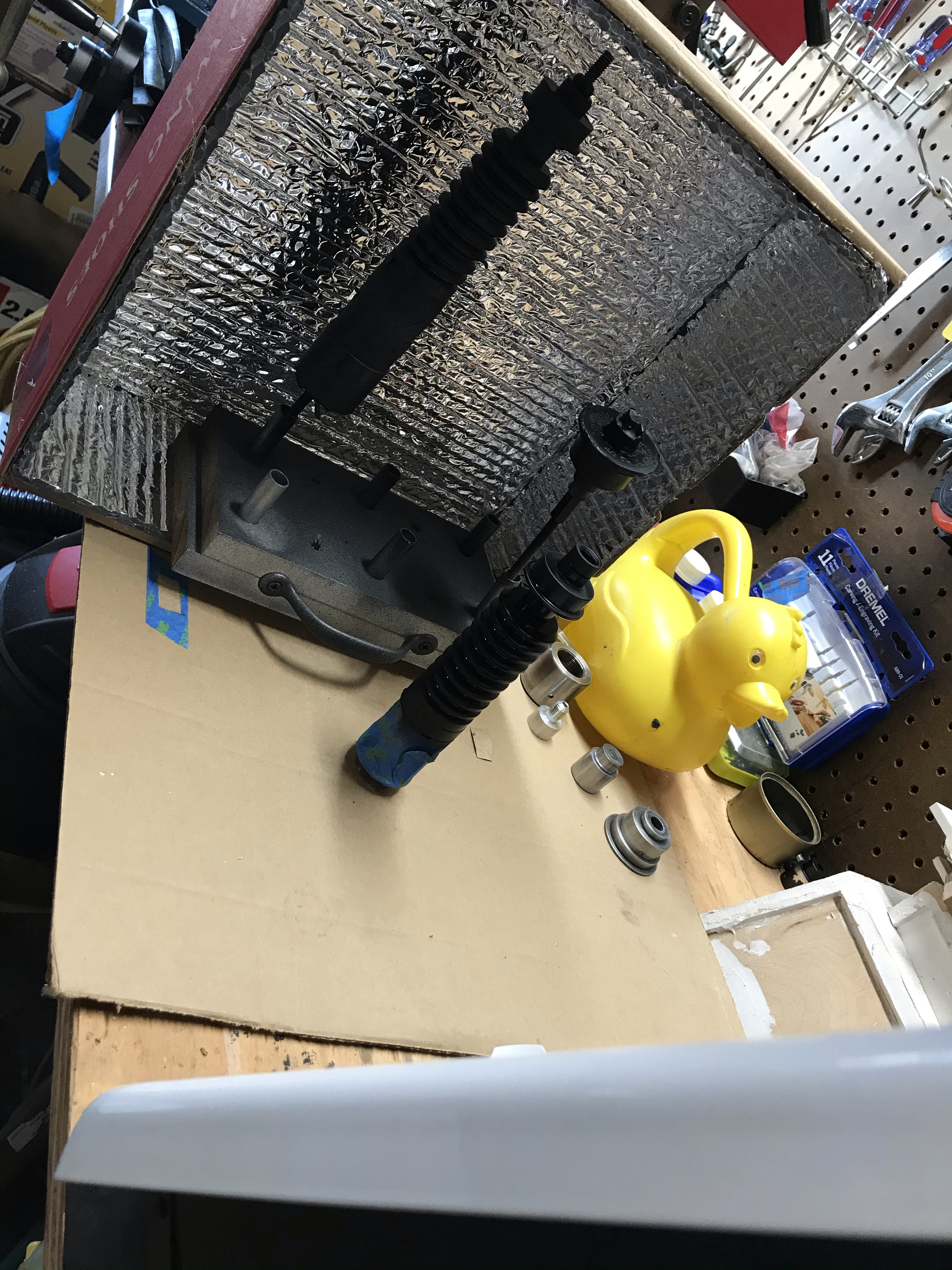

I built some heat boxes out of some cardboard boxes and radiant floor thermo shield.
Got my electric heater going, and it worked flawlessly!!
Don’t know if it will work in 20degree days, but it kicked @$$ today!!

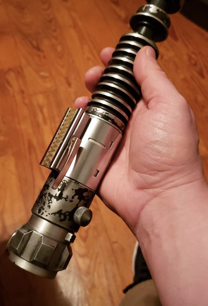

I aged and weathered my buddies tonight
