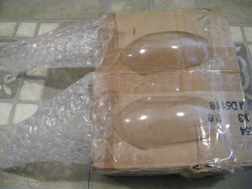

Prior to receiving vectorzero's offer of the canopy, Metallboy sent me a PM offering one of his that he scratch built. I want to thank these two greatly for helping me with this. I had agreed to his generous offer and he ended up sending me two of them. One I used to practice on and one for the build. The clear plastic has some little imperfections but I think it looks great. Why should the canopy on the Slave 1 be so flawless and clean while the rest of the ship is so weathered? I think the canopies that Metallboy made are very much worthy of the Slave . First are the pictures of the canopies as they arrived.

They needed a little trimming and some light sanding. I didn't have any very fine sandpaper so I used toothpaste instead which turned out to work better than I thought.

That's looking so so so good; really can't wait to see you start bay 94! By the way, what are the canopies made from/ how were they made, just out of (relevant to my build) curiosity?
Thank you Ze0ro, Haystack Hair and Katsu-san! Here’s a link to what Metallboy had posted, http://www.therpf.com/f11/amt-slave-one-wip-146130/index9.html#post2781415 I believe they are vacuformed but I don’t know the source of the plastic. They are thin but not too weak. I saw what happened to your canopy Haystack Hair and I feel your pain.:cry Looks like you made a very nice plug to vacuform or to push trough heated plastic. This was a fun challenge to do and someday I will want to work on the base. I have some updates to post on my Duel truck thread then I’m going to be busy for a couple of weeks doing something I’m very excited about. I’ll be posting that info on the other thread, hopefully tonight.
Randy the Slave 1 looks amazing! I'm honored to have helped you in the completion on this masterpiece. I see what you mean by the canopies weathered look and indeed it makes sense to have it look that way. Your next idea on the Docking Bay platform sounds great! it would be another part of movie history we would love to visualize.. As of the material for the canopies? they were made from clear sheets of model making canopies for model Jets wich i got from an old hobby store. The heat source I used to mold them was just simply a candle? This is the technique old timers used before any home made vacuforming mini tables were considered...Anyway congrats on the completion of this amazing model...
