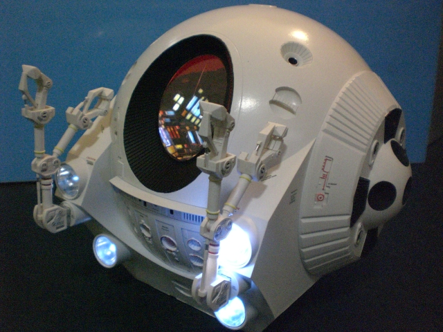

Great stuff all around. As "Mister Lazy" (my wife's name for me:lol:), I'm always devising tricks to make my life easier (yes, that's how my brain works...not my fault:p). So, when I built this EVA Pod and knowing that I didn't want to buy the extra lighting after-market kit, I came up with a quick-&-dirty solution: applying aluminum tape at the back of the panel and using the tip of a file to break the tape on top of the buttons (as you know, the buttons at the back are just slits). Voilà, 5 minutes of work by entire panels and the results is, according to me, not too bad:D;)
That is genius!

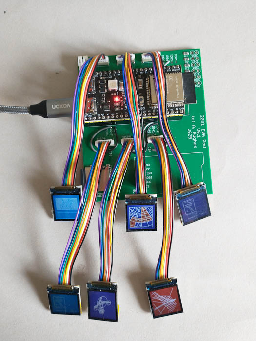

Slow progress on this due to other demands, but I've put together a prototype PCB to verify it's possible to drive all 6 displays and an SD card all over SPI simultaneously. With that confirmed, I can push on with a more tailored solution.
Looking good! Are those the 128x128 pixel 0.85" IPS LCDs? (the GC9107 driver type)
