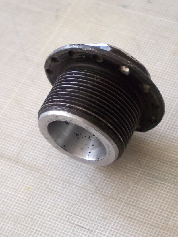

Re: Obi ANH saber. Where to place the cotter pins and 'figure 8' holes?
This was used toput the emitter on grenade section?
I didn't know about that,it's interesting.
It was suggested by Howard and that's why Russreps made two types of booster cones : A the straight and B the tapered just like the real booster-bearing screw part:
However you'd need 2 real vintage and complete booster gears to pull this of that is if you'd also like the booster-bearing inside the clamp, alas I only have one :cry and Kurtyboy apparantly had 2 but he did receive the vintage UK cotter-pins from me :)
-Chaim
so it means holes will be visible on the back of emitter?
and..how to fix it on brass section of grenade?
or,it's just cut?
what are sources mentionning this part was used?
it could work,because bolt diameter is close to emitter diameter...

It needs to be cut.
The emitter is fixed to the greneade with glue on the original. You can see the glue sticking out under the emitter. The bottom of the emitter is also crimped but I didn't want to damage my balance pipe.

Are there any original pic showing the glue or the cone section?
The emitter has been hammered on the inner part to secure it to the upper neck of the windvane section ... you can see the 'damage' in the picture in post #27.
