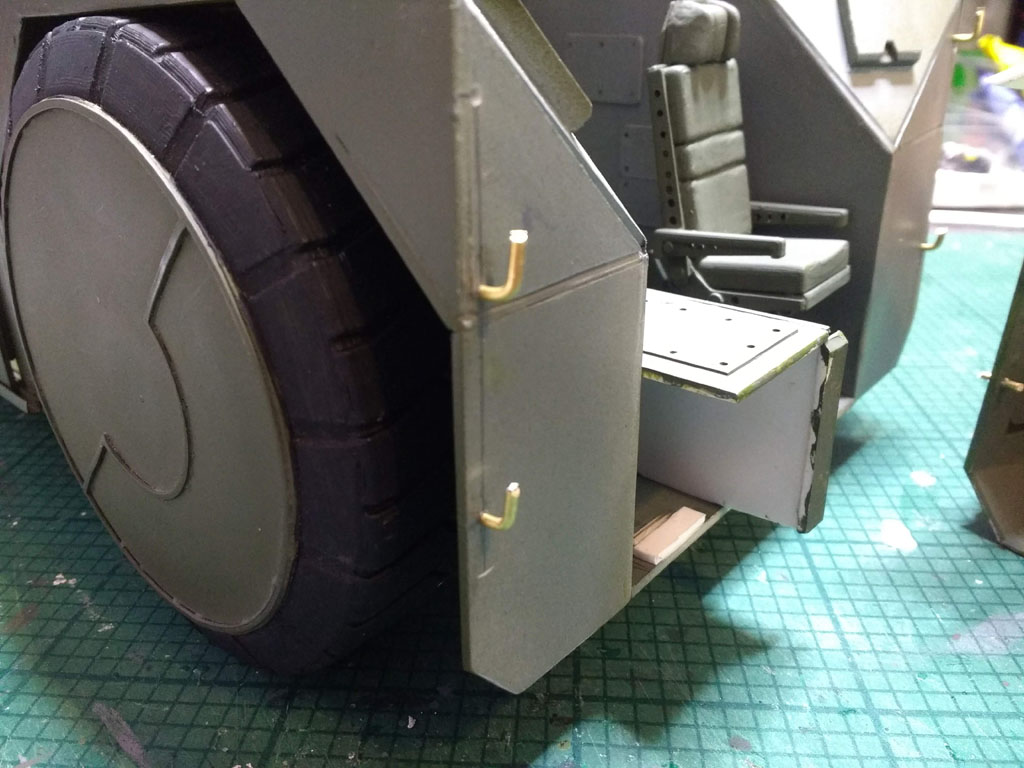

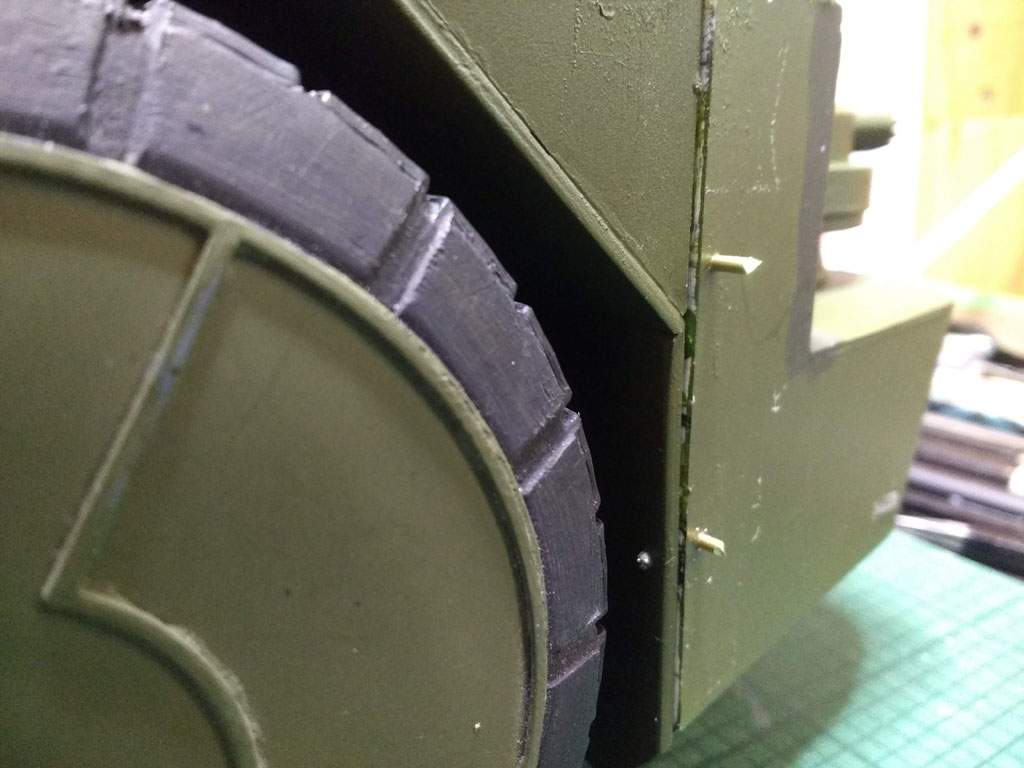

I had an issue with how I was trying to attach the front cabin. The method I was constructing just wasn't strong enough mechanically. So, I worked on an alternative using brass rod which, seems to be holding up really well.
Those two little brass pins sticking out of the side just ahead of the wheel are the key.
They extend inside and hook onto...
These hooks which will be glued into the chassis tomorrow.
The earlier method I tried relied on strips of styrene and interlocking tabs to hold the front on which just wasn't going to work.
I'll snip the pins flush on the outside and re-do those last (white) bits of roof.
