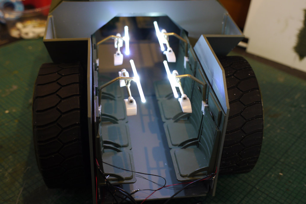

My new fibre optics and micro LED lights arrived so I could now crack on with fitting out the seat restraint lighting for the rear-bay seating area.
The tub at the left side contains all the components to build up the seat restraints. There's styrene sheet pads, brass tube, styrene brackets, brass hinge pins, fibre optic strand for the lighting - all sorts of stuff. :)
These long, hollow white styrene tubes have 2 back-to-back micro LEDs fitted in the middle and the wiring feeds through the brass tube and out the back. Dealing with that wiring (each wire is approx 0.2mm thick) is and will be a pain. I found that the only way to strip the insulation off it is to burn it off with a lighter. I'm not looking forward to soldering it - might need a microscope. LOL.

Here I'm building the hinges that let the seating restraints pivot up and down.
The tiny wires that lead from the LEDs need soldering onto more robust wiring that will connect them to the interior wiring loom later on.
These are the components for the torso pads.
There's four all done! Next step is to add the torso pads.
Done, yay! I keep a grubby old pair of green plastic tweezers which are VERY handy for handling magnets - especially the ones I'll be adding here, which are 2mm x 1mm.
In this shot you can hopefully see two magnets glued to the base of the brass upright - right against the white hinge collar.
After matching magnets are embedded into the wall between the seats, they keep the restraints in the 'up' position.
..and here they are fully down.
Of course I had to wire them up and see how it looked. :)
Not too shabby! On to painting next, then I'll add in some troops, put the roof on and we'll see how it all looks together.
