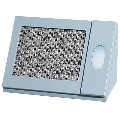

Hello, has anyone tried combining an Alexa Dot into a TOS Desktop communicator. I realise that the dot is way to big, the diameter is almost the same as the external dimensions of the communicator. I'm wondering if it is practical to cut a hole/slot in my bench top big enough to embed the Alexa Dot, sticking up as much as possible into the bottom of the desktop communicator prop, which might need to be enlarged by maybe 5%, and maybe making some kind of shield and foil (as a mirror) to direct the Dots light effect through to the white light on the side. I notice that the input name for all Alexa devices can be changed to 'Computer' and the voice is fairly convincing. Has anyone tried doing this? Any thoughts?
I've also looked at the Input model, that is used with your own speaker unit, but that just means either keeping my big PC speakers powered on all the time, or finding perhaps a small speaker unit that can be mounted under the bench. Seems like extra work to me!

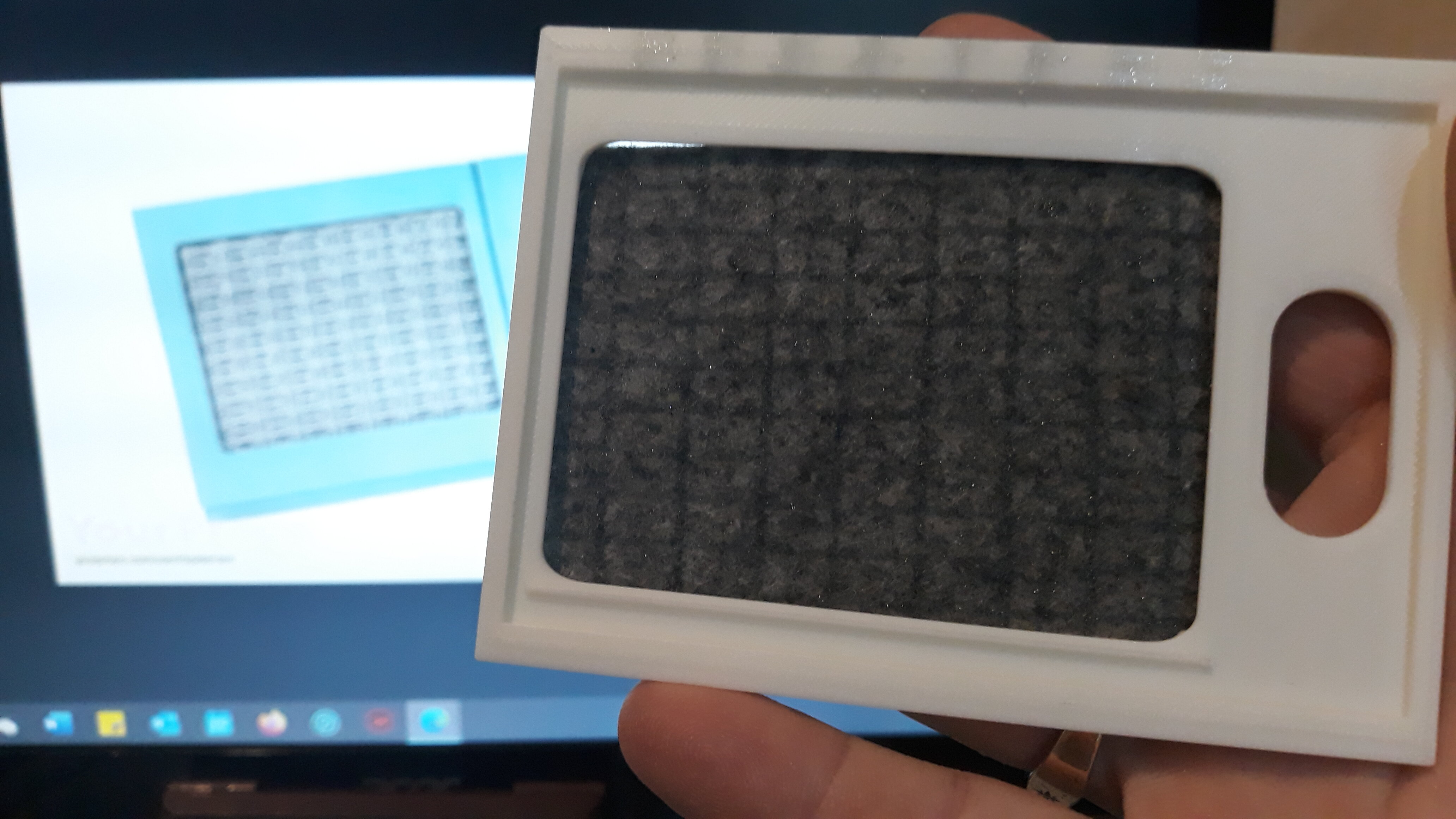

Hey guys, I've taken the plunge with this project. I've settled on a gen2 Alexa Dot, and although it doesn't fit inside I've decided to cut a hole in the main case of the intercom unit just big enough to slot the Dot in and I'm currently 3D printing that.
Here's my modified design on TinkerCad: 3D design Star Trek TOS Intercom Case | Altered for Alexa Dot 2 | Tinkercad
Here's the original design on Thingiverse: Star Trek TOS - Desk Intercom by Shipbrook

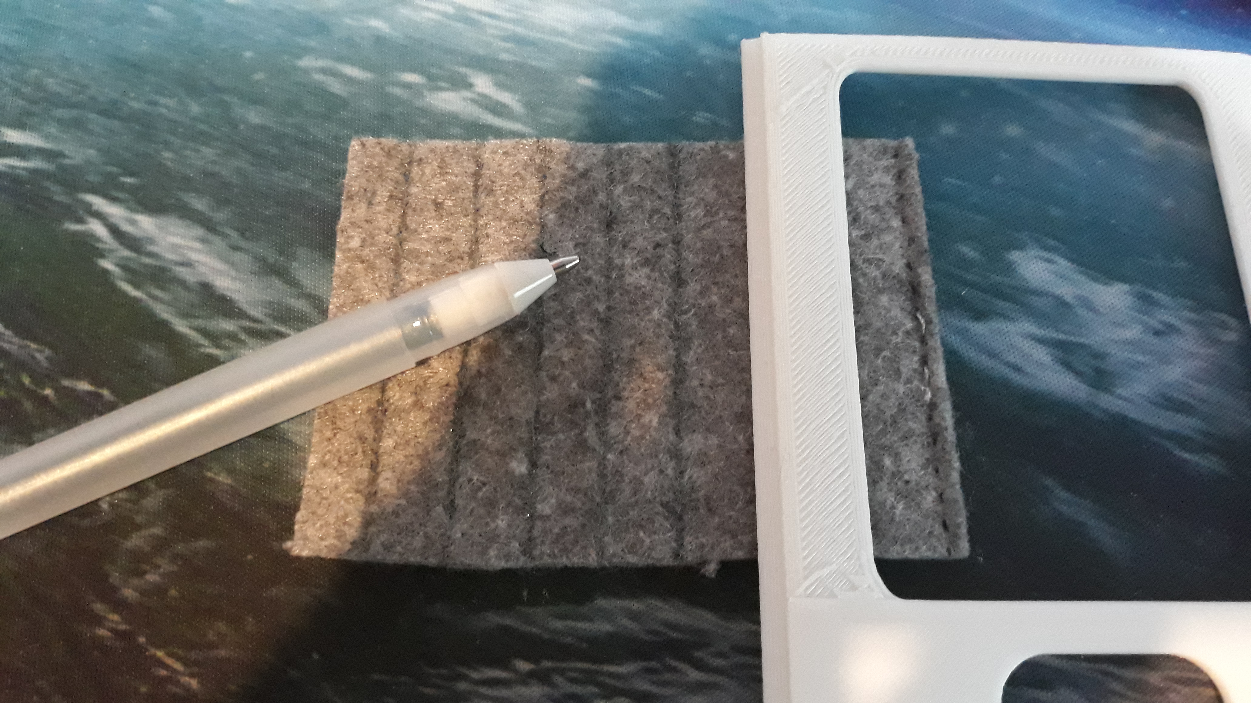

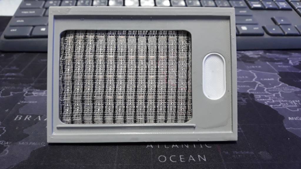

Another mod. for this project is the speaker fabric. Properly I should be using period Fender guitar amp fabric, but it's not cheap, and postage to Thailand is ridiculous at the moment, and too many things are disappearing in transit, so I've decided on an alternative until I can get the proper stuff. The cover pouch for my eLoop powerbank is a rather nice fabric with varying tones of grey, so I took a deep breath, and cut it up to make the speaker fabric. I used my wife's sliver glitter pen to mark out the lines. It's not perfect, but it isn't half bad, so I'm happy with it for now.

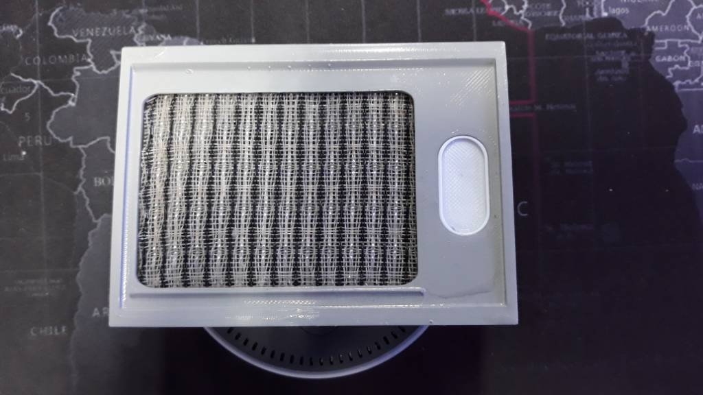

I'll make a cover out of stiff foamboard over the back of the Dot 2 when it's all test-fitted to cover it up, and I'll have to cut a recess into my desktop to fit the lower curvature of the Dot 2, but overall it should work well. The unit will be located so that the enlarged rear will not be very noticeable.
I'll update again when all is done. I'm hoping that the ring of LEDs around the perimeter of the front of the Dot2 will be bright enough to show through the thing light cover insert on the righthand side.
