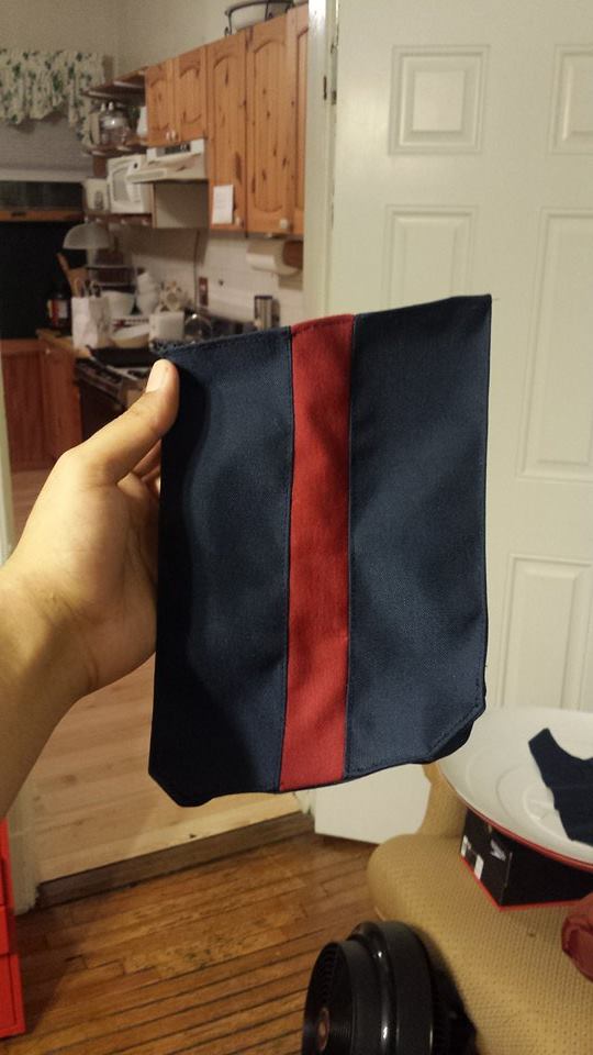

Didn't expect to make a post dedicated almost entirely to the pockets, but with the amount of work it's taken to make them I feel they've earned it! This was my first crack at making cargo pockets so I decide to record it step-by-step for a mini-guide to post on instagram. I decided to add a back panel instead of just stitching the sides down to the pants directly cause I thought it'd add a little extra stability. They won't be sewn down until I attach the back side of the legs, but I placed it on the thigh panel just to see how it'd line up with everything else.
To be honest, the pocket flap was the REAL work horse for this since doing the pleather inserts with those tiny corners took a lot of careful pinning and sew! Stitching is a little messy in some spots, but I'm overall happy with how the first one came out. Gotta make the other one tonight and make sure everything lines up on the pants properly. I'm also thinking of opening up the bottom edge of the flap so I can install some magnetic snaps that I have laying around as opposed to using velcro, but we'll see if I feel like going through the effort for that :p
