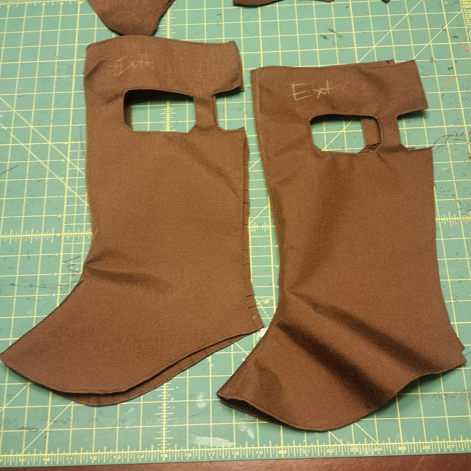

Update on the gaiters since I've got the main bodies more or less done. I did the liners first before breaking down the pattern into the individual sections. The open cavities are to mimic the look of the red webbing strap that threads through the top of the gaiter. Basically just going to attaching the liner and shells, fold the top section down and sandwich the webbing between the folded section and the open cavities. I split the gaiters down the diagonal line as opposed to the middle since it looks like in pictures of the suit on display that the seam allowances of the diagonal stitch are folded under the upper half topstitched down. Last picture is really just to show off how well I aligned the halves and let me tell you, that thin 1/4" middle piece was NOT fun to sew haha

Image dump incoming! I am very close to having these finished, just have to secure the stirrups to the body of the gaiters a bit more, add the brown pleather strip in the front and secure the flap of extra fabric down in place! After finished all the main body halves, I attached them together to make the shells and added piping to the bottom. Then I added the zippers, and attached the shells to the lining.
I did run into a bit of an issue with the zipper; as you can see in the second picture, because of the way I structured the cavities for the webbing to slip through, there's no fabric to sandwich the top of the zipper between! I do have a solution in that im going to make two small bars of fabric to topstitch on top of the zipper with the folded down flap behind it, sealing the zipper in all the way to the top.
Next was adding the extra pieces. First I made the webbing strap that wraps around the top of the boot, trying to mirror the look of the original as much as I could. Unfortunately, because of the thickness of the webbing and color of the thread, it's hard t really see the different stitching lines securing the two lengths of webbing to eachother. But, it still has the right general look and I'm happy with the look it when it's actually threaded through. I made a tab cover for one side by just making a cap out of leftover red pleather, and attached the other side to the bootcover by sandwiching it between the shell and liner at that one section between the cavities. This allows me to tuck the rest of the belt behind the starting point when it wraps around.
I also made the red stirrups and attached it to the gaiters by sewing it down at the front where the curve of the instep begins, and at the back by the zipper. I may also stitch it down across the top lines connecting those two points, but I want to leave it floating for the most part so that it doesn't wrinkle/buckle with the gaiters and because once on the boot it holds in place pretty well.

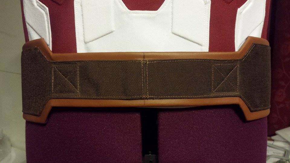

Base belt is done! One of these days I really wanna do belt work with real leather, but usually time and money limits me (might finally be able to do it for a WS Cap suit next year though). But, I have a pretty solid no-sew method that I've done multiple times before that using pleather and craft foam that ends up looking pretty good and is surprisingly sturdy. All it is is marking the belt shape on the back of the pleather, cutting it out slightly smaller (maybe 1/8") in craft foam, and gluing the pleather around the foam. In the past I've done this using hot glue, but this time I wanted to go for a more solid/clean method. I used spray adhesive to tack it down to the pleather and then section by section spread barge cement onto the craft foam to fold the edges of the pleather over. Then I just clip on a lot of binder clips to clamp it and let it dry. The impression marks the clips leave fade off on their own by the next day.
I made the cordura panels separately and topstitched the edges with a contrasting thread to mimic the screen belt, and actually glued that down with barge as well. I did the stitching for the little 'x' boxes on the front once it was glued down. I also made the cordura section at the back of the belt by gluing it around a section of craft foam as well to try and get the same seamless look on the screen belt.
Before I glued down all the edges of the pleather though, I cut two holes in the craft foam at one of the ends to insert two 1/4" neodymium magnets. I then lined up the craft foam for the cordura section where I wanted it to connect and placed the other two magnets to mark where they needed to be inserted into the back section. Then I just did the same thing, cut two holes, glue it to the cordura, glue in the magnets, and then I glued the cordura fully around. The strength of the magnets is still pretty strong through the pleather and cordura, but it's still pretty easy to pop off when I take the belt off.
The only part that didn't go so well was stitching the cordura section to one side of the pleather and putting matching stitching on the other side. This pleather turned out to be much more grippy than the other pleathers I'd been working with, and none of my usual methods for dealing with grippy pleather worked. That combined with the soft craft foam made the thread sink into the belt really deep, have really short stitches, and it fell off a straight line several times. I might go back over it with light handstitching just to cover up the sunken thread, but I'll need to figure out a way to work around this issue before I start on the pouches. A friend suggested using a teflon presser foot so I've ordered one of those that's being delivered tomorrow, hopefully that'll do the trick.
