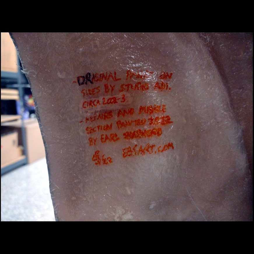

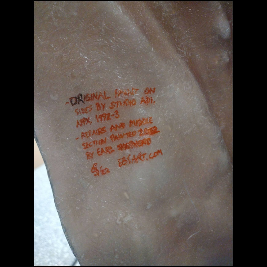

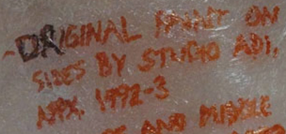

Then I signed it on the back side with red alcohol ink and cleared over it with two coats of Gloss Medium and Varnish (not pictured).

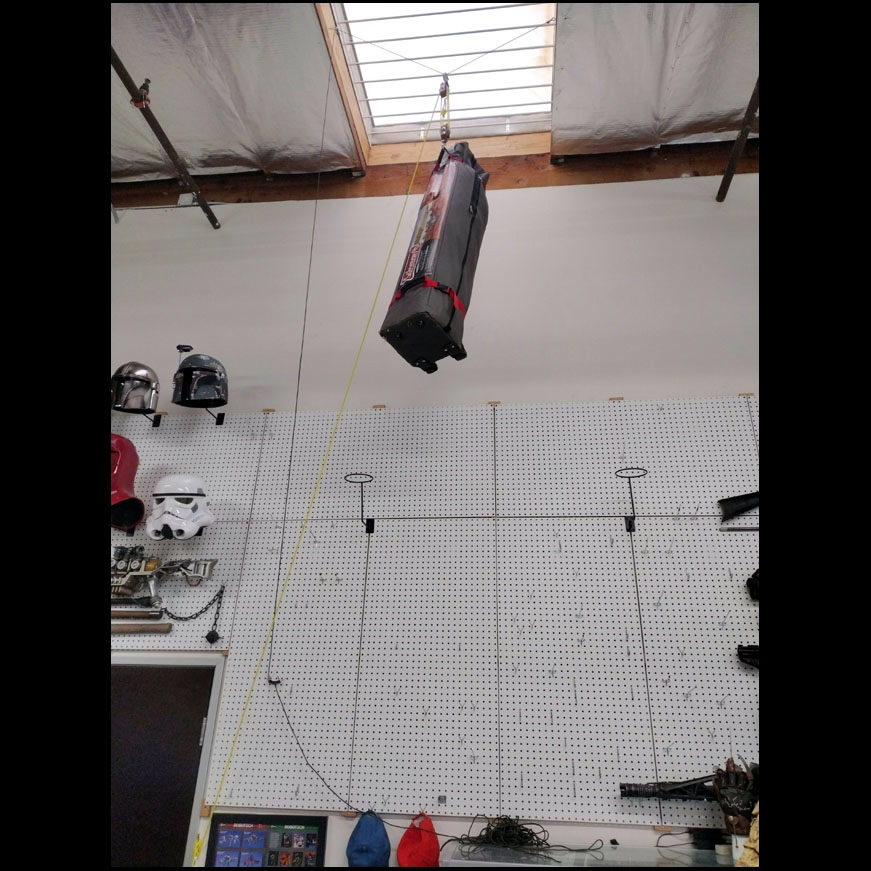

A quick hang test, because why not. This EZ-Up is a few pounds heavier than the crown.

Hoisted and cleated. Leaving it up overnight to make sure there's no weird sag, and/or to see if anything else loosens. Barring catastrophe tomorrow the crown shall be hung!
Btw, if you've never gotten your hands on a block and tackle (or similar) DO IT! It's a really neat lesson in physics. I was able to casually lift that 50lb EZ-Up with one hand. This is the one I'm buying. It's cheap, strong, and a proper block and tackle as opposed to the dressing hoist which is very similar but structurally a little different. For under $30 why not have both.
Also, the only cleat I could find at any of the stores isn't "rated" for weight like most mounting hardware. Assuming the worst I think it's still probably good for 75lbs but that's probably pushing it - and that's too close to 50lbs for me to be super happy. I did attached it to the wall with two drywall screws (my favorite multi-purpose screw) going through holes in the steel frame around the door jamb, so I feel secure about that at least. The neat part about the block and tackle is that of the 50lb total load, the load on the cleat is only about 8lbs because of the way the pulleys redirect the load within the block. Physics is awesome!

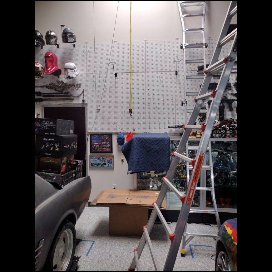

The lifting area, prepped. Bonus points if you can name the Lego kit in the big box I used as a platform to raise the crown high enough that I could get its wire on the block's hook. I couldn't lower the rope any farther because I had to splice the line to get enough length for the lift and that splice wouldn't fit through the block's pulleys.

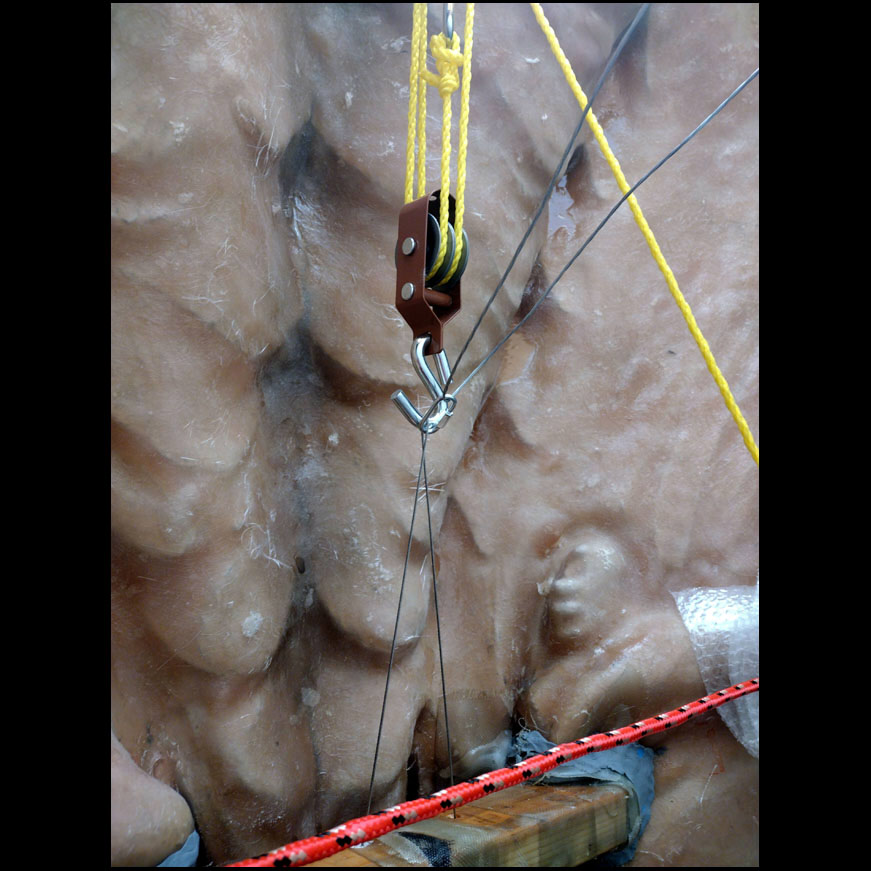

It was about 1mm from impossible, but I got the wire on the hook. One of many examples of when it would have been far easier with a second set of hands.

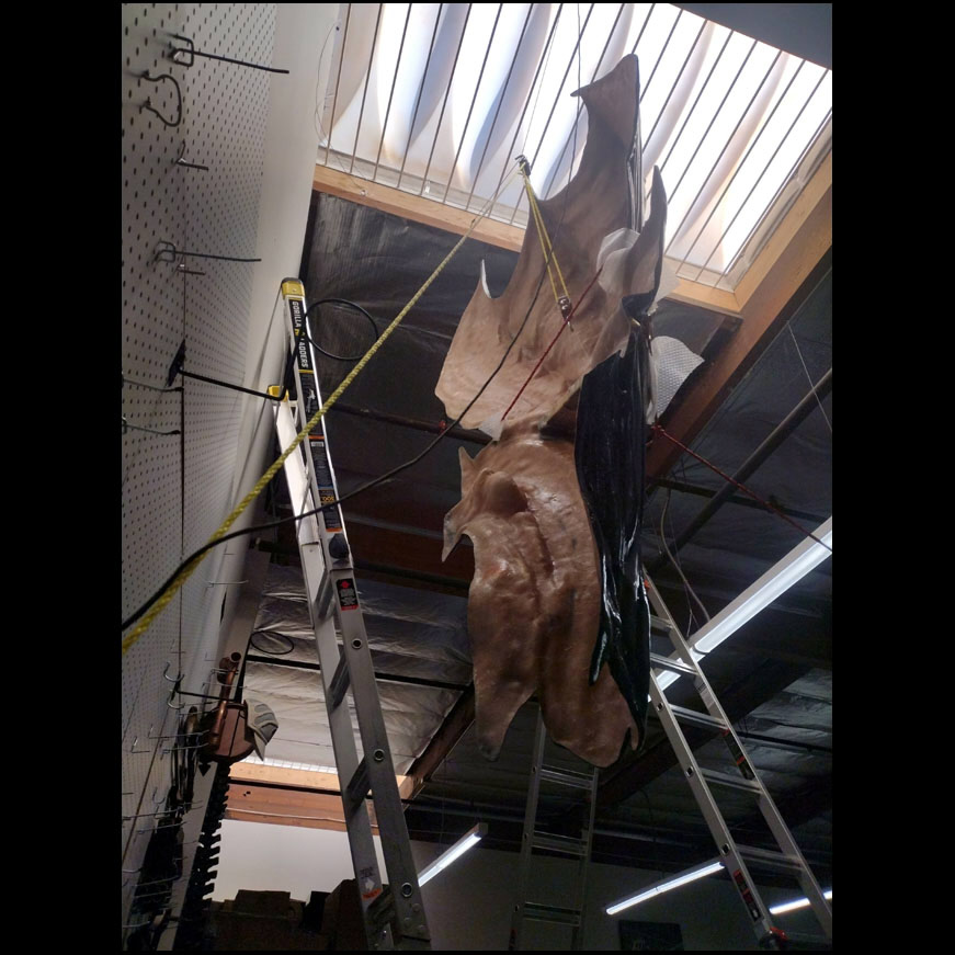

The rest of the lift went quite smoothly, up to the point where the middle spike made contact with the block (about 14' up). I still needed it to go another foot higher so I could attach it to the wall-anchored wire. I expected it to slide over the block, which it sort of did...
...until a disaster of sorts. Or at least terror. As the horn made contact it slide up and sideways, imparting an anhedral effect that spun and inverted the crown quite violently and I was certain it was about to fall and crush my cabinet and maybe some other stuff. But it was so heavy that its weight kept the wire on the hook and after a lot of thrashing it settled down - hovering sideways way up over my head. I lowered it a bit and climbed up to inspect and figure out how to salvage the situation.
Lowered it a little more so I could get hands on it from my step ladder so I could be in front of it. On the plus side, I now KNOW that my 2x4 mount setup is strong enough!

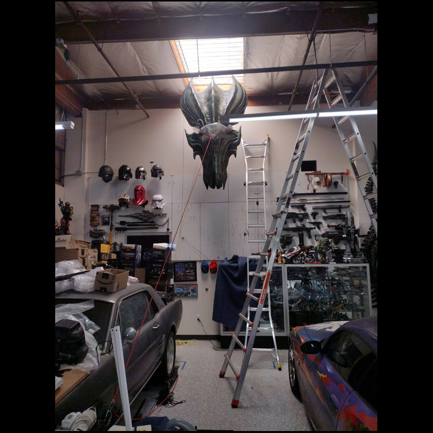

Then it was time for lift #2. Up to the block again...
Then over the course of an hour I inched it up and ever time I saw it twitch I would cleat off the lifting line, climb the ladder, and adjust the crown's angle. Every inch. Until it was high enough to make the hand-off to the wall cable.
