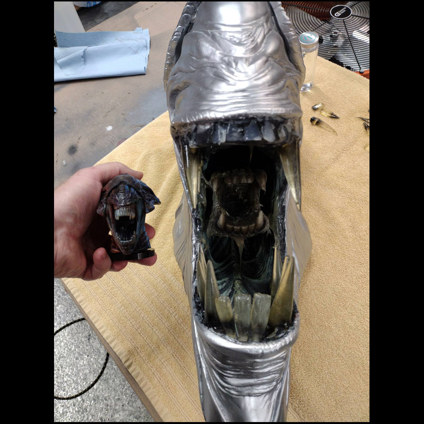

This is not a prop, or a replica. But I was asked to post the process here as it relates directly to my AvP queen crown repaint project. In short, the idea to extend and blend the ADI crown's blue and green paint schemes across its unfinished middle stemmed directly from my experience painting this dual-color OSL repaint of a cheap Lootcrate Aliens queen pencil sharpener. The crown thread is here, if you missed it:
I will try to be concise, but this thread will be very picture heavy due to the steps involved and the two very different sides' palettes and lighting angles. OSL is a term used mostly by mini painters, and means painting portions of a figure so that it looks like they are illuminated by a Lighting Source within the Object's frame of reference.
Also, I'm not a mini painter. I painted a mini once, a 1/144 scale Dougram:
And I did one simple OSL before this one, a larger (1/12 scale) Leia in carbonite:
And, technically, this pencil sharpener isn't a mini. But it is roughly the same size as larger mini busts and monsters.

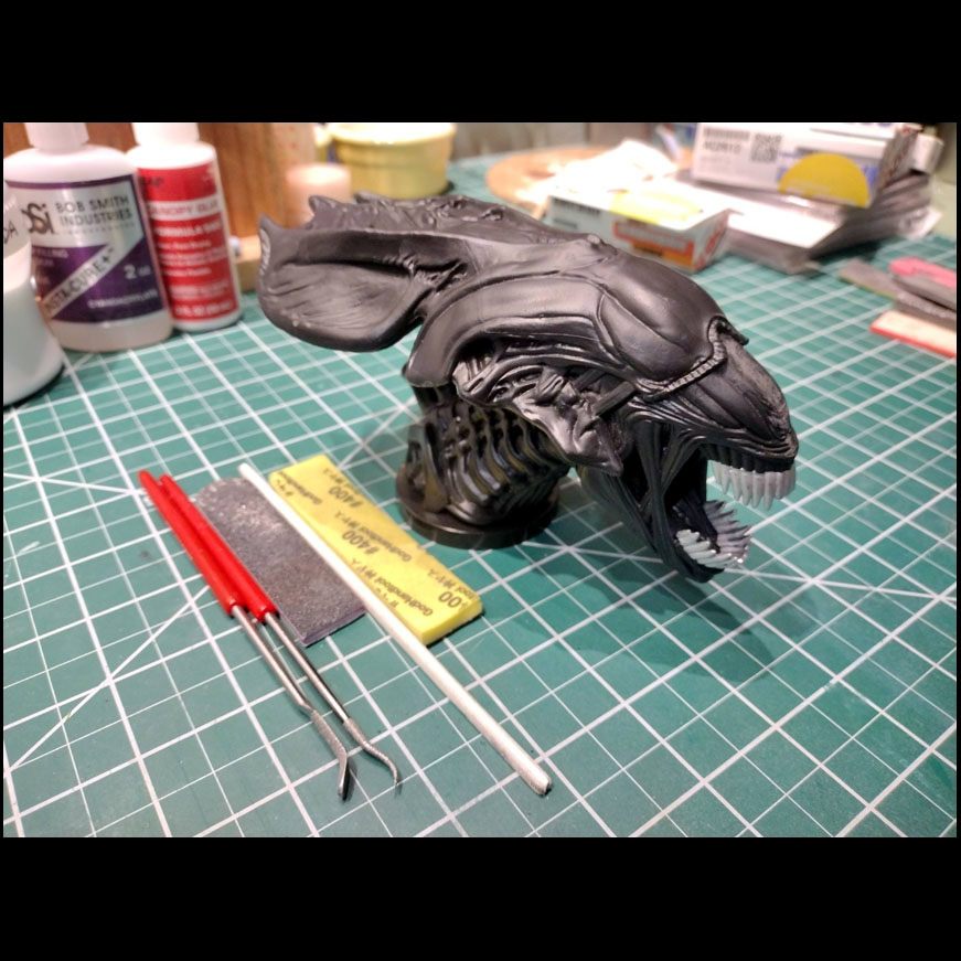

The pencil sharpener, acquired via eBay after Lootcrate's release. This pic is after I spent an hour sanding off the mold lines and defects prior to priming.

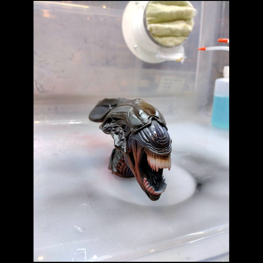

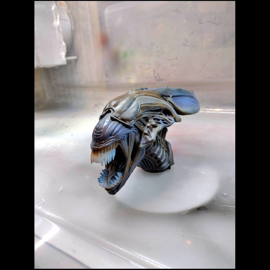

The next step after a simple black (gray on the teeth) priming was to do a sort of zenithal (but not literally zenithal!) base by spraying blue and red from the directions of my two light sources. I chose below for the red, because uplighting always makes things look dramatic, and 3/4 behind for the blue so it would (hopefully) reveal a lot of the beautiful contours of the queen's design.

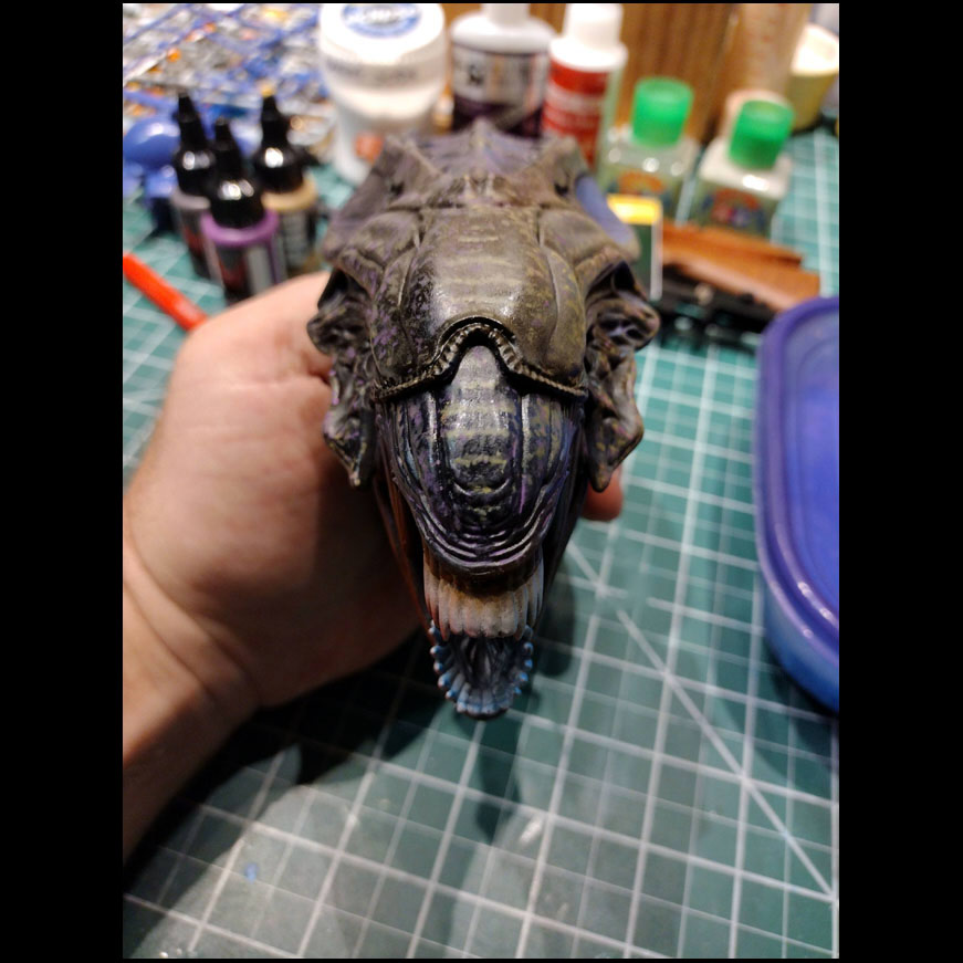

The next step was brown pre-shading. To give variation to the head I broke it into sections of harder and softer areas. The former got a brown tone, the latter a more neutral base color so the lights' colors would show stronger there and also diffuse more.
Unlike my full size ADI crown, this figure had to be painted on all sides - much more work!

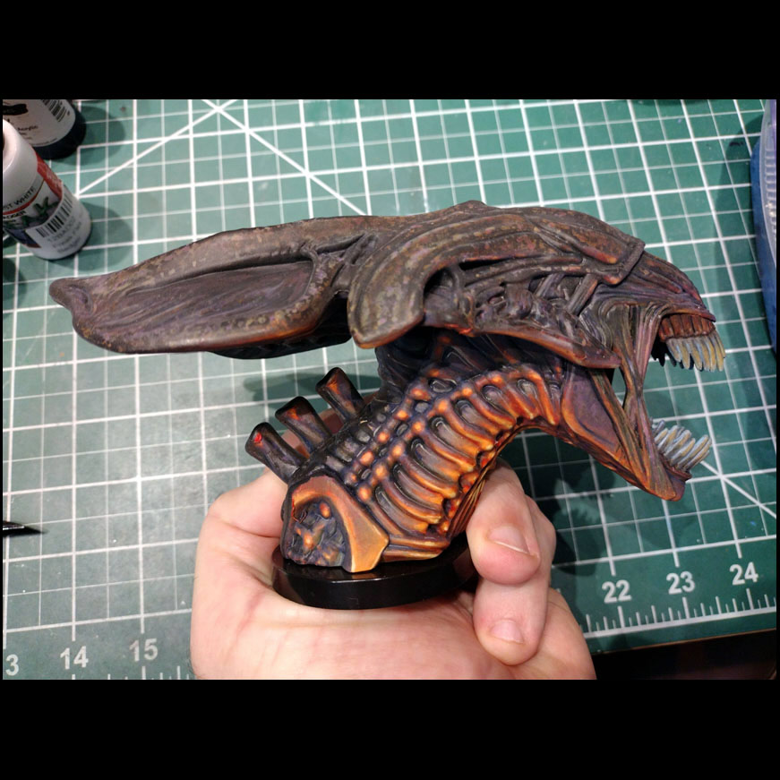

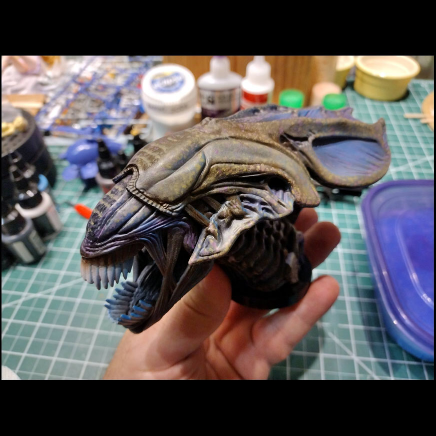

Then it was time to start the orange side, thinking it would be a little less complex than the blue. And all of this was basically a series of sequential experiments, having never attempted NMM before. I laid out where the reflection midtones would go with fairly opaque red.
Then a smaller orange area within each of those red areas.

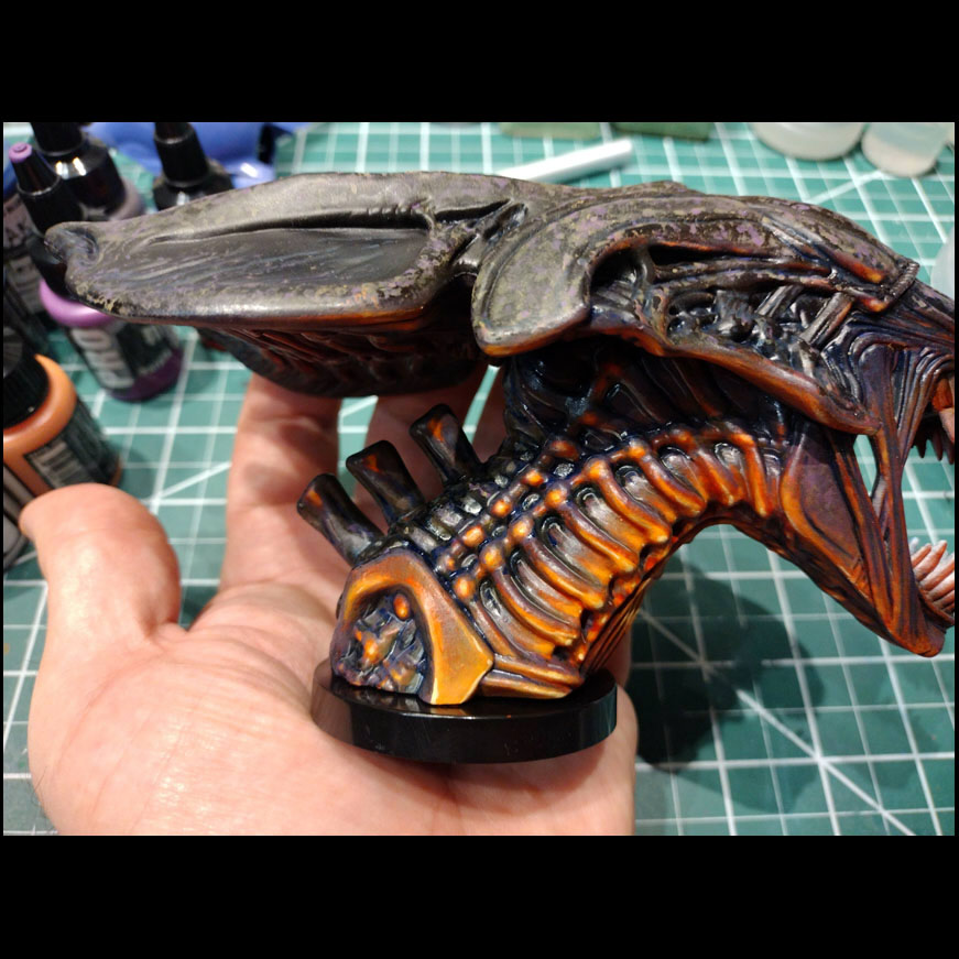

Then purple within the black for a subtle reflected light warmth. And I had started glazing within the red/orange areas as well as transition from the red into the black.
But I felt that it read too much like comic and that I wasn't going to be able to get a proper spread of light through the area. So I got the airbrush back out and lightly sprayed orange to enhance the transition aspects.
Then I went back in with the brush and built out the contrast again with lots of glazing. And I added secondary reflections (thin pale lines) inside the core of the darkest areas.
A close up to show the secondary reflections more clearly.
The orange side pretty much done. Except the teeth and tendons...more on that later...

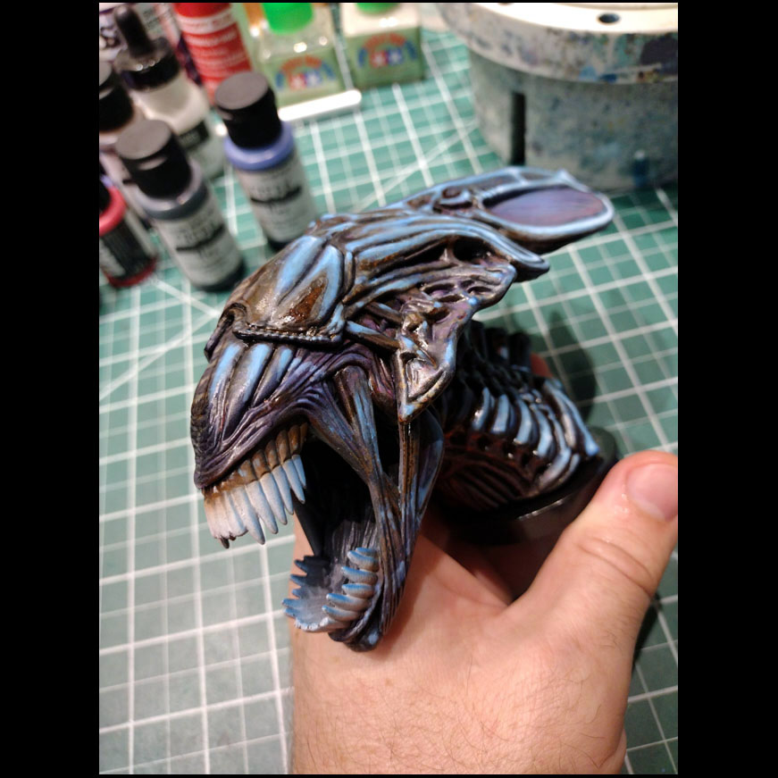

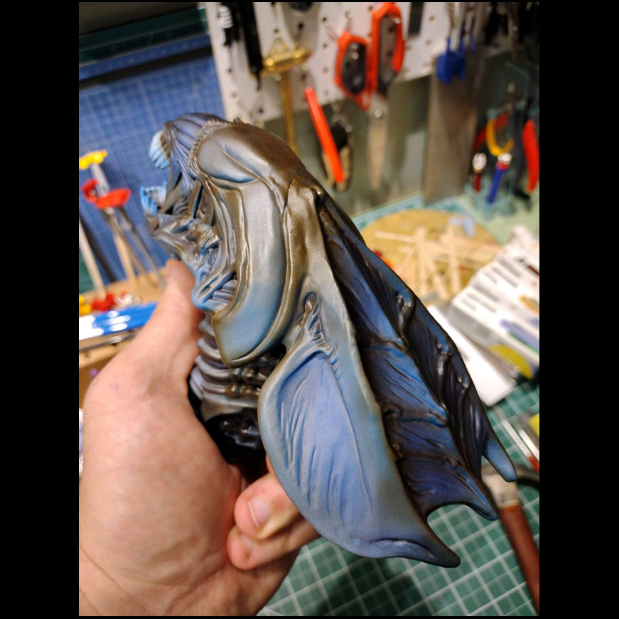

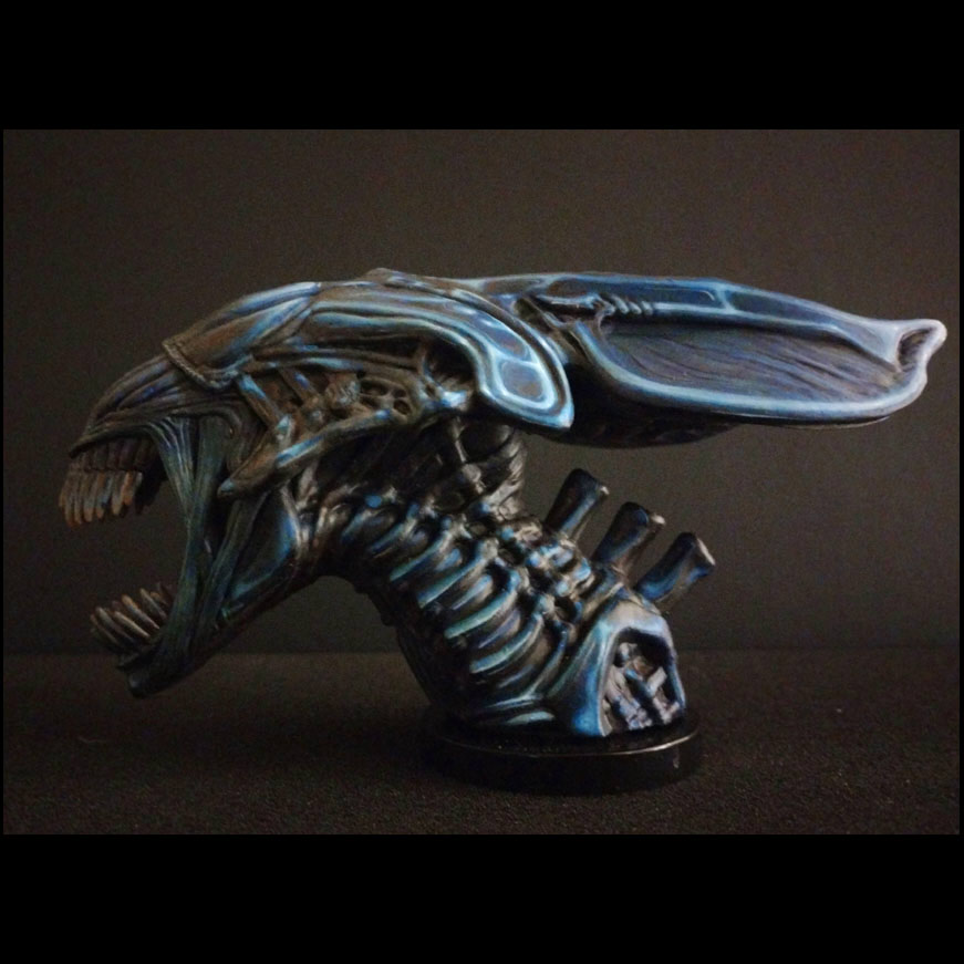

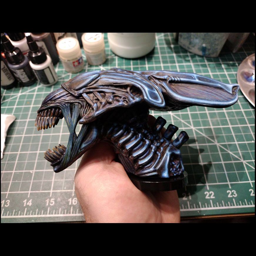

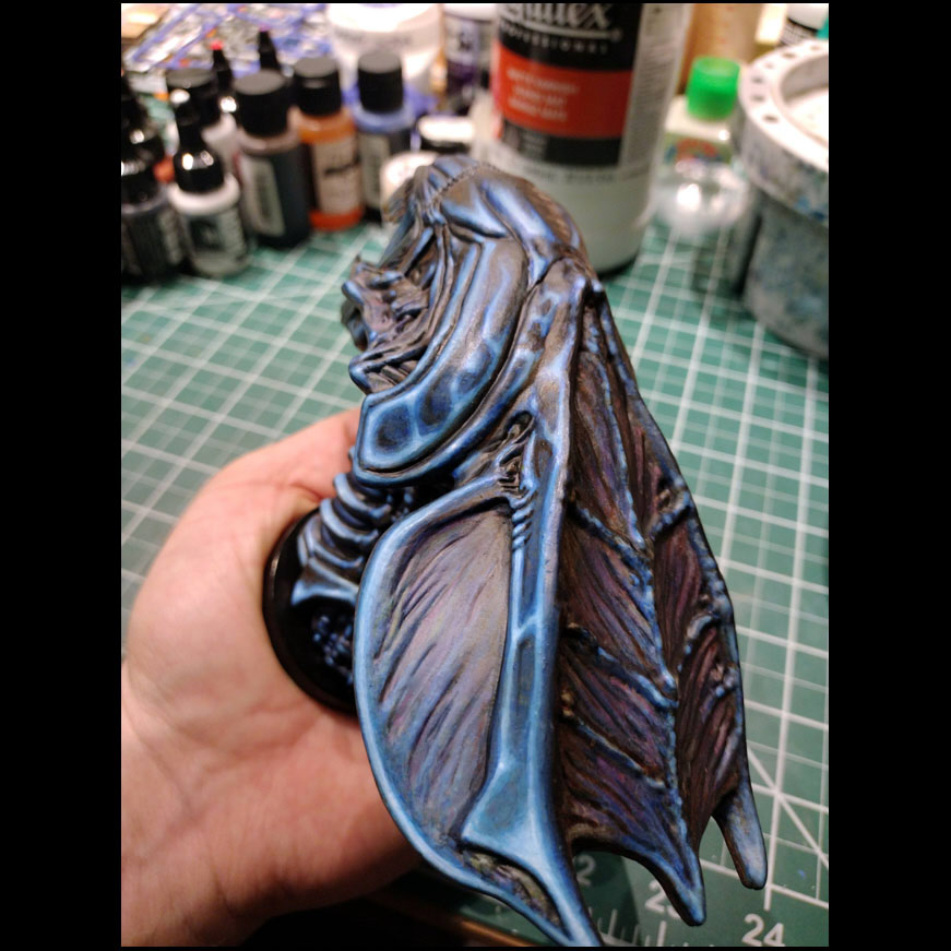

Time to start the blue side. Beginning again with a color sketch to define where I want the highlights.
Building up more blue.

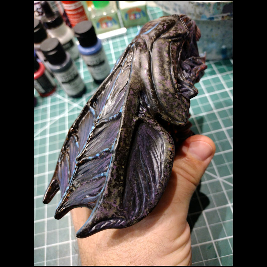

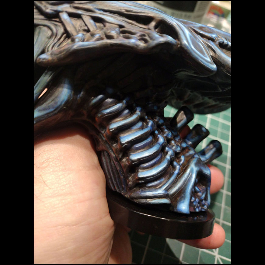

Then I toned the non-highlight areas with Freak Flex brown tint. This gave a really wonderful translucent effect over the previously-applied color dots.

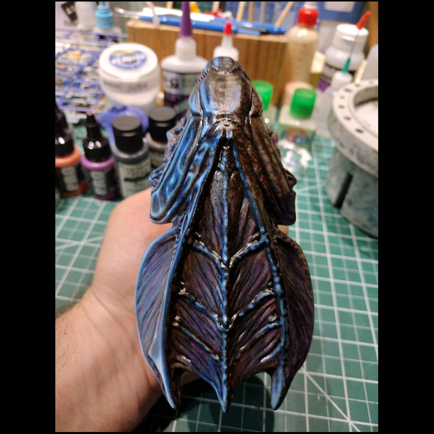

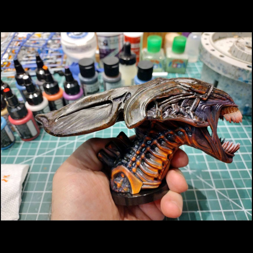

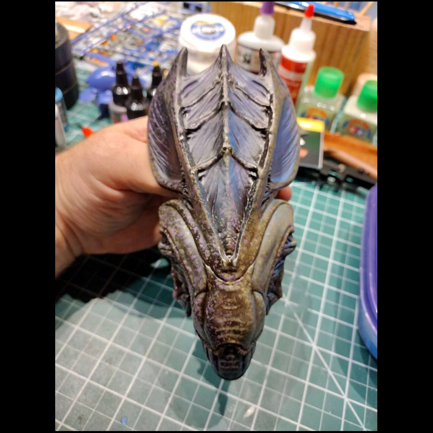

I didn't have a clear plan with how to make this angle interesting. Neither lighting source hits it, but I didn't want it to simply disappear. So at this point I decided to paint it as if it were illuminated by a weak, neutral light.
More tonal range now, after the brown tinting.

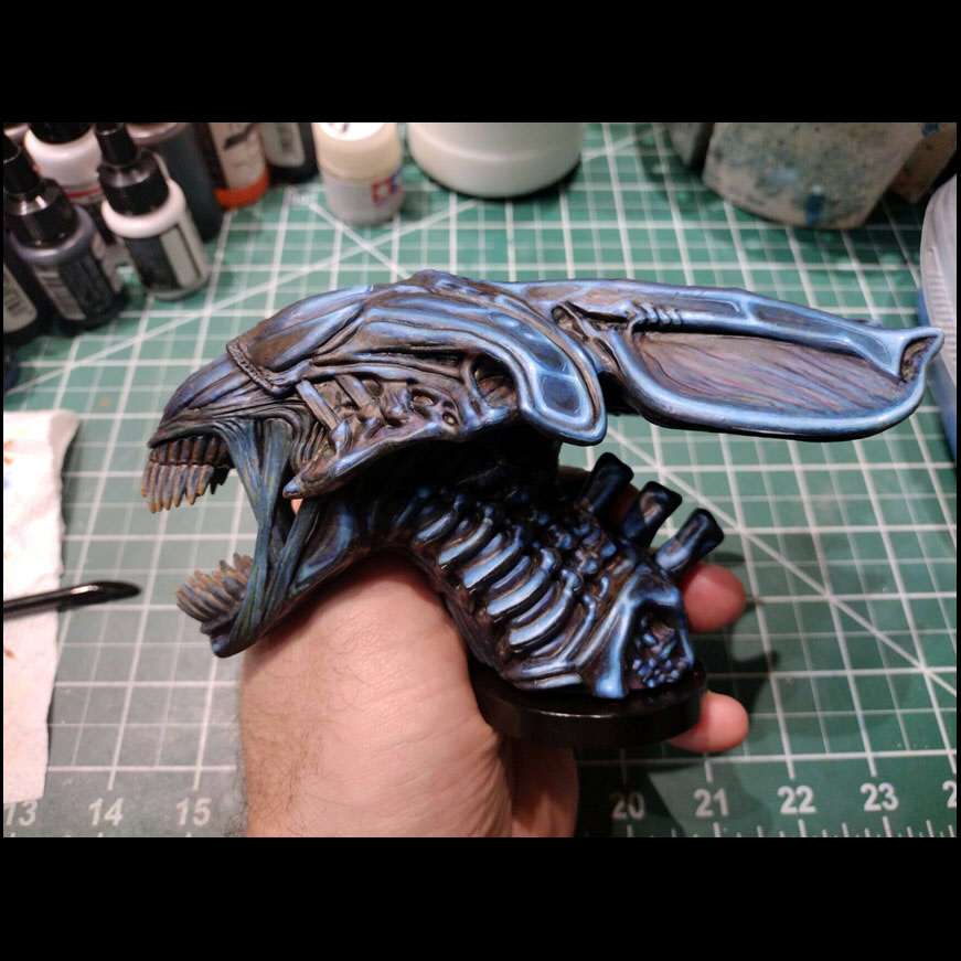

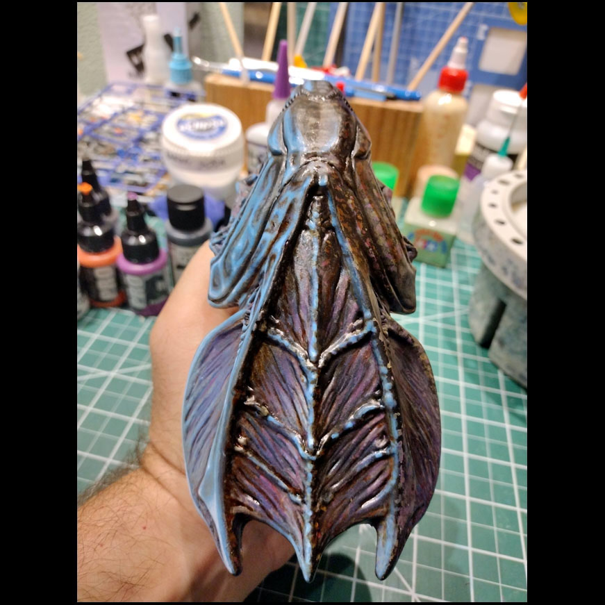

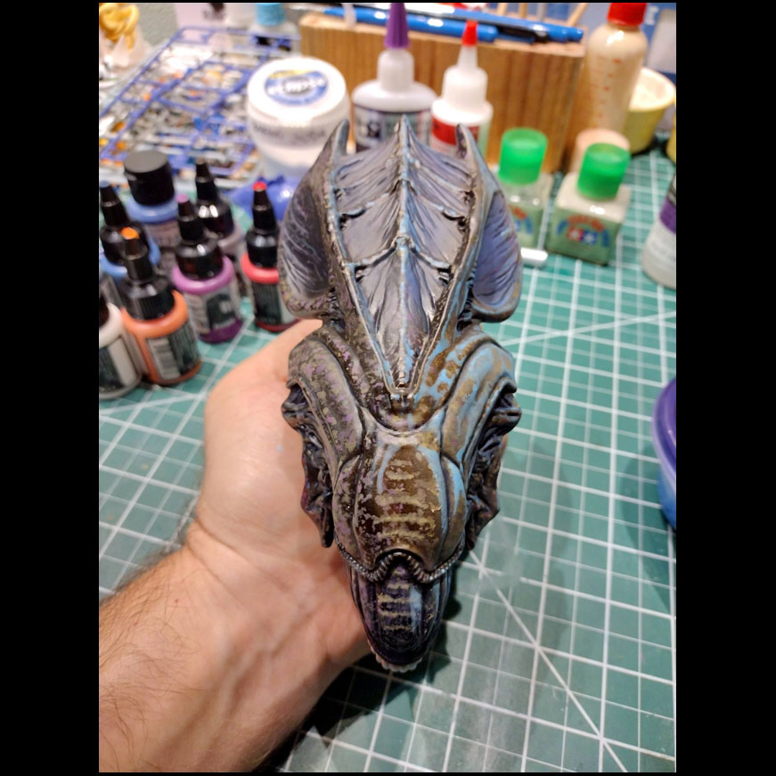

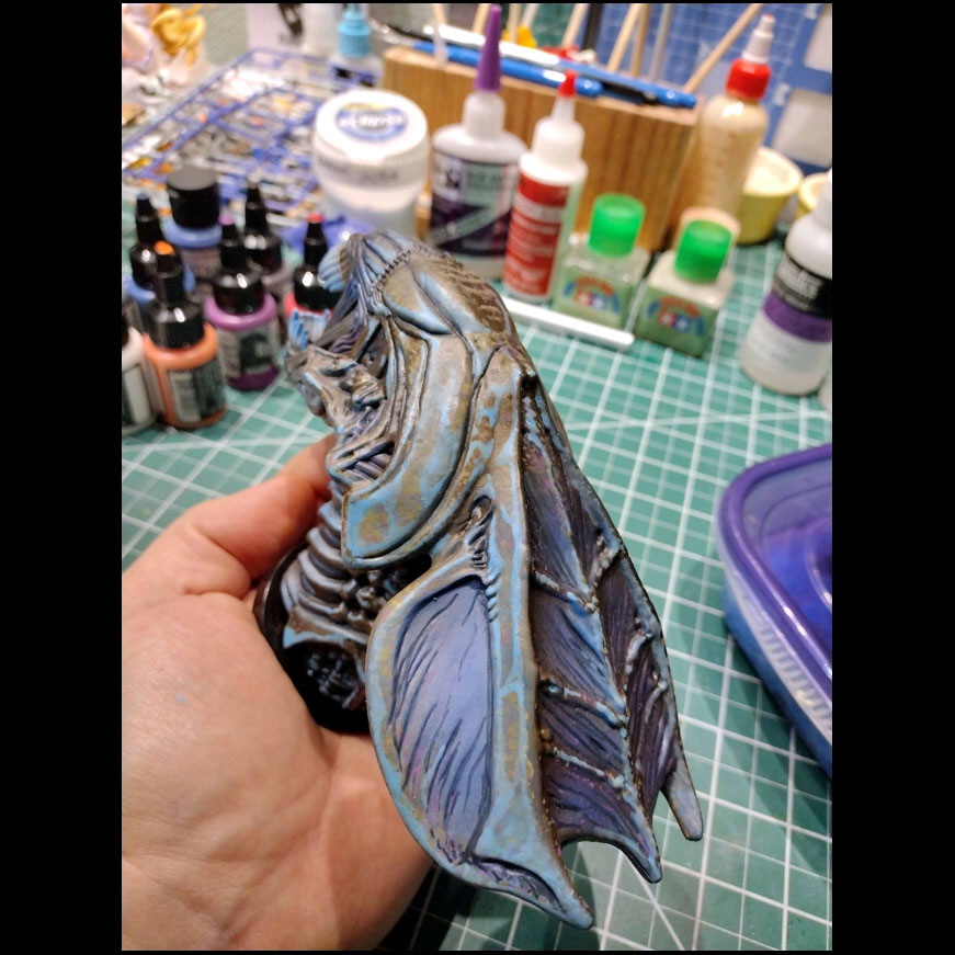

Back to the orange side, extending the range of its illumination a little farther onto the top of the crown.
This was to balance the two light sources. Also more detailing in the soft areas.

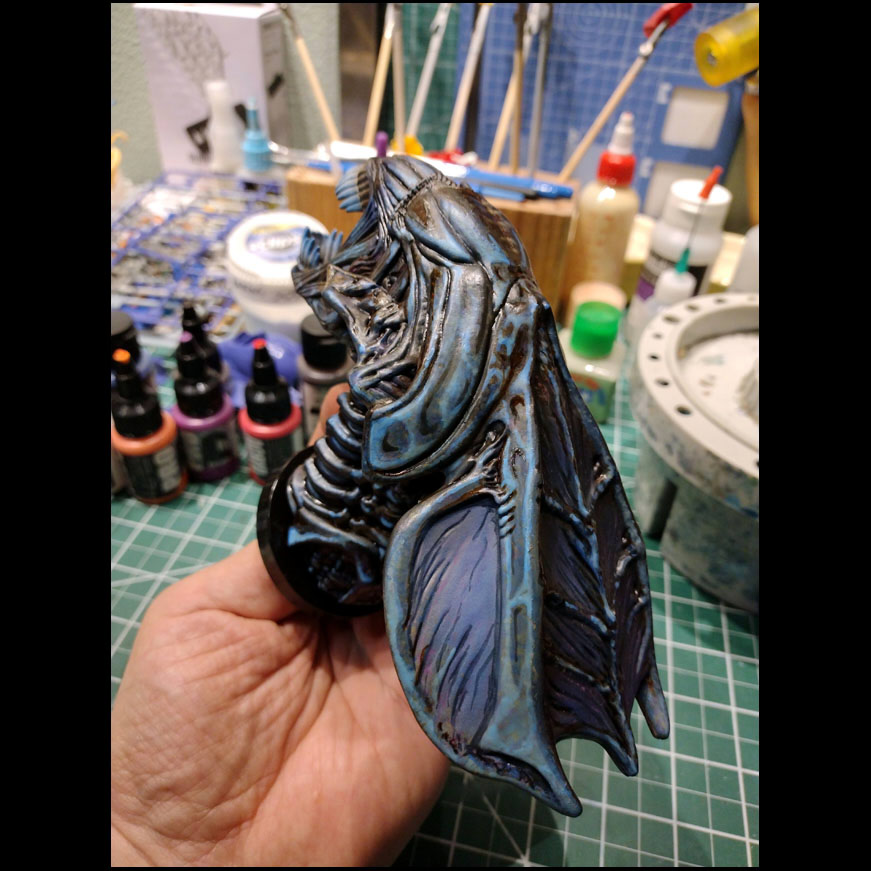

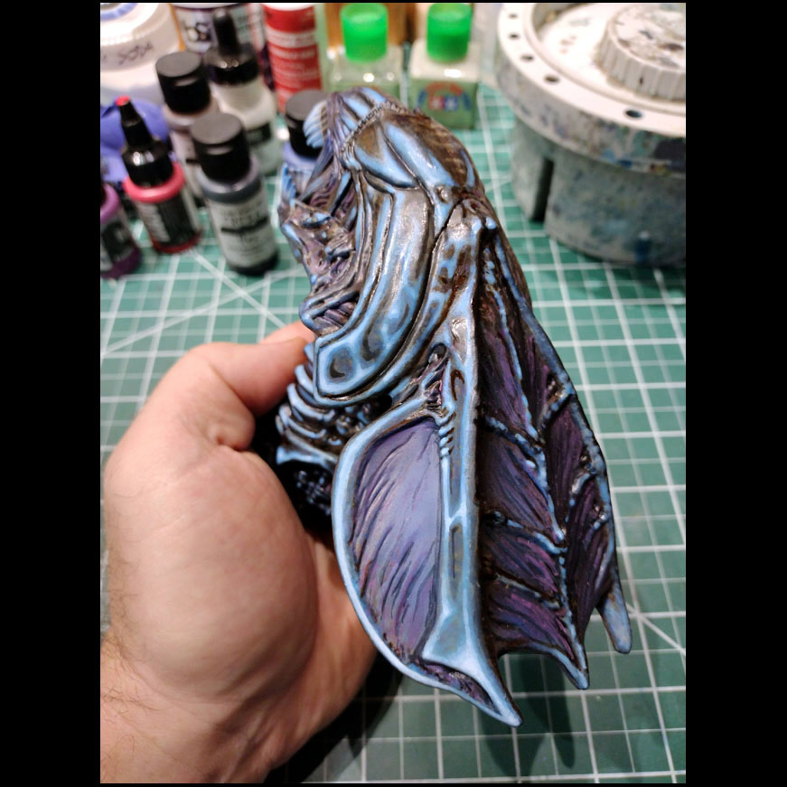

Then I started adding a dark blue glaze to help transition between the blue highlight areas and the brown dark areas. This hue shift was critical in establishing a light effect as perceived by the eye. See the difference below, the head has the blue but the crown does not.
More glazing of the blue areas, also white fine highlights were added. Getting a better glow effect now.

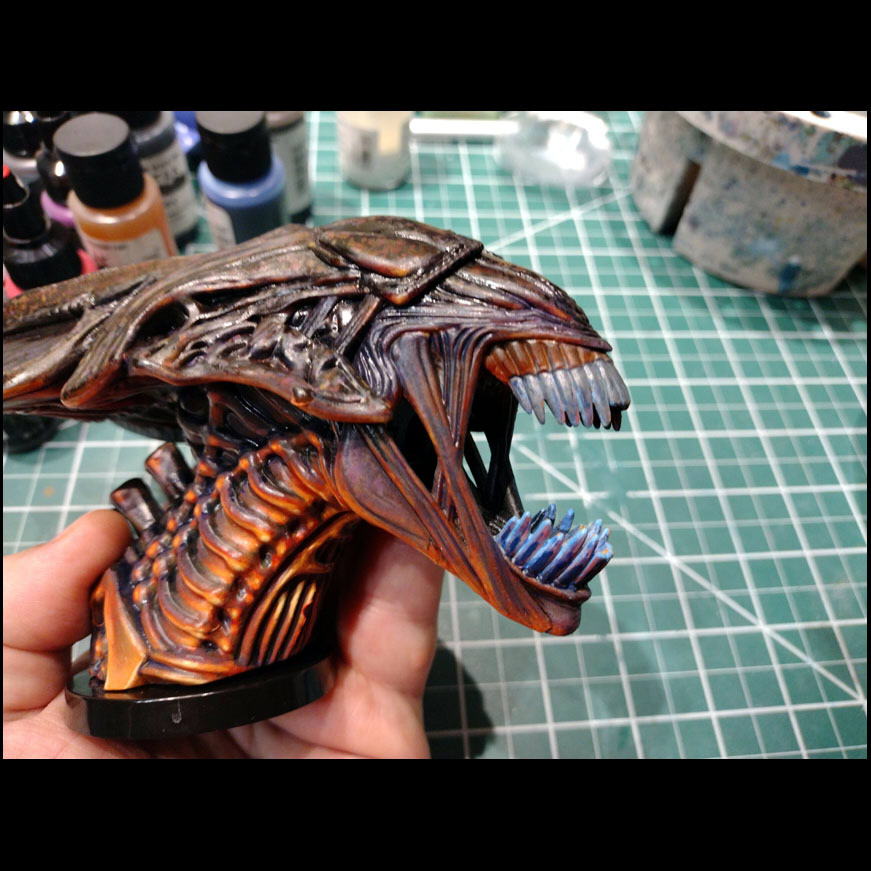

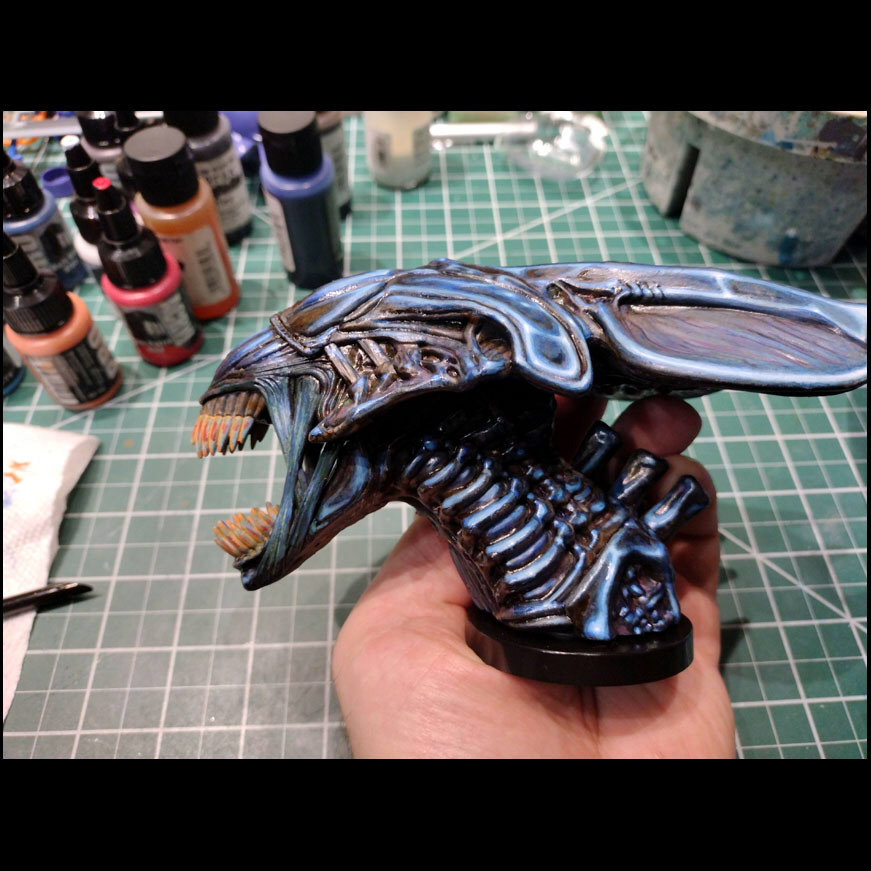

Now time for a new experiment, how do I make the tendons look at least a little bit translucent? After a fair bit of experimentation I came to the conclusion that simply inverting the logical shading process would be a good start. If the highlights were in the crevasses and the darker colors were on top then it "should" read as light passing through the thinner areas of material, right?
Simple color sketches using the blues and white to define the basic idea.
Later, after glazing to add variation to the tendons' color tones and smooth the transitions.

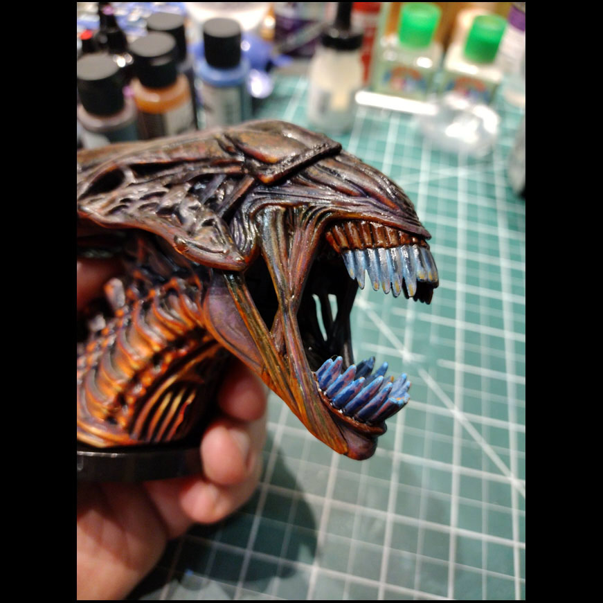

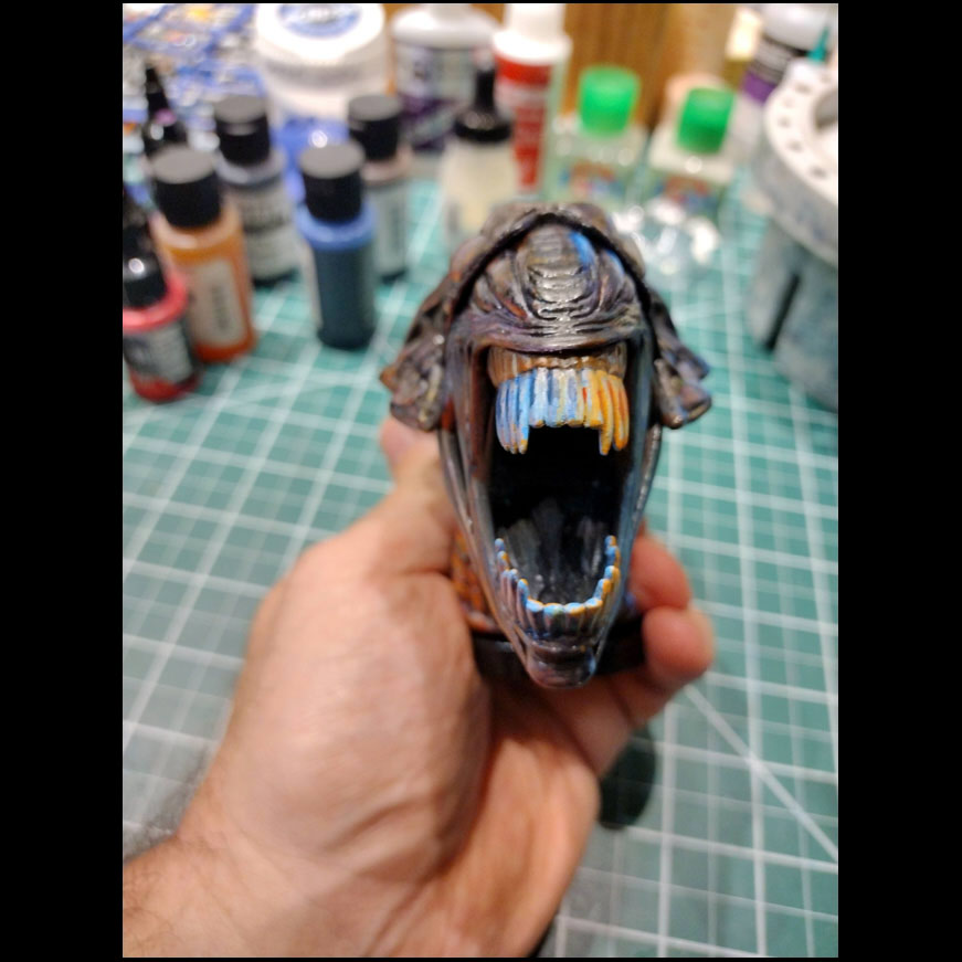

This seemed to work, and I did the orange side too (not pictured, for brevity). Then it was on to the teeth. The queens teeth are not silver, or metal, they are quite clearly a crystalline silicone. So I studied pictures of gem stones to try to understand what exactly it is that our eyes see that make us think "crystal". In short, more light from behind is visible, with the core shadow in the middle and the edges very bright with the backlighting color. Any lighting from the front (like my initial zenithal airbrushing) does impact the color, but to a lesser extent.
This means that my back lighting highlights on the orange side needed to be blue, and the reverse for the blue side. Here is the first round of highlights and core shadows, looking very crayon!
Then a lot of glazing, to blend and tune the colors. In this pic you can see the difference between the upper and lower jaws.

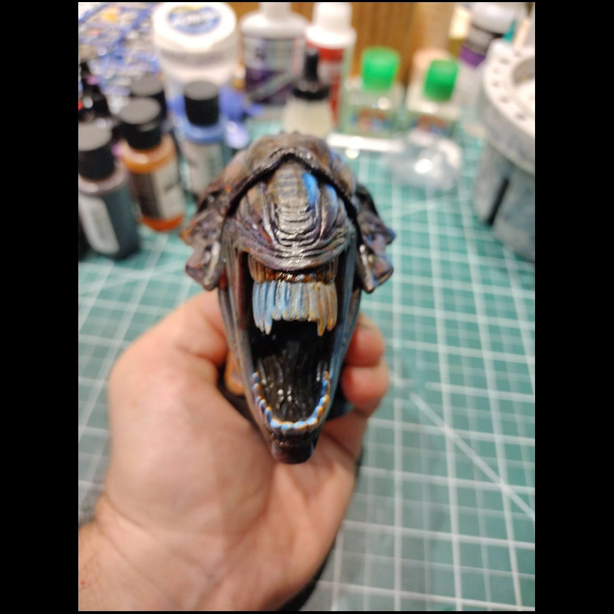

Additional contrast was needed. I did the top jaw on each side before doing the lower, to fine tune the process. Afterwards I then had to do the inside of the teeth, reversing the colors yet again.

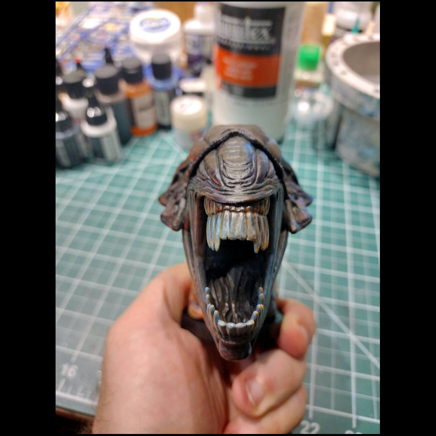

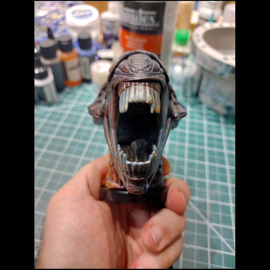

The teeth, finished, after a bit more glazing. I will point out that this was a good example of the importance of walking away! As I get older I find it increasingly important to make myself put a project down and walk away...for 10 minutes, a lunch break, whatever. The mind needs to disconnect so that it can see relationships more clearly upon reconnecting. We are creatures of relativity, so it's important to reset.

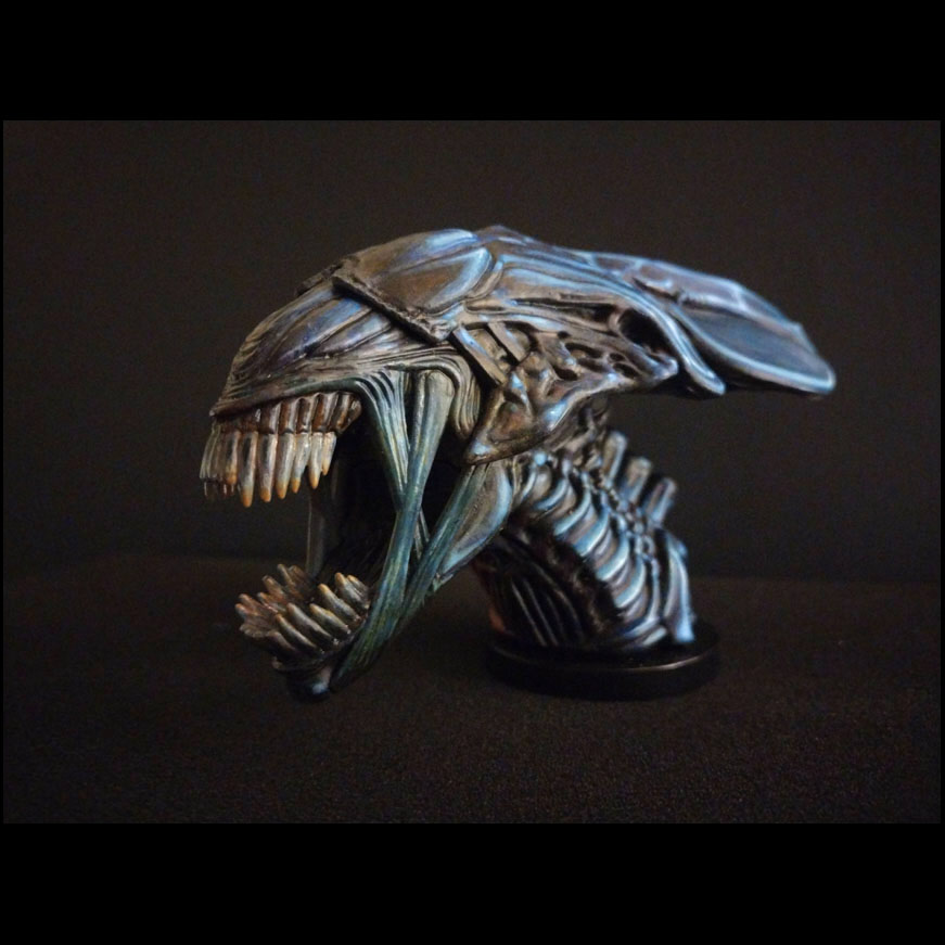

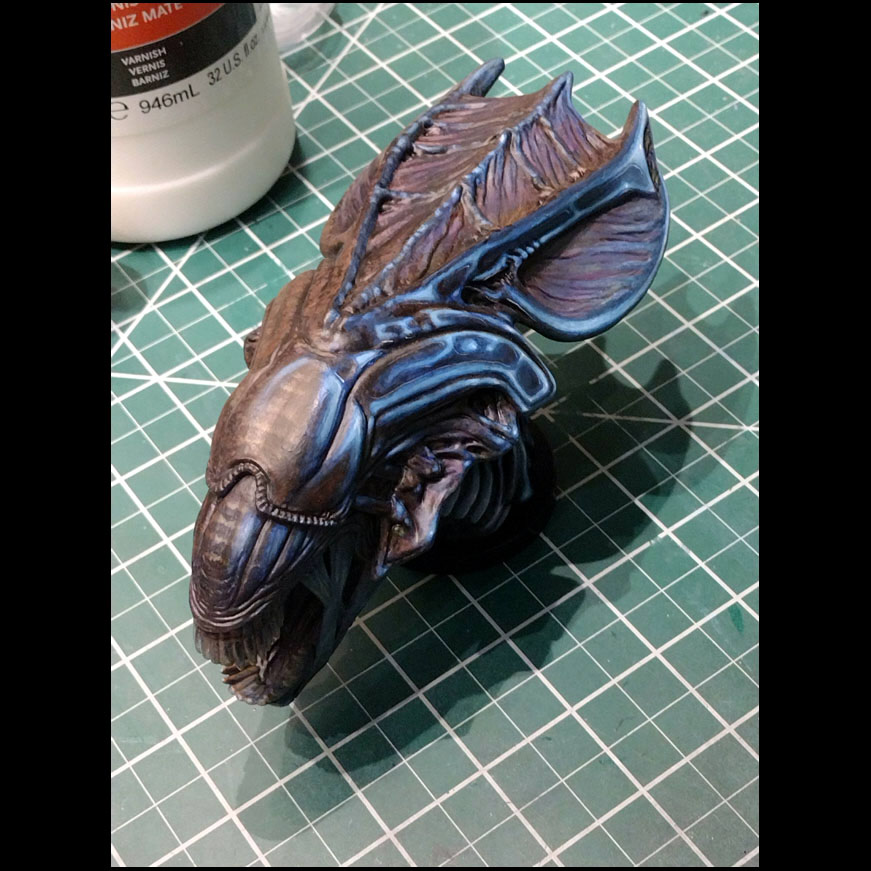

Almost done! Time to clear coat...which if you are a mini painter means a matte finish. This is important so that real specular highlights don't distract from the more important highlights that you manually applied. However... Tamiya's excellent matte clear made my queen look like crap. It sucked all the depth out of the dark shadows, flattening the whole thing.
I re-cleared it with Liquitex Matte Varnish, which brought back a lot of the depth.
I then added secondary highlights to the blue side.

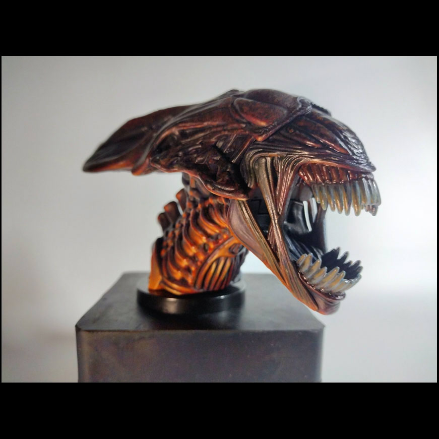

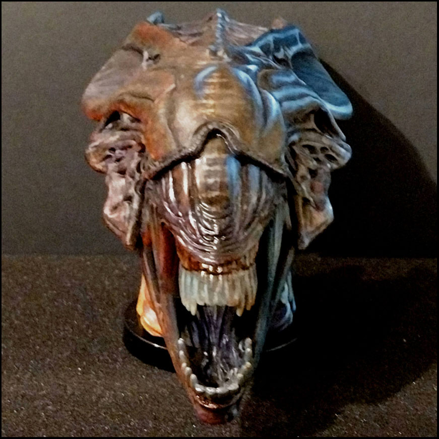

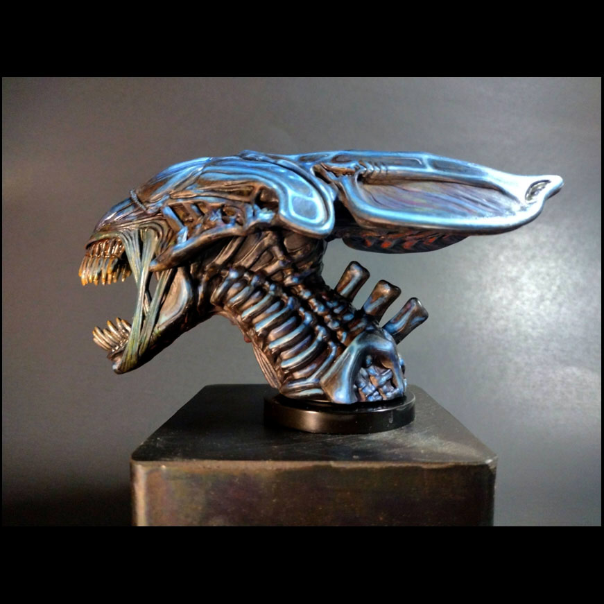

Several times I've tried to take better pics, and every time I have not liked the way they turned out. Something about this particular figure and its paint, it just doesn't look right in the pictures compared to my eye. These are the best I have so far.
These I shot under fairly low light, which helped the camera with perceiving more subtle details in the colors. But it also added noise to the pics and reduced focal precision.
