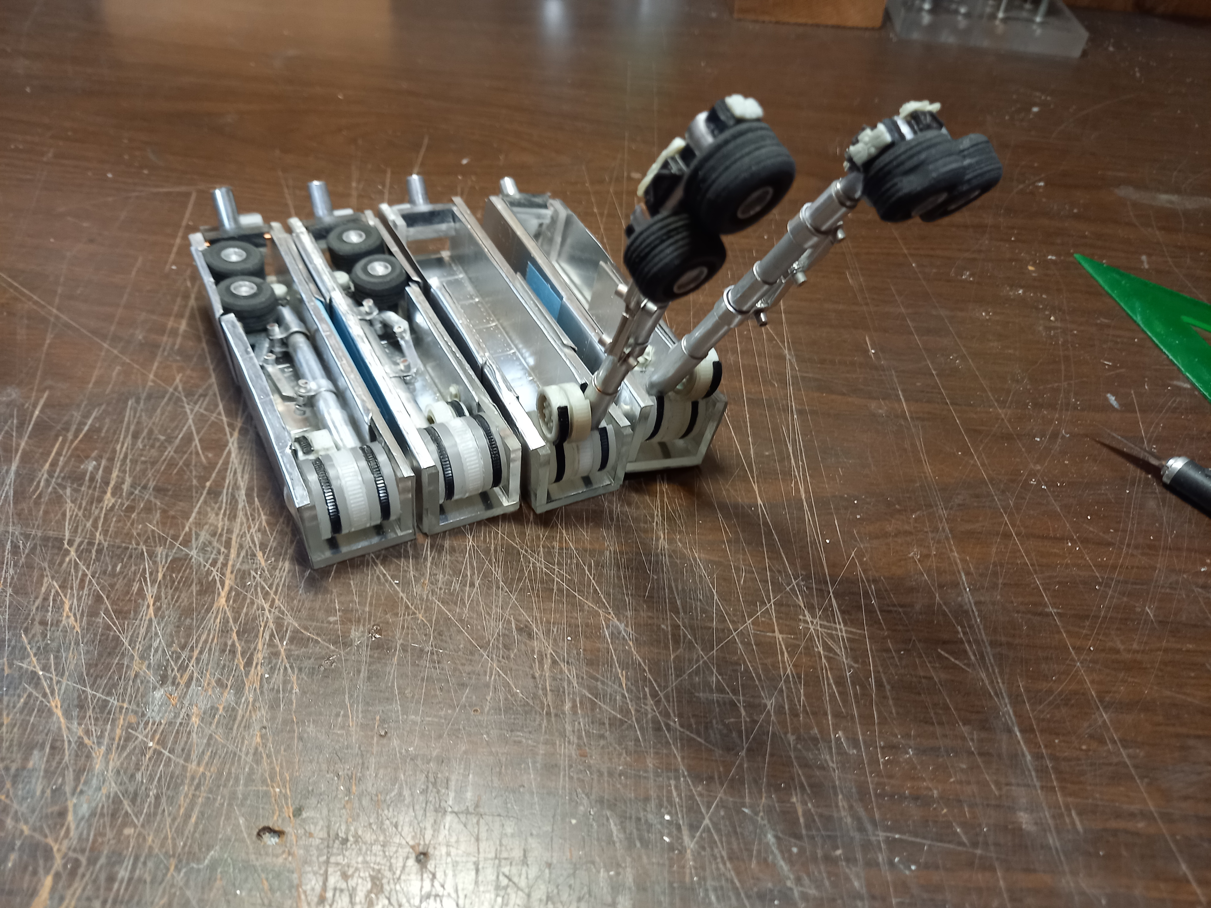

Here's the small progress of the last 2 days.
I've been working on the gear-down mechanisms.
This part will be finished soon.

Those gear drivers are sweet. Always amazing to see simple household articles become tech hardware.
It is always nice to take some time off
Those landing gear look awesome
Very cool to see the APC under there

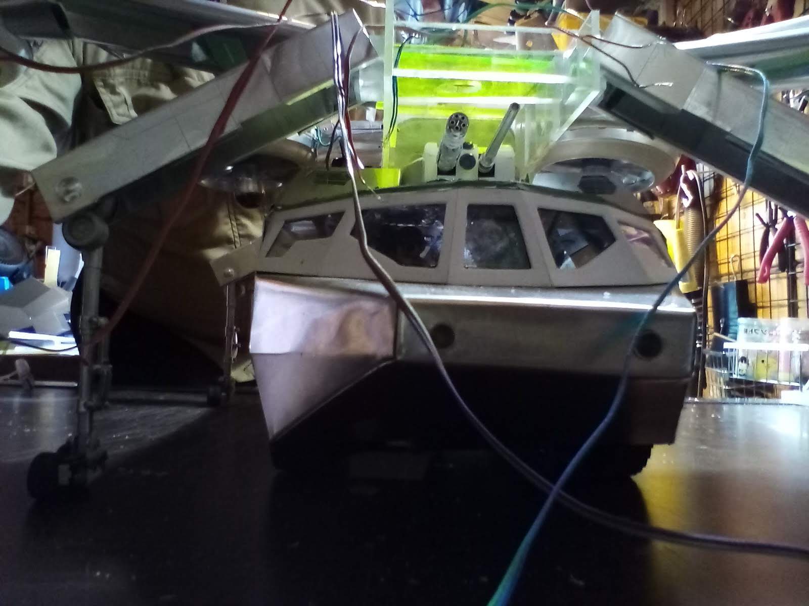

Landing gear and stance of the whole drop ship is cool (y) (y) Noticed that the real landing gears are touching the side of the vehicle:unsure:
I'm sure that could be fixed. Eager to see your next update Katsu-san:notworthy::notworthy:

Thank you, Analyzer-san!
Aghhh!! ... No sweat.
I didn't put the fixture for the claw on top of the roof. So the ship will be about 1/3 inch higher. Not the wide gap but it will be OK.
I will test fit them again later.
By the way, I think I need to change the thin coil springs inside the landing gear strut to a bit stronger one. So that the ship could hold the appropriate height. Maybe a spring of the ballpoint pen or I will make some if it's still weak.
Thanks for the close looking at my model. :notworthy:

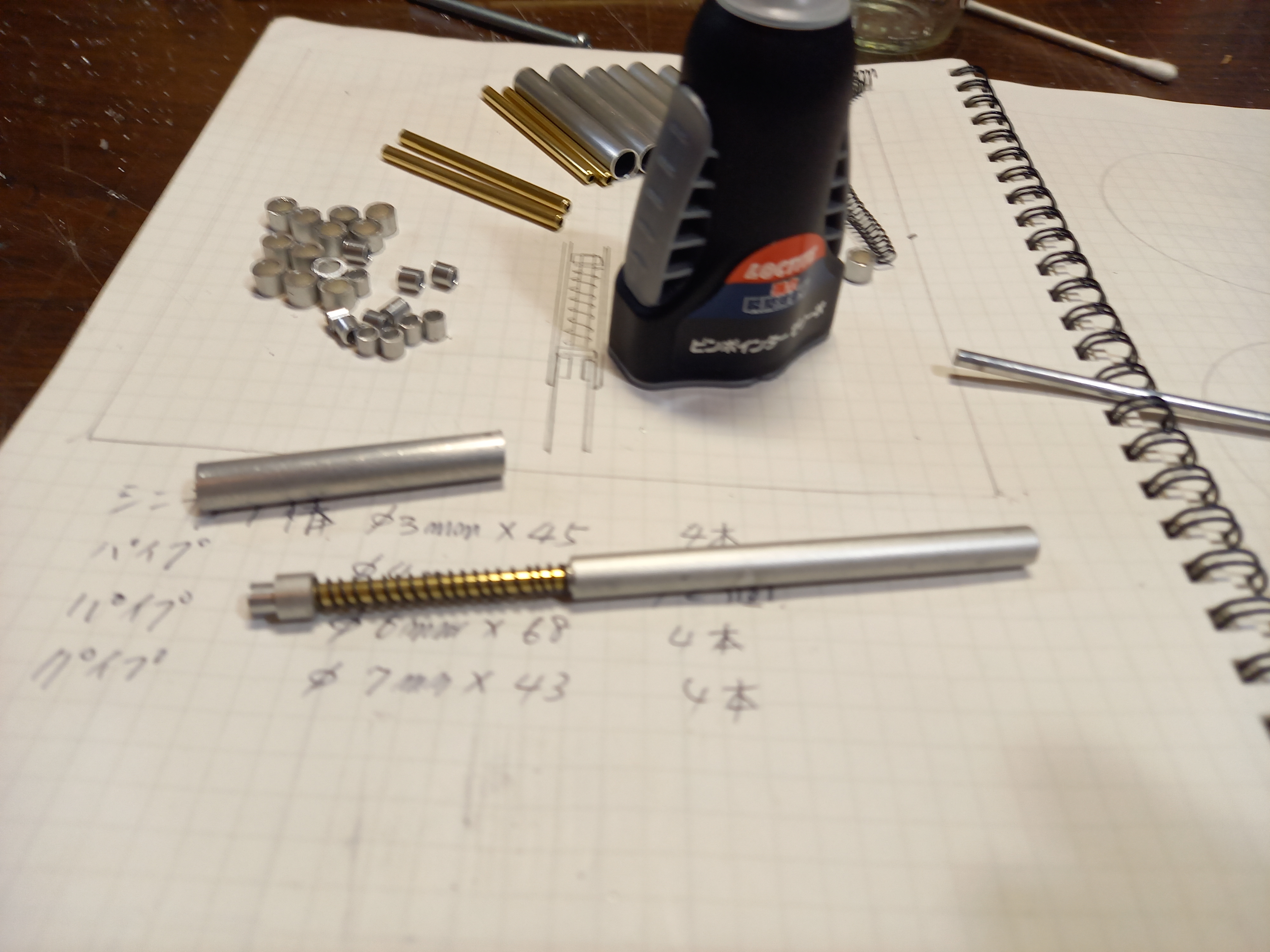

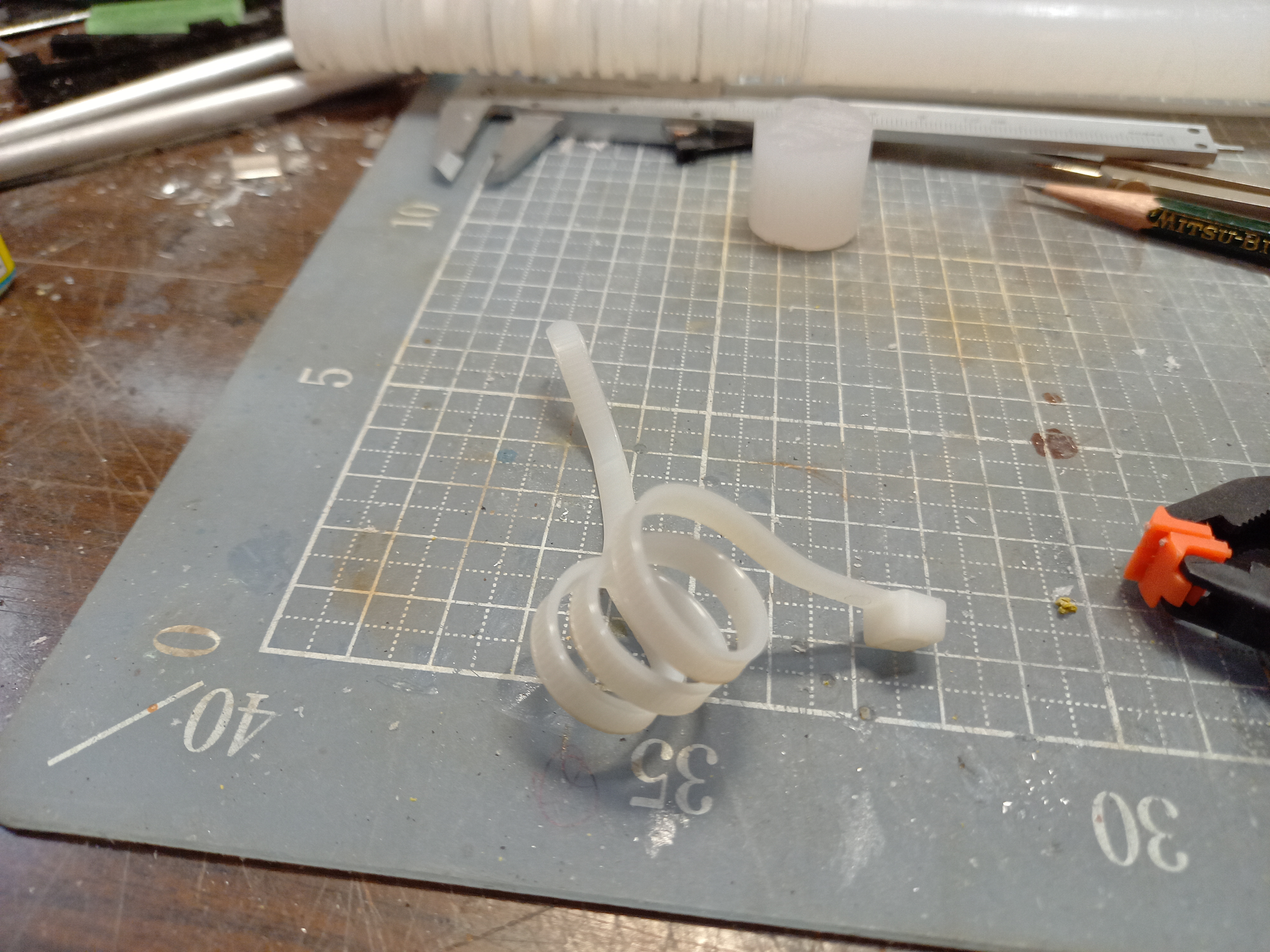

Thanks for your kind tips! Yes, I did heat up the 0.8 mm thin piano wire with my gas burner but it was broken when I tried to coil it. Maybe my heat control was not good enough or anything. :unsure: Then I found that it doesn't need to heat up if I use 0.5 mm piano wire. And I got a one with good tensioning. :D
Wrap with 0.5 mm piano wire around 3 mm screw bolt to make a coil spring.
So, I made whole new landing gears.
Thanks for looking!
And again, thank you Analyzer-san!
katsu
