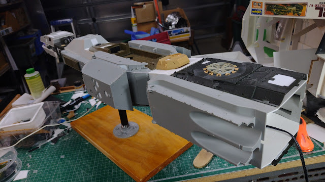

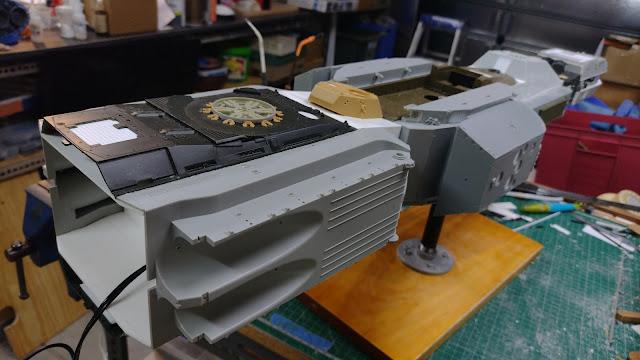

The structure is built on a length of pine to which I have attached a couple of 15mm water pipe flanges for mounting in exactly the same way as the film can spaceship. All the 1/35 scale tank hulls are strung along this wooden spine using 2mm styrene sheet bulkheads and connecting panels.

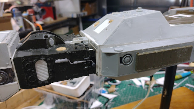

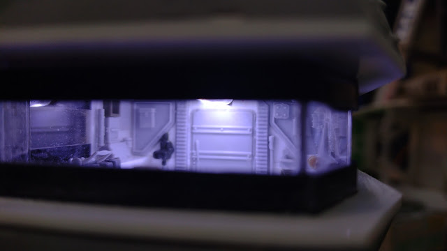

The bridge section is made from two Stryker kits of different types. I have detailed the interior and made windows from 2mm acrylic sheet. It is lit in the usual way with a led light strip consisting of the shortest possible module of 3 leds at 12 volts. The bridge top is removable for access.
The neck is made from two gun turrets from Tamiya Flakpanzer Gepard kits followed by two Dragon Jagpanzer top hulls top and bottom with two cut down Dragon Maus bottom hulls on the side.
The middle section is a combination of two Italeri DUCW amphibious upper hulls and two lower LVT amphibious hulls on the sides. Added to each side is a Maus turret.

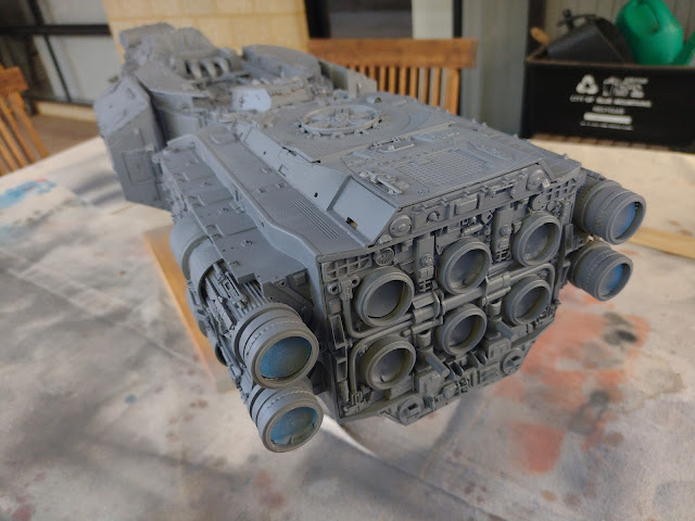

The rear engine section is made up from two Geppard hull tops and two Hobby Boss Land Wasser Schlepper amphibious vehicle lower hulls on the sides. I used the Land Wasser cockpits on two previous projects, the Science Vessel project and the Heavy Salvage Tug. One of the Land Wasser hulls has some nice raised line detail on the bottom of the hull and strangely the other doesn't. They both came with the same box art but were purchased a couple of years apart.
For the engines, I am going to use a number of LED garden lights I obtained cheaply as they were being discontinued at my local Bunnings hardware store. They have a convenient bell nozzle shape and I have used them before on my Escape pod mark II project. They are not particularly bright but will do for this project.
The bridge section is yet to have window mullions added to break up the large areas of glass. I will also add some 1/72 scale figures to the interior.
The model currently measures 885mm long with the engine nozzles still to be added.

The rear engine section is made up of two Hobby Boss Land Wasser Schlepper amphibious vehicle lower hulls on the sides.
the twin scoops on the engine block sides…I could see conical R-7 Soyuz strap-on booster rockets filling those…or maybe recessed nozzles in them.
I would pull the orange cap off Elmer’s white glue, turn it around…and put the cap back on the stem for a quick and dirty thruster nozzle.
The scoops suggest a chemical escape system with you ion drive lamps in the square block.
Large aircraft drop-tanks could also fit into those scallops.
I weathered the bridge interior and added 1/72 figures to the cockpit.
Unfortunately I forgot to take photos of the result which is now hidden behind masking tape.

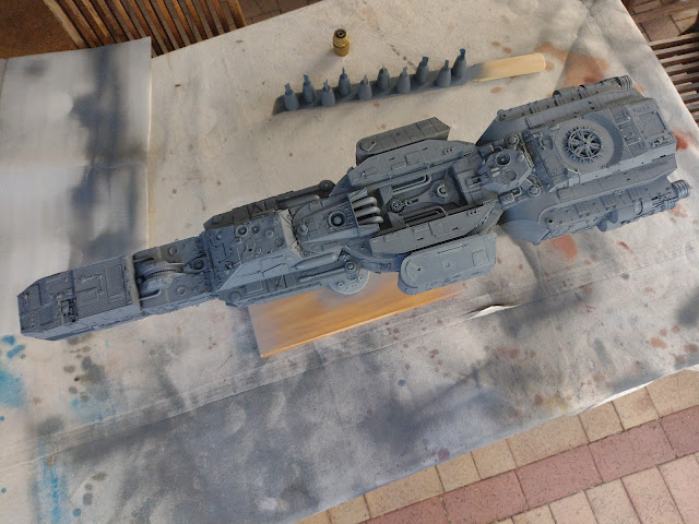

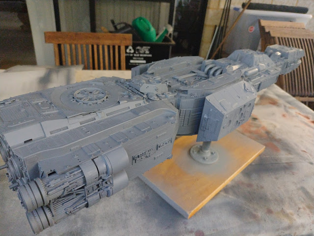

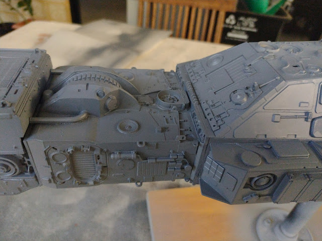

Then completed the surface detailing of the Tank Hull Spaceship.
The strap on boosters were made from wedding cake plastic fluted columns.
This was supposed to be a quick model but I found I had to add a lot of very small nurnies to make it look right.

Mung,
You've shown a few times in your builds that some models are... "built on a length of pine" .
I think it's a great method, but have you encountered sagging or other issues after a significant length of time, when using wood as a spine?
Thanks!
No sagging at all. The hull structure adds to the stiffness of the spine. 2mm styrene is pretty strong. It will bend on the flat slightly but if held vertically won't bend at all. Once it is all glued up it's not going anywhere.
